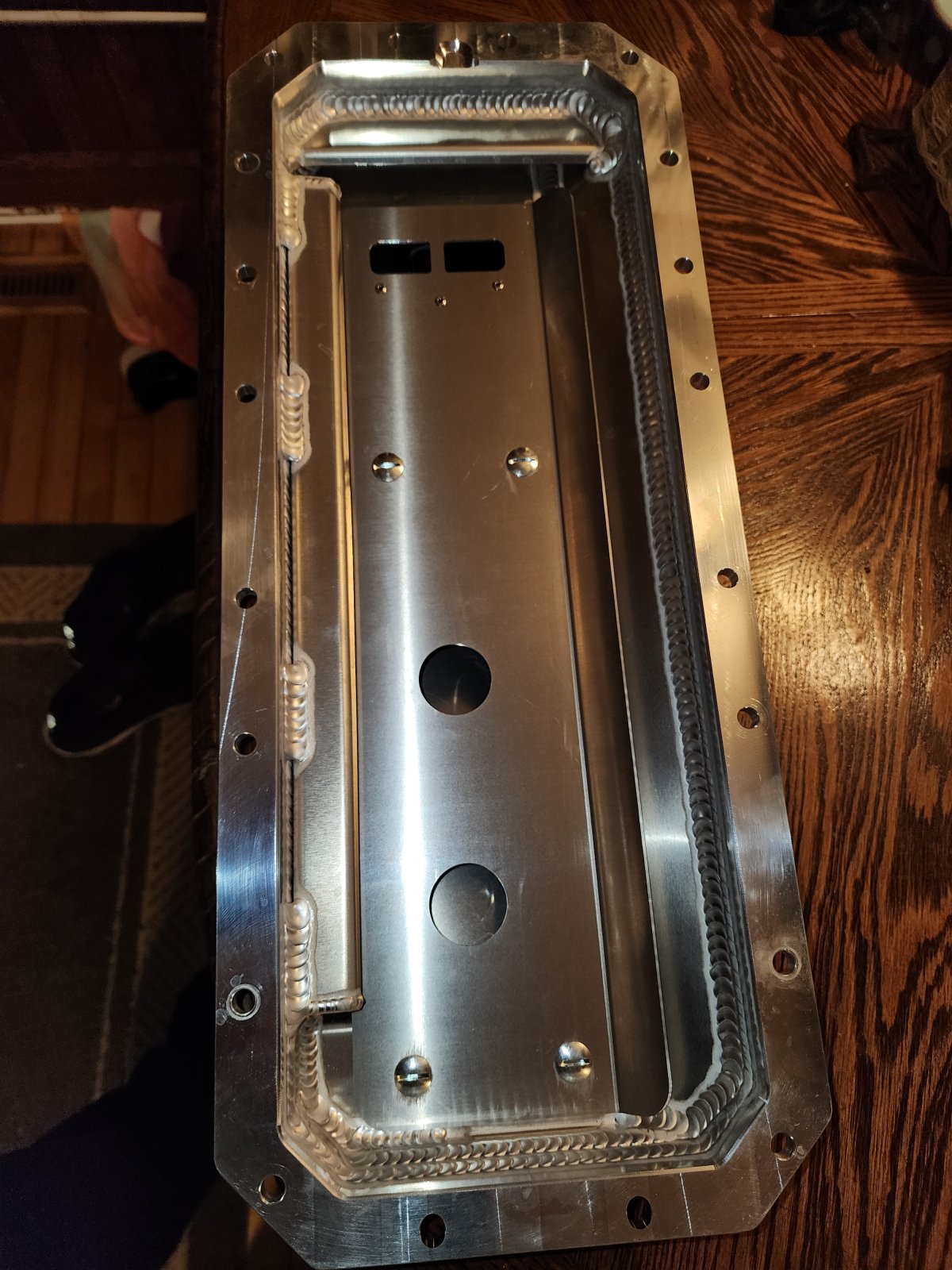

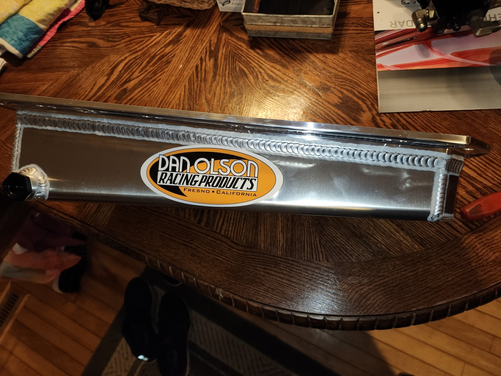

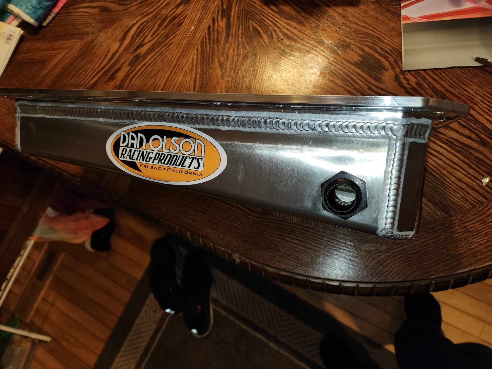

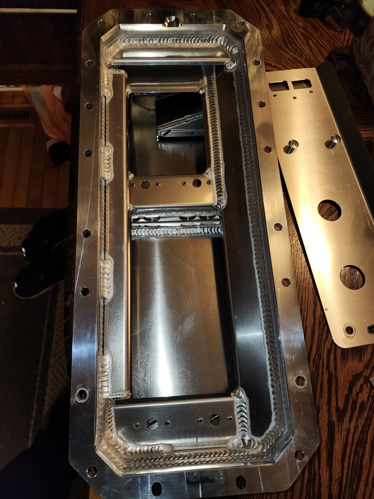

    I bought a new Dan Olson oil pan for the car. Here's a little nitro tech for you. This is considered a funny car pan do to it being tapered and more shallow than a square dragster pan. A big feature of real deal nitro pans is the thick billet rail. These pans are on and off so many times the thick rail keeps them flat. The plain sheet metal rail looks like a wash board in no time and starts leaking. The thick rail combined with a special fel pro pan gasket no sealers are needed. The gasket can be re used many times saving time and money. The out let is a AN-20 going to the pump. The windage tray is removable. There are trap doors to keep the oil around the pick up while braking. The multiple crank s****ers and pick up are welded in. There are skid plates front and rear. The pan is made with .090 sheet aluminum. The welds are perfect. It holds up to 11 quarts.

  16. DDDenny
    Posts: 22,486
    That pan is like jewelry, Olson makes top shelf stuff, I have one on my little Rodeck, a somewhat more garden variety version, also a pair of aluminum valve cover burndown castings that I machined threaded adapters to accept K&N breathers.
