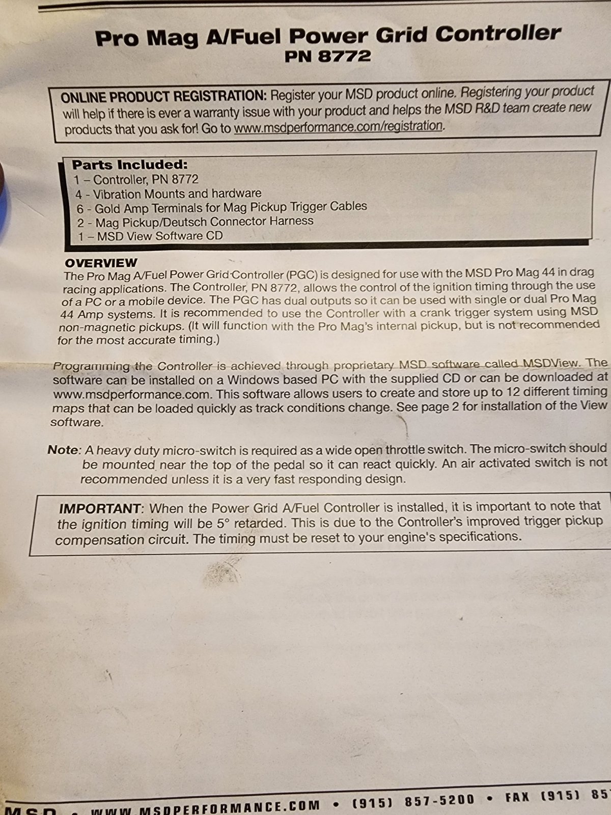

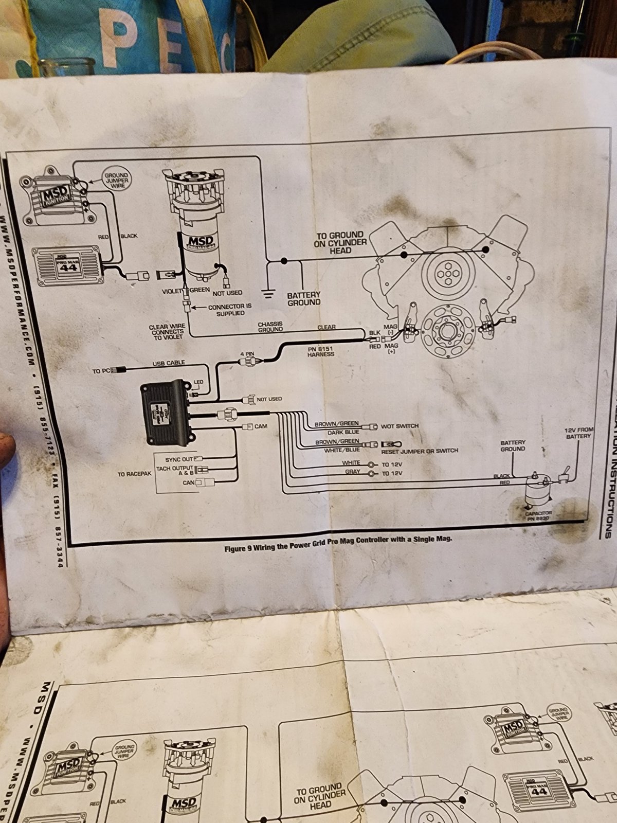

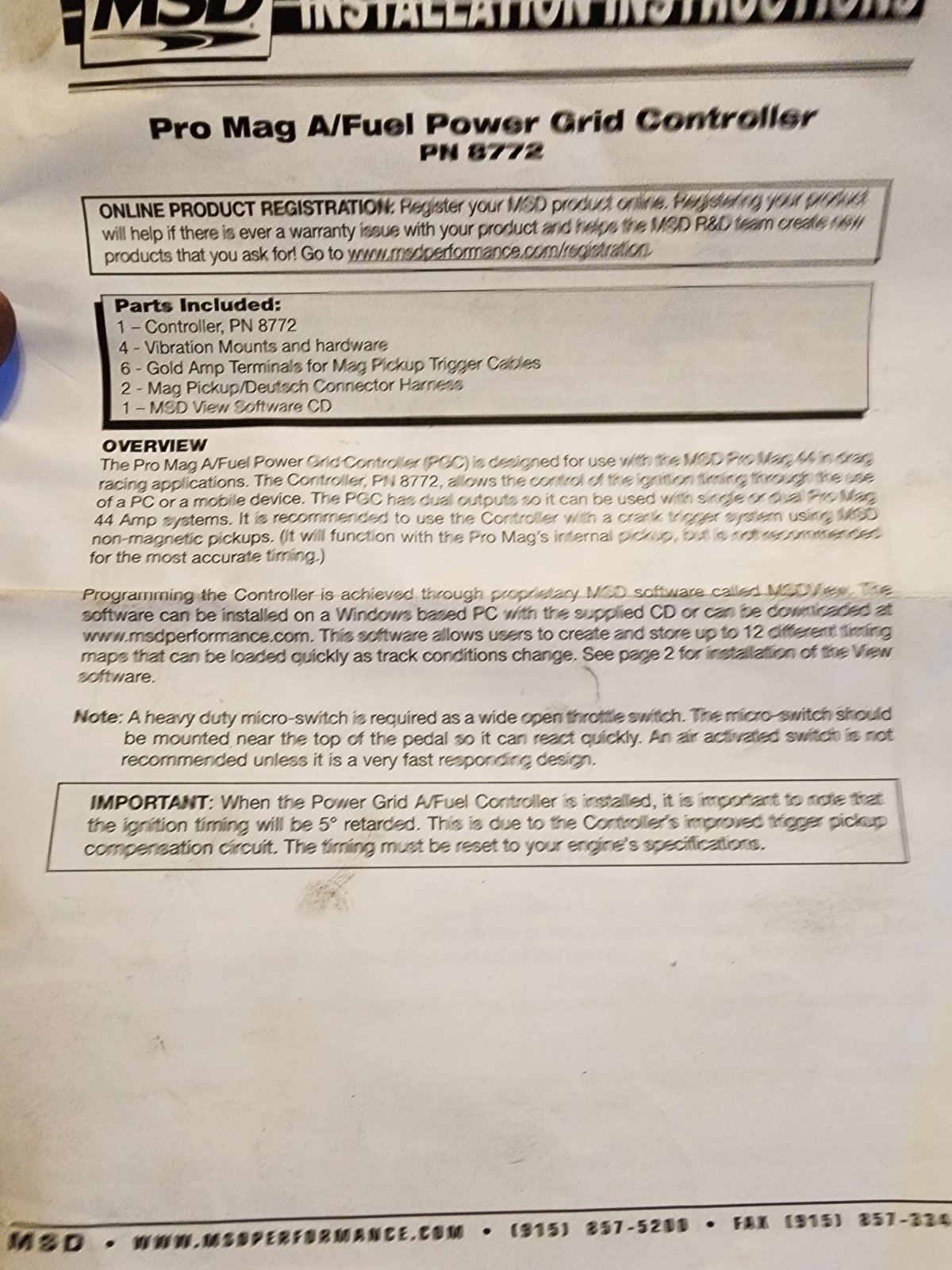

  2. The nitro tech tonight is used on most modern blown alcohol and nitro cars. Fast nitrous cars and turbo cars also use a version of this technology.
    The msd grid is a timing retarder. It pulls timing anywhere in the run that it's needed. Too much power at the hit like in my case pull some timing. If the track is slick pull some timing. A bump in the track 300 feet out upsetting the car pull some timing. It has many uses. The way I'm going to set up mine is to take ten degrees away just after the hit. The tire needs to plant. Timing will be ramped up to 45 degrees total over 1.75 seconds. I should be about 100 feet out. This is how the fast cars have made such big gains lately. The nitro 44 Amp version is twice the price of the other models. I included a few pages of the instructions. A special shielded cable for the crank trigger must be used along with a noise 20230605_194952.jpg 20230605_195004.jpg 20230605_195033.jpg 20230605_195019.jpg 20230605_201940.jpg 20230605_201942.jpg 20230605_202033.jpg 20230605_202111.jpg canceling capacitor.

  3. The grid stores the run. It can be down loaded onto a lap top. After viewing changes can be made. It has a wide open switch that's triggered by the gas pedal. That's what starts the timing curve.

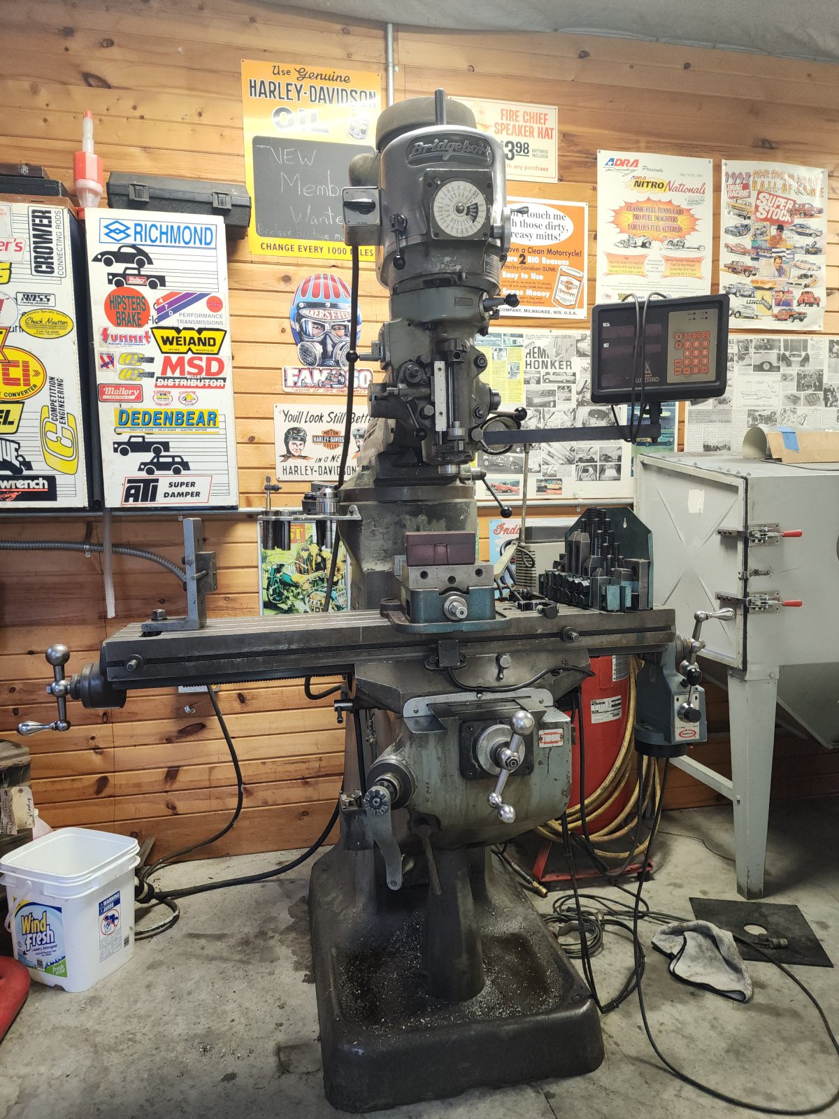

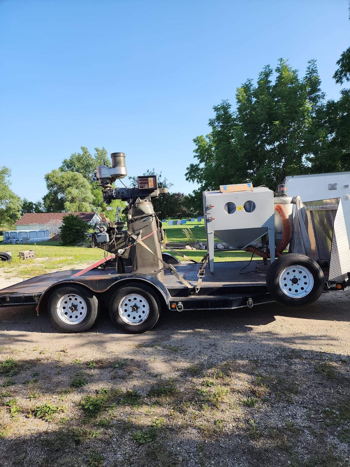

  20. 20230710_201021.jpg 20230710_174158.jpg This was fun in the 90 degree heat but we got it done with no incidents. I finally got a Bridgeport mill. It also came with a commercial grade sandblaster. Some tooling came with the mill more is on the way. I'm lucky to have a neighbor with a forklift.

  22. The sandblaster got thrown into the deal. The machine shop is moving and didn't want to take it to the new location. The mill is 15 years old but has only been used a few times in the last five years. The sand blaster works great. I gave my old mill away to a friend.

    Congrats on the mill!

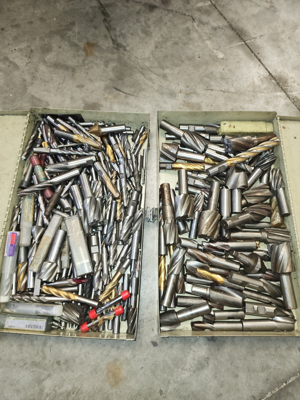

  26. 20230713_192123.jpg My machinist friend dropped off a few end mills as a shop warming gift for the mill. This should last me a lifetime.

    That's a pile of $$$!
