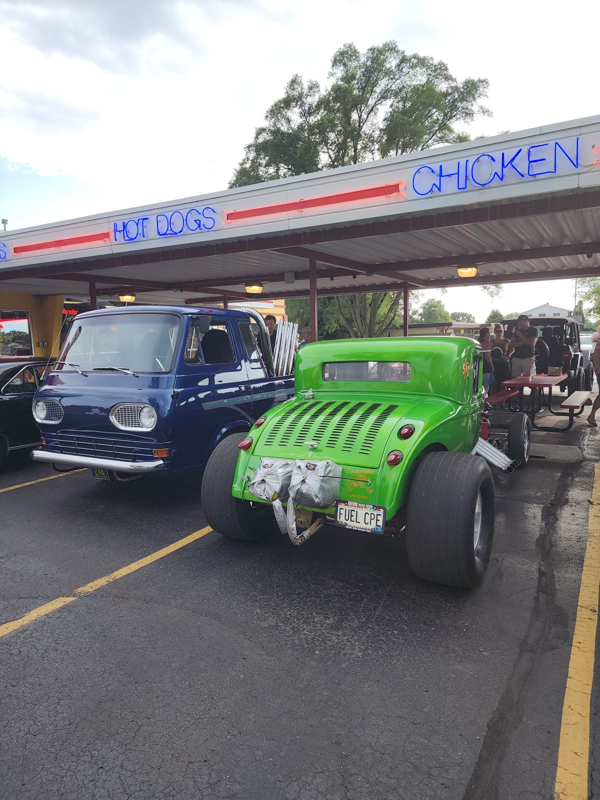

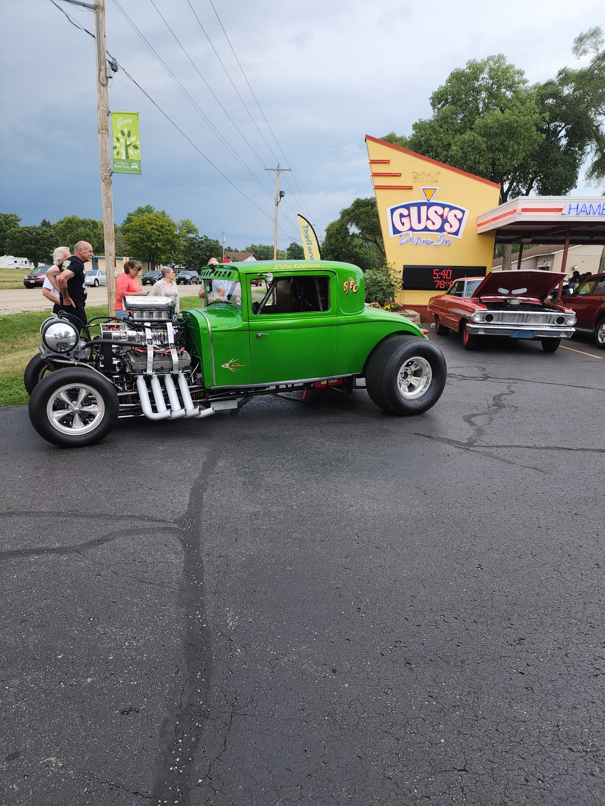

  10. 20230722_174012.jpg 20230722_175933.jpg Street driving to gus's drive in tonight. I'm getting ready for a drag and drive event in August. A street driven wheel stander showed up.

    What a car! If people only knew what you go through to make this happen.....

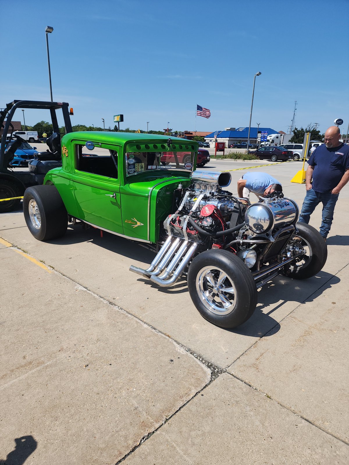

  17. It's been a busy few weeks. I went to the show on main street Union Grove followed by Gusses drive in East Troy. Then today I went to the friends of Broadway Bob luncheon at the Blue Badger truck stop. It's a get together for racers and fans of the Grove. Danny Sullivan brought his jet car and fired it up. I fired mine on nitro. Al McFadyen brought his blown alcohol coupe. Truckers and customers were shocked to say the least. When I came home to get ready for the Area 41 drags this weekend I found this during routine maintenance. This isn't good. Luckily I have two spares. They just need to be honed to size. I can do that tomorrow. Always something. Between all the action with the coupe I got the nos quarter on the 66 chevelle. I can't show pics of that. 20230816_135918.jpg 20230816_140058.jpg 20230816_194819.jpg 20230816_194833.jpg

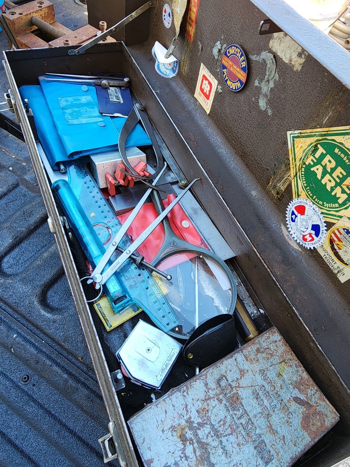

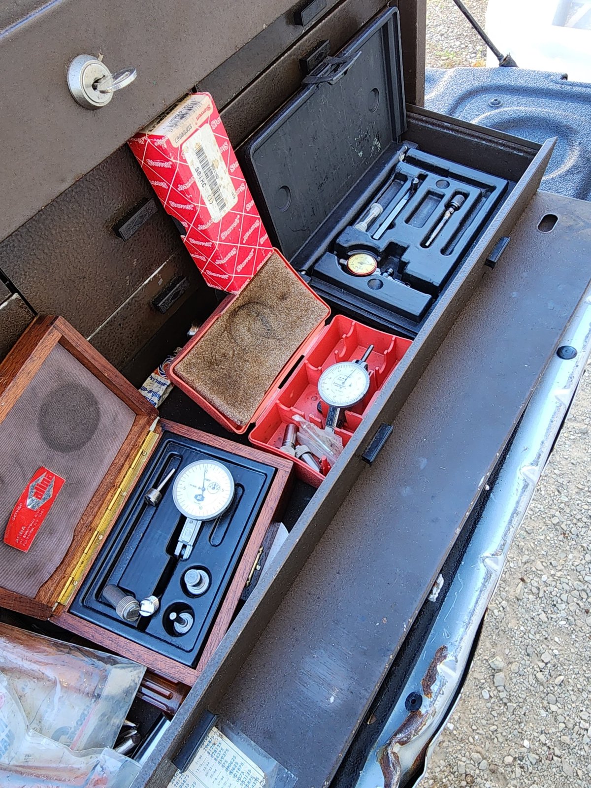

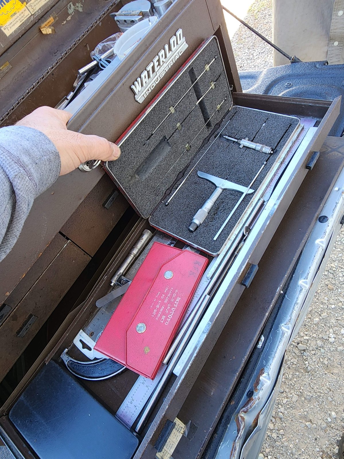

  25. 20230831_112327.jpg 20230831_112943.jpg 20230831_112938.jpg 20230831_112353.jpg 20230831_112342.jpg 20230831_113019.jpg 20230831_113011.jpg 20230831_112408.jpg 20230831_112401.jpg It really ****s when friends p*** away. I have received calls from two friends widows in the last week wanting to clear out some of their tools. It's nice they thought of me to get their shop equipment. They don't know what to do with it and they don't want strangers coming over or listing it on ebay. The first pile of item came from a retired machinist. The second pile I have to go get in southern Illinois this weekend. Anything I won't use or is doubles to what I already own will be donated to a young up and coming local hot rodder or machinist.

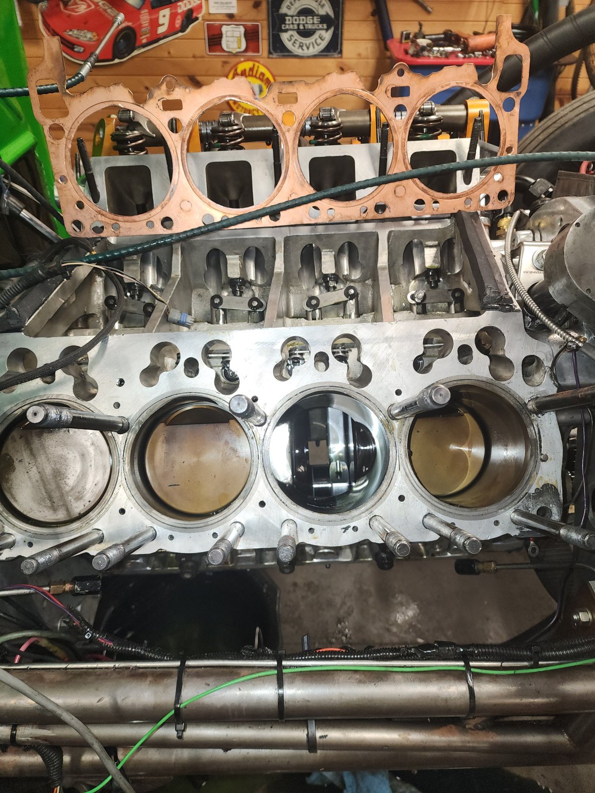

    Back on the 31. I found number 4 cylinder leaking 45 percent last time out. I pulled the head and put new valves in and put it back on. Re leaked still 45 percent. I pulled both heads and changed the springs. I pulled the pan to remove number 4. I found a broken stuck second ring. I have the parts to fix it. It's a matter of time to have it at the fall out drags this Friday. Let the thrash begin. 20230910_194432.jpg

    Is the kb block hurt?
