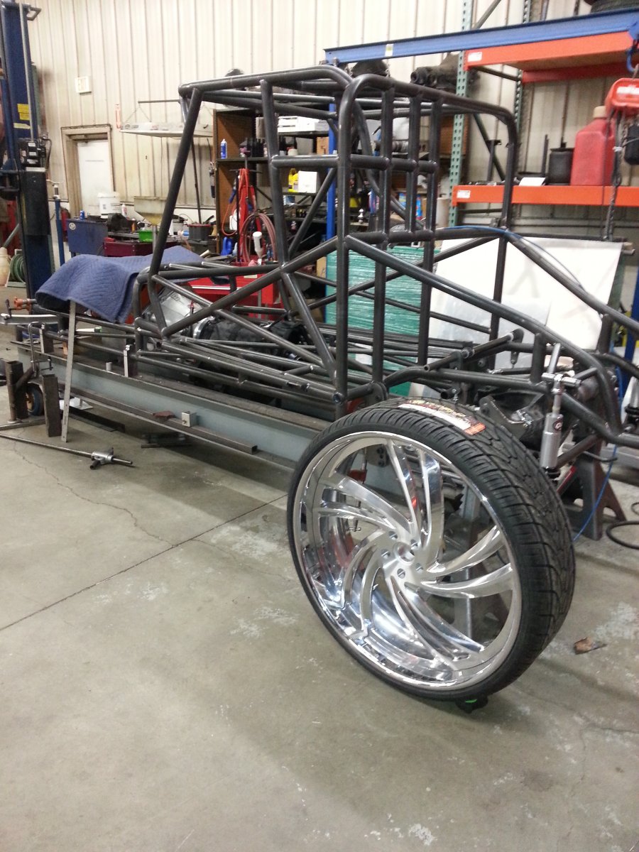

  6. What do you think about the new wheels? Just kidding i couldnt resist when i saw them come into the shop. 20160128_154146.jpg

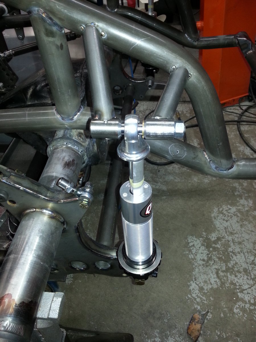

  7. In the wheel pick the new axle can be seen. Wow this axle is light. I could have a sword fight with it. The air valve got welded. Now its off to the polisher. John got most of one shock mount done. He had a family emergencey to deal with. There is one more support that needs to be welded in place. I got the body out of there again to be dropped off friday at the body shop. Busy busy 20160128_154223.jpg 20160128_154624.jpg 20160128_154206.jpg 20160128_154624.jpg

    :DLooks Great as usual, except for the Wheel LOL. Gary:D

    Actually, that Wheel Picture made me throw up in my mouth a little bit...:eek::eek:o_O

    Is that a tire on that wheel, or a rubber band.:)

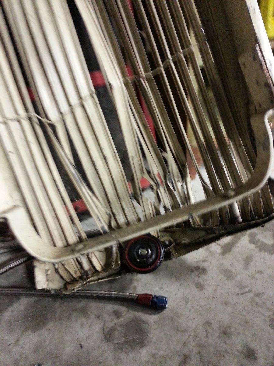

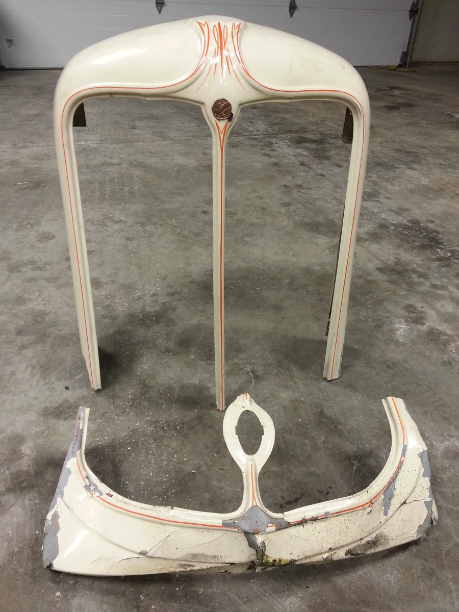

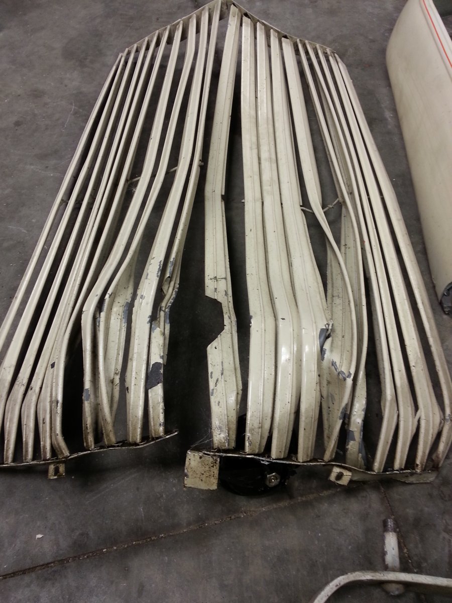

  13. I have been holding off dealing with the grille. These old mopar parts are so rare that any decisions made need to realy be thought out. I cant call speedway and get another if i mess up. I have said before i want to keep as many of the unique features this chrysler came with if possible. A fibergl*** model T grille wont work for me. The lower section of the grille is junk. The insert is beyond saving. So i made the hard decision to cut the bottom off for several reasons. I want a grille on the car. i don't want to cut up a good original. i want a grille that looks right for this build. The fuel coupes back in the day used cut down shells. The uncut grille i think would look out of place as it is very tall and would look miss proportioned. Im not putting the radiator up front its going in the trunk. Im thinking with the insert out and a moon tank taking its place it should look good. with the moon tank up front it should get plenty of air to cool the recirculating nitro when I'm street driving on gas. as the fuel goes around in a loop it will generate heat 20160130_164943.jpg 20160130_165507.jpg 20160130_165516.jpg 20160130_170525.jpg

    Those grilles are beautiful. You are giving incredible thought to this...definitely a go fast safely and keeping a vintage look hotrod has its challenges and you are meeting them in style. So much to know and do. Thanks for sharing the journey again.

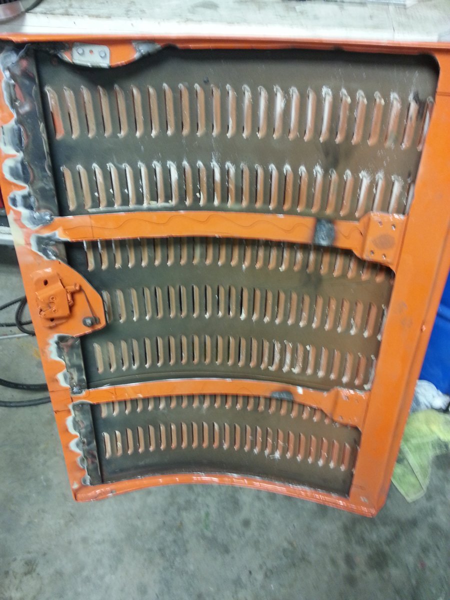

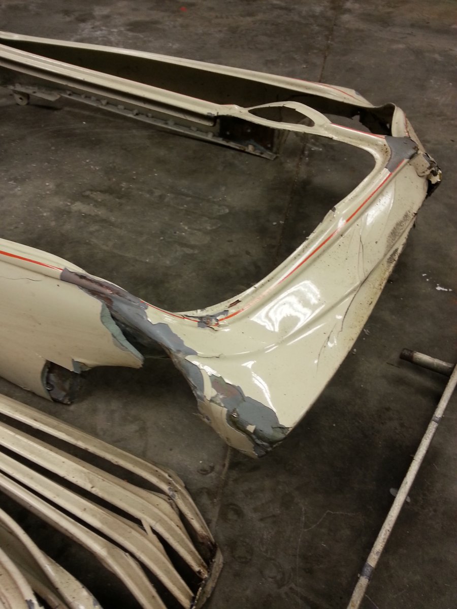

  18. The trunk is mostly done. The inner skin i put on years ago is gone. Originally i think it had wood bows with the sheet metal nailed to it. That old wood was rotted away. I had made angle iron bows using a stretching machine. The orange strips are all that remains of the skin. I welded it to the angle iron bows to help give the trunk mounts some support. i put all of those louvers in with the help of dennis rolane. the r from r and b ch***is in kenosha wi. they were a very early ch***is shop that became very famous. due to dennis advanced diabetes he couldn't run the louver press. so on a christmas eve i went down to the shop and under his direction i punched the louvers. It sure is light now. It will go to the paint shop this week 20160131_171955.jpg 20160131_172051.jpg

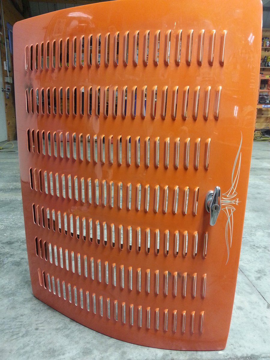

  19. loudbang
    Posts: 40,346
    I sure don't envy the poor bodyman that has to sand with all those lovers on there.
    els likes this.
  20. they complained the first time they had to do it. the pinstriper wasn't all that exited either. I don't see what the big deal is there are only 168 louvers in the lid. that's why I don't do body work.

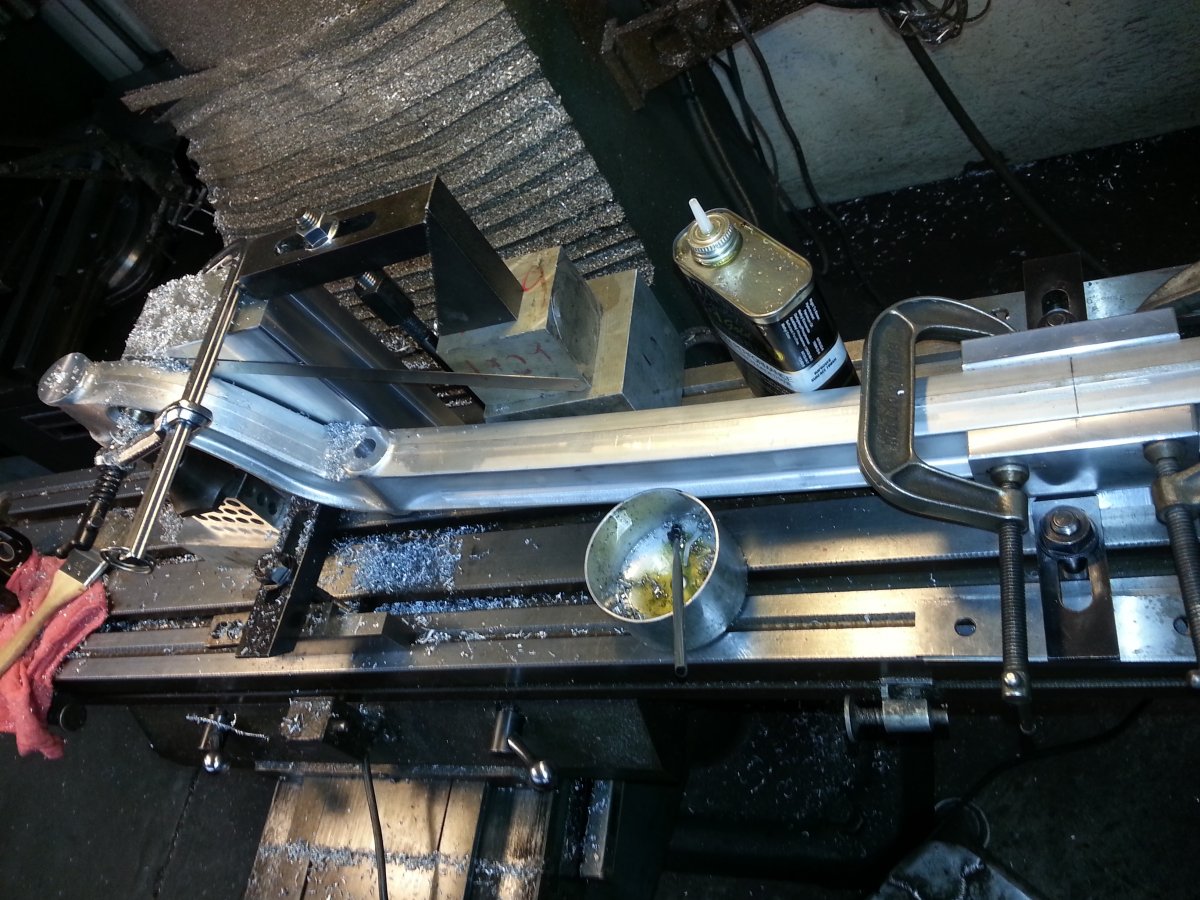

  21. Theres not alot to take pictures of tonight. But dont think there is not alot going on. The air valve was welded on. That created a mess with the pollished casting. That made a trip to see mike the pollisher neccesary. Mike did it monday while i waited. Now it looks like it was cast there. The axle is moving forward. The fixtures were made to support it. Its ready to go in the mill.The trailer hitches pieces are all fabbed. They just need to be welded. The rods are being sent back tomorro after being resized. The rear shock mounts are done. Im on my way over to andy boehls shop. He just bought out vern moats operation. He has fire bottles and a three way shut valve for me. Like i said not alot to look at but alot is going on. I ran across the pic of the car last night i thought it looked cool.We were pulling a all nighter getting ready for the march meet a few years back. 20160203_154718.jpg 20160203_172444.jpg 20160202_180235.jpg

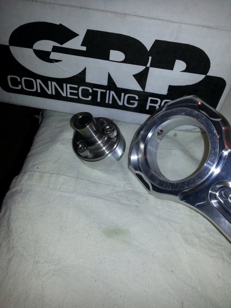

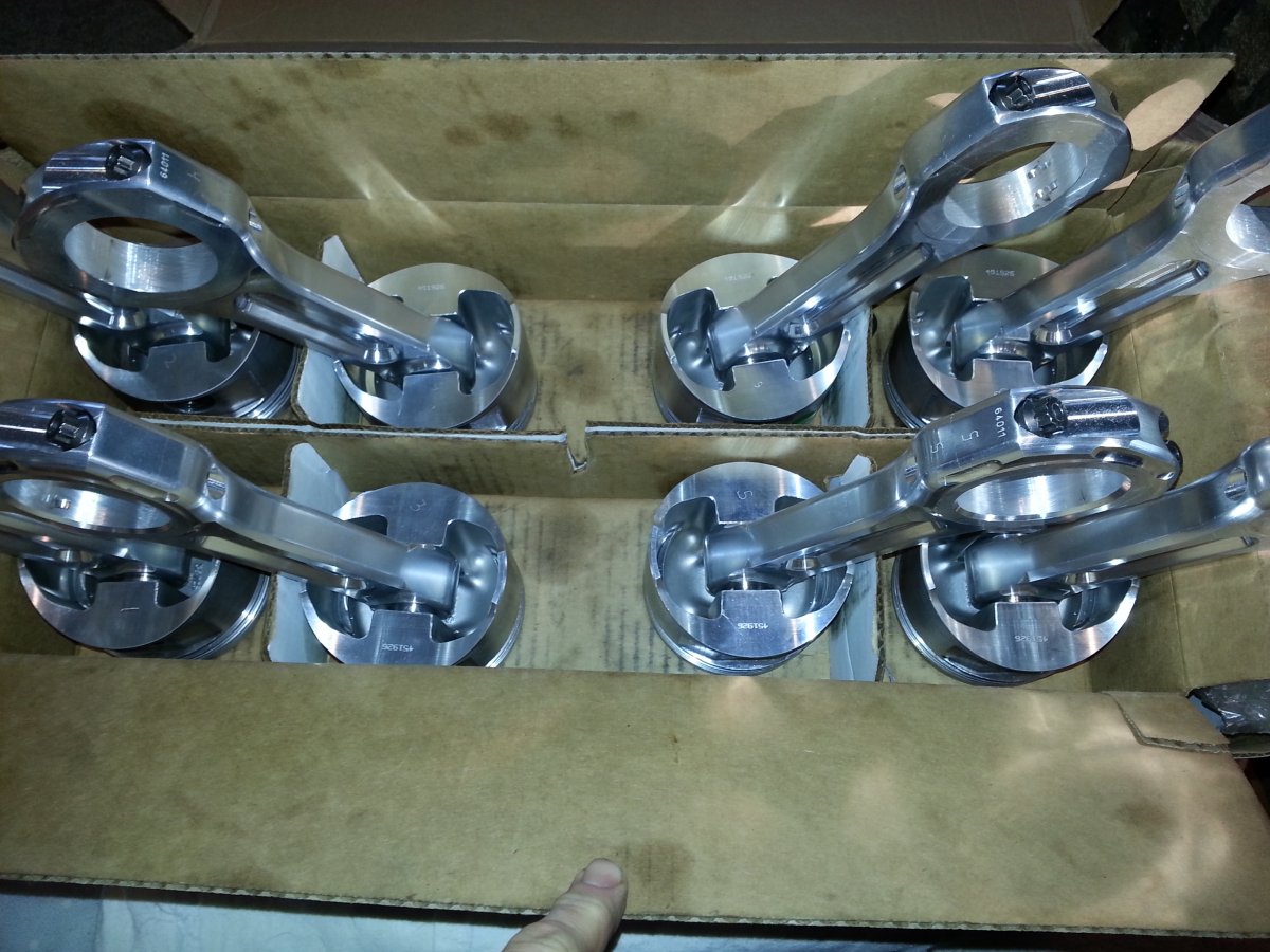

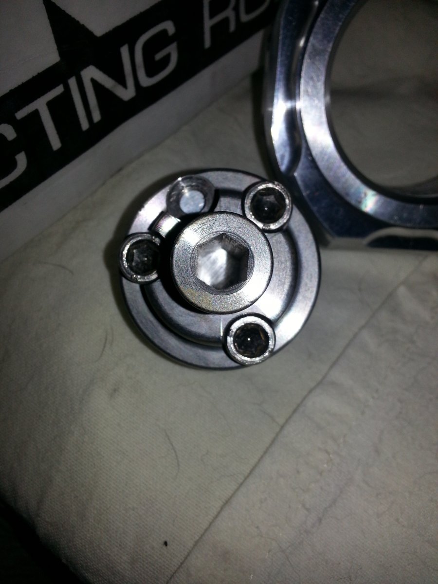

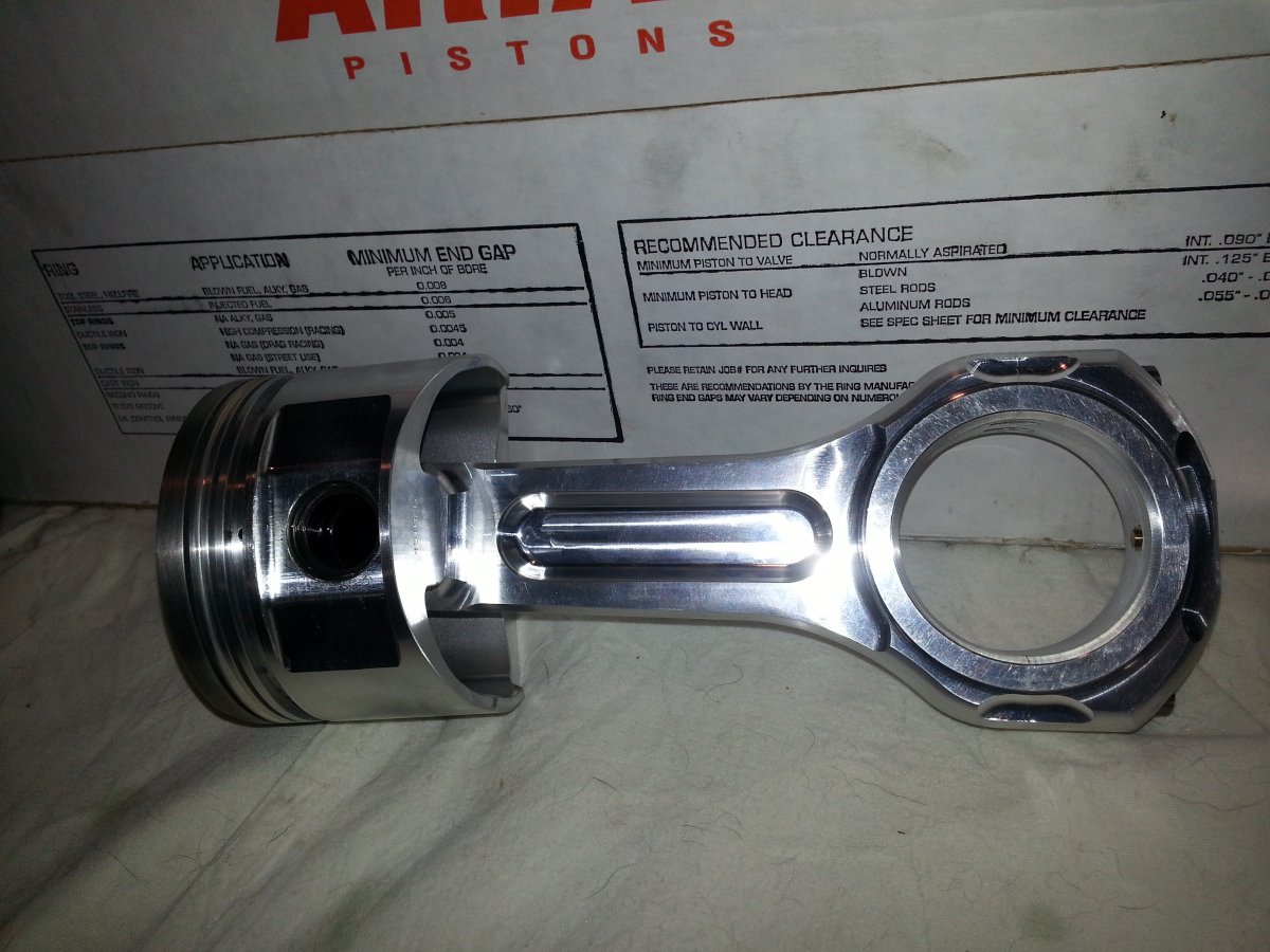

  22. 20160206_163558.jpg Fed ex dropped off the rods this morning. This gave me some thing to do. Time to put some parts together. 20160206_155626.jpg 20160206_155552.jpg 20160206_160218.jpg I sent the rods back to grp for resizing. When the engine was taken apart the big and small ends were checked with a bore gauge. It was found that a few were .0015 out of round. This is a common reading after a years service. The bores get pinched smaller. Grp offers to its customers free resizing. The br*** pin that holds the bearing from spinning needs to be removed first. They are drilled then tapped. A bolt is screwed in. When the bolt hits bottom it drives the pin out. The rod is honed back to size. New pins are pressed in. The small end is then honed. Now the rods are good for another season. The part next to the rod bolts to the cam. This drives the fuel pump and mag with a hex shaft. The aluminium spacer is unique to the early hemis. There is a bolt under the spud that holds it to the cam. late moel hemis and wedges don't use this. this part is available through hot heads. It will work perfect with the hot heads front cover. Theres nothing secret here just ordinary blown fuel parts. I thought i would include a few pics on the inner workings of the engine for those who have not seen this stuff before. This morning i also got the drive shafts front yoke changed over to the the lenco specific yoke. I will check the fit soon. most likely it will need to be cut down.

  25. Jim has been very busy this week working on the front axle. At the start of this rebuild i decided to go with spindle mount wheels. This decision has created a big domino effect. First there was a lot to do so i could have front brakes. Spindles needed to be purchased that were made for the racing the car will see. I was unable to find a axle that is made for anglia spindles. I was fortunate to find a raw super bell forged aluminium axle. Now in true hot rod fashion we are making it all fit. Jim has been on the phone a few times with jerry at super bell. They went over all the dimentions. Jim made fixtures to hold the axle in the mill. The holes for the bat wings were machined first. Those holes were then used to help hold the axle for the king pin holes. A inclenometer ( im sure i butchered that spelling) was used that reads to the second for the right angle. The axle will flex some and that was figured into the final angle. The hole for the king pin is off center .080 for steering clearence. Once all the holes are drilled the axle will be flipped over for the machining on the botton. It took alot of time to make the fixtures and set up everything. Im ok with that because we only get one chance. Once again the harder road was taken but in the end i think it will be worth it. lightening holes will be added to make the axle stronger. when all the machining is done the axle will go visit mike the polisher. the axle needs to be mounted by either a four bar or hair pins. i chose pete and jakes chrome hair pins for that early fuel coupe look. 20160210_160532.jpg 20160210_160543.jpg

  28. good question. i figured i would get some interest in my axle selection. the super bell is a cold forged aluminum axle. its not cast. the material is the same used on the corvette and viper suspension components. the material is of the highest quality. the axles were subjected to testing and showed to have more strength than the stock iron axle. their testing also showed with one inch holes the axle could hold more load than the undrilled axle. i asked jim about this. jim has multiple engineering degrees. he agreed if done correctly the load is transferred from one drilled section to the other. he says that way the load is spread out evenly. about my front end selections. I'm trying to blend the traditional look of a old fuel coupe with some modern technology. the hair pins fit the old look to a T. if i wanted the ultimate modern front end i would have used a- arms and struts. doing the struts would have upset the balance of old and new parts. it would have looked horrible on a non fendered car. ford did use aluminum axles in their big trucks in the seventies with no problem. super bell has a section on their web site about the testing that was performed. its impressive reading. thanks for everyones interest.
