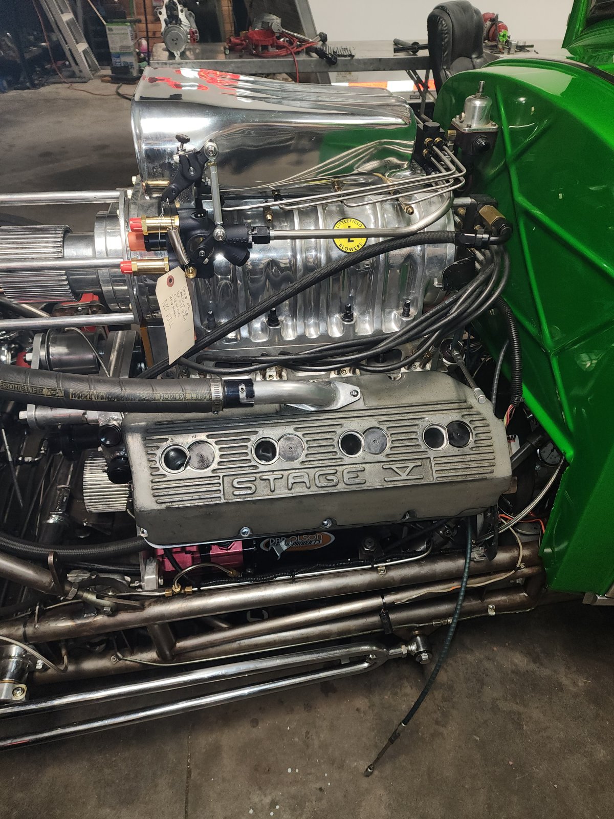

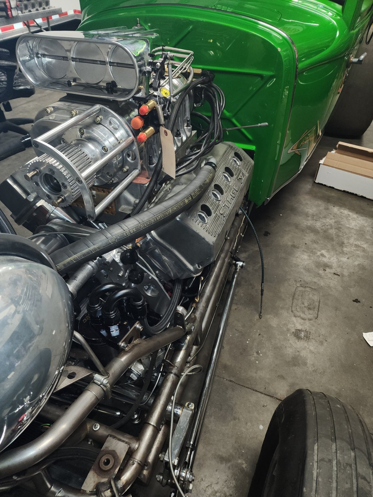

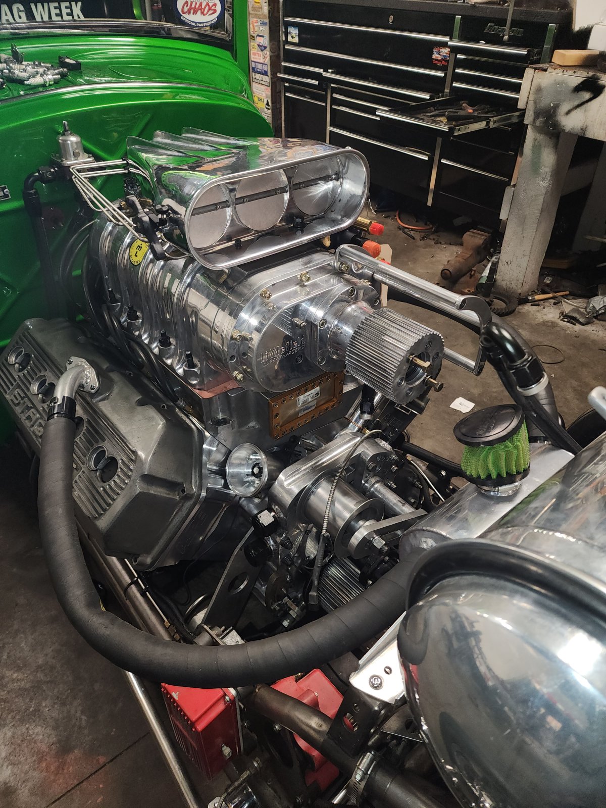

  1. 20231114_191830.jpg 20231114_191819.jpg 20231114_191812.jpg 20231114_191806.jpg The nitro chaos events I want to run requires a minimum of 85 percent. The car sounds great with that percentage.
    I came home from work tonight and found this at the door.
    Enderle bug catcher with the vintage three ribs on top. It has a high flow nitro spool inside of a K valve. It was ordered with a number ten inlet. The Hilborn barrel valve it replaces only had a number eight inlet. This was always a concern of mine. With the extra volume it will be needed for safety. You never want to go lean. They go boom or lift the blower.
    I heading to the shop to see how it looks. The ****erfliesI View attachment 5895189 will be sent out to be anodized green to match the car.

  4. I had to set it on the hemi for a look. I got in the car and it's so much easier to see in front of the car. It looks good. Now fuel lines and a throttle cable can be made as soon as it gets back hone. 20231114_202252.jpg 20231114_202143.jpg 20231114_202300.jpg
