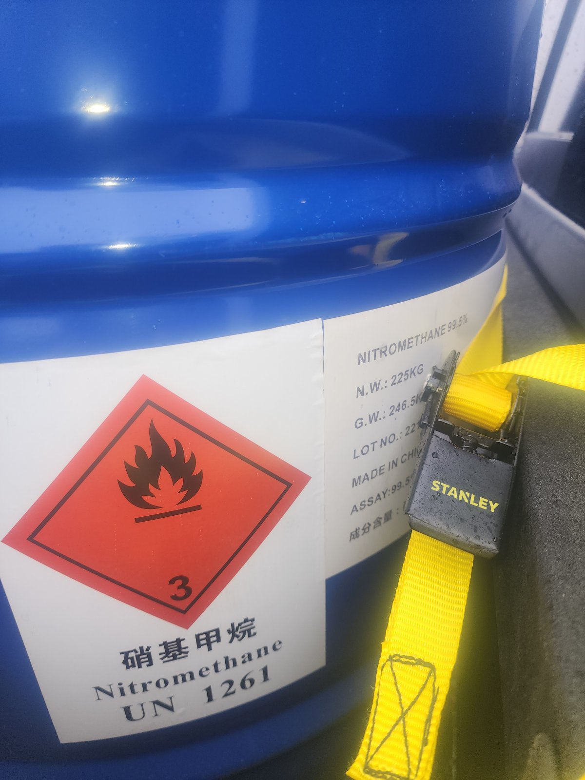

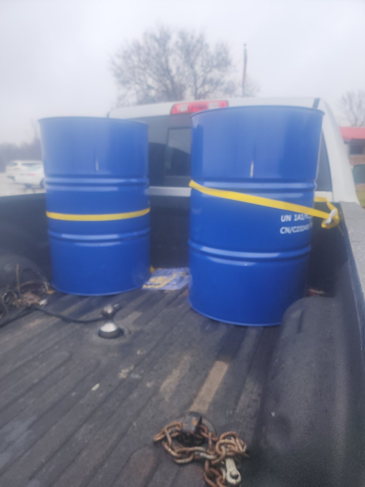

  17. Seeing that I was in the area I stopped by a fellow nitro racers shop for a few drums. It never hurts to have a few on hand. 20231216_115434.jpg 20231216_115439.jpg

    Chinese NITRO, what's wrong with this picture?
    427 sleeper and Desoto291Hemi like this.
  20. After the Oklahoma bombing domestic nitro producers stopped selling it for racing. I don't like it.it smells different.
    Stogy, mad mikey and 427 sleeper like this.

    All so the only plant that manufactured
    Nitro in states burnt down if remembering correctly about 15 yrs ago,
    All so recall the state of Ca or all 50 states had a ban on Nitro that you could not have more then like 40 or 45 gallons @ atime ,
    Race team transporters or Nitro fuel truck had issues with transporting across Ca state lines, It had somthing to do either with Nitro or weight of transporters ,
    Its been A while are those Laws / litigation still apply??
    Are those 55 gallon drums or 40-50 gallons that are pictured ??

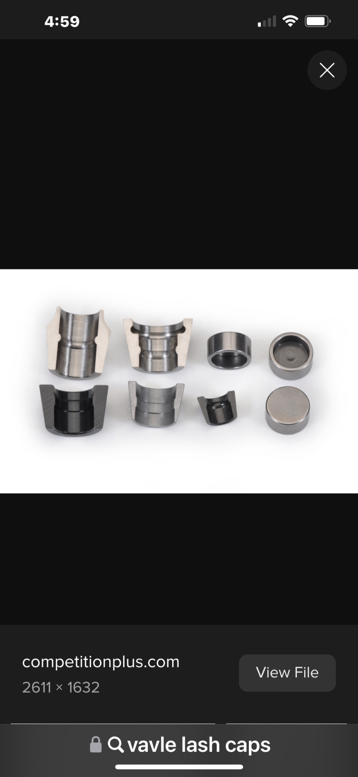

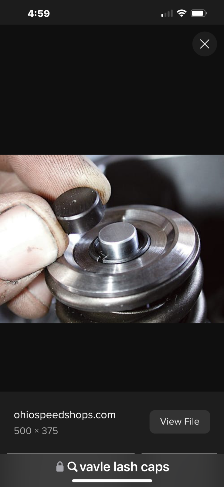

    Are you referring to lash caps ??
    These ! ?

    It was Racer X I was asking, those are the lash caps I’ve always seen. I’ve not seen ones that lock into the valve/retainer

    you where not specific on question,,
    A pic , I miss under stud , No worries
    You said cap & retainer,
    The ""keeper"" are locking style , lash caps sits on steam then lock / snap over keeper , most of time are 10 degs keeper or more ,
    Its a common practice used part for Hight Rpms , spring presser & cam lift
    Stogy and Oneball like this.
