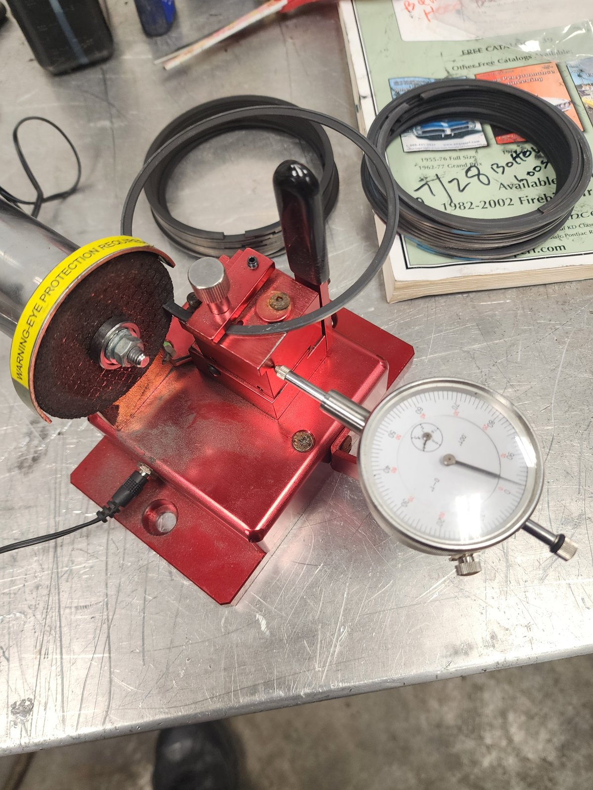

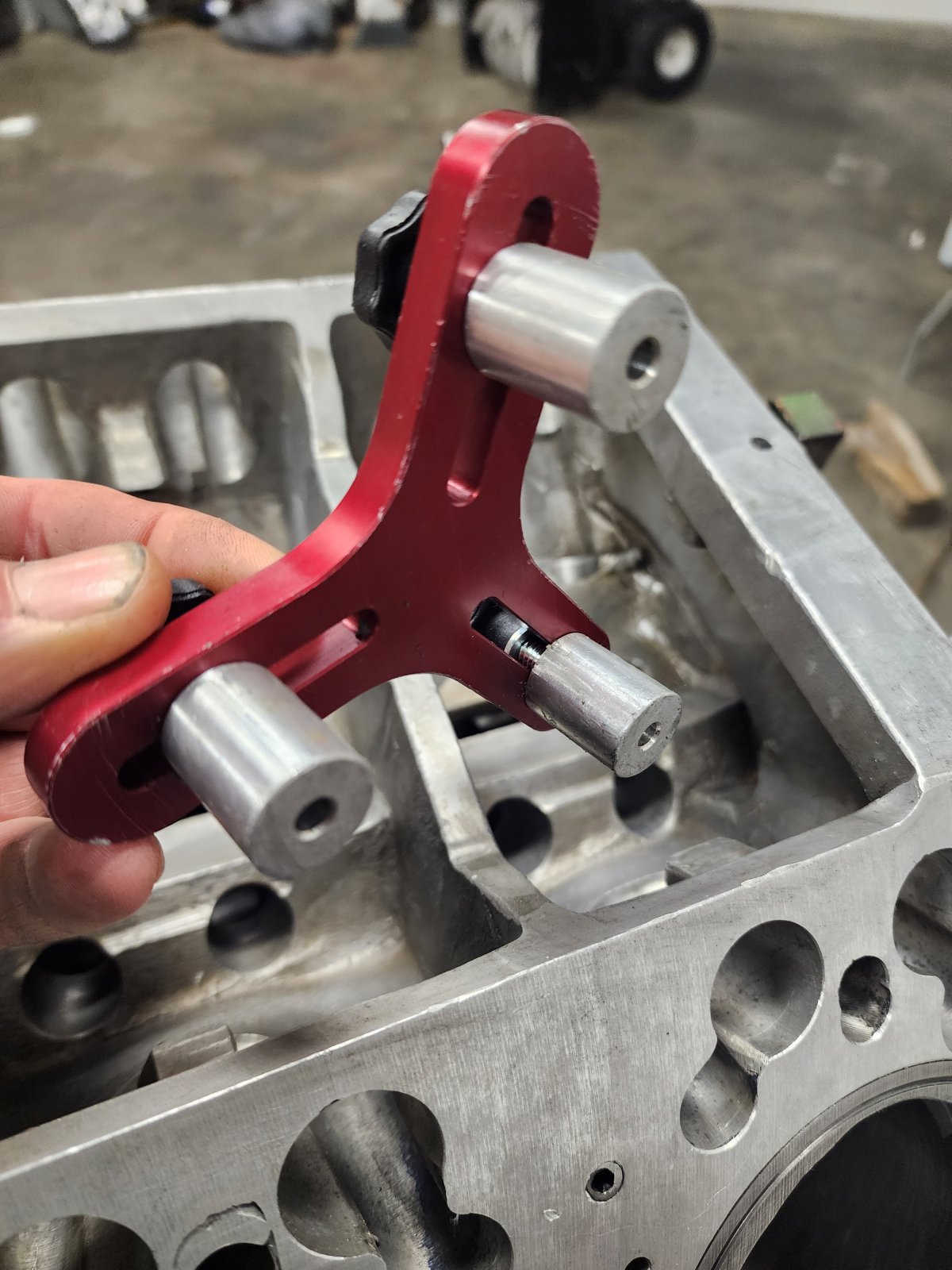

  3. I have covered this before so I will keep it brief. Ring end gap is critical. When the rings get hot they expand. In a nitro engine it can get crazy hot. Hot enough to close the gap. A ****ed set of rings can cause major damage. Getting the gap correct is a big deal.
    To measure them correctly a ring squaring tool is used. This does what the tool is called it squares the ring in the bore for a accurate measurement. A power ring file saves alot of time. It has a indicator on it for fast accurate removal of material. A slight dressing on the edges finishes it off.

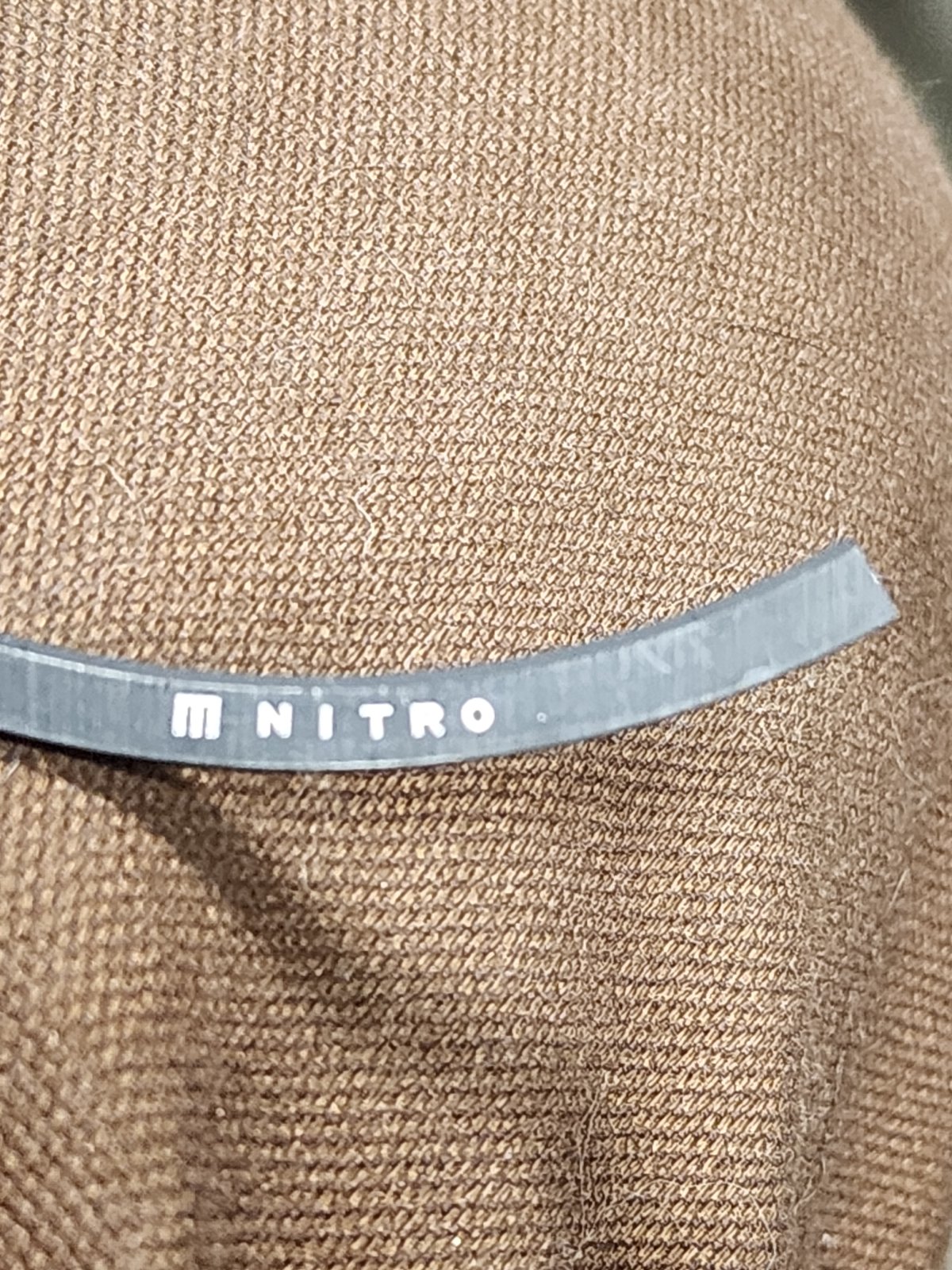

    The new ring package is a ****s top ring. This L shaped ring under pressure is forced against the wall for a great seal. The second ring is also a compression ring with a barrel faced edge. The oil control ring is standard. It takes a while to do a set.
    Gaps are top a loose .037 bottom loose .028 20240110_191738.jpg 20240110_191753.jpg 20240110_192004.jpg

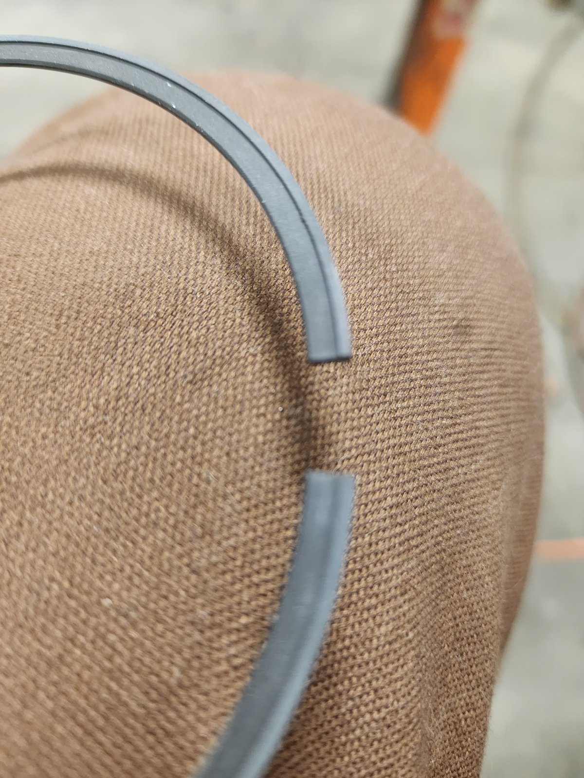

  5. Ring detail. The difference is obvious. 20240110_193124.jpg 20240110_193205.jpg 20240110_193217.jpg
  6. Once you have a power file you will never do it by hand again.

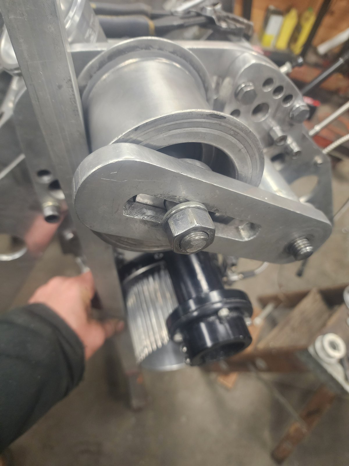

  8. 20240113_182300.jpg After digging out from the snow storm i was back on the hemi. One little change and it's like opening a can of worms.
    Because I won't need the alternator pulley; msd degree wheel or the idler pully big bracket anymore everything needed to be redone. Some time was spent on the lathe making new spacers. A new idler pulley shaft was made to. The old one had a slight bend to it making it difficult to slide the pulley off. It's all better now. A straight edge was used to make sure its all correct. I needed to get this done before it went back into the ch***is. I find this work to be fun. It's real hot rodding making your own parts. 20240113_180121.jpg 20240113_180124.jpg

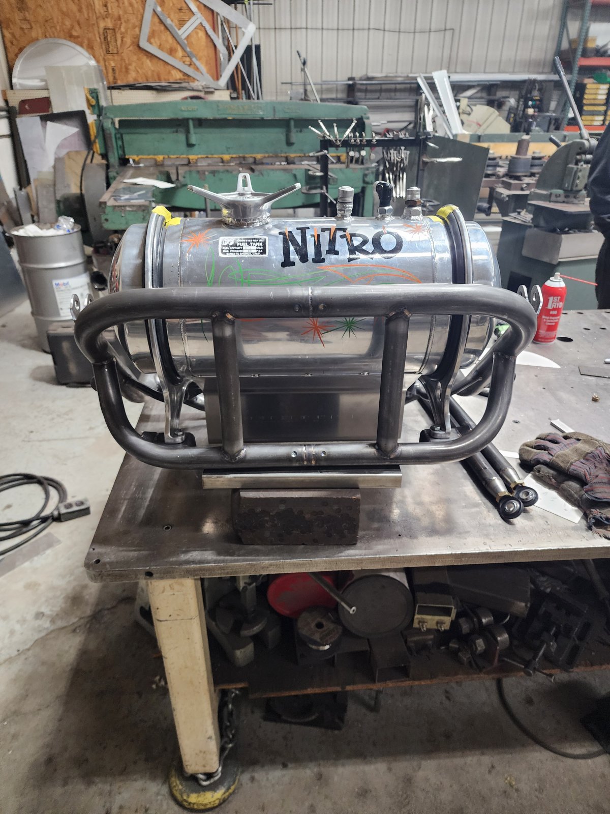

  10. It's almost done. The final location for the fittings for the fuel line and drain were laid out today. The design changed slightly for clearance reasons. It's now going to hold 3.5 extra gallons. That's good. 20240117_094708.jpg 20240117_094715.jpg 20240117_094726.jpg 20240117_094730.jpg

  12. The tank was washed out. The bottom was cut off.
    enloe, mad mikey, porkshop and 3 others like this.

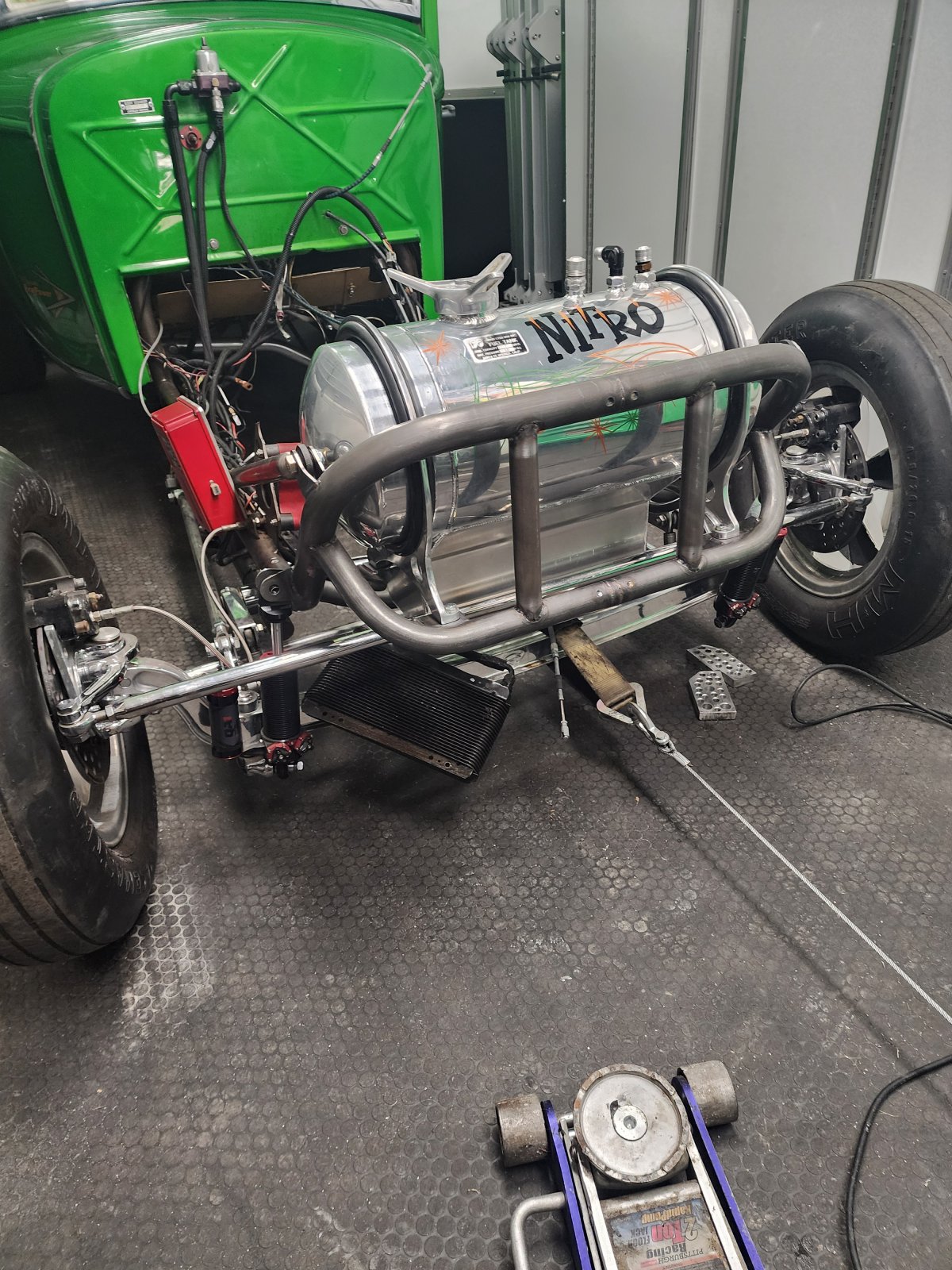

  13. 20240120_163223.jpg All of the planning paid off. I picked up the completed frame section without having to bring the trailer out in the snow and salt. The car is still in the trailer. I wanted to see it on the car so I did what I had to do. It fits perfect. The shop filled the tank with water for a exact measurement. It came out at 10.2 gallons. I couldn't be happier with how it came out.
    I can now use a blower starter
    The capacity was increased
    It's a safer design
    Looks better
    Mission accomplished. 20240120_160952.jpg 20240120_160957.jpg 20240120_161004.jpg
  14. Another plus with the tank lower it will be easier to fill the nitro tank and during a wheelie I will be able to see over it.
    TFoch, TerrytheK, saltflats and 10 others like this.

    The tank looks "right". Perhaps easier to make a new squared-off aluminium tank, but incorporating the round tank makes a very nice nod to the car's (and hot rodding) history.
    Cheers,
    Harv
  17. That was very important to me to have the moon tank. All of the fuel altereds these days have the ugly funny car style square tank. It would have killed the look of the car to get rid of the moon tank. I might paint the new added on piece flat black to make it disappear. I will decide that after the engine is in and I get a look at it outside.
    The addition was set up at the back of the tank not only for looks but it also had to clear the drag link.
    TFoch, The 39 guy, mad mikey and 8 others like this.

    Just noticed in your pictures, while cross steer, your track rod is in the dreaded front of axle. But with your brakes & rims & track rod arms looks like still lines up for pretty good Ackerman angle. Can I ***ume you carefully designed it that way?
  19. DDDenny
    Posts: 22,472
    Mike
    Me thinks NOTHING happens by accident on this car!
  20. It was set up that way and it works great. There wasn't any room behind the axle for the bar. This way it frees up alot of space for the oil pan and blower pulley. The other optio would be to raise the engine to clear. That would have been a worse idea.

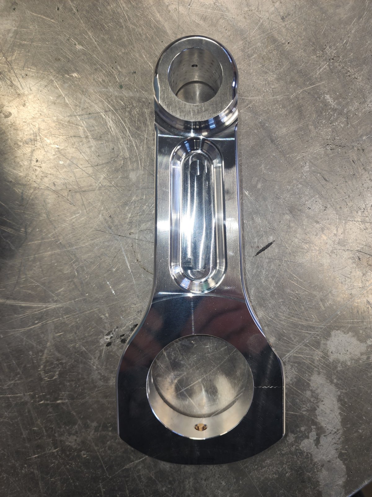

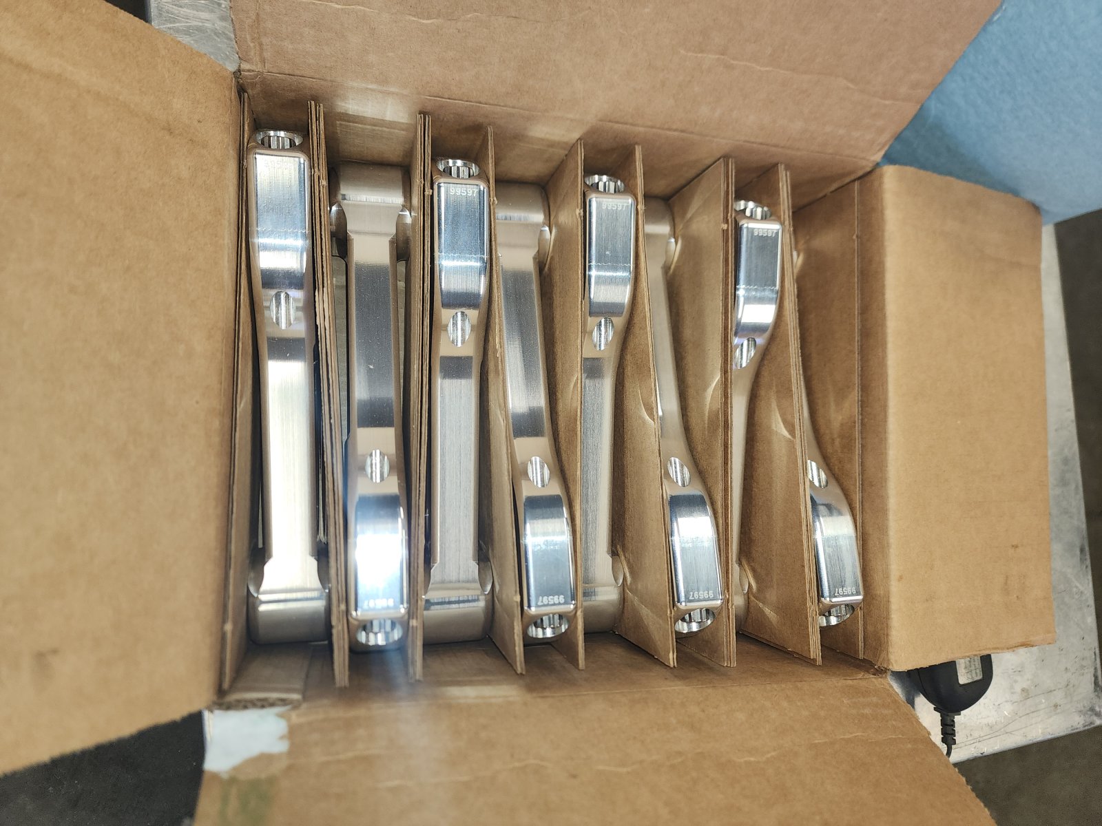

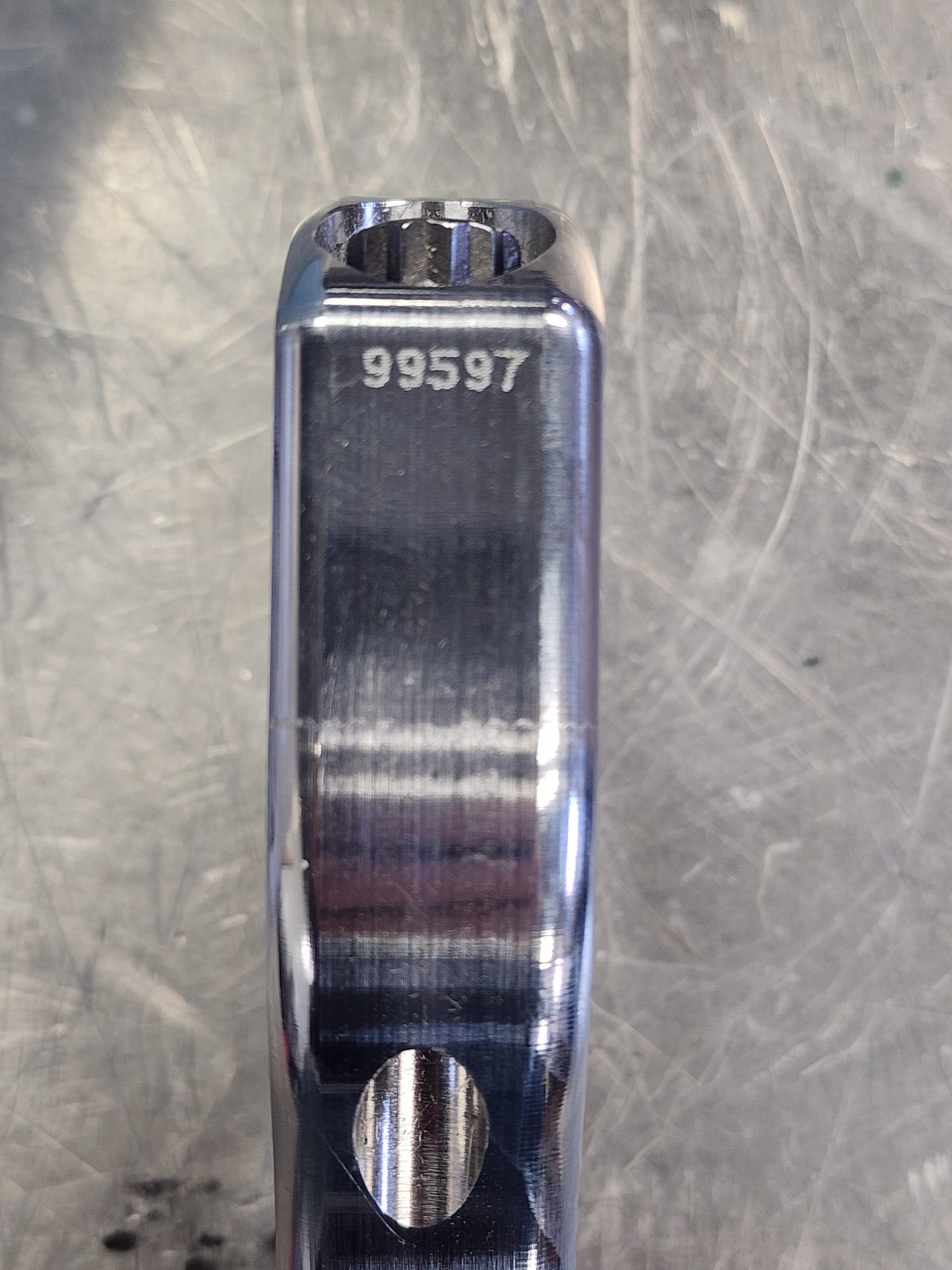

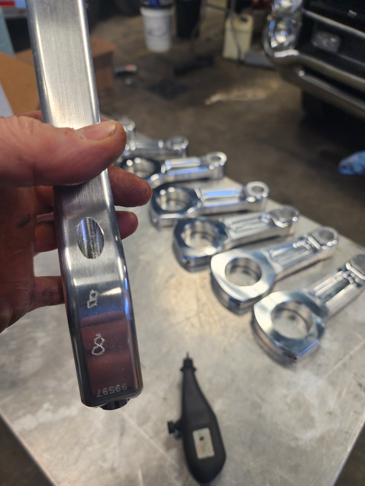

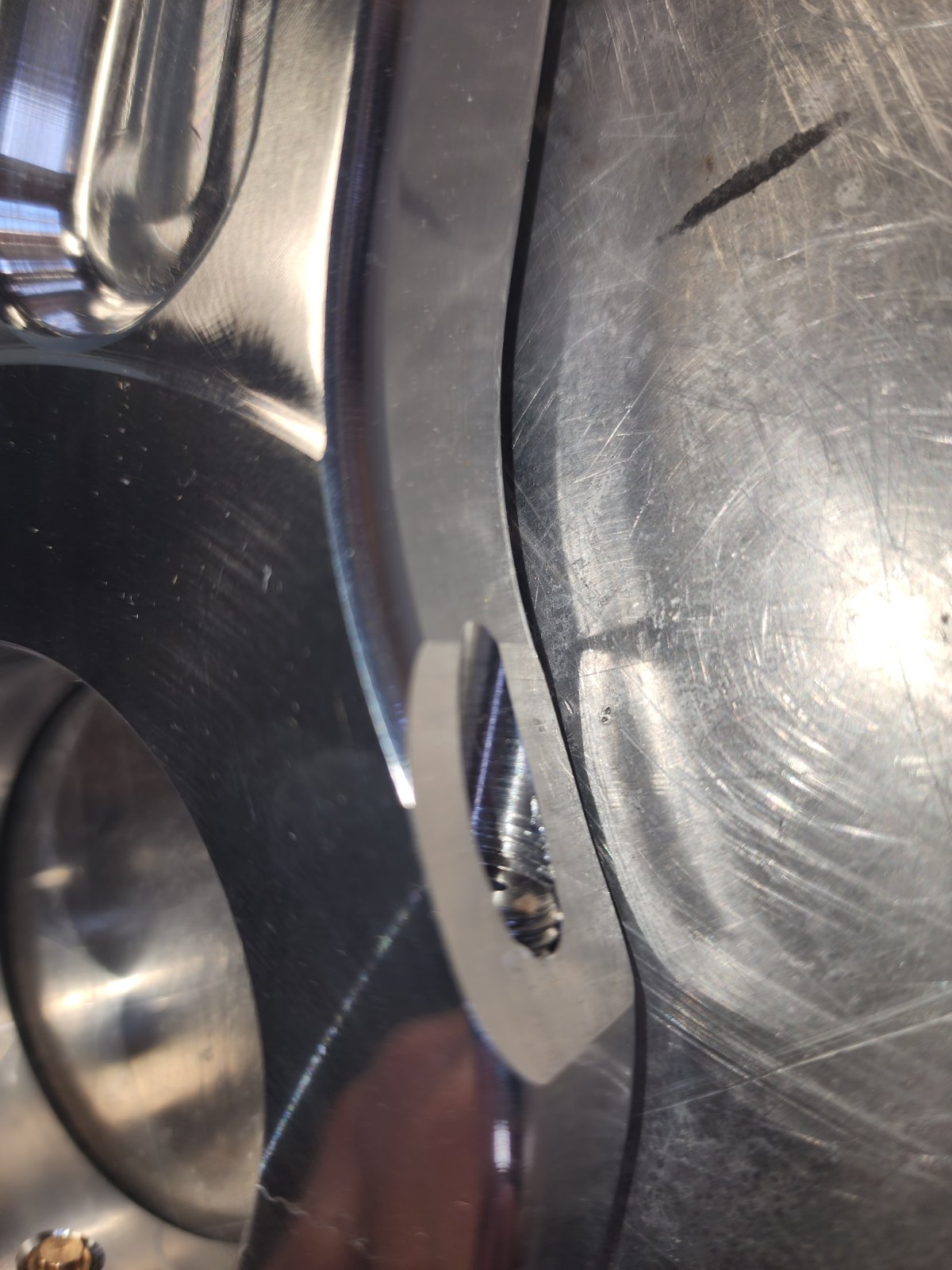

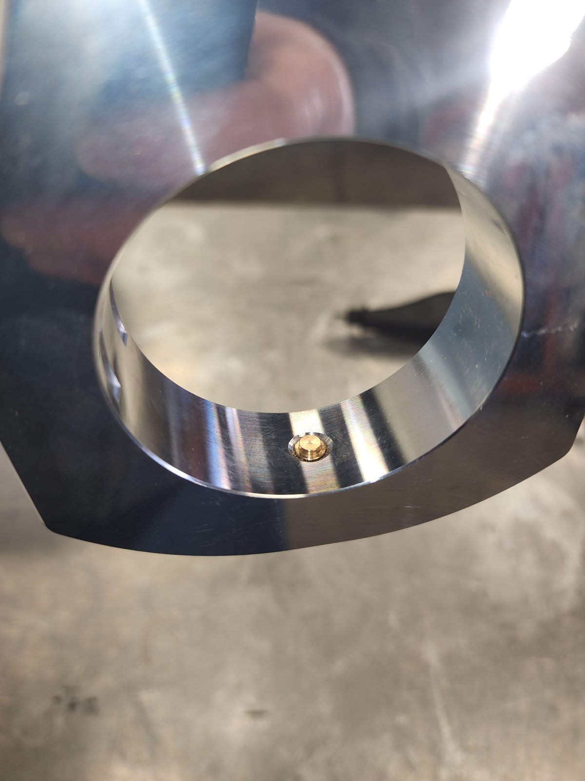

  25. The rods showed up. Time to build a hemi. Speaking of the rods let's take a closer look at what you get for 1700.00 dollars.
    These are cut from plate aluminum.
    They come pin fit.
    They are cam cut to clear the exhaust lobe.
    They are serial numbered for easy re order.
    They can be sent back for re sizing at no cost.
    The bolts are the best ARP makes.
    They are tightened by rod stretch.
    The big nitro pins are used.
    The caps have br*** pins to prevent the rod bearing from spinning. 20240201_160620.jpg 20240201_160732.jpg 20240201_160736.jpg 20240201_160741.jpg 20240201_160828.jpg

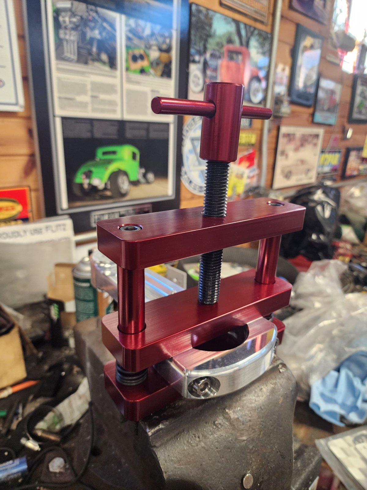

  26. First things first as my mom always said. I number the rods on the opposite side of the cam cut. That way when the rod bearings get changed the numbers are facing outward so it's easy to double check they went back together correctly.
    They come out of the box torqued. It's hard to get the bolts broken loose without a rod vice. The last thing you want to do it clamp them in a regular vice imprinting the jaws pattern into them. 20240201_161952.jpg 20240201_162327.jpg

    My understanding is that castings have no "flow", whilst a forging does. The "flow" gives increased directional strength in the direction of forging (forging also removes some internal voids). The increased strength is good for around 30% over the cast billet that got whaled on by the forge. Plate ally is probably rolled, so would have some directional flow but I ***ume nothing like a forging. It would also not have directional flow "around the bends" of the rod.
    Any idea why plate is used please?

  29. When you say plate are you talking about dinner or something else? Hehe
  30. There are two schools of thought on how rods are made. I'm no expert on the matter but this is what I've been told.
    First up plate material. The grain all goes the same way.
    Forged is smashed to compress the material making it stronger. The grain pattern is not all going in the same direction.
    I have no preference. All I know is these plate rods have not failed me yet. I do change them out each year. The old ones go back to GRP to be checked out.
    Most builders and tuners are much to proud to say the tune up was off or they were behind on their maintenance for a rod failure. Its so much easier to say the rods were junk. Its easier on the ego to. Today's rods are nothing like the rods from even a few years ago. They just don't magically fail. If they can withstand the violence of a 12000 hp engine they will do just fine in everyone else's engines. Regardless of what people's opinions are they work fine on the street. All of your fast drag and drive cars have them. Especially if they are boosted.
