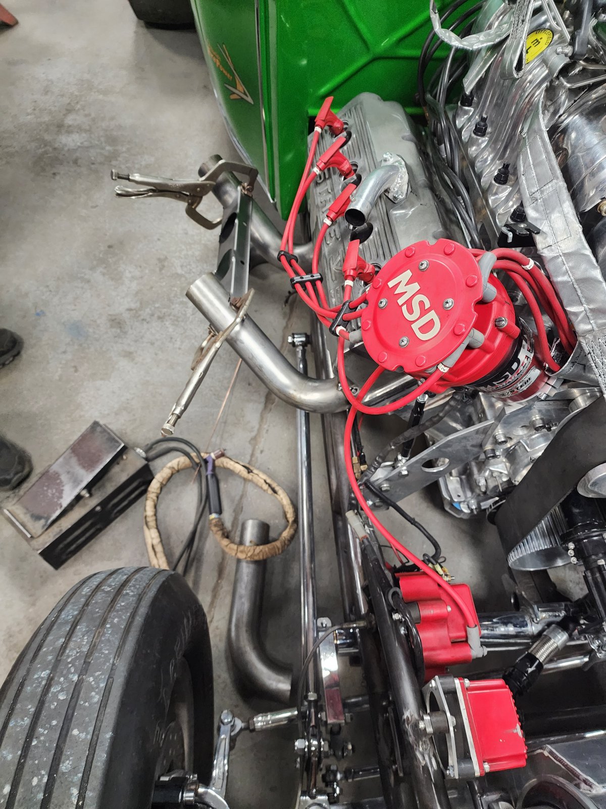

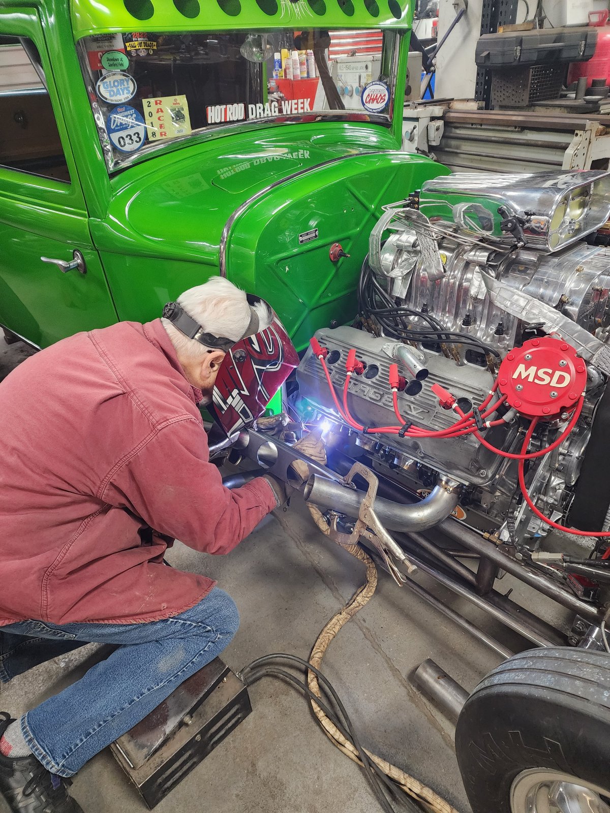

  18. More work today. The zoomies were picked up from the powder coater by a crew member in Chicago. They went on today. They were ceramic coated then tumbled in plastic beads to get the shiny finish. I had them finish the support bars in satin black for contrast. The blower restraint brackets had to be modified alittle to fit.
    The starter was tested out. It's very important to get it set up right. If it's off your hands will feel like you got stung by a hundred bees.
    I need to extend the points box wires going to the coil. Then it's ready to fire. The scoop cover was off of Steiners dragster. A cover with real history. 20240324_162009.jpg 20240324_174023.jpg 20240324_174030.jpg
