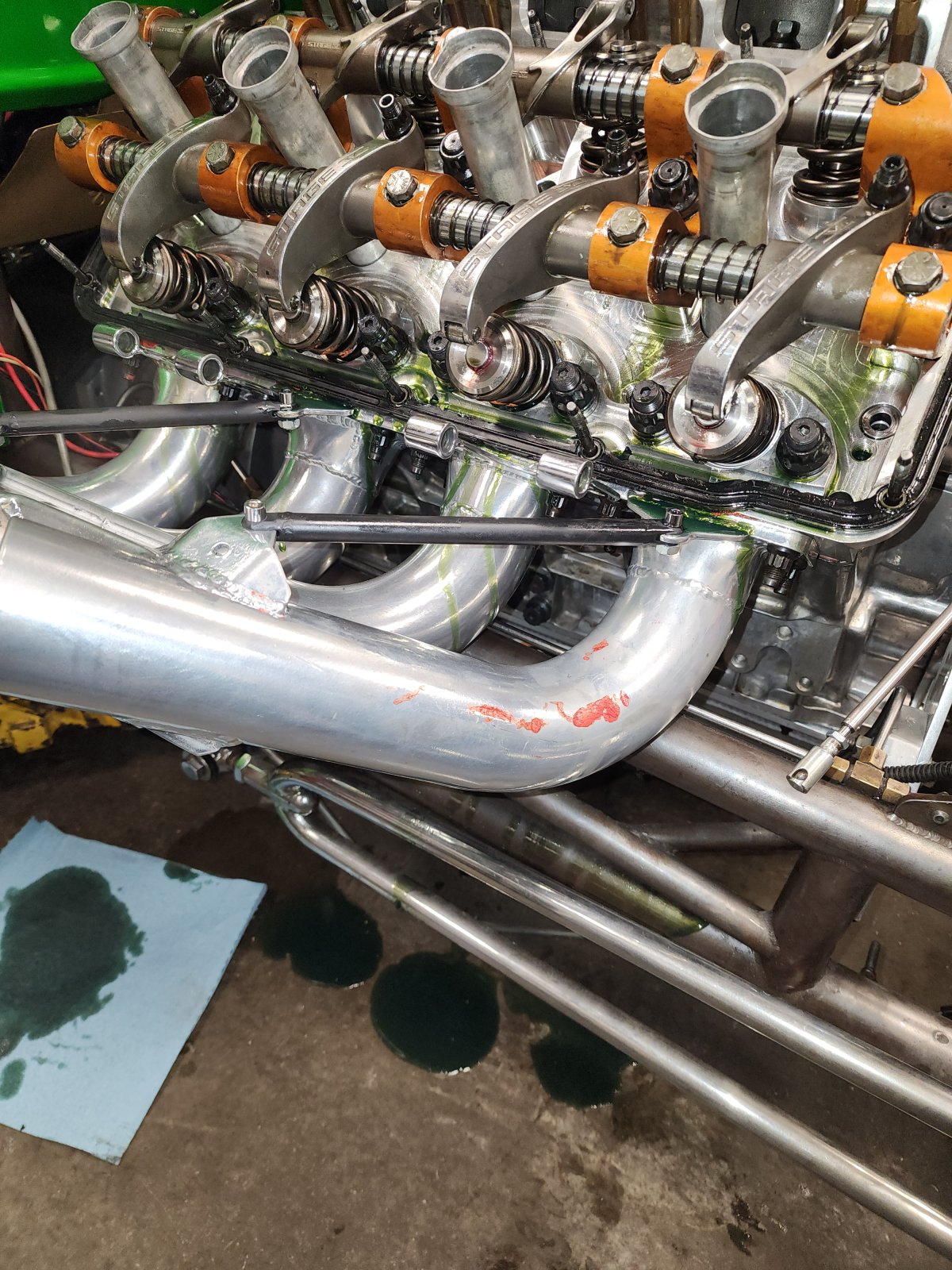

  1. Pulled the heads. Restrictors are not plugged. P***ages in the head are clear. Gasket is good. Digging deeper. I think I will pull the mag. I can stick the pre oiling shaft in the pump and spin it. There will be a mess but I will know if it's a cam bearing issue. 20240330_203004.jpg

  3. I have a kb. The main oil p***age runs down the drivers side. There are intersecting p***ages that feed the mains and cam. The number four cam bearing sends oil upstairs like a stock 426.
    With the heads off I'm going to pull the mag. I will use the priming shaft to see if oil comes out of the deck. No oil it's a cam bearing issue. Hard to believe because it's pinned. If I get oil then it's a rocker shaft issue. I don't remember taking them apart this off season. They are intake and exhaust specific. They can also go in 180 out. Then the oil through the stand wouldn't match up to the hole in the shaft. More to look at tomorrow. I have a plan. I just need another person here to hold the rags while I try to pre oil it. If oil comes out its blasting out. It would be a big mess.
  4. The screw diver points to the hole in the deck where the oil comes out. It also points to the hole in the gasket. The hole in the head that lines up is shown. Lastly the hole in the stand and rocker shaft. They all need to line up. 20240330_213030.jpg 20240330_213035.jpg 20240330_213104.jpg 20240330_213114.jpg

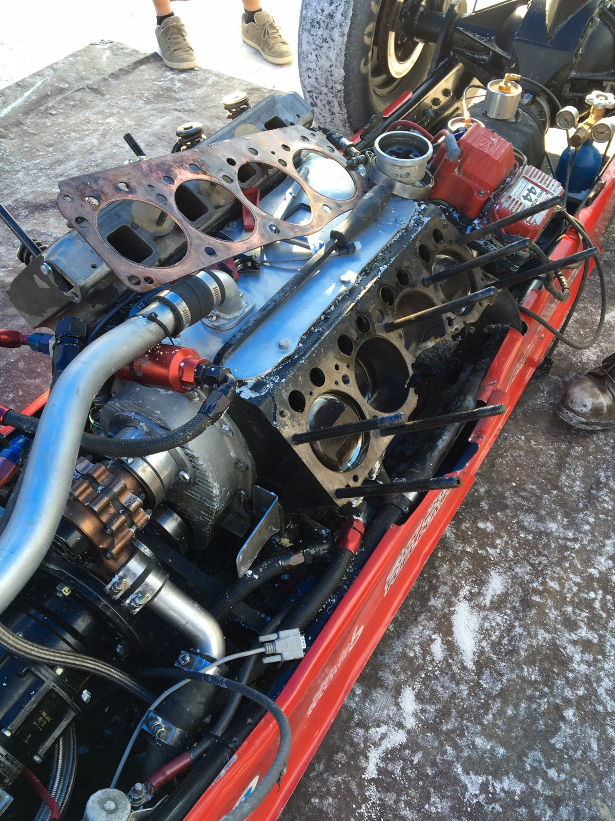

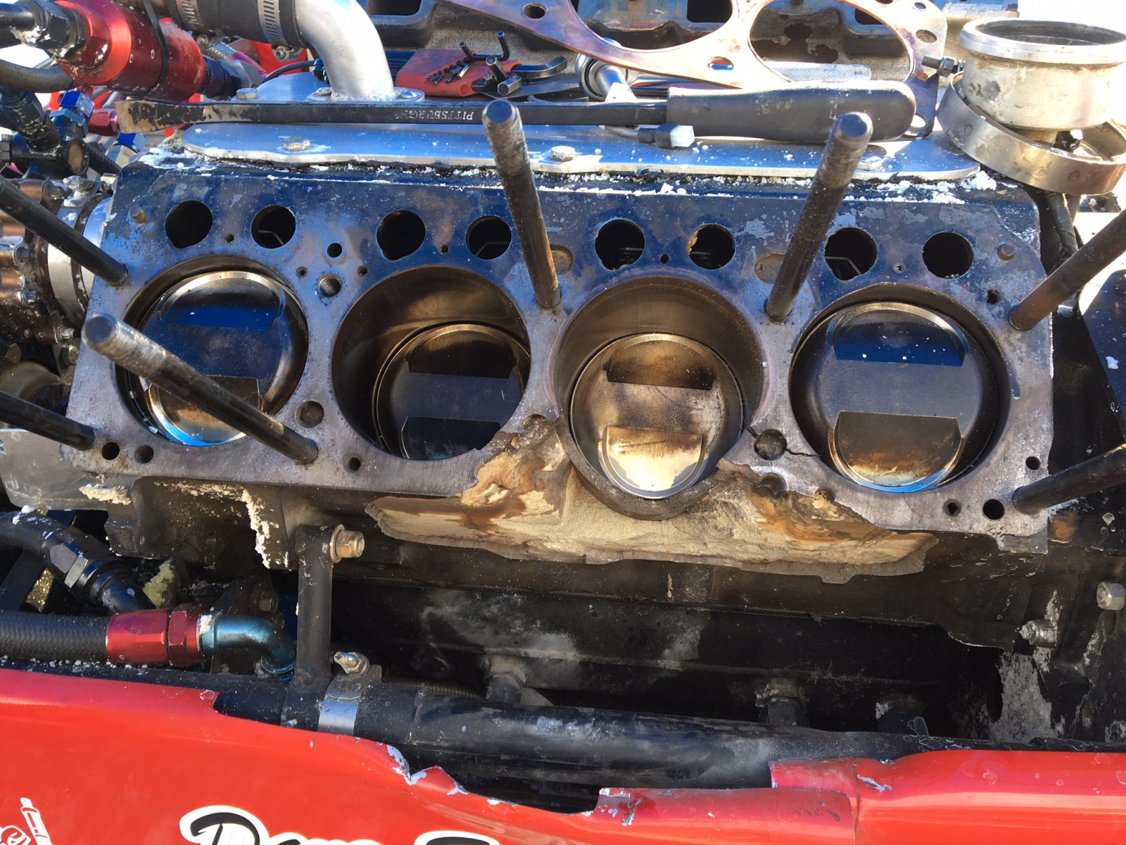

  5. This happened at Bonneville SpeedWeek 2016!
    964878C9-777F-4C12-9C6A-5362242277B8.jpeg FCE3CF00-84D0-441D-AB5A-3BD2CB319297.jpeg
    The chunk of block missing took a guys baseball cap off his head when it hit the brim, and then that piece of cast iron went thru a windshield 100’ away! Nitro!

  6. Man,,,I wasn’t expecting that,,,,when I saw it I literally said ,,,,”goodness gracious “ .
    Man,,,look how thick the iron is in the cylinders .
    I bet that thing is heavy with all that hard block in it,,,,and the concrete really helps the life of the block for sure .
    Yep,,,Nitro is unforgiving !
    Tommy

  7. Alot of verifying today. The head gaskets are double drilled so they can't go on backwards. The oil hole lines up with the hole in the block. The gasket was put on the head and the holes line up with the head. A wire was put through the heads to make sure the holes were drilled all the way through. A drill was used with the priming shaft to verify oil to the decks. The stands were checked out verifying the holes lined up. So far no explanation found.
    For tomorrow's fun. I drained the oil. The pan is coming off. The number four main bearing will be pulled. Air will be blown in from the side; top and bottom. Just in case there is a chip causing a restriction. The rod bearings will get checked to. The filter will get cleaned. It will be re***embled to try again. 20240331_135102.jpg 20240331_135102.jpg

  12. Demons be gone it's cured. I pulled number four main cap and upper bearing. With high pressure air I blew it down the holes in the deck. While this was going on I was rotating the engine to line up the holes in the cam bearing and the deck. A noticeable tone change happens when they line up. Both sides were done several times. I didn't find any junk that flew out. I re***embled the engine. I used my 5/8 drill this time for more power running the pump. The 1/2 inch drill can stall. I usually don't like a oily mess on the floor but this time I'm OK with it. Oil is pouring out of the rockers. I will put the pushrods back in and reset the timing. We will try again this weekend with a nitro fire up 20240403_203824.jpg

  14. I had to have blown something out. there was a noticeable change in the sound of the air blowing through. The flow of oil now is great. I really don't want to pull the engine apart. It's all good now so we will monitor it very closely.
