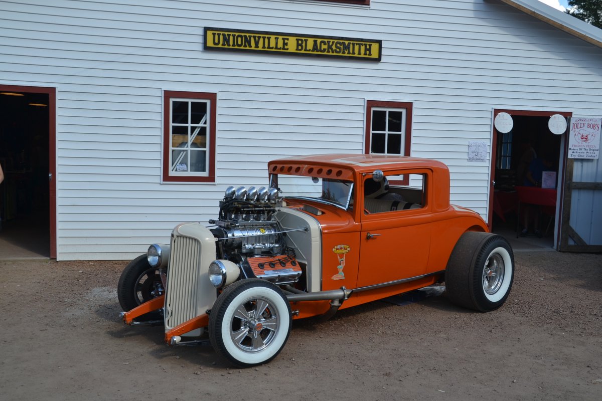

    I'm glad to hear you came out of it ok Brian that looked like it was a hard hit. As you know your coupe was/is one of my favorites and while I'm sort of sad we will not be seeing the car rebuilt "show coupe" style I'm excited to hear a new fuel coupe will be hitting the streets sometime soon. Sorry again about your loss but happy you weren't badly injured. DSC_0547.JPG

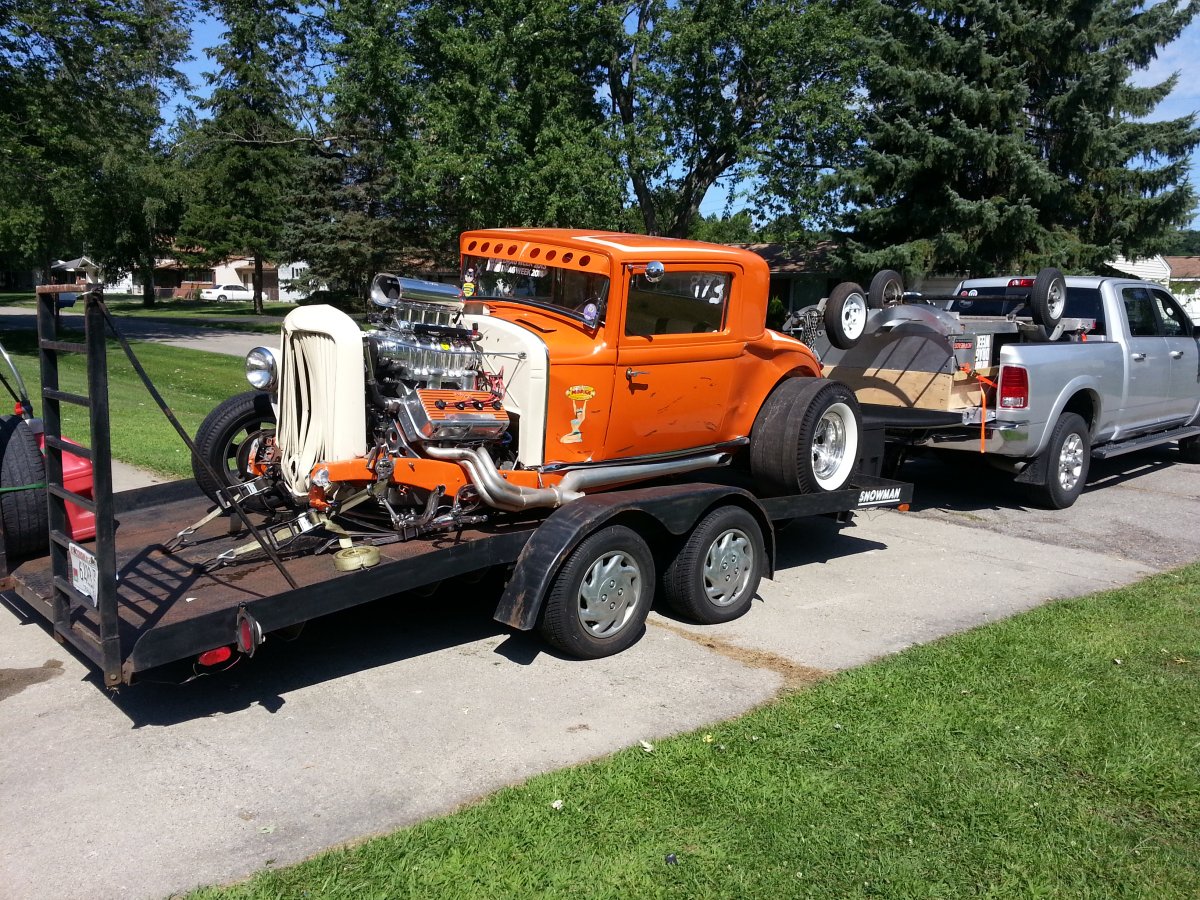

  11. This pic was taken at my sons house near detroit. The carc*** is loaded up ready to come home. We used the trailer winch and two jacks. 20150815_112903.jpg

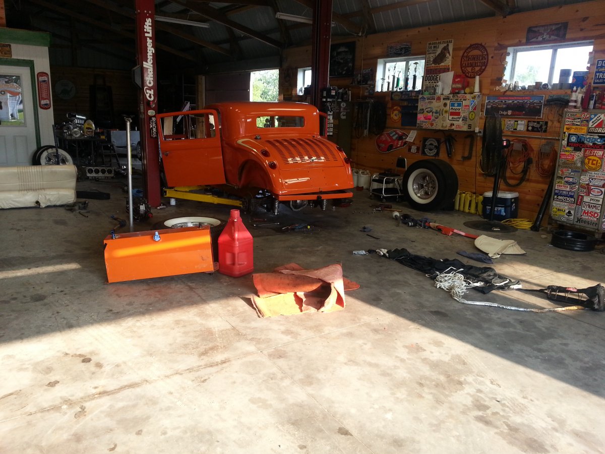

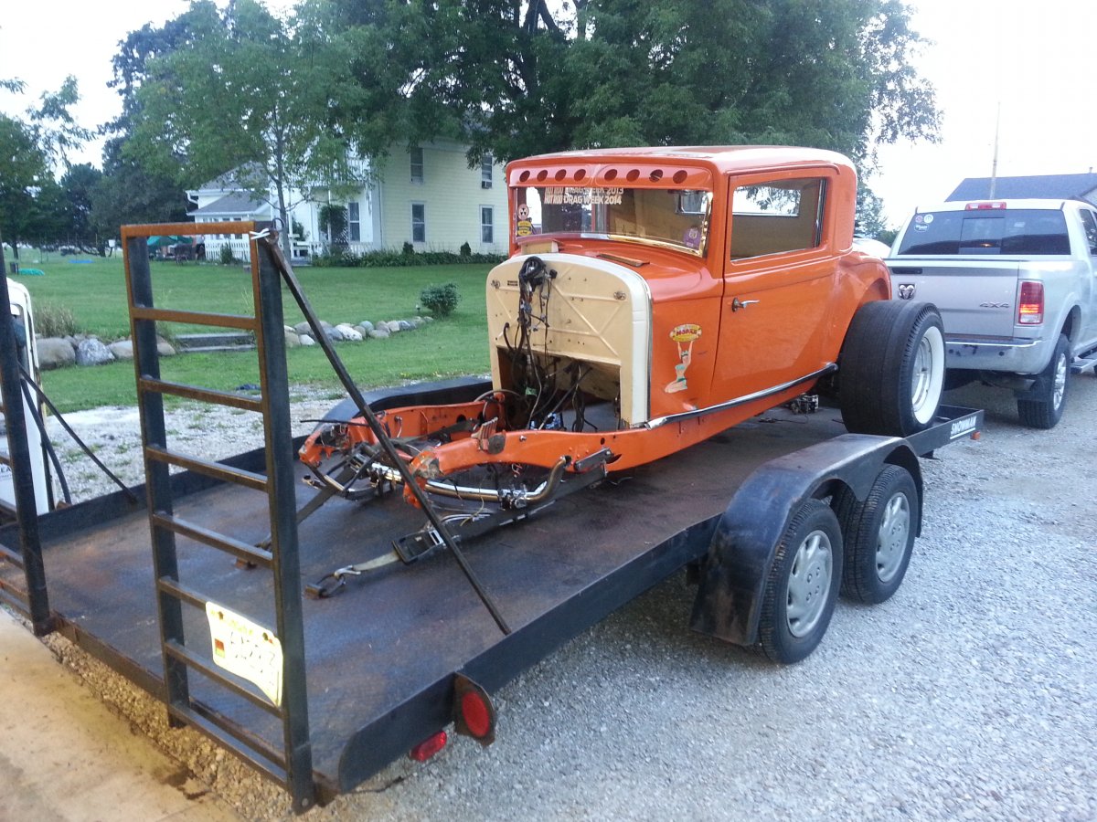

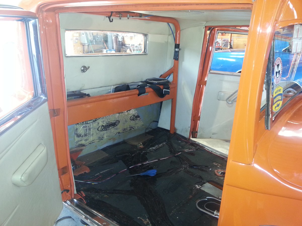

  14. Seats and roll bar were removed along with the battery and gas tank 20150901_172508.jpg
    els and volvobrynk like this.

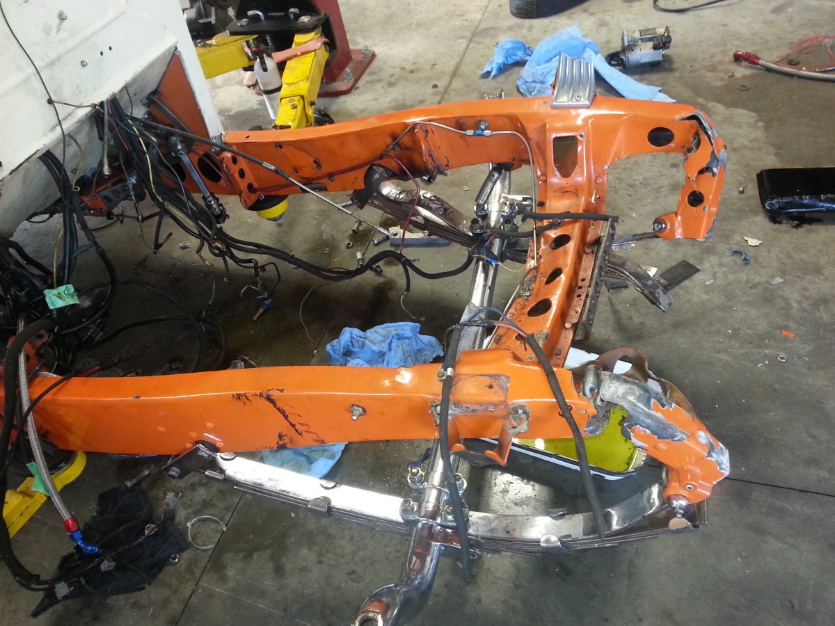

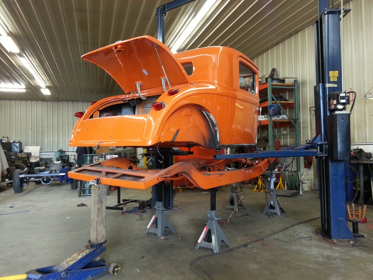

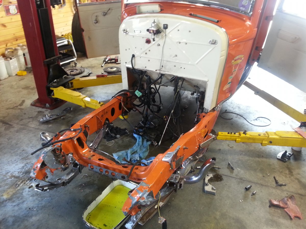

  17. The body is off the frame. The frame is for sure junk 20150910_154646.jpg

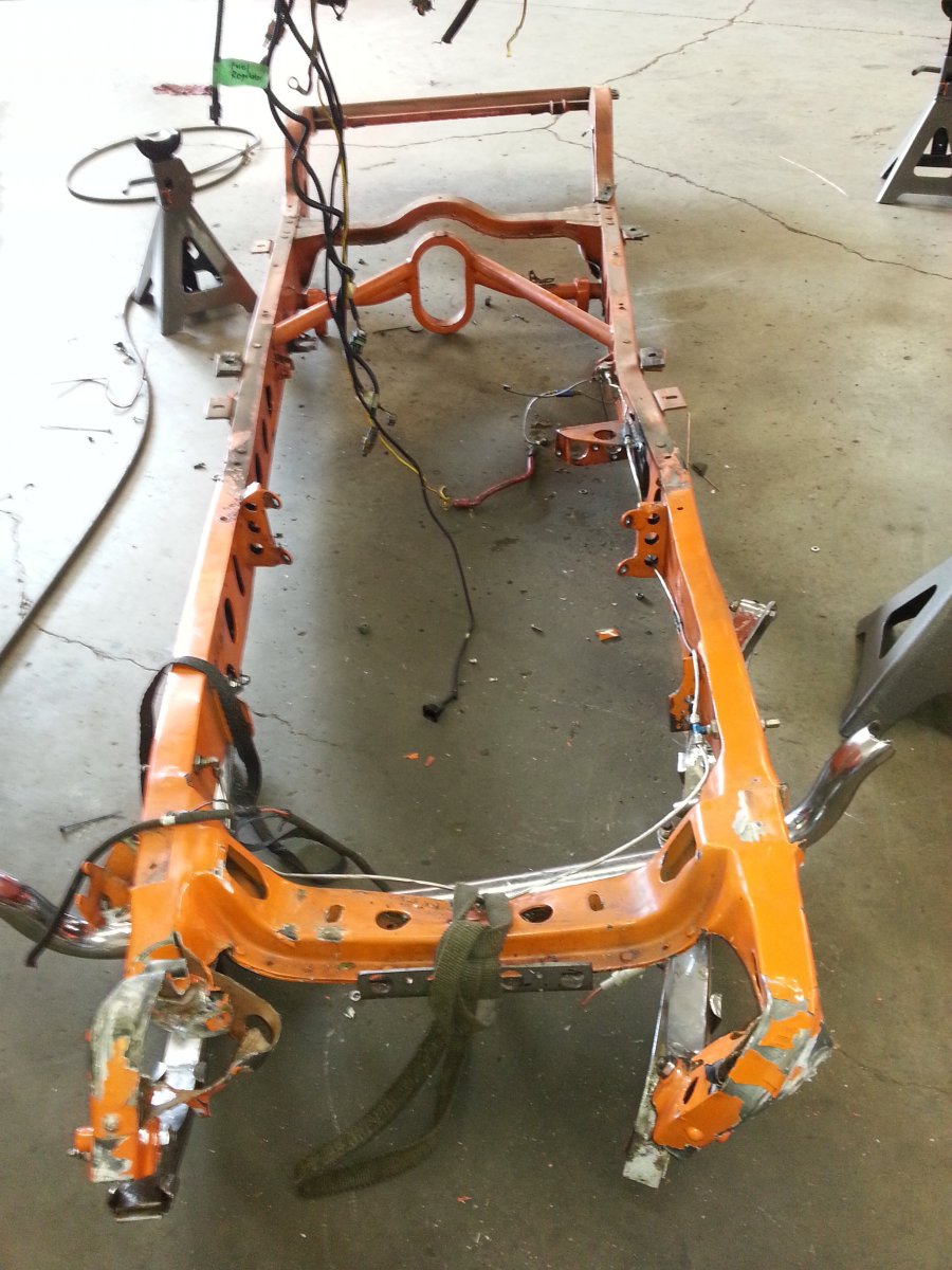

  18. Here you can see the trashed mid plate mounts and how they bent. The drivers side frame rail is bent and rolled over 20150910_155014.jpg

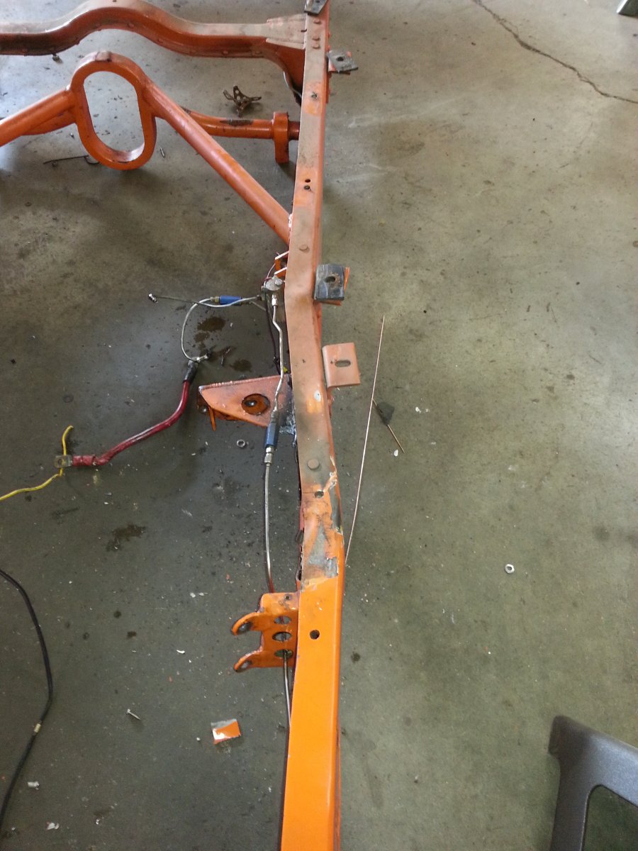

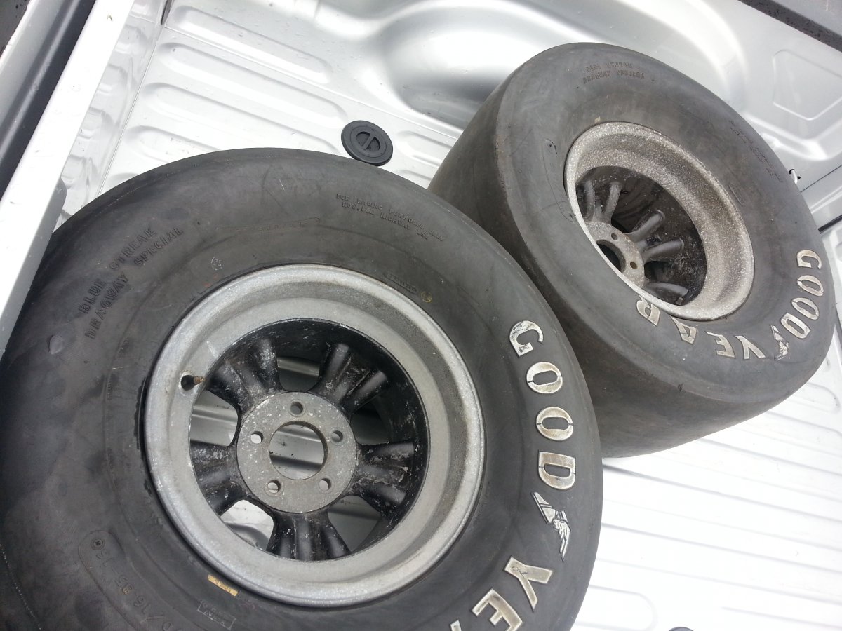

  23. These followed me home from the cleveland area. They were on a fuel altered out there. The wheels still had the goodyear blue streaks on them and still hold air. They have been dismounted now. Both front and rear wheels are at the polisher. 20150904_145812.jpg

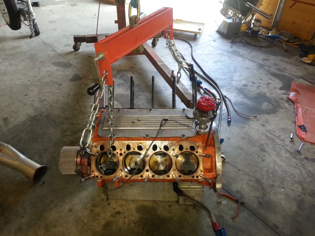

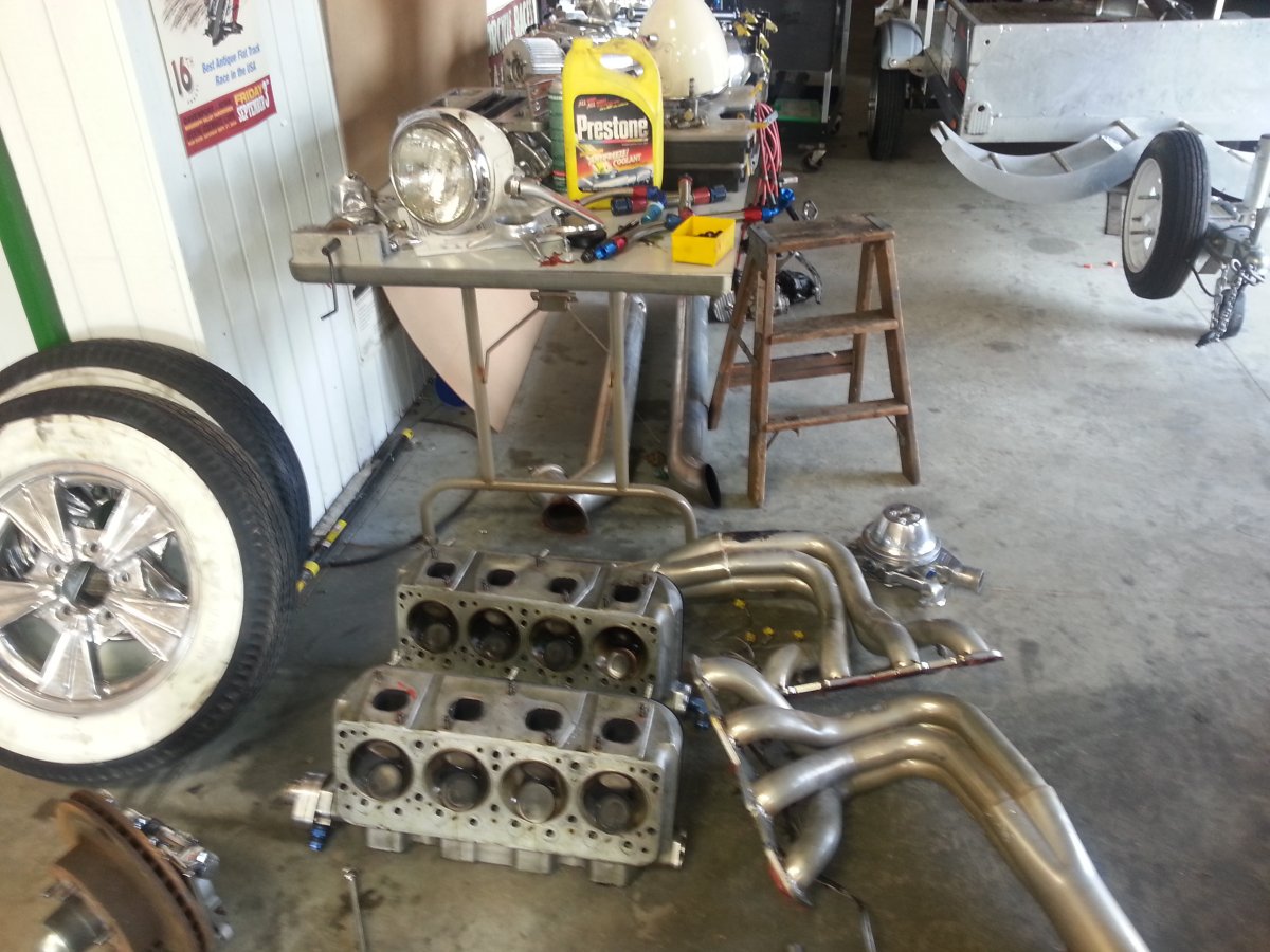

  24. The engine is apart to check the thrust. When the engine moved forward the lowee pulley hit the cross member. I think i should take a look while i have time. you can see some of the dents in the headers. they have been dropped off at a friends house. when that come back they will be perfect. 20150901_172432.jpg

    man. Looks like they are pushed up a bit too??
