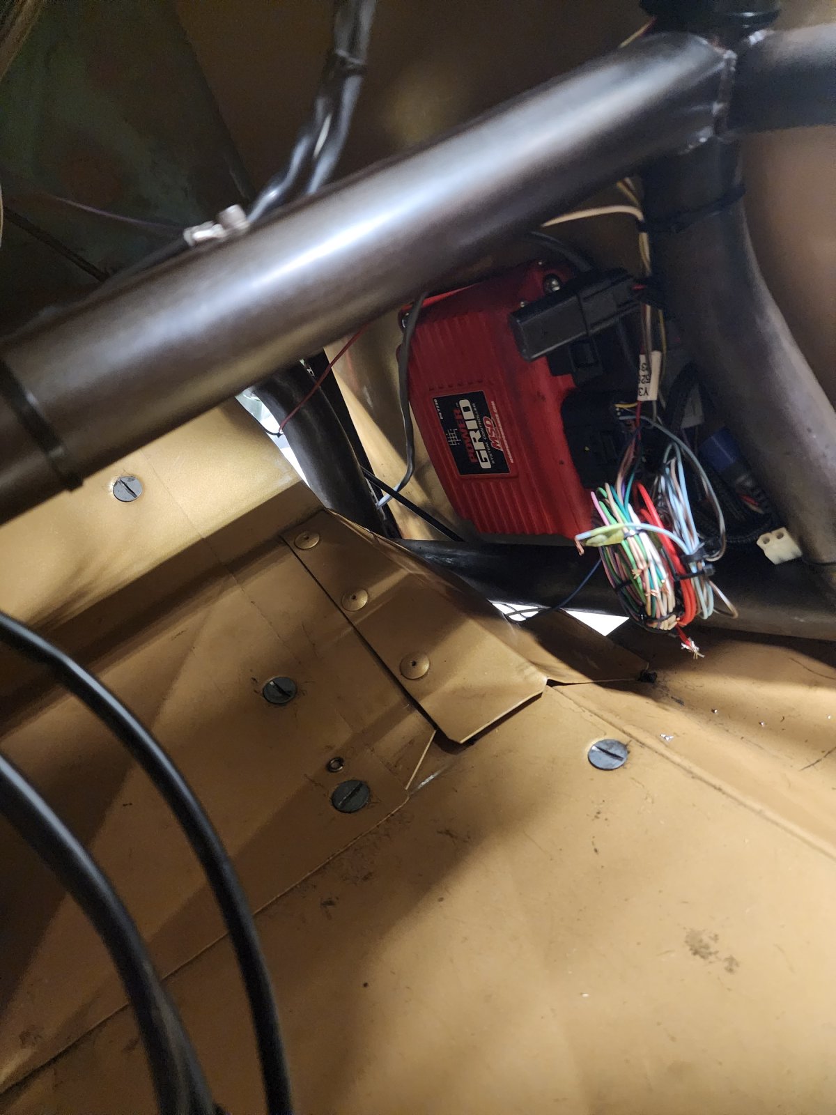

  25. The new grid is installed. You wouldn't think installing the box and connecting 7 wires would take all day but it did. Each wire was soldered. Marine grade shrink wrap was used to cover the joints. This is a much better way to do things. Solderless crimp connectors are not a good idea. A tip here Harbor Freight actually has the best shrink wrap around. They offer two kinds. Regular and marine grade. The marine grade is twice as thick.
    This box is designed to start the timing map at the release of the trans brake. At the hit the engine has full timing to hit the tires. A pre programmed timing retard then starts. This is how fast cars don't blow the tires away. The timing is ramped back in over the next 1.5 seconds. This box data logs. On the screen the line looks like a square root sign. More on that later. The new technology of these boxes is amazing. Its a whole new world. 20240523_220027.jpg

    Does the marine grade have a glue inside of it also ? I've used other brand marine grade with the glue inside and it's great stuff.

  27. If you're having issues with crimp connectors, you're not installing them right.

    I do the same,Crimp and solder, even weather pack witch rolls & crimp.
    Especially on race cars stuff (machinery ) with a lot of vibration;)

  29. That's the very last place you want solder. Again, if you're having issues with crimps, you're not doing them right.
    Field-installed solder connections have been illegal in the electrical industry for well over 60 years for safety reasons.
