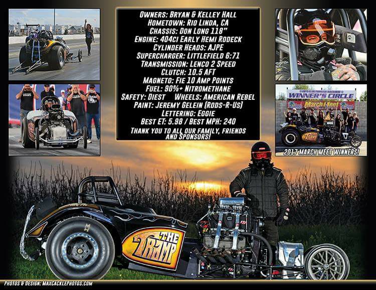

    Bryan Hall went 5.98 @ 240 in the Tramp without retarded looking wings, spoilers, or canards. Brian doesn't need them either.

    Pull Brains 30-31 MOPAR body the way it is , Mount on The Altered/ Fc ch***is shown , will not Act , handle , go threw air the same way,
    Watching Norwalk race , seen a few
    T/Fc windshield start to cave in again .
    I went 220 25years ago my self with a ch***is like shown
    125 wb NHRA/IHRA A/Fc piping
