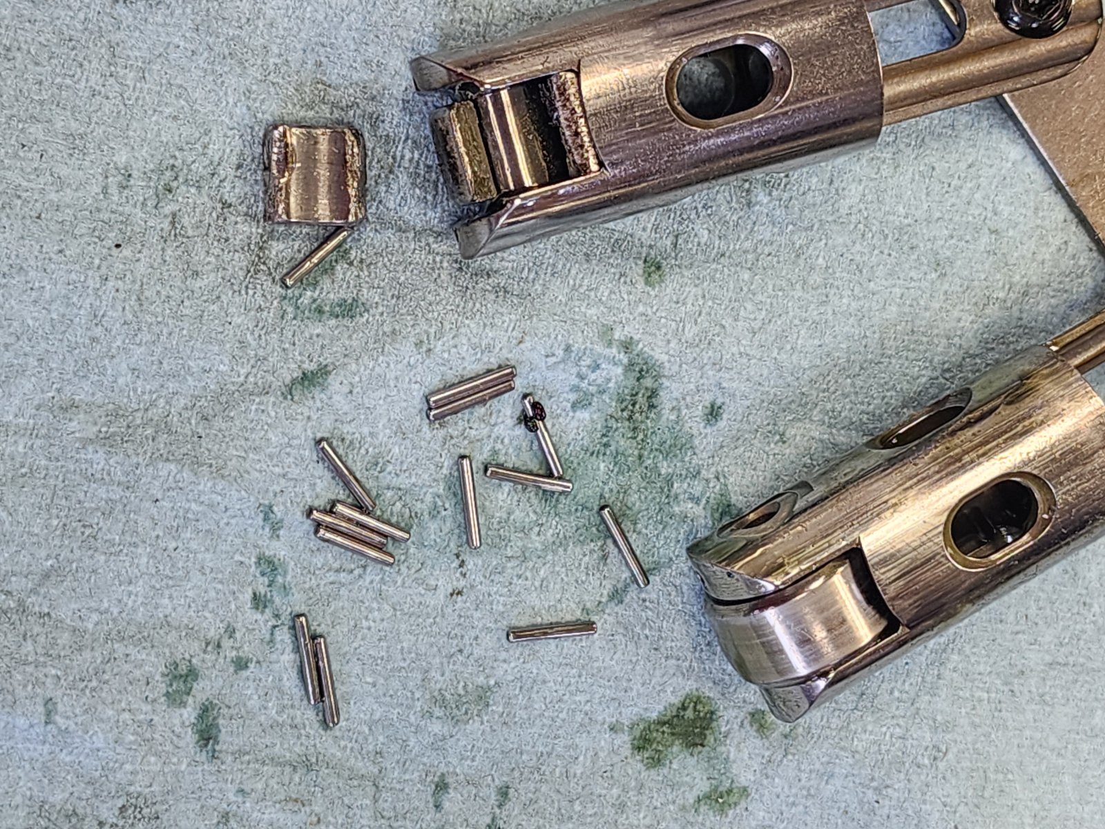

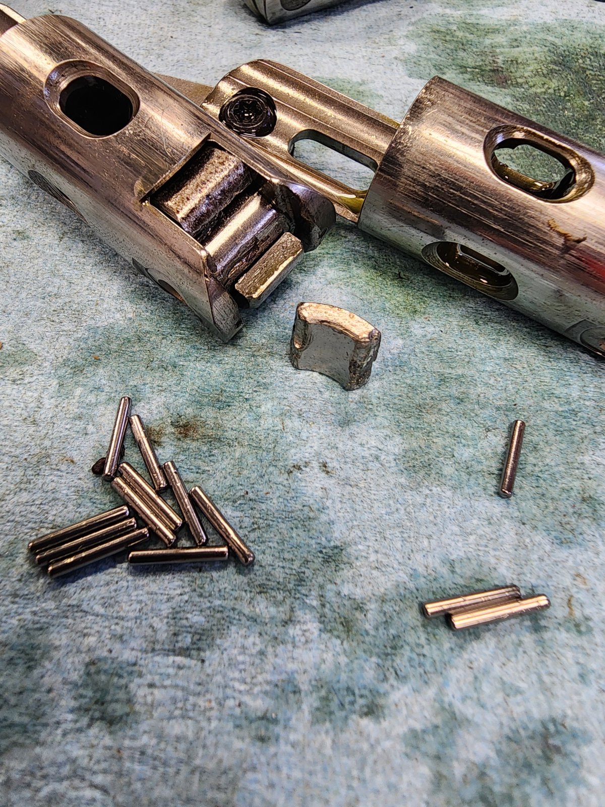

  6. I have talked about the importance of regular maintenance. While changing rod bearing which by the way looked great I found needle bearings in the pan. They can only come from a lifter. Those following this thread know it was a broken lifter that led to a hole in the block and a snapped cam. Looking up into the engine I could see all 16 rollers. Tuning the engine over there were no loose lifters. Things that make you go hmmm. The intake came off to pull out lifters. I found number two exhaust had a piece out of the wheel. This prevented a repeat of the same kind of disaster. The cam looks good. It wouldn't have lasted another p***. The lifters were comp cams. They can't handle the spring pressure. I have spares but I won't be using these again. A set of morels will go in. They do require new pushrods. 20240704_171500.jpg 20240704_132945.jpg

    All the lifters have body wear/galling like those two? Bodys don't look that hard/hard enough?

  16. The comp cams lifters are good. I just need better. It's all about the spring load. Installed they are 400 lbs on the seat. At open they are over 800 lbs. A typical street car that's hopped up might have 90 lbs installed.
  17. The galling on the lifter body is really the light. Yes there is some. The flash makes it look much worse than it really is. Nitro motors have alot of trash going through them even with the oil changed after each run. Piston skirt and bearing junk is most of it.
  18. Wouldn't the most likely way a lifter wheel could fail like that be from bouncing on the cam?
  19. They all bounce. Big springs help stop that. The drag and drive cars set lash at 0 to make them live on the street during long drives just for that reason. There is alot of violence going on in that engine.

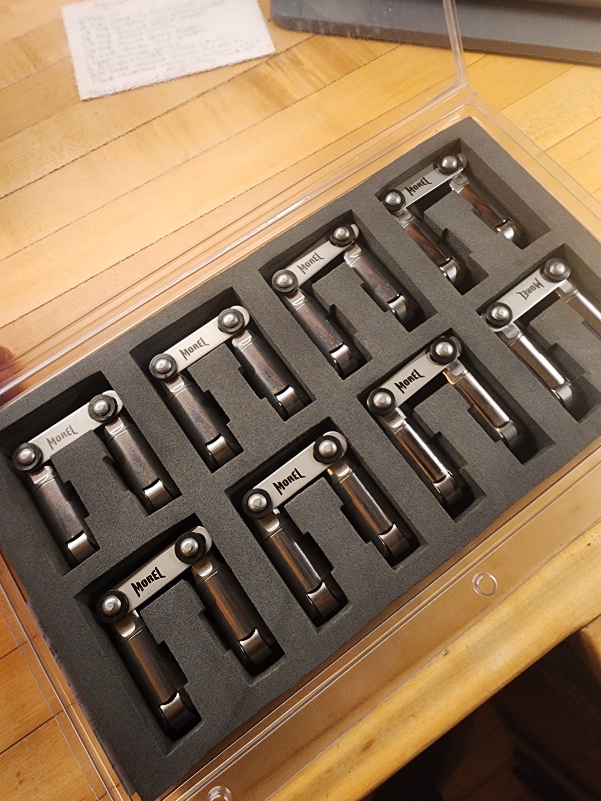

  22. This will take care of the lifter issues once and for all. Morel is the best out there. They are re build able to. The foam case they came in was cool.
    I pick the car up from Brian Metzenheims ch***is shop tomorrow. 20240711_204512.jpg 20240711_204518.jpg

  24. Of course the new lifters require new pushrods. I have a Manton mock up pushrod kit. You put together a push rod that is the correct length. Then it's sent in to manton. They will send back 16 pushrods exactly the same size. They etch the length into the rod for easy re ordering. When you start using premium parts it shows.

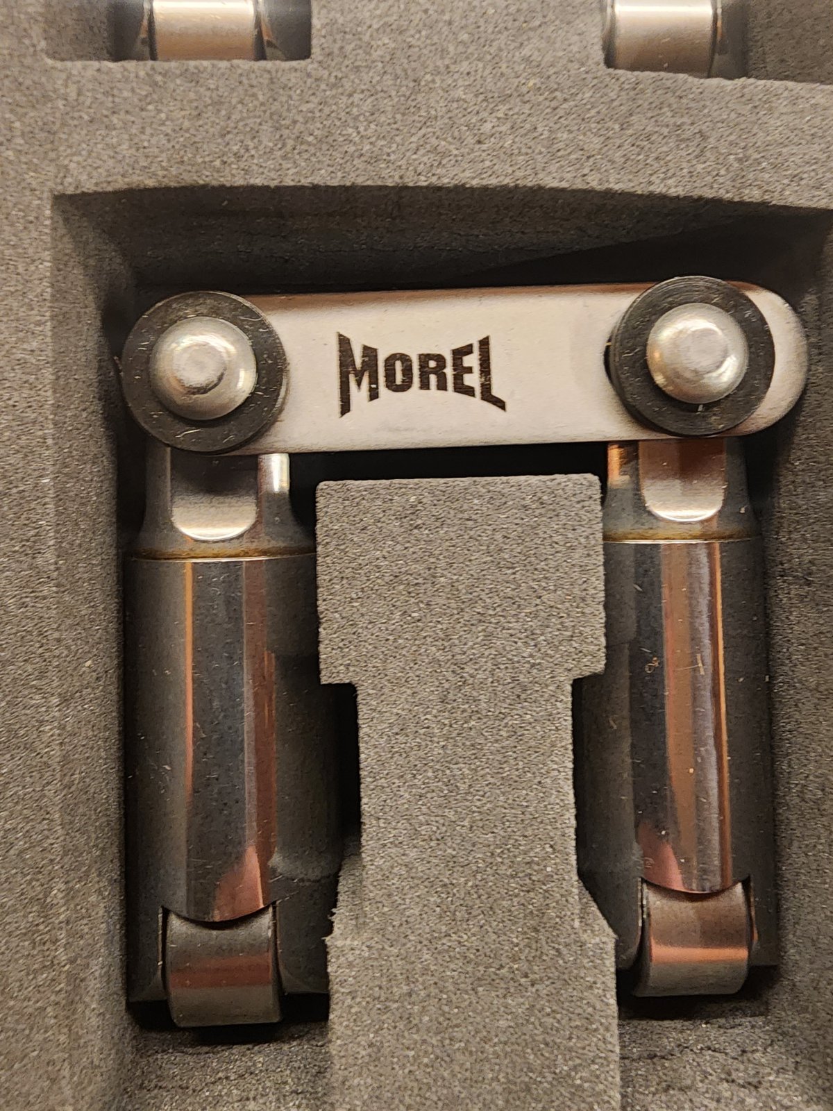

    Maybe it's just the pic or the lighting but why does the last pic, left lifter look beat up and dinged up especially the roller? Ive never had a roller valve train before, so correct me if i'm wrong, but I expected them to look smooth as gl***. Is it not that significant in this situation?

  28. It's the lighting. They are new and perfect. Going in the engine today after sitting in a container of oil overnight.
