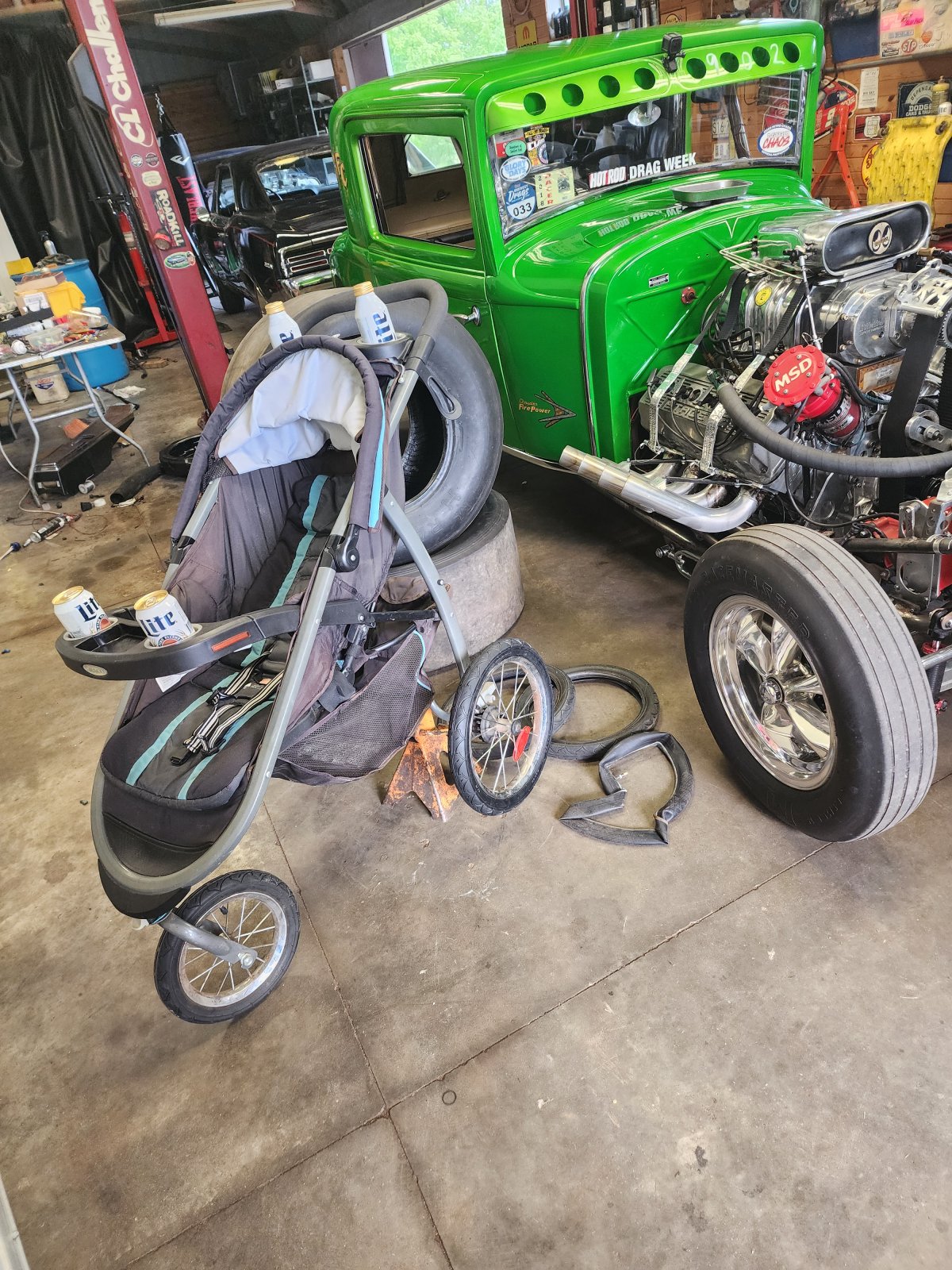

  9. New tires for the race car. New tires for the stroller. Grampa has it going on for the 8 week old grandson. 20240721_173510.jpg
  10. 427 sleeper
    Joined: Mar 8, 2017
    Posts: 3,367
    427 sleeper
    LOL! I had a Grampa like you!!! It was the BEST TIME OF MY LIFE!!! :D:D:D Memories are being made that you don't even realize!!! You're too Friggin' Cool Man!!! :cool::cool::cool:
    Thank You for letting me relive some of the things my Grampa did for me. ;)
