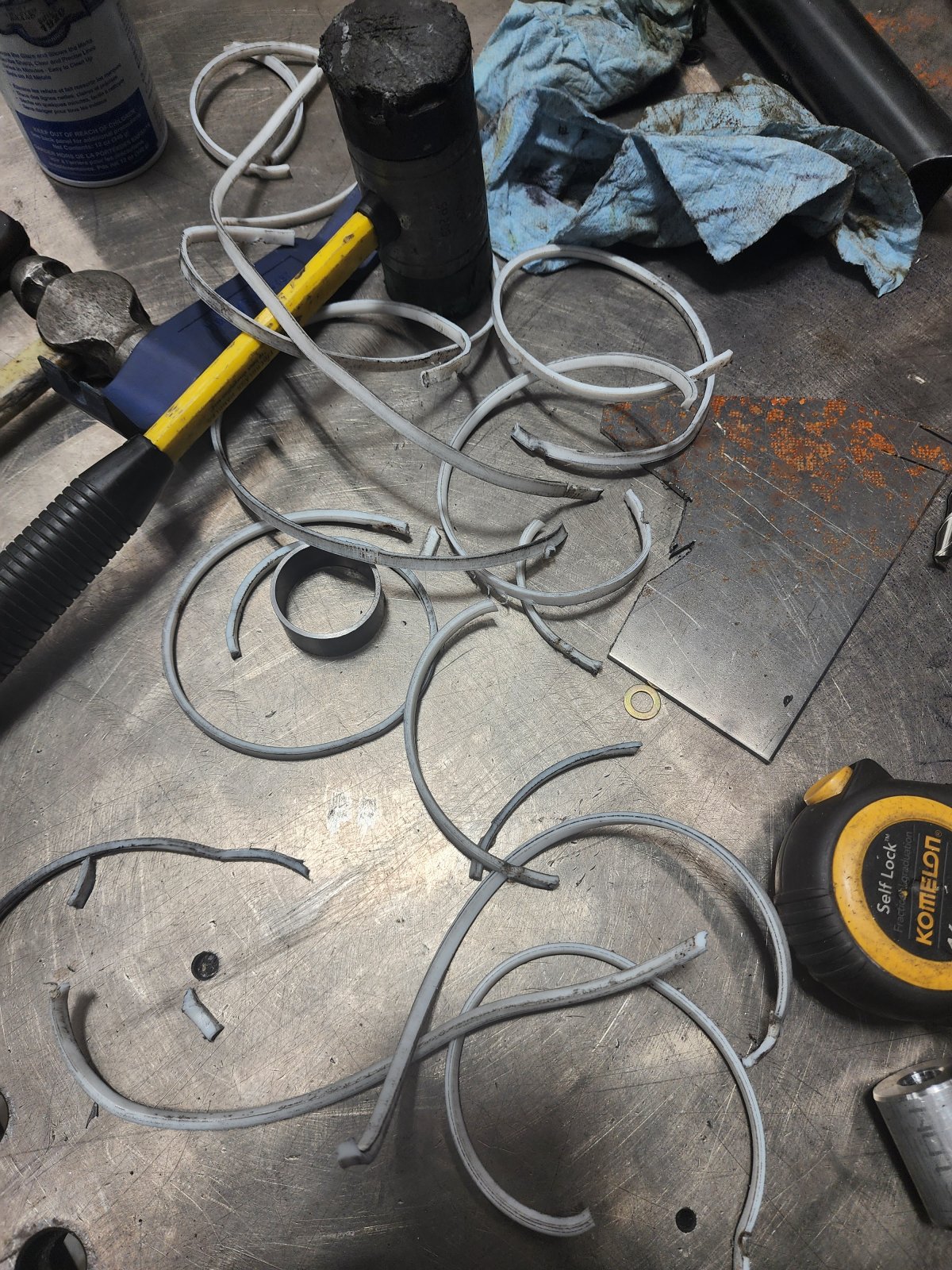

  2. To get to 200 mph I need to tune up the blower. This involves taking it apart and restripping the Teflon strips.

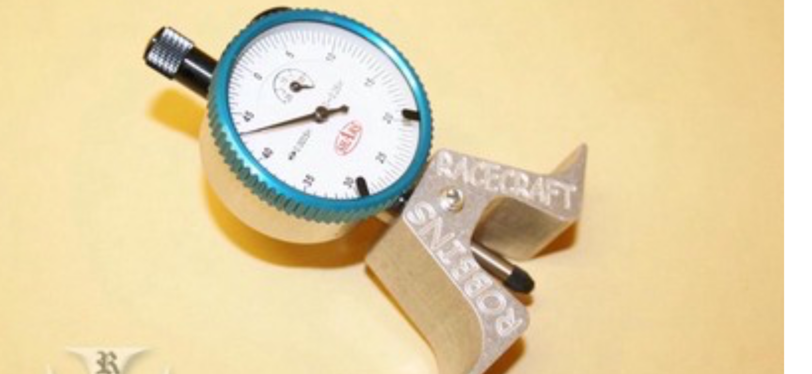

    The blower has two very different styles of strips. The black strips are very hard. They seal to the case. The case needs to be measured first. New black strips are installed. The rotors are put in a lathe then cut to fit the case. It's a involved process to get it right. It doesn't need to be done very often.

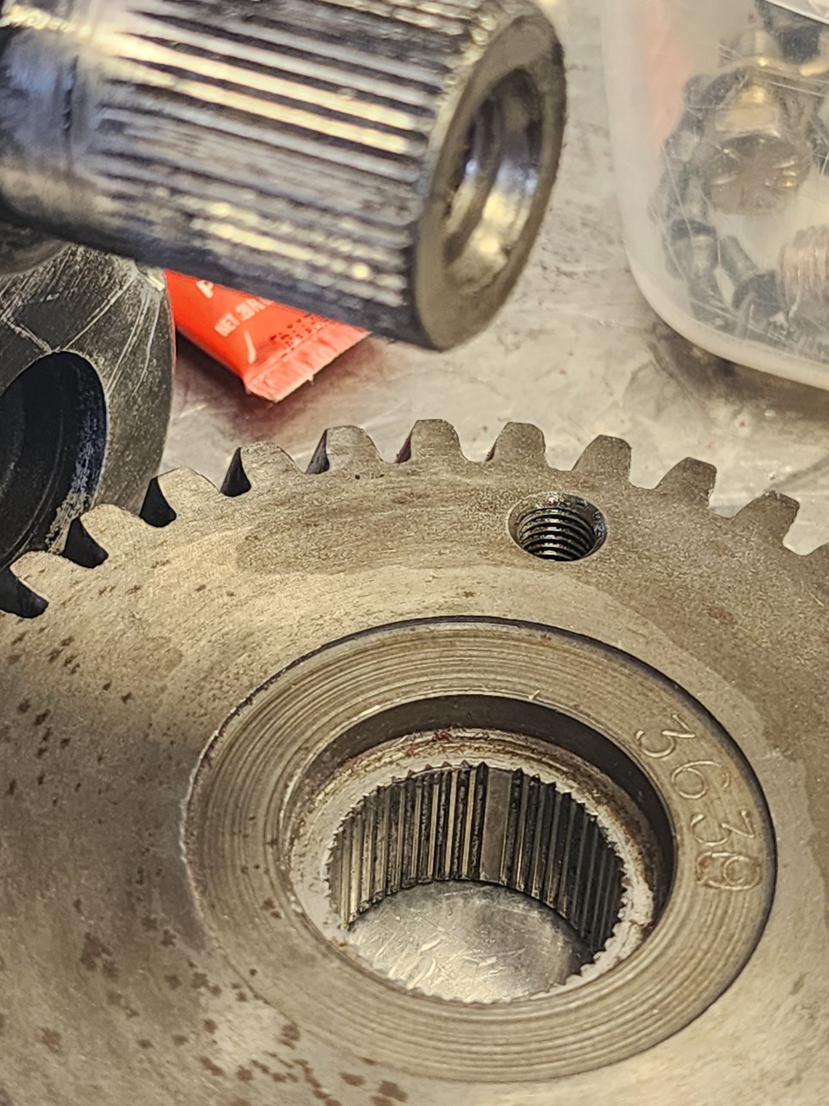

    The white strips are teflon. They seal rotor to rotor. There's two per rotor. This is were the magic happens. A good street blower will have the black. The problem with whites on the street is it creates alot of heat compressing air. The other issue is it wears out fast. A few street miles and it's done. Big show nitro cars restrip every p***. A crew guy is dedicated to the blower. As the whites wear the tune up changes going richer due to less air. After a restrip the tune up is richened do to more air. On my car after a few p***es it will wear a little and maintain a max boost. When the boost starts to drop it will get restripped.
    To do the work a special gear puller is used. The gears rotate as they are pulled. Before dis***emble the rotors are marked rt and lt. Punch marks are made on the gears so it's timed correctly.
    The screws on each end are removed. A small screw driver flips up the strip. A pliers grabs the strip and it's pulled out.

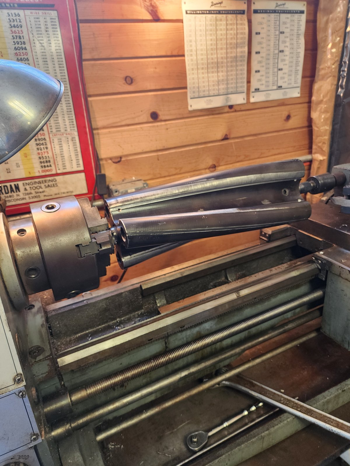

    Wd-40 is sprayed in the groove after cleaning. Putting the rotor in a lathe set in neutral goes a long way to get this done. They don't just slide in. A new strip is pulled into the groove. It's cut off leaving a extra inch on each end. The strips stretch. They sit for a while then a soft mallet is used to tap them in a little more. The screws are put back in. Then a razor blade cuts them off perfectly even with the end of the rotor.
    I stopped at nitro dragster driver Tony Zizzos shop. Tony drives the Rustolium sponsored car. I was there to borrow his puller. I didn't need my own because I would send my blower back to Littlefield every two years. That's going to change. Next week we will be making our own. A rotory table is needed. A print has been made. This is hot rod stuff here. I will cover the machining process next week. I talked to Littlefieldyears ago about the rub marks on the rotors. They say its onlya cosmetic thing. It makes no difference. The strips are doing the sealing not the rotor. 20240802_093429.jpg 20240802_093432.jpg 20240803_092003.jpg 20240803_092018.jpg 20240803_092027.jpg 20240803_092137.jpg 20240803_092145.jpg 20240803_092246.jpg

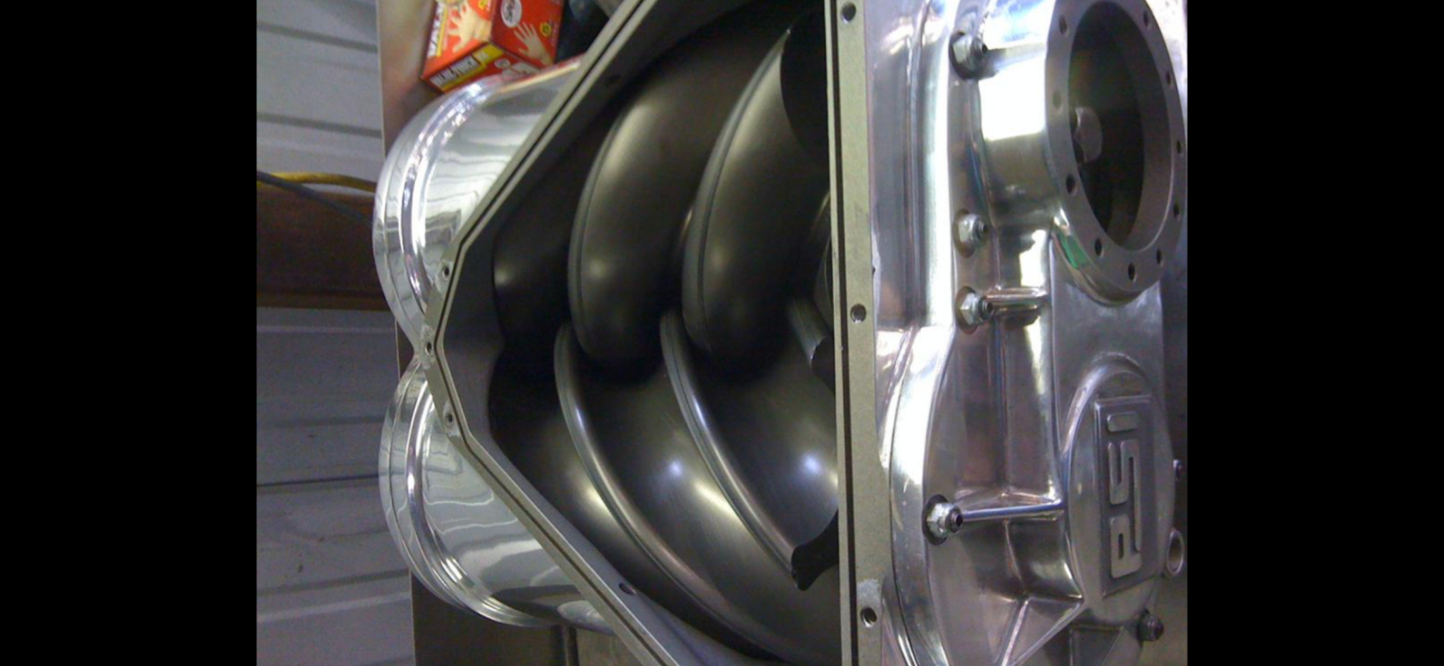

    Something that the casual fan and/or hot rodder may not know, is that the rotors spin away from each other, moving the air around the outside, not down the center of the two rotors. In the photo of the top of Brian's supercharger, you will notice a screen. OEM supercharged Detroit engines used those for many reasons. Not many hot rods or inexperienced racers use them. That is asking for trouble. In the photo below is the result of a mounting bolt backing out of the inside of an Enderle Birdcatcher, and that team was not using the supercharger screen. The result was the bolt getting pinched between the rotor and the case, and the rotor won. What results next is a m***ive intake leak, which sends the RPMs to the moon, and the engine doesn't want to shut off. There was an instance like this recently that happened to a funny car backing up from a burnout. The result was a fatality. Brian immediately installed a screen to his supercharger after it was known what had happened. At the end of the day, you don't know what you don't know, and sometimes that gets people hurt.

    If I understand correctly, the black strips are removed, new ones put in, then the rotor ***embly is machined down in a lathe, cutting back the black plastic until it is a tight clearance to the case. I ***ume the case is measured beforehand, with the rotor in place, using a vernier (?) between the rotor face and casing bore. How tight a clearance is aimed for?
    The white strips get pulled out, and new ones tapped in. Do they get machined down too, or are they "close enough" and get clearanced by wearing in?

  13. Harv you got it.

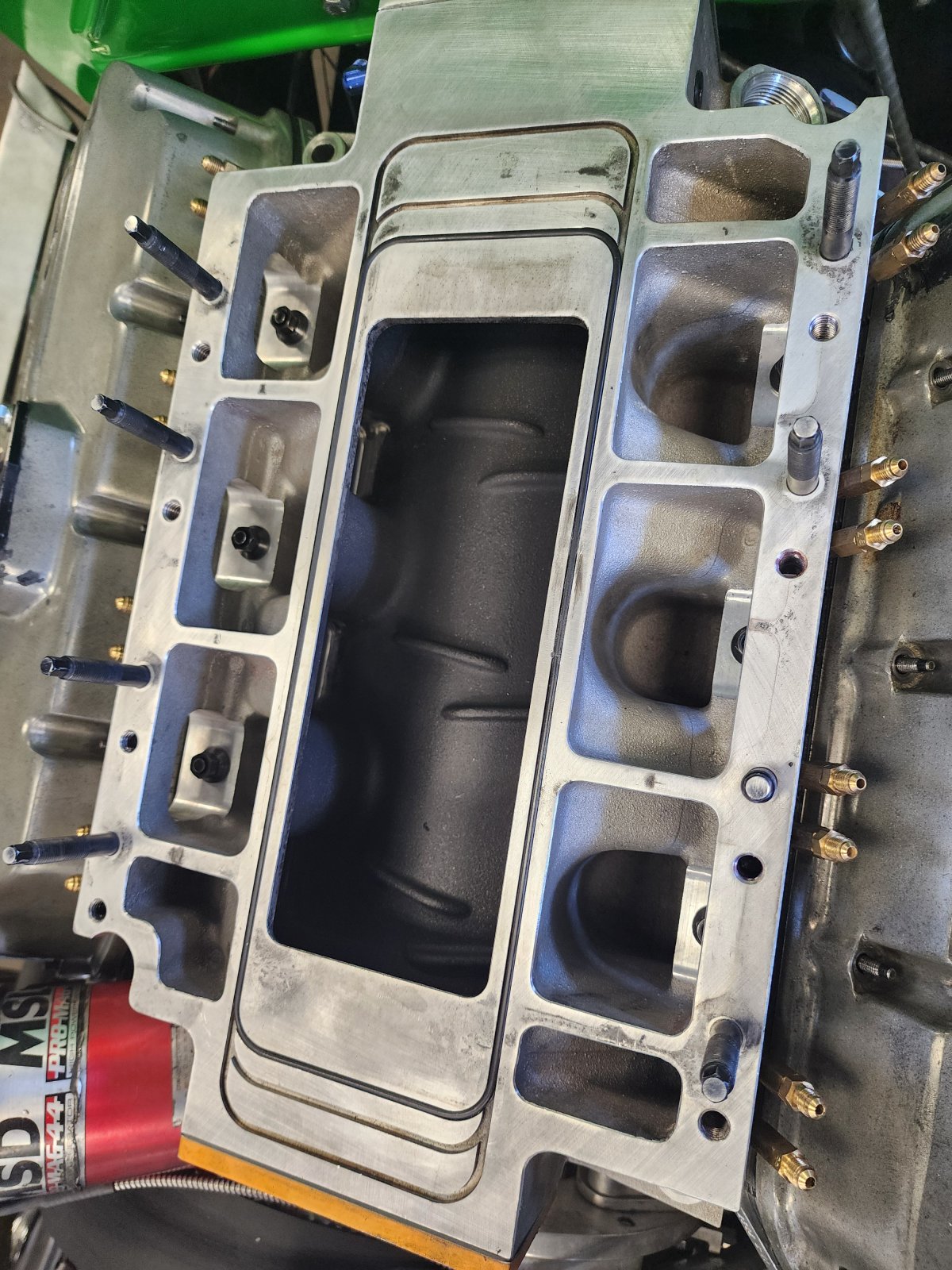

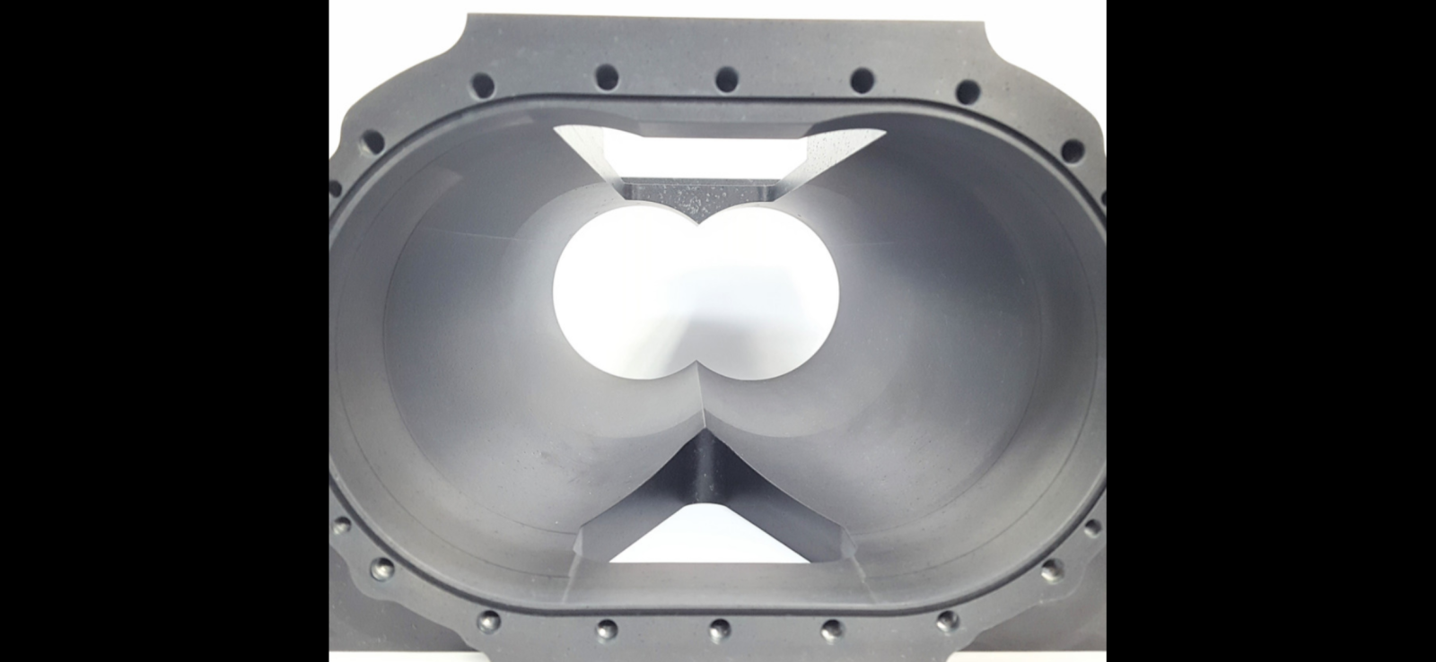

    13Eddy30 my blower starred out as a retro case gas street blower. The retro case has the small pie opening in for the rear exhaust port. This provides more stability for the rotors in the rear. It also decreases the exhaust area increasing the pressure. Last year I added the white strips. The only thing left to do is add high helix rotors. I'm holding off on doing that because if I go back to street driving they will create too much heat. My blower when fresh creates 35 lbs of boost driven 20 percent over. That's all I need.
  15. Seeing that we are in pretty deep on the blower rebuild let's go a few steps further. The gears and rotor shafts can only go on one way. The splines dictate this. Before dis***emble I punched the gears two/one for easy retiming. I'm just waiting on the strips to show up next week. The first rotor is in the lathe ready to go.
    I mentioned the bottom of my case. This is referred to as a retro case. More pressure. More support.
    The manifold has a extra pattern drilled into it. I use the rear pattern. By doing this the distribution is cleaned up. The front cylinders get more air than the rear. To straighten that out the front nozzles are richer. Moving the blower back decreases the stagger so all eight are running closer to the same power output. Look at a modern top fuel car. They are really set back. My buddy Roger that I go see in Iowa invented this idea years ago. It took a long time for other teams to catch on.
    The manifold uses a o ring to seal. There are three patterns to allow for different size blowers. 20240804_134634.jpg 20240804_134704.jpg 20240804_134800.jpg 20240804_134933.jpg

    Just a few pics of othere case designs and rotors there's several more for full out race,,some maynot seen or had hands on IMG_1982.png IMG_1988.png IMG_1987.png IMG_1994.png IMG_1996.png IMG_1992.png IMG_1990.png

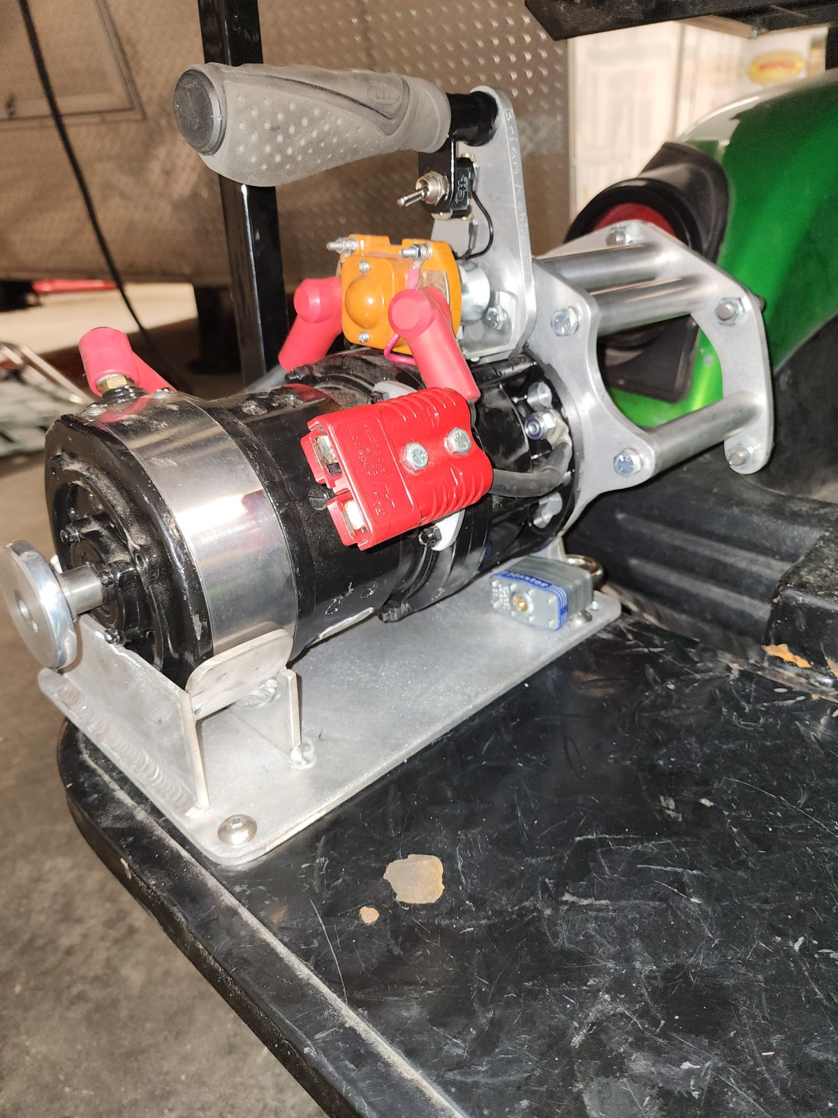

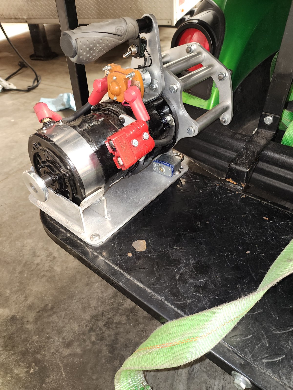

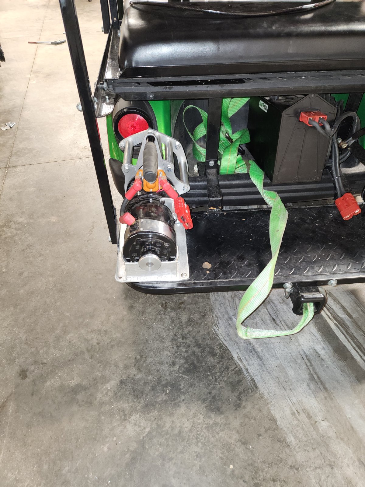

  22. Tonight's fun. Building a mount for the starter. Not only does the mount hold the starter stable so it won't fall out while driving. It has a lock hole. These starters cost 3500 each. They could easily be stolen. The design works so another will be made for the spare starter. You always need two. If one goes bad at the starting line the spare comes out. 20240810_204528.jpg 20240810_204541.jpg 20240810_204556.jpg

  25. That's without the 1200 dollar 48 volt battery and charger. Of course the cable is extra. I'm fortunate I only had to buy one. A friend p***ed away recently and had a brand new one. The guy running his estate is a racing friend of mine and ex top fuel driver. The spare is his on loan as long as I want it.

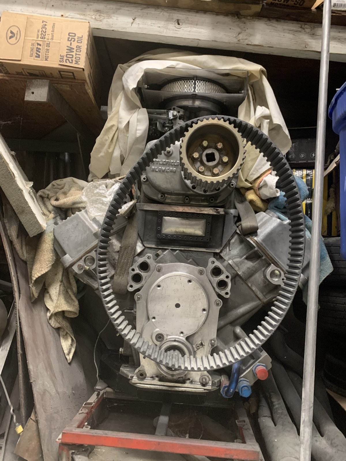

    IMG_2370.jpeg I sure admire what you've accomplished, Brian, if it was easy, everyone would be doing it. My KB Hemi sits under a blanket, awaiting my attention. I had to turn the Hemi spend-fest off for awhile. One thing I've learned, it doesn't pay to have some quality parts mixed with some questionable parts. Just blows up in your face.

  28. I learned from a friend's mistake. He had one stolen without a backup. Mine is engraved with my name in a few places. Thieves are opportunist. When they see a chance they take it.
