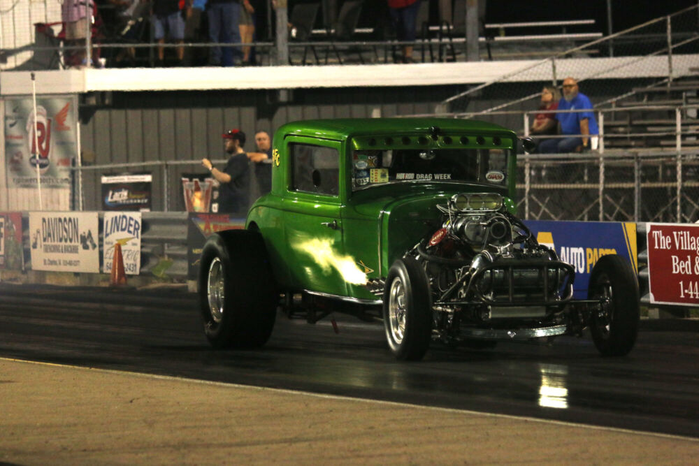

  1. I just mounted the data logger last night. It's not hooked up yet. Hopefully soon.
    I share the good and bad here. With that being said I wasn't happy with the performance. It was slow by a half second and the 60 were off a tenth. Something is a miss.
    We found the problem while cackling the car at the show yesterday. When the blower went back on the fuel returns somehow got reversed. That explains the lazy leave because it was lean. It also explains the flames we couldn't get rid of with adjustments to the barrel valve. The mph was down because it wasn't leaning out on the big end.
    The fittings have been engraved so this won't happen again regardless of how tired I am or in a hurry thrashing. Live and learn. You want to find something wrong yet you don't. It's a easy fix just swap line positions and it costs nothing.
