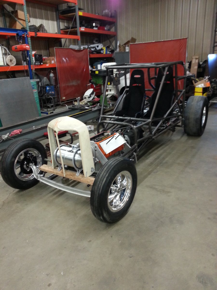

  1. its a illusion. the grille shell is moved forward to make room for the moon tank; mag and fuel pump. i was using 2x4s and all kinds of things to mock this up today so i couldn't place everything exactly where i wanted it. the rear wheels were moved back two inches. when i first built the car i ran 28 inch tall radirs. a few years later radir offered 32 inch tall tires. the extra cir***ference would some times rub the body in the front. i had purposely moved the wheels forward basically altering the wheelbase. now we moved the rear end back to the center. the engine was moved forward. i had the distributer cap right up to the firewall. now i have room for a pro mag if i want to use one in the stock location. the car originally had a 115 inch wheelbase. we have not finalized what we want yet. we looked at it from several angles with the grille moved around. we think we can get it all proportioned right. it might just be the pic i posted. i took about twenty through out the morning.

  3. Heres a pic with the grille forward and one 20160213_092924.jpg 20160213_093948.jpg placed more toward the rear. look at how its placed on the 2x4.

  4. fiat gasser
    Joined: Sep 5, 2008
    Posts: 1,608
    fiat gasser
    Really like the grill farther back sitting over the tank. The entire project is really coming out beautiful. keep it going.

  5. i like it further back also. the front axle can go back some more. i don't want to go less than 110 inches on the wheelbase. todays work while fun had a real serious tone to it. we all saw different things from different angles. decisions made today are going to impact how this whole car turns out. we had to do this work before we could go any further. we are trying our best to not make a mistake that might come back to bite us down the road.

  7. mad mikey
    Joined: Dec 22, 2013
    Posts: 9,460
    mad mikey
    Another vote for the grill back over the tank. Will that screw you on any needed space up front?
    els and loudbang like this.
  8. The tank needs to be raised alot. The outlet on the tank needs to be higher than the inlet on the pump. The pump needs to be forward of the blower belt due to the fuel lines. With the lower pulley on the crank we know where we need to be. I could only mock up so much with what i had. It was a real balancing act. I didnt want the tank to fall and get dented. Im sure this was the first of many mock ups. I will go over and over all of my pics. Notes will made for the next time. For now everything is taken apart. The bottom of the axle needs to be machined to fit the bat wings. 20160213_094814.jpg
  9. fiat gasser
    Joined: Sep 5, 2008
    Posts: 1,608
    fiat gasser
    Another thing with the grill over the tank and the tank raised, will you have easy access to the top of the tank to fill it?
    I really like the low center of gravity that the drivetrain is going to give you. I know what you mean by thinking the process through. I have added years on my build because what looks good initially later becomes a problem in another part of the build. I have learned the hard way, but your project looks to be in good hands. A perfect example of something great coming out of something bad.( the crash to now)

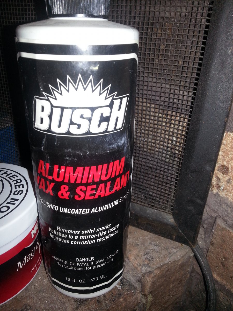

    U putting anything on the wheels to keep the Polish on the them? I polished my fronts a few years ago and if u don't keep polishing them they will be dull and nasty in no time and don't even think about washing them with water if they are bare u can't dry them fast enough before they are dull.

  16. Yes i do. I pollish then use busches sealer. The busches needs to be slopped on dont be shy using it. Let it sit until it dries. It will come off real easy. You are correct on the water causing corrosion. Even the moisture in the air can mess them up on a humid day. The busches seals the wheel from moisture. Its not a cure all but far better than nothing. A fyi dont leave the bottle outside to freeze. If you do the product is ruined. Since i had the wheels pollished i have had to do the fronts once the rears were still good. That cammer ford is looking bad *** by the way. Hows the dyno session going?

    Joined: Feb 14, 2009
    Posts: 3,292
    ROADSTER1927
    Where do you find the Busches sealer? Thanks, Gary

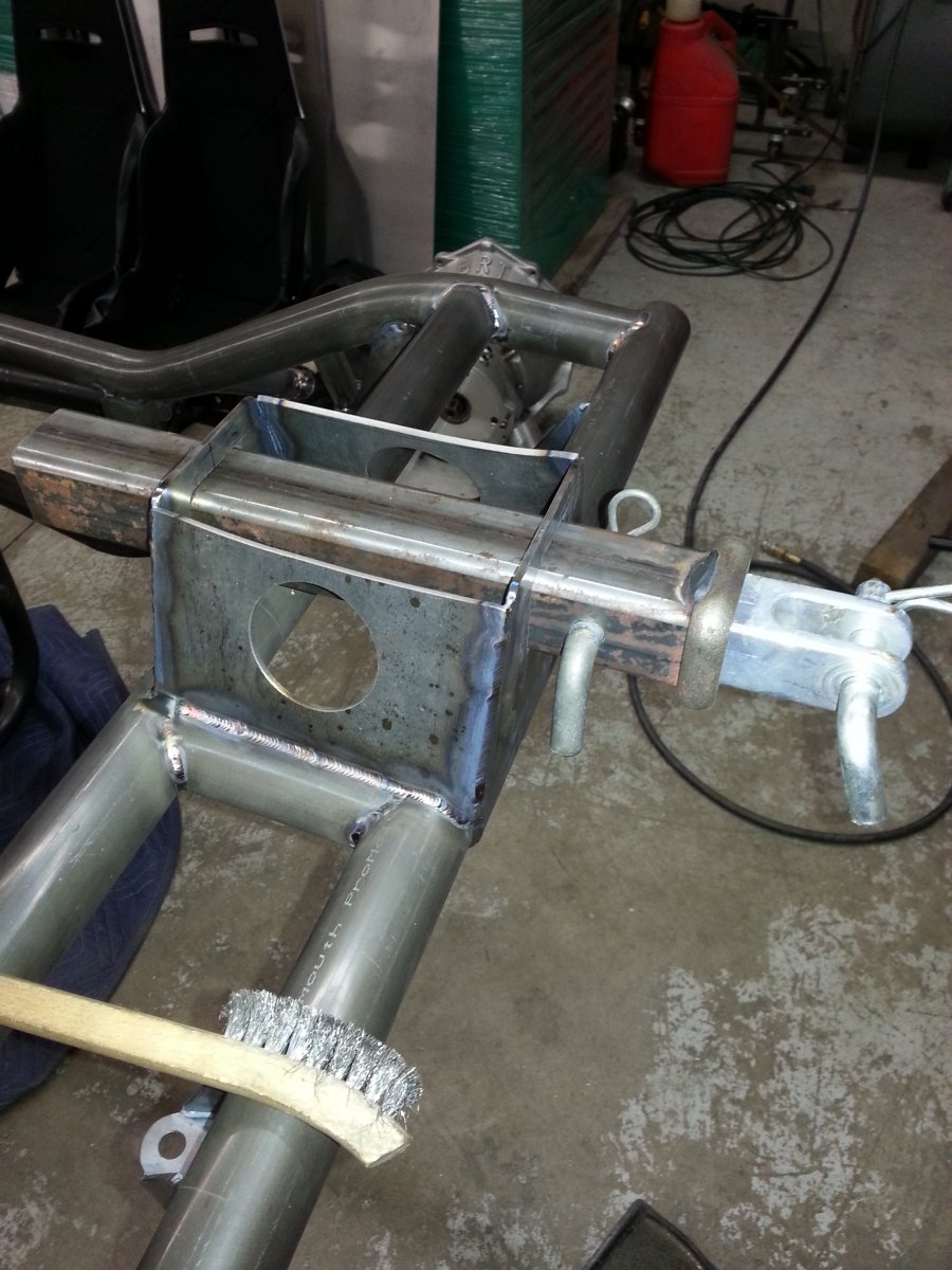

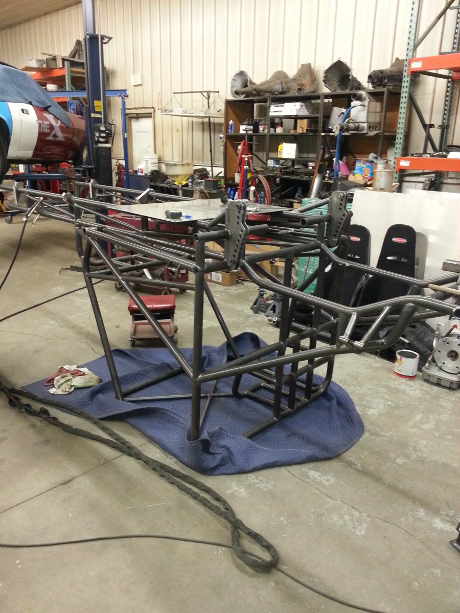

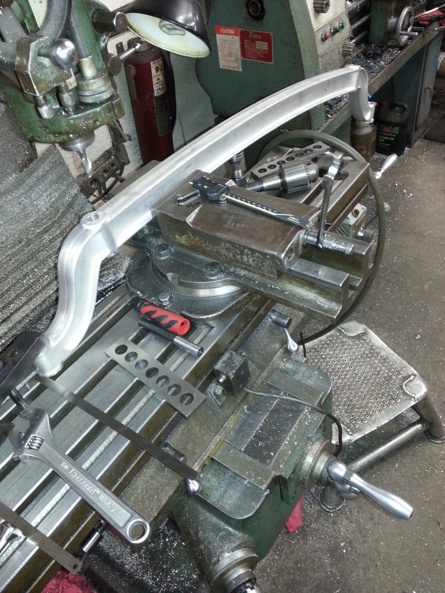

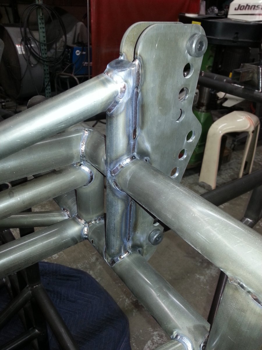

  29. Everything came apart today. The frame was flipped so all the welding could be finished. The trailer hitch was all welded up. The axle went back into the mill to get machined for the bat wings. I took the engine and mid plate along with the front cover to mike the polisher. The block is now back home and ready to go together. things are really moving now. 20160222_164533.jpg 20160222_164523.jpg 20160222_164555.jpg 20160222_172446.jpg
