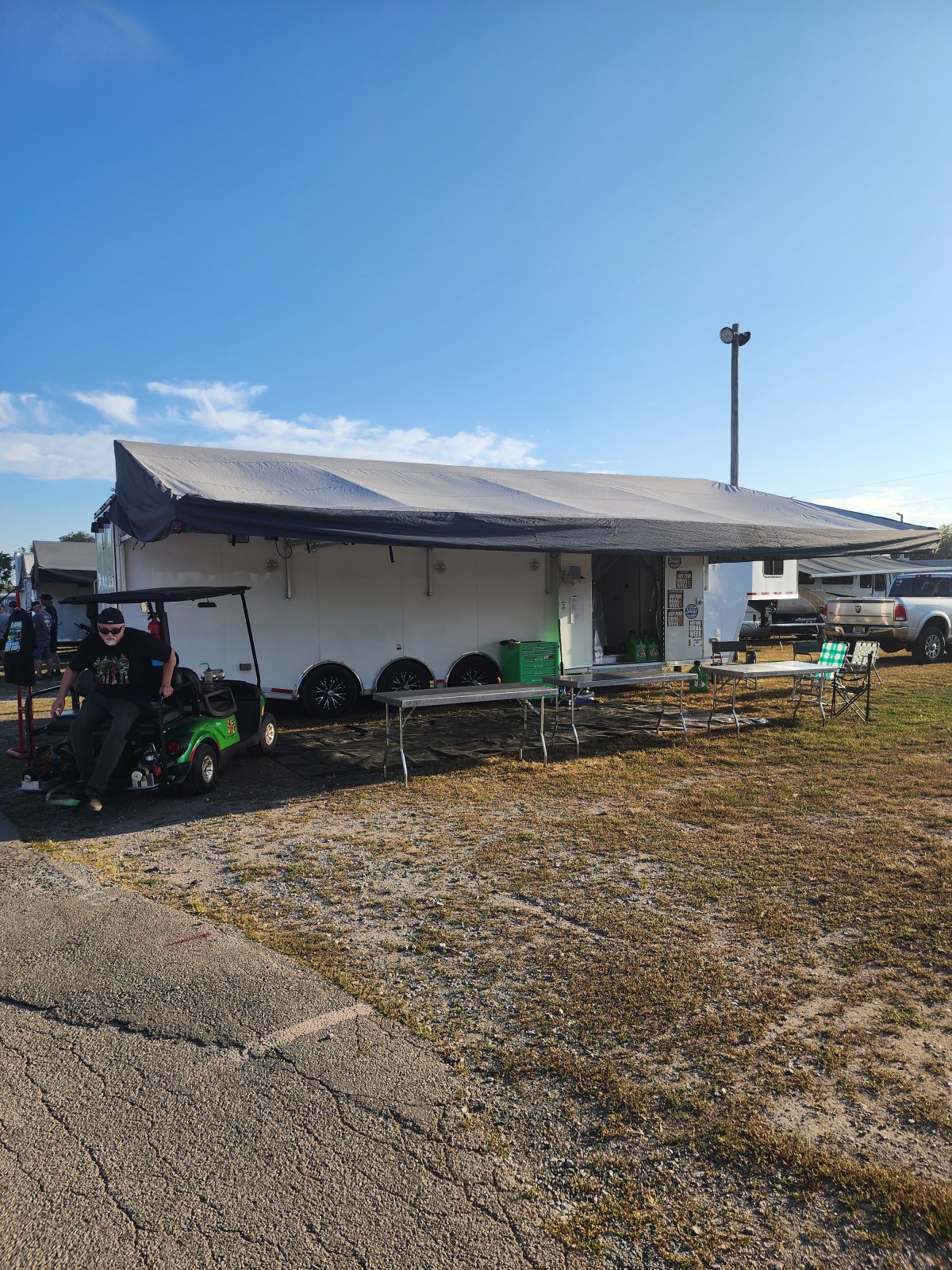

  6. We arrived with zero issues. About 6hr drive. Temp is 91. We are all set up. Let the chaos begin.
    This is a cool track built in 1969. It's a eighth mile track. It's in the middle of nowhere. Driving here I thought many times we were lost. If it wasn't for a small sign along side of the road we would have missed it. The corn is high and you can't see a thing. 20240919_173525.jpg

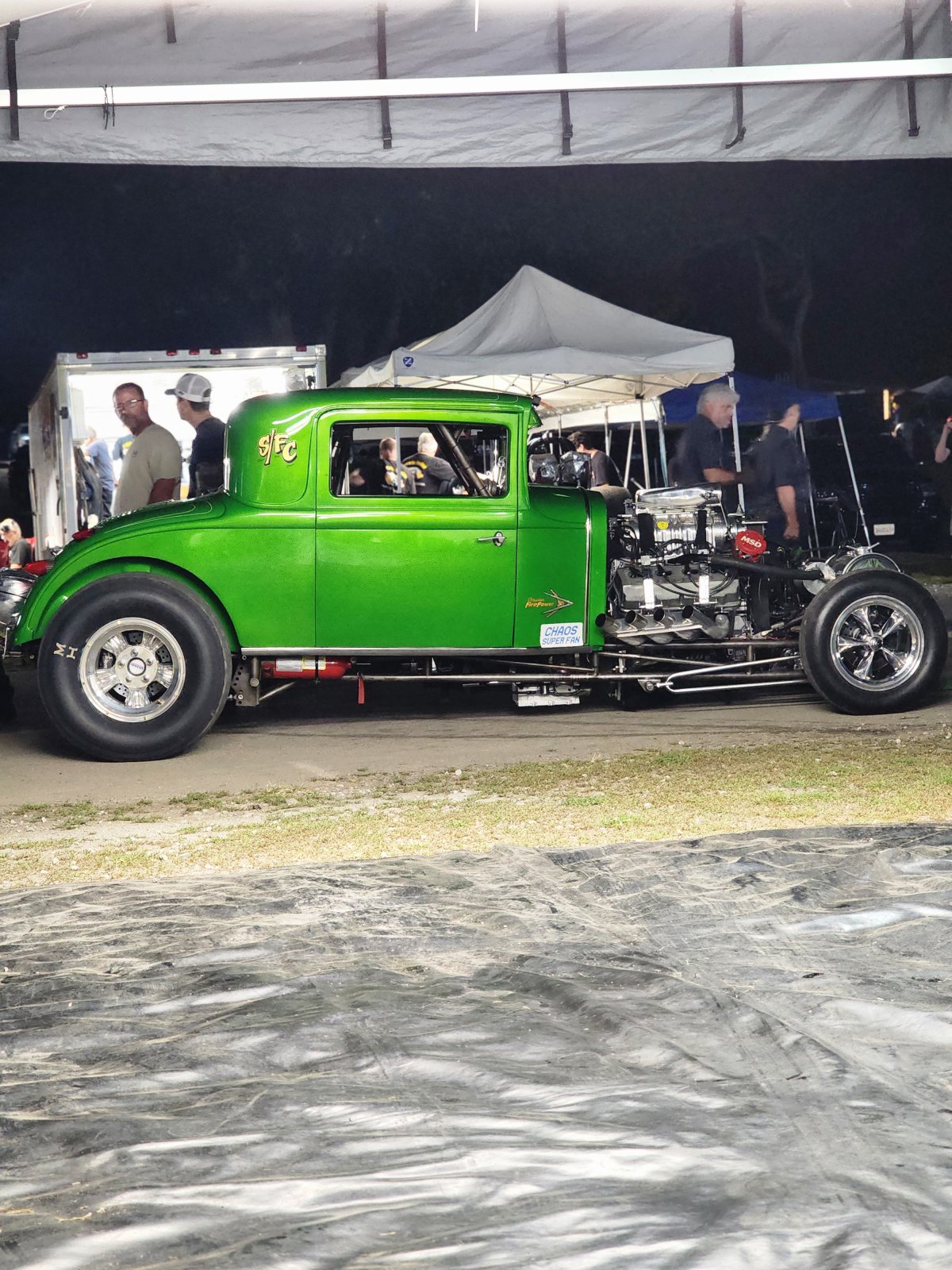

  12. Heading to E-2. This will be the first time in Chaos history that two door cars lined up.

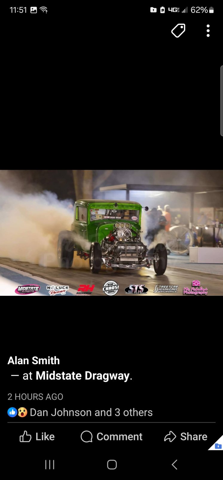

  20. Screenshot_20240922_115111_Facebook.jpg Friday night q-2
    mad mikey, TFoch, The 39 guy and 8 others like this.

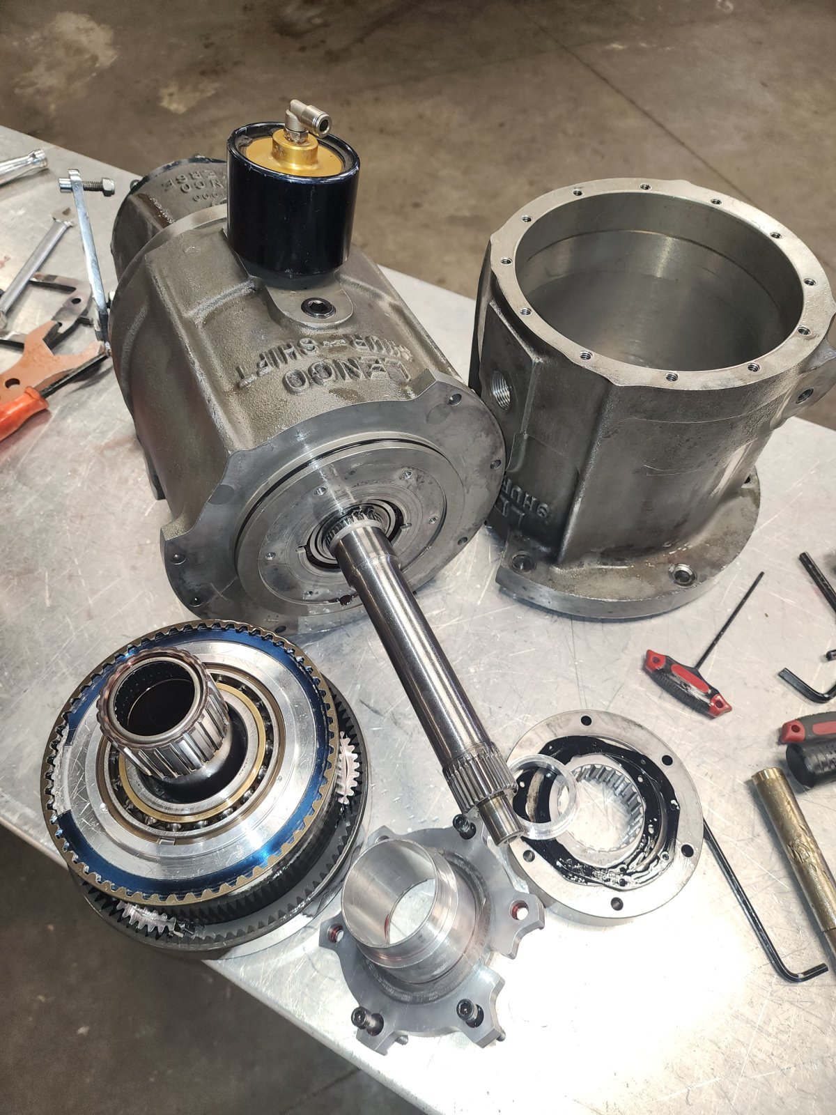

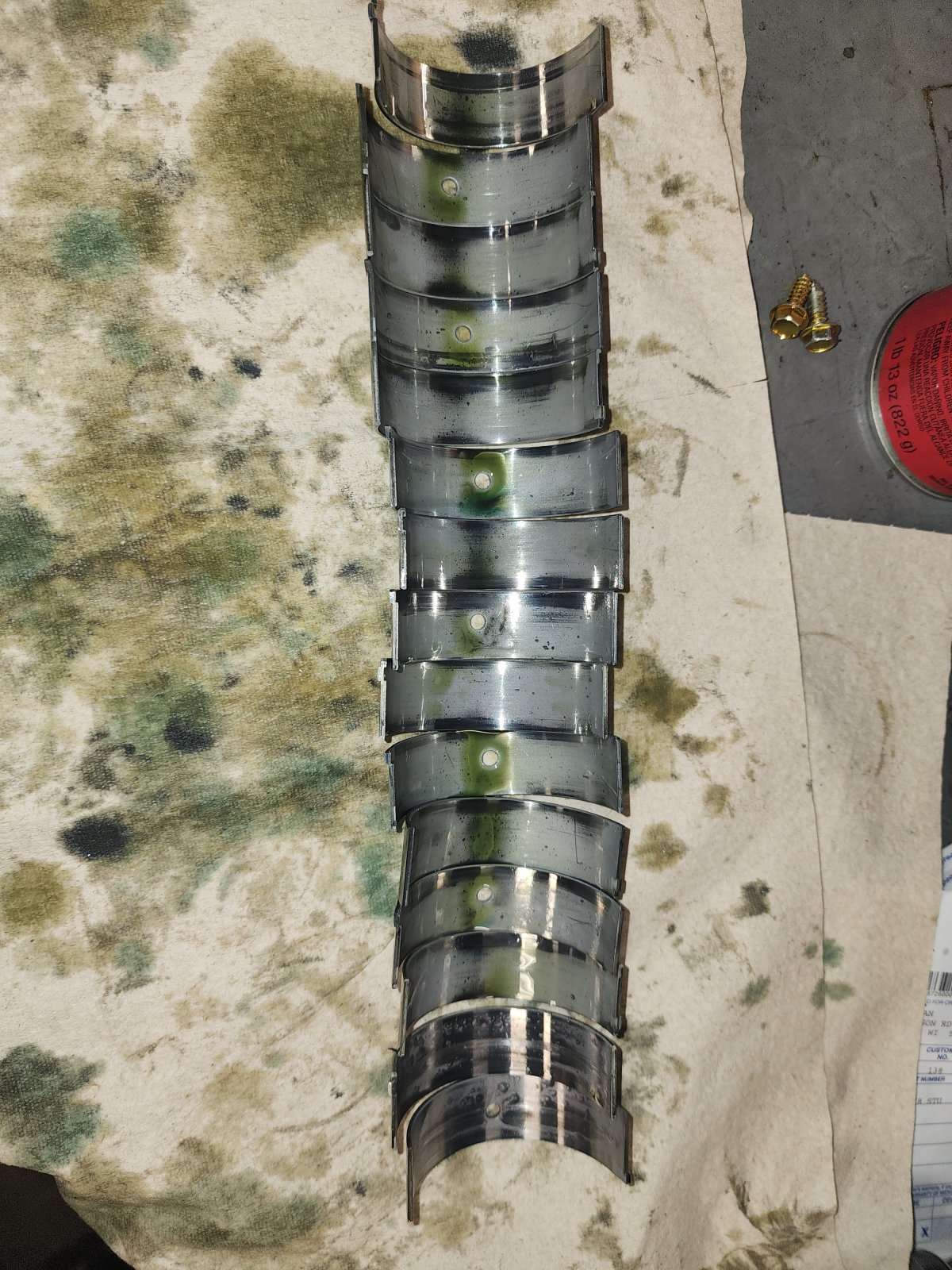

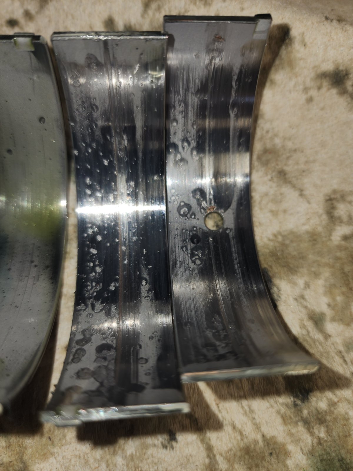

  24. I got home at 2am Sunday morning. I was do pumped up I had a hard time sleeping. Out in the shop by 9am. Pan pulled so the bearings could be changed. As you can see in the pics one was getting picked on. That's usually do to that cylinder being lean. That cylinder was richened at the track. It's a good thing we did or it might not have lasted the weekend. Seeing the bearing confirms our tuning choice. See why proper servicing is so important.
    Several leaves were tried. The second gear launch was by far the best. A first gear hit was way too violent and was slower. The choice was made to pull the trans and gut the forward case. A adaptor shadt was ordered from lenco today.
    I could have left it as is. It would have worked fine. Doing it this way there is only one shift ****on not two. There is no chance of forgetting to have one shift ****on up and one down. It also removed alot of rotating weight. Fifteen pounds of rotationg weight is equal to one hundred pounds ds static. That's a tenth. It's worth doing.
    Leaving a gutted case connected saves me the cost of a new longer driveshaft. A new rear mount would have to be made. The shifter would have to have a new mount fabricated. The empty magnesium case weighs less than a few pounds. The oil jugs were pumped full along with the nitro and alcohol jugs. There's alot more. See how glamorous being a owner can be. 20240922_172020.jpg 20240922_172025.jpg 20240923_174200.jpg

    I ask Questions learning more on & what others are doing , characteristics.
    I counted a few times I'm seeing 15 shells, No big deal , see damaged/wear one that One rod/cylinder.
    How much of a Fuel
    change /percentage increase?
    Since Lean compared to other 7 ,
    Was Ring land pinched / warped on that hole?
    The pitting , is that also of foreign debris in oil?
    Was Heads pulled , Rod & pistons?
