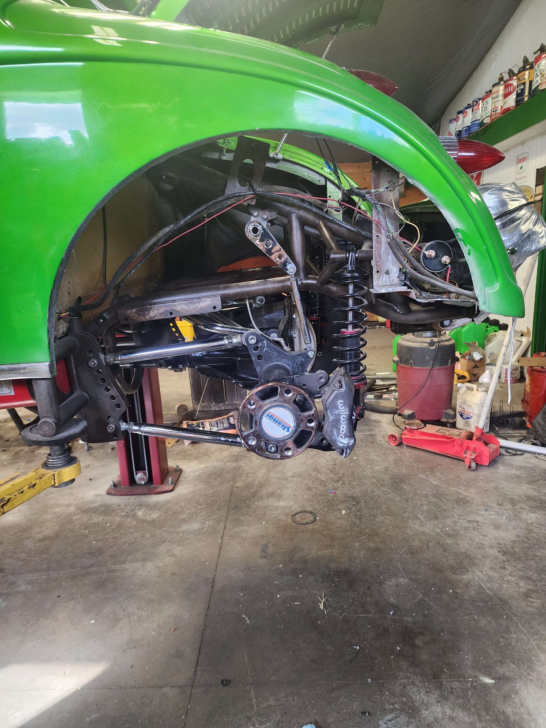

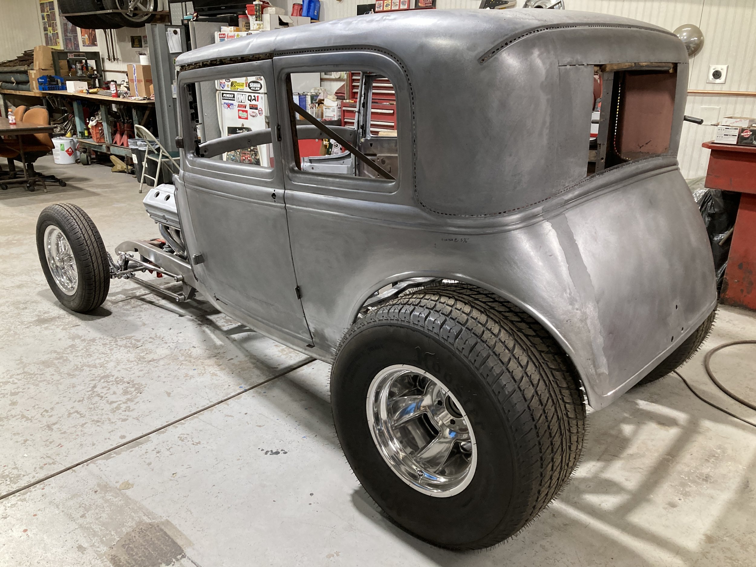

  4. To fit the tires to the car there will be some surgery taking place today. The inner wheel house will get cut off and moved inboard several inches. I have the room to do it. I might have to change the radius on the outside of the car also. I will see how it all fits.
    Here's some tech info. The car had a 11 inch rim. The tire was 13.5 inches. This made the tires sidewall bulge out. At speed the tire grows and stands up. With this setup it causes the tire to narrow as it grows. I have pictures of this happening. It's normal for this to happen. In my case without a wing driving the rear of the car down I won't ever get traction.
    The new rims are 16 inches wide. The tires will be 14 W. So it will have a 15 inch contact patch. The sidewall will be stretched inward. This slight taper won't allow the sidewall to grow in the middle. The contact patch won't change. It will also stiffen the sidewall. This helps a heavy car.
    Tires are a huge tuning aid. Big growth tires change the gearing. They help get mph. The new tires are larger diameter so they will make up for the lost growth.
    Another benefit to all of this is the rear width. The new rims have a different offset. They will bring the tires in several inches. It will help get the tires in the groove of the track better. The old setup had me riding the outside edge of the groove It will also help keep the car more stable.
    Tires seem like a simple thing but they are far from it. The old tires were fine for what we were doing. With where we are going it's just not going to work out anymore. Now we can tune up the engine and really make it fly.

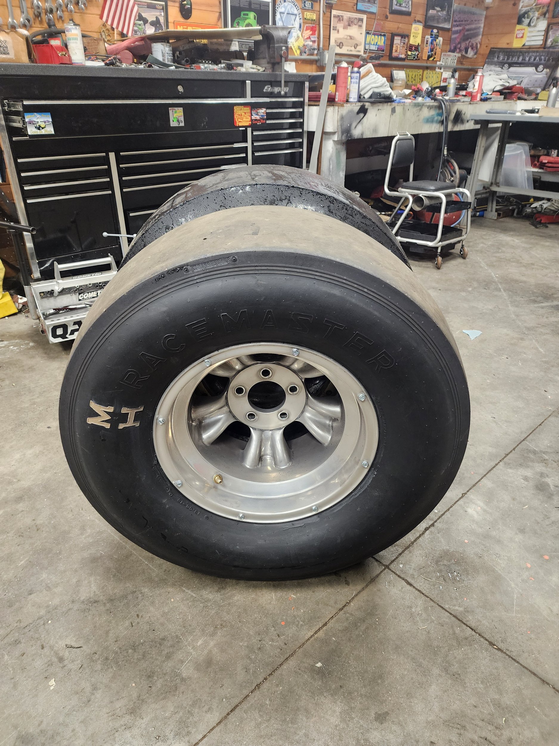

  5. 20241012_184003.jpg I got this pic yesterday. See how the tire grows as it spins? See how narrow the contact patch is? This is why I'm changing things up. I hate to remove the bear claw wheels. 20241013_080816.jpg

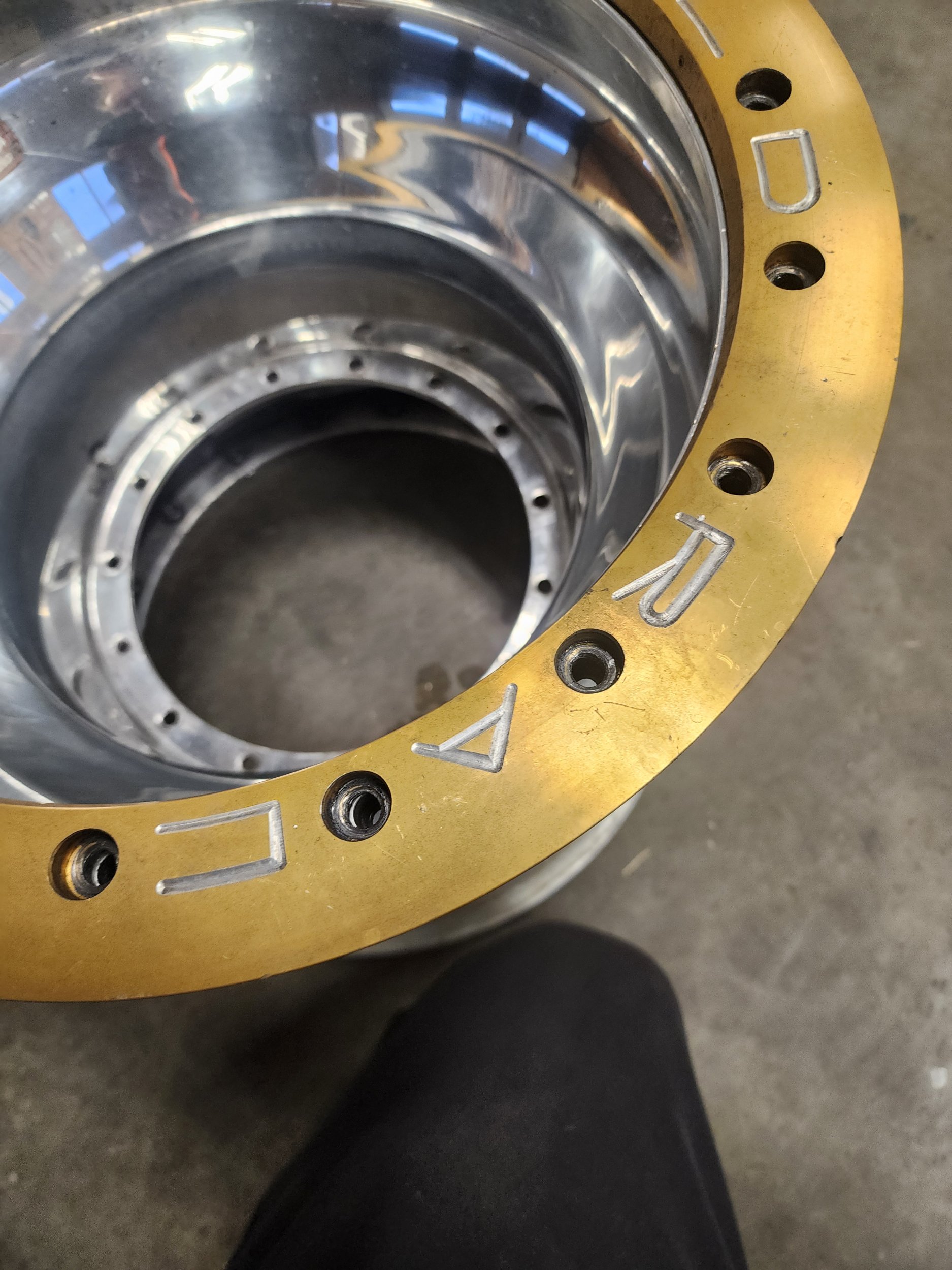

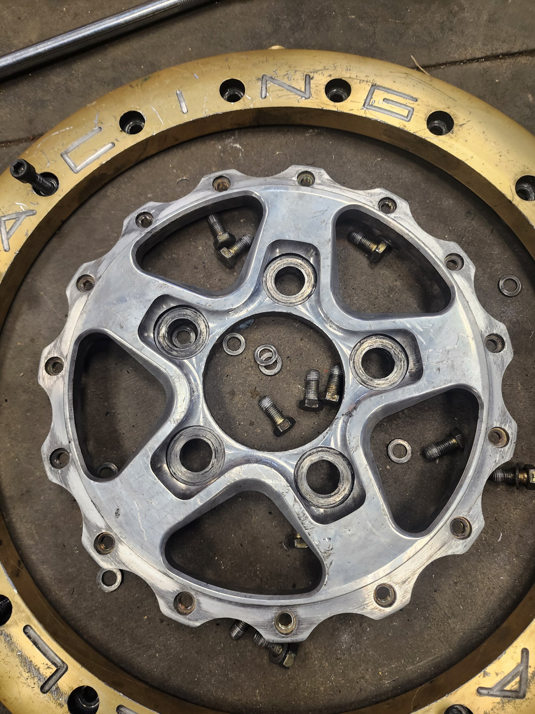

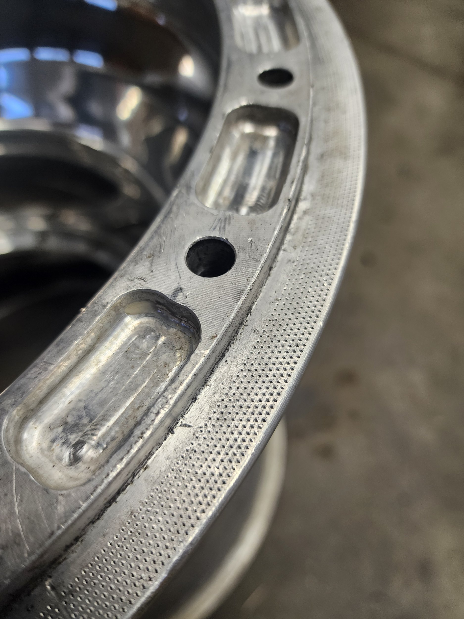

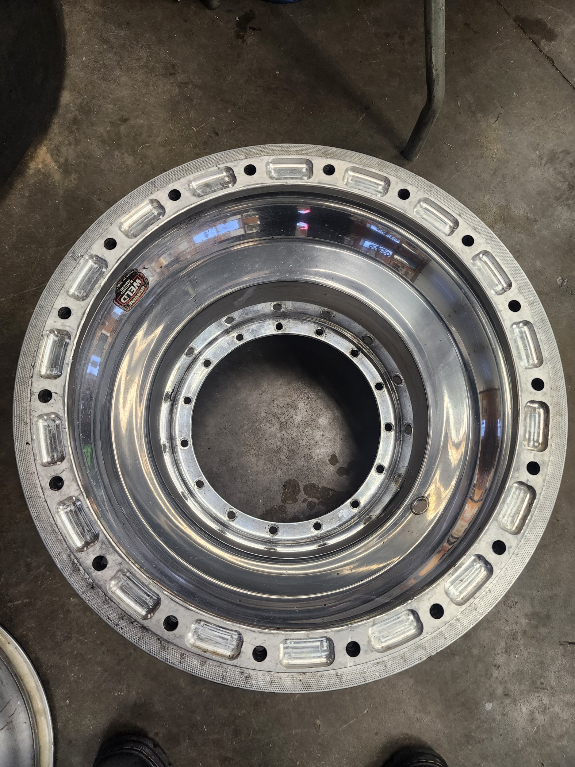

  9. Let's dive in a little deeper into these bead lock rims. Old magnesium rims have a deep recess in them for the bead. It helps keep the rim from spinning in the tire.
    The next upgrade is rim screws. These also help prevent slip. If the slip is extreme the tire can come off the rim. The result would be a crash.
    Beadlocks were invented to do a better job retaining the tire. The bead is clamped between a ring and the rim. Eighteen bolts hold it together. The rims are sfi certified. Different centers in different bolt patterns and styles can be changed out. A inner tube is still used. The tires can be mounted with s****s. No tire machine is needed.
    Not only are the wheels much safer the car works and drives better. I'm looking for a 1.0 60 foot now. 20241013_131707.jpg 20241013_131716.jpg 20241013_131734.jpg 20241013_131739.jpg 20241013_131748.jpg

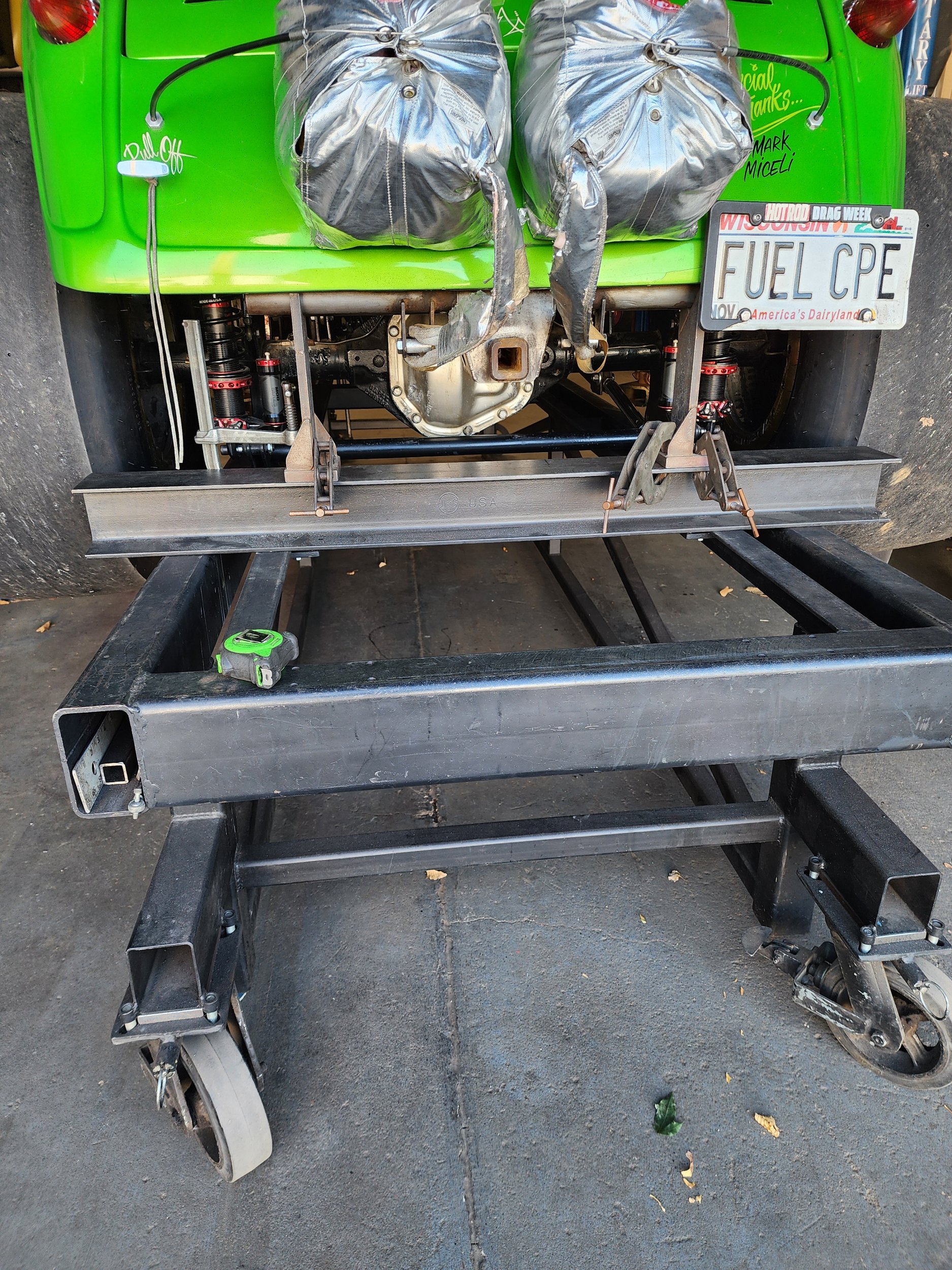

  10. Doing man stuff today. Cutting into a painted finished car. Moving the tires inboard required some modifications. 20241013_140755.jpg 20241013_150745.jpg

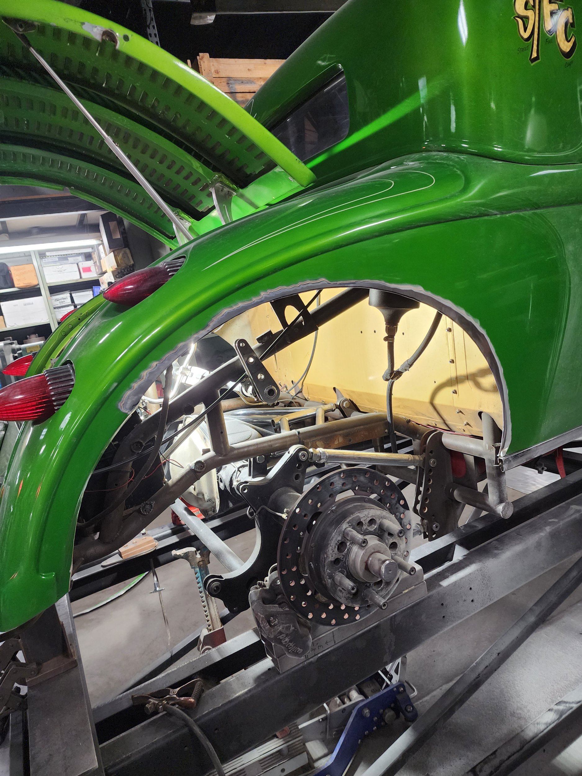

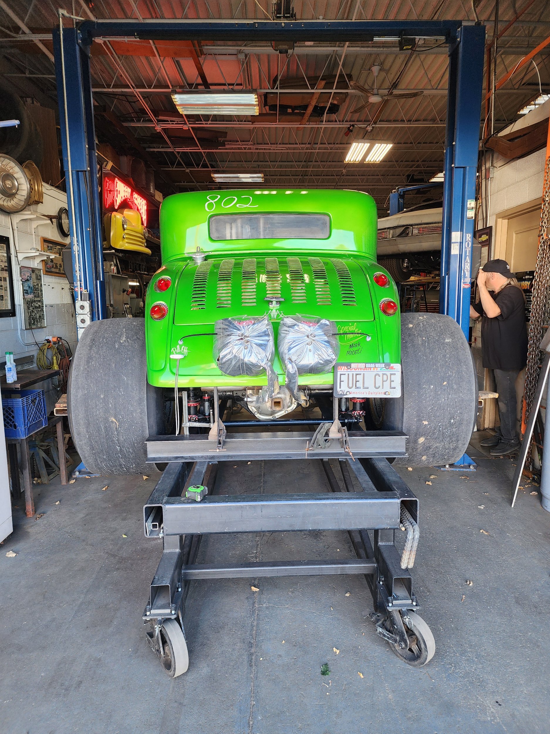

  22. It was a major thrash to get the big tires on in less than a week. All i can say is the new tires work! So smooth so straight. Too bad the coil went away. It would have been 200 based on the down track times.
    Today's fun is moving the tires inboard. This will keep the tires in the groove without the wide track. It will also look better.
    The frame jig we are using has been building ch***is since the 60s. Major surgery is needed on the body. The shocks will get moved in board. Wheel tubs need to be fabricated. The rear-end needs to be narrowed about 5 inches. The axles need to be sent out to be re splined. It's a major undertaking but we will get it done. We are preparing for the first week of April. That's the first nitro chaos in Dallas tx. 20241101_095635.jpg 20241101_095520.jpg 20241101_095533.jpg 20241101_100359.jpg 20241101_100616.jpg 20241101_100702.jpg

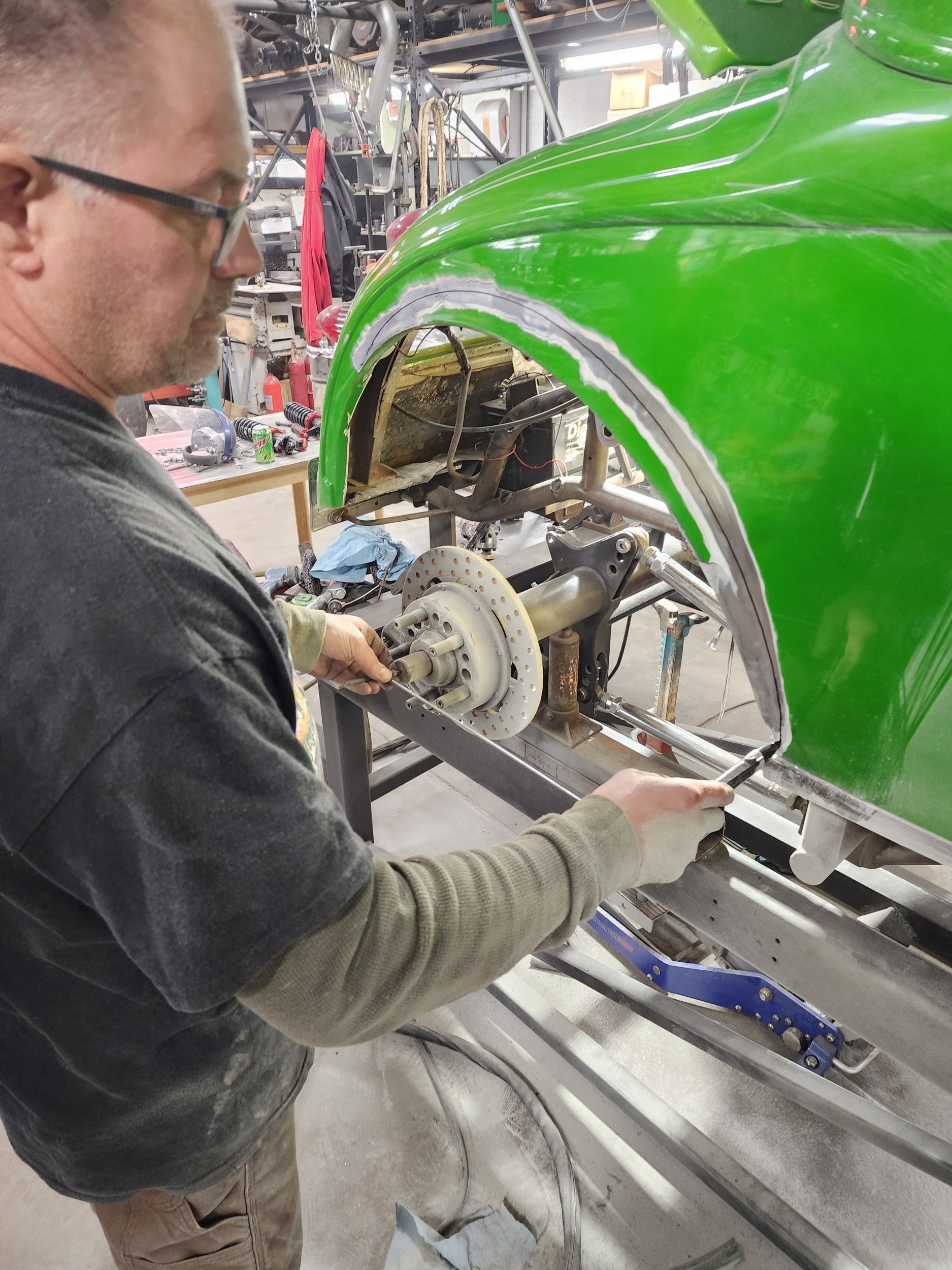

  26. The opening on the side of the car needed to be bigger. A plug with a center was put in the axle. A adjustable rod with a marker was used to get a even line. Just swipe the panel. The paint was removed. A plasma cutter removed the metal. Some sanding finished it off. We needed some extra room. When the tires grew on the burnout it they lightly touched the body. 20241101_155030.jpg 20241101_155358.jpg 20241101_155652.jpg 20241101_163146.jpg

  28. Were done for tonight. The wheel openings are done. The right side shock mount is made. The anti sway bar links were modified. With everything in place I have 2.5 inches between the body and tire. So at maximum growth it can go 5 inches bigger on the cir***ference. The larger tires raised the car 3 inches. We made new shock mounts to drop it back down to its original ride height. With the body down and the tires moved inboard it's going to look cool.
    The drivers side shock mount and narrowing the rear-end are on tomorrow's list of things to do. View attachment 6227940 20241101_160651.jpg
