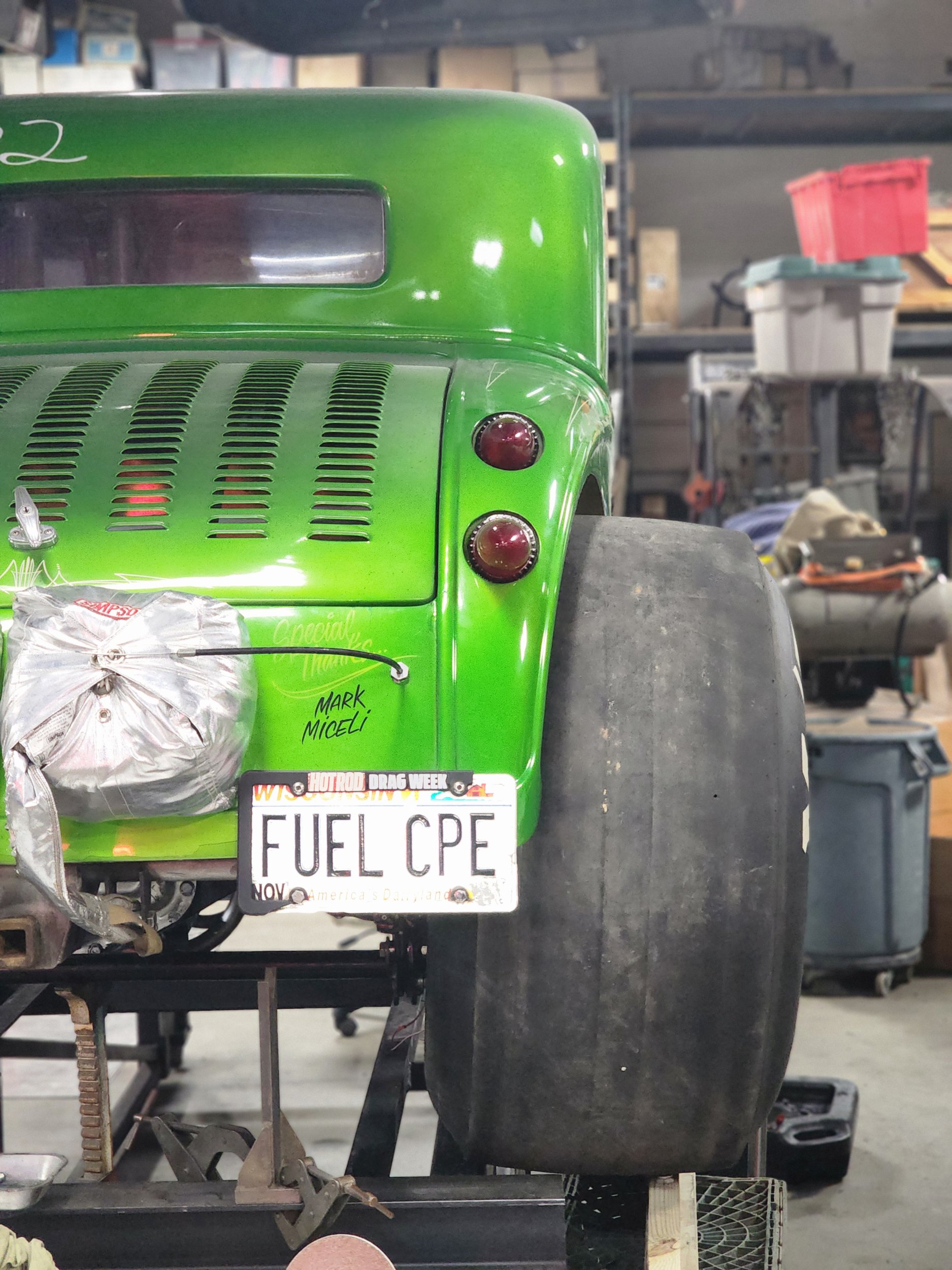

  2. I can't show the wheels. I used oven cleaner on the hoops. It removed the gold anodizing. I then polished them. So much better and it saved me 600.00 if I bought new replacements. The shock mounts are on. The housing is out. We are cutting it 4 inches per side. This gives us extra room if I ever want to put the big Bubbas on. 17 inch wide Bubbas. The housing is a real mopar Dana 60 40 spline axles steel caps billet yoke. 20241102_180431.jpg

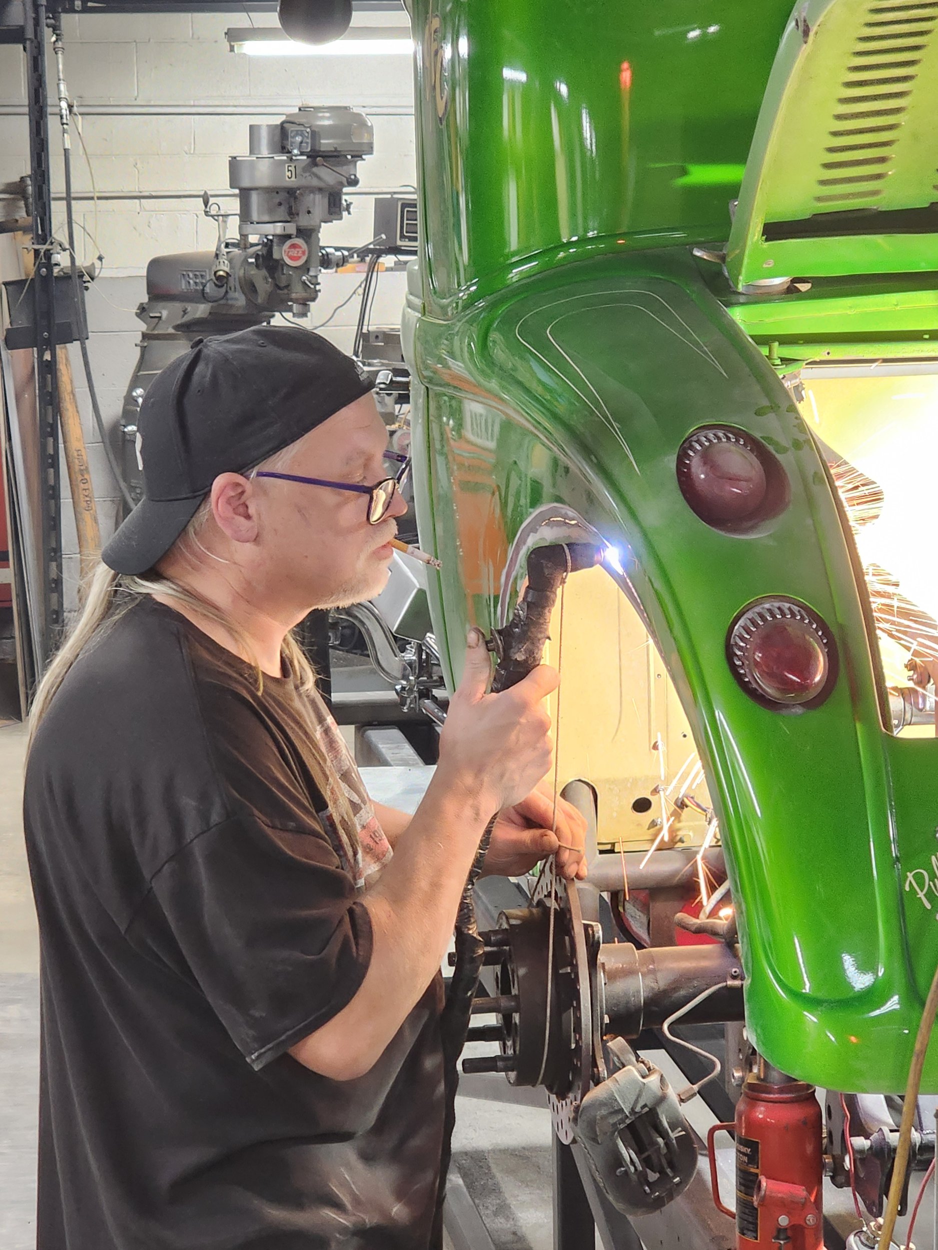

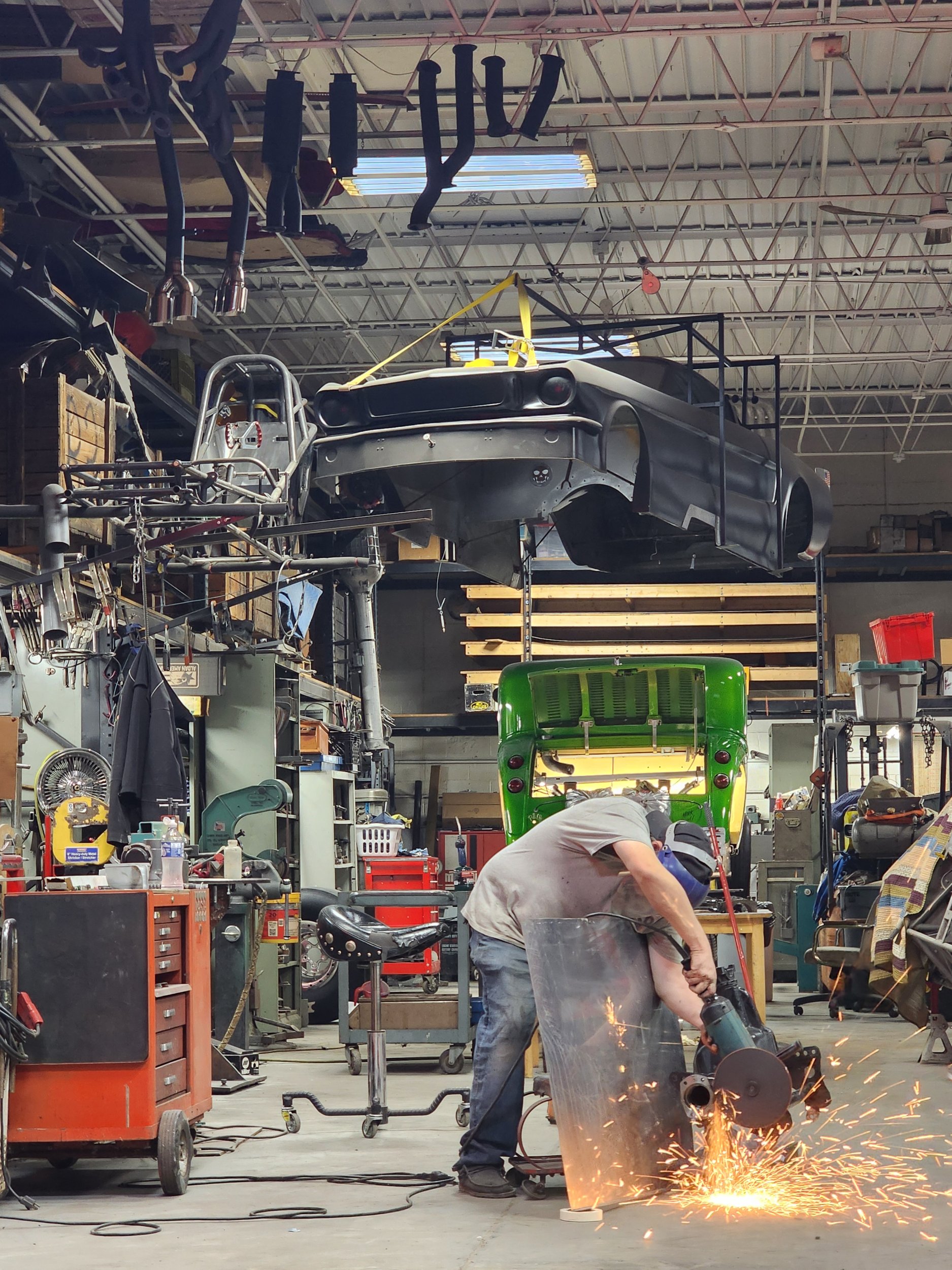

  4. I'm not one to usually tell people what to do, but that big grinder needs to be flipped 180*, if it bites then that big wheel will come running right at that guys forehead. I get he probably doesn't want a face full of sparks while cutting but the alternative is a face full of cut off wheel that is still spinning.
    SDhotrod and porkshop like this.
  5. He switched when he cut the other side. It's a nasty cut off wheel. He is wearing gl***es and a face shield. There is a steel sheet between him and the grinder. The last bit to be cut off was done with a small cut off wheel. Sometimes at the end of a cut they grab. I did show him your post. We have to do the other side. Thanks.
  6. Right on, one thing I have noticed on this thread is the emphasis on being safe around this car as things can go south in a hurry. I figured it would be a helpful contribution which is why I spoke up.
    chryslerfan55 and Dick Stevens like this.
  7. Always appreciated. Everything about this car has a element of danger. We are always trying to minimize the risks. The other side was cut off without incident. It's ready to weld back together. We settled on four inches per side. The rims have a extra two inches of offset to the inside. These changes along with dropping the car down to its original height will really change the look.

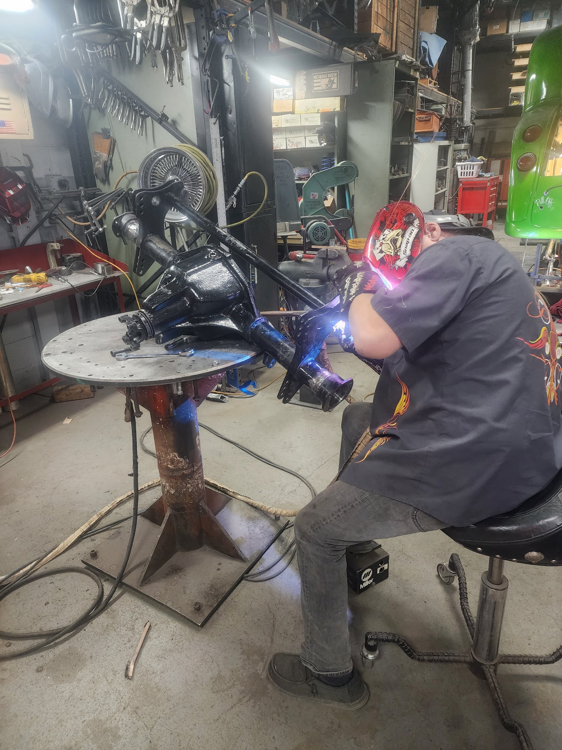

  8. 20241104_130102.jpg The hard lifting is over. The frame was scrubbed down. The new shock mounts are on. The housing ends are welded. The carrier is back in. New axles are ordered. Total amount gained 6.5 inches per side.
    What's left is new brake lines; wheel tubs; kill switch mounted; parachute re enforcements; touch up the paint on the housing 20241104_173011.jpg 20241104_172529.jpg 20241104_172223.jpg . Some things had to be cut out or moved. Alot of progress in just a few days. It just worked out i had a four day stretch off work. Getting a idea on how it will look. I like it.

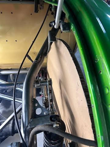

  10. Looking again at the picture of the wheel well getting cut out I just noticed the string… F4CC854A-35A6-4C93-AFAF-E8010F542FC9.jpeg I’m going to try to remember that trick!

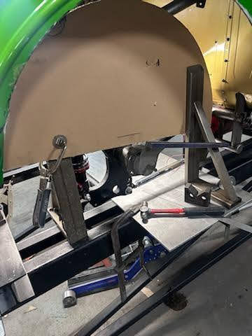

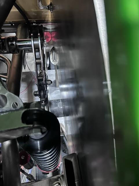

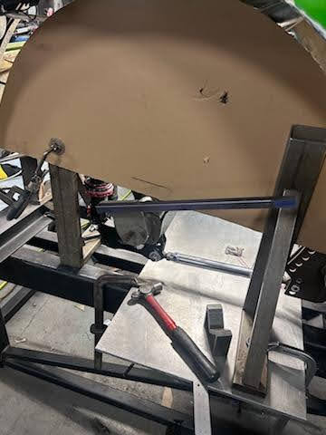

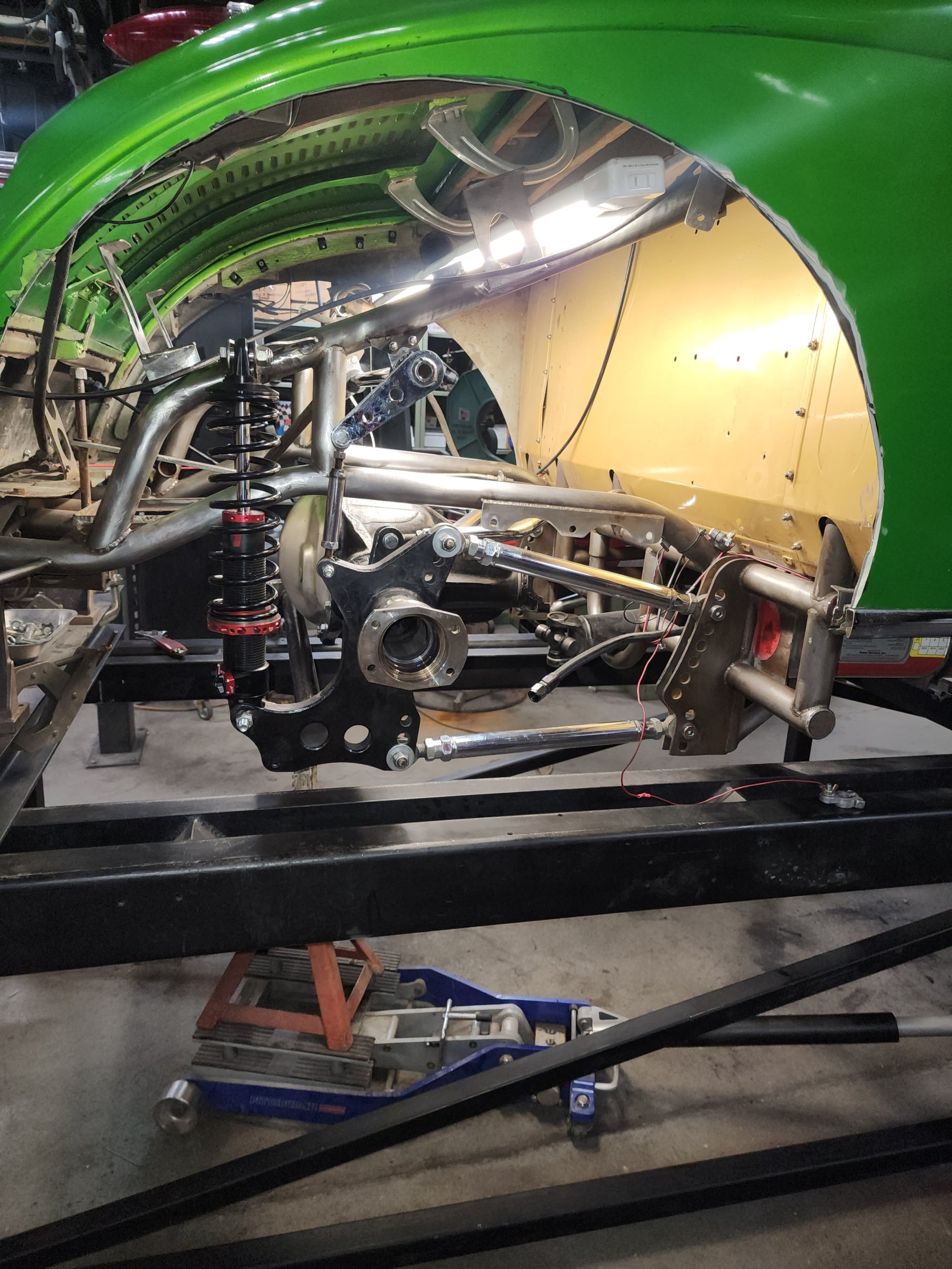

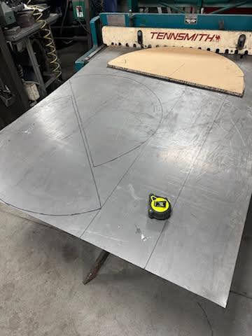

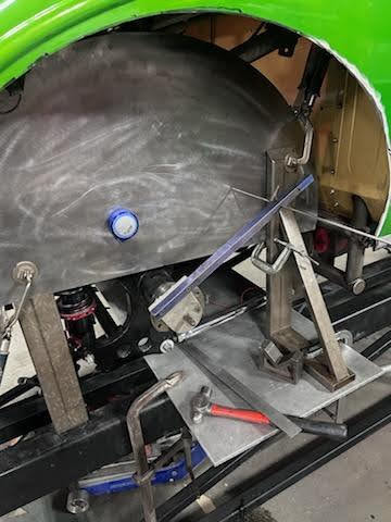

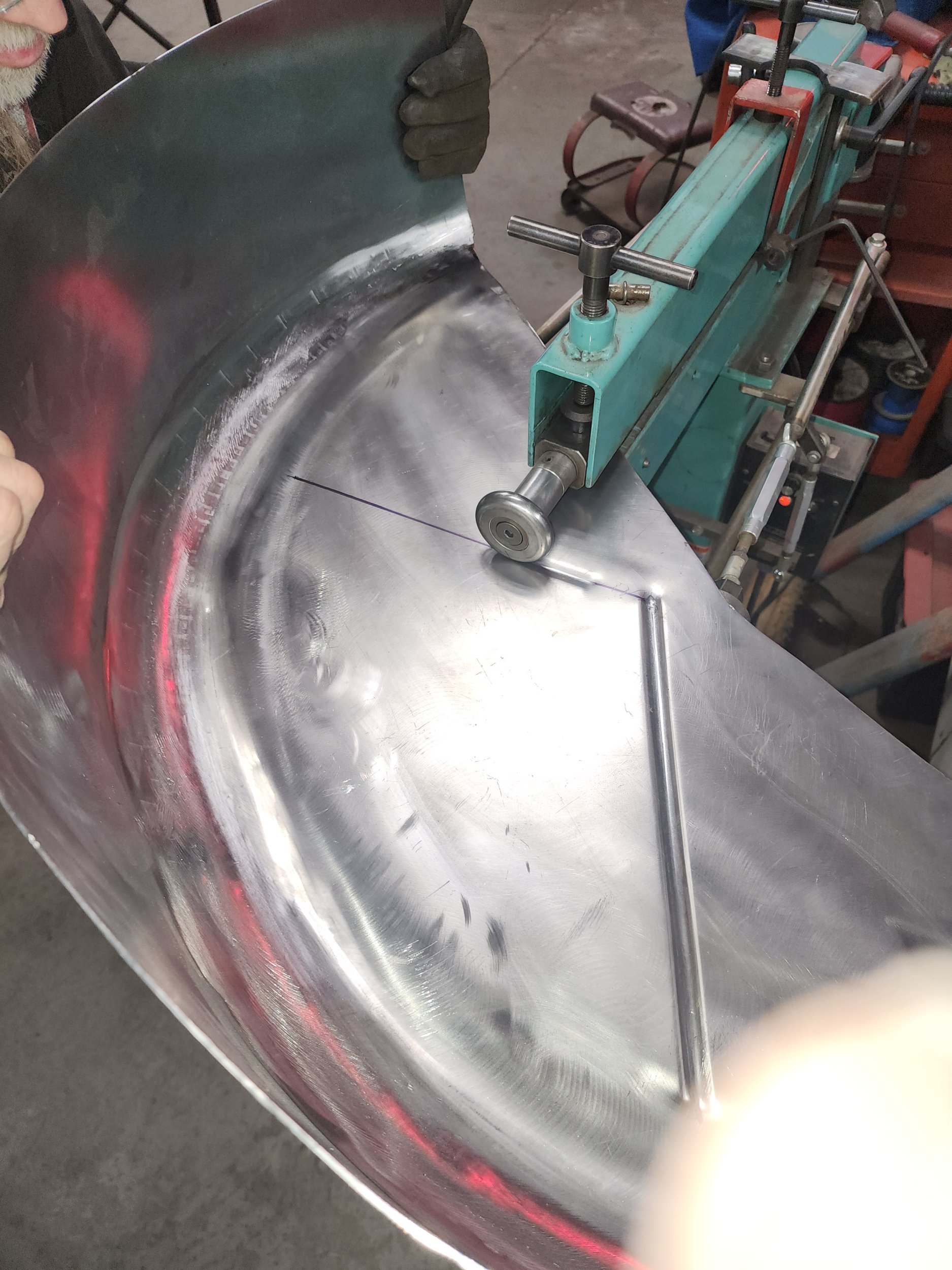

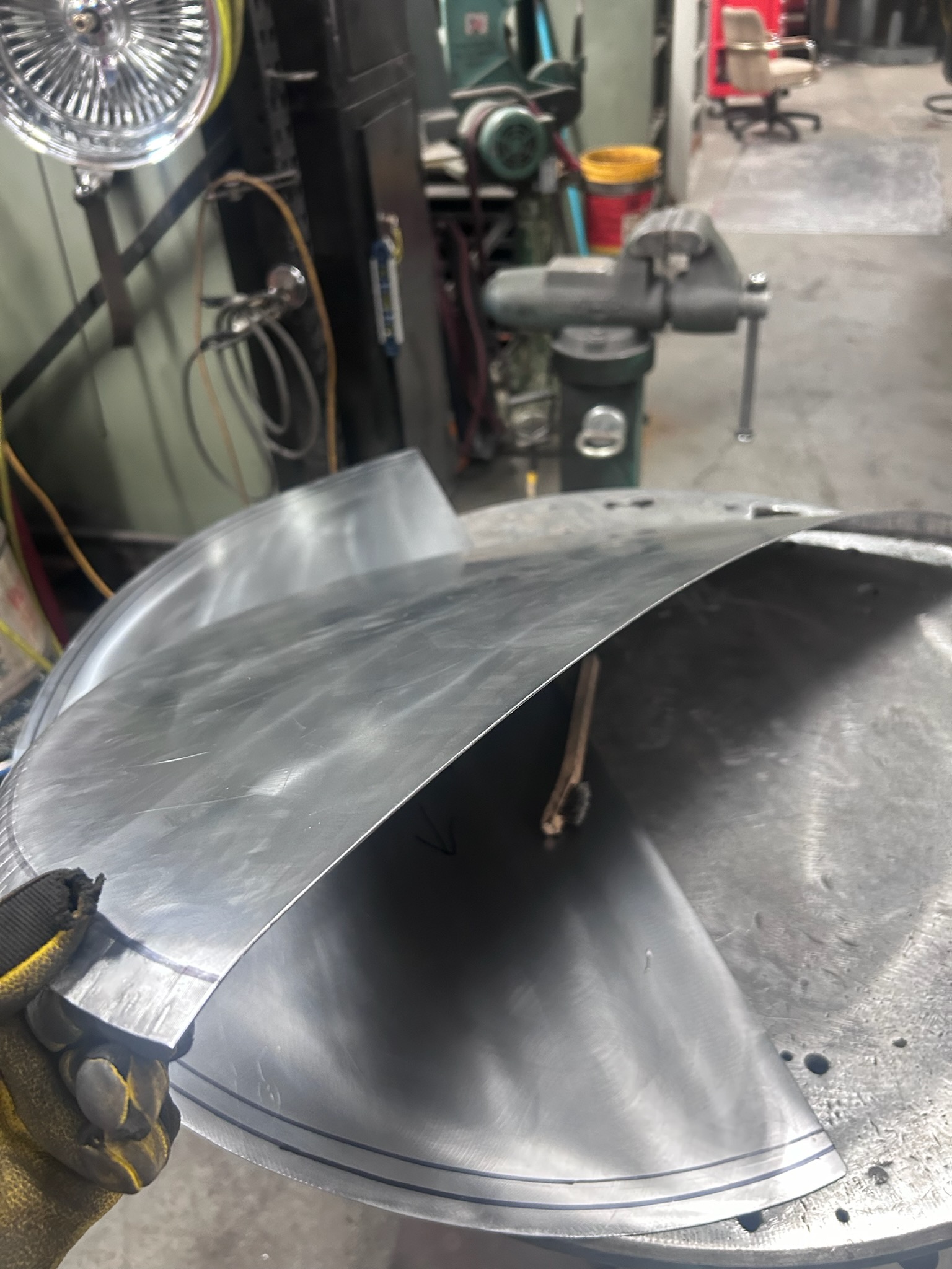

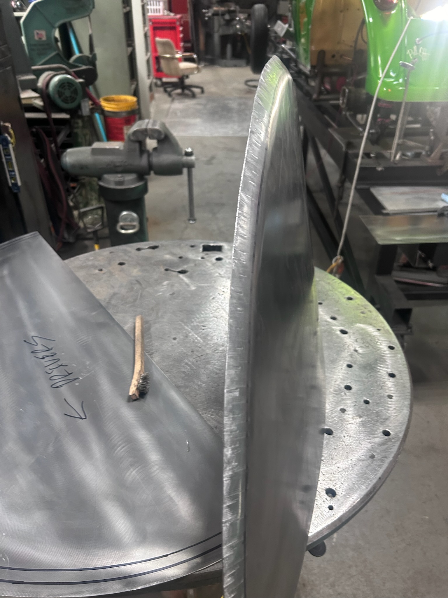

  15. image.jpg image.jpg image.jpg image.jpg image.jpg image.jpg image.jpg image.jpg Time to make new wheel houses. Cardboard is you friend. The metal will be rolled on the edge. Here's a few photos of the first side. The new axles will be picked up after work. I used Strange axles again. Gun drilled 40 spline lightened flange 5/8 stud.

    Looking nice Brian , after tub / inner fender done , Take the cardboard
    Make a circle 17-1/2 inch , tape to
    wheel/rim So we can see a full iside view ,
    With the new tire size ,
    more dive & fuel can be added .
    Race season all most over , maybe you can find a set of American Racing B-L
    Pro Series To match the Front originals,
    5 on 5 pretty common.
    My B-L where made to order 8 months.

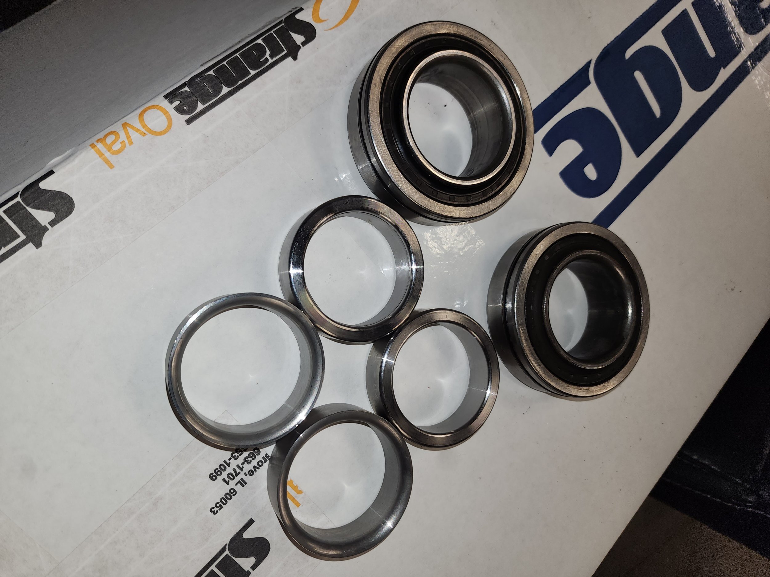

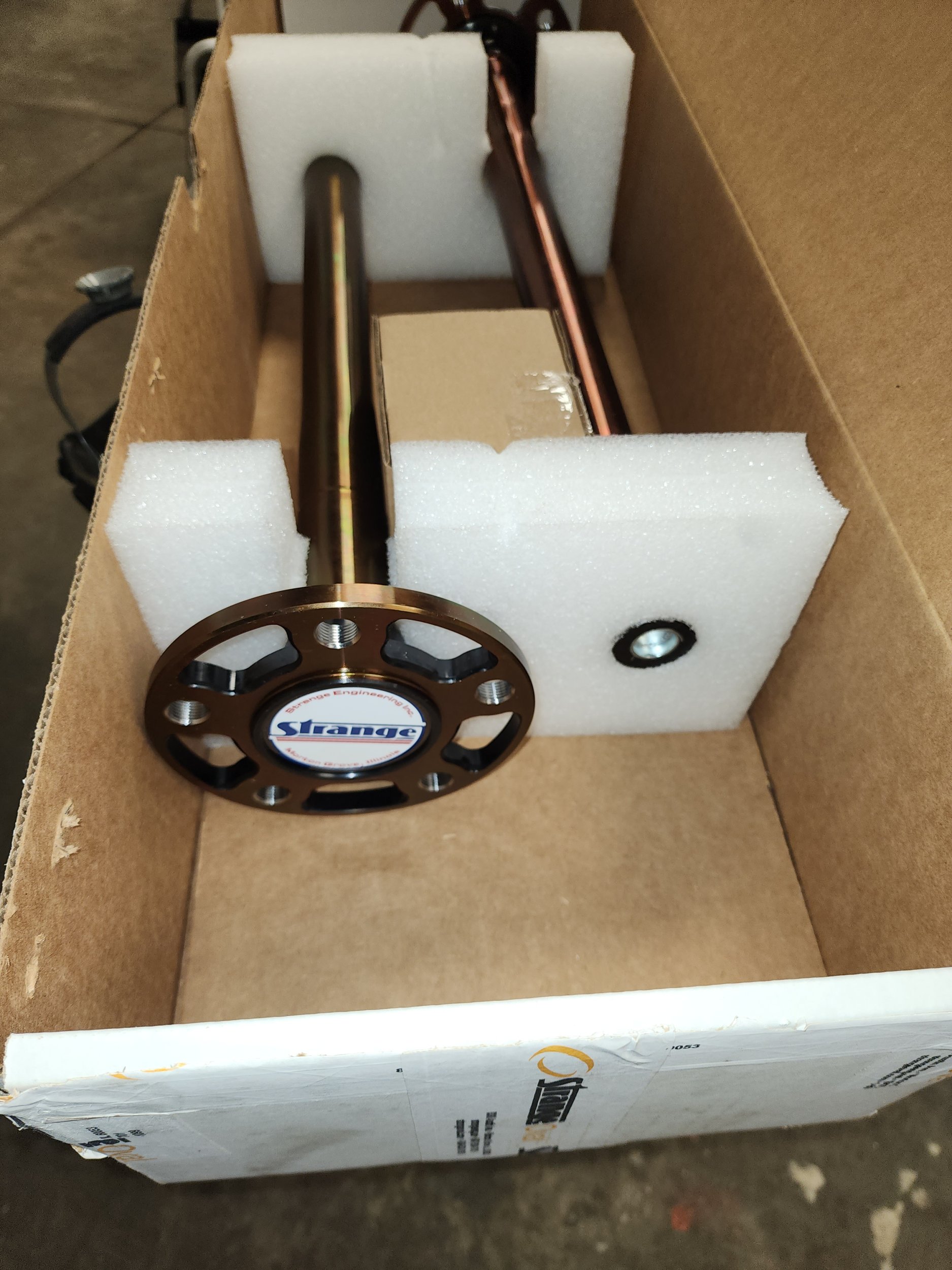

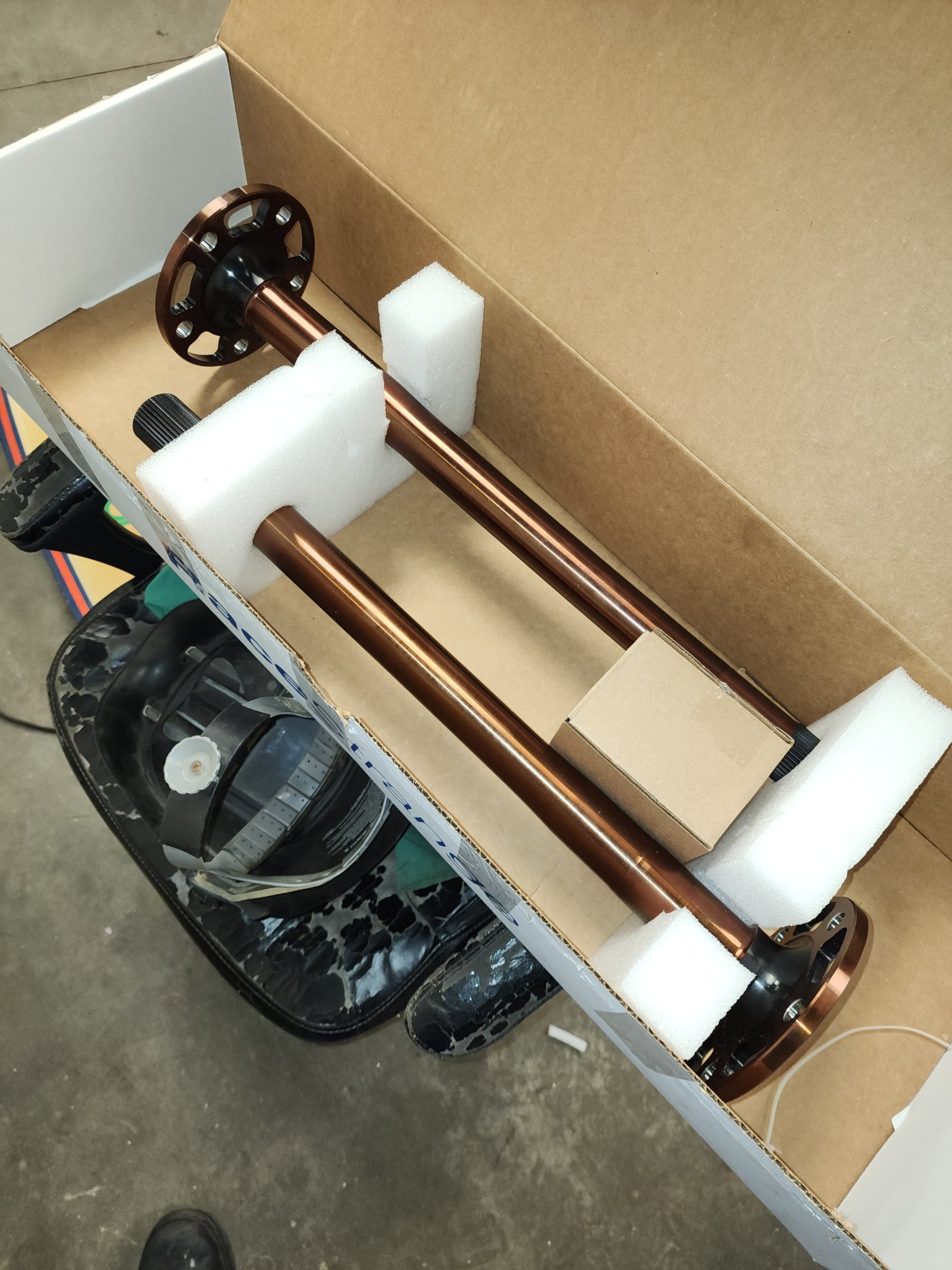

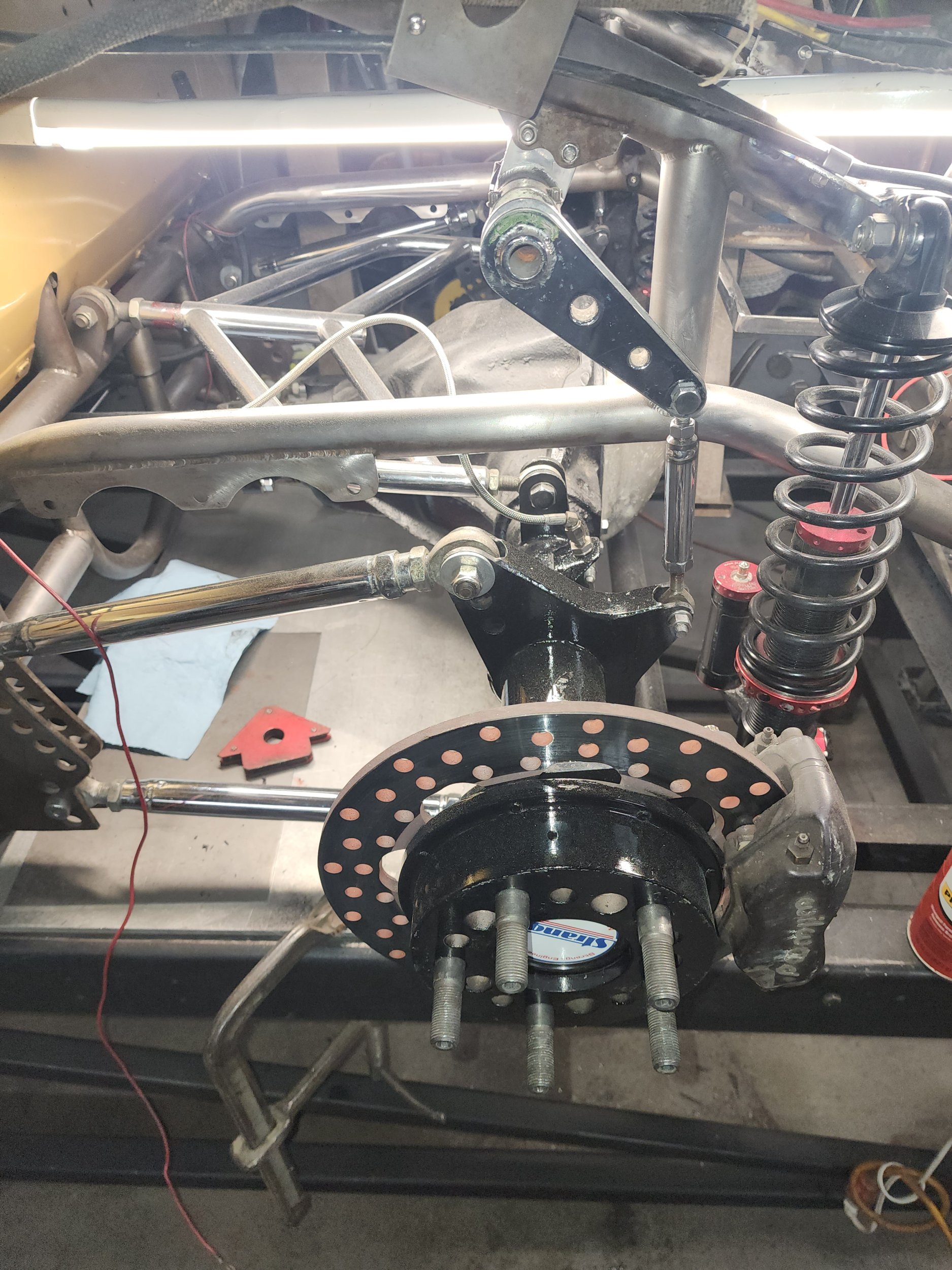

  23. Similar yet very different. I like to show some of the parts that most would never see. Today it's the axles. They showed up today so after work I ran to Illinois to get them.
    These are 40 spline; gun drilled; light flange; 5/8 stud;
    big bearing axles. That's a mouth full.
    They are gun drilled down the center. This of course makes them lighter. Getting rid of rotating weight is always good. It also makes them stronger. The heat treating gets the inside and outside.
    Modern axles today use a common flange end. A spacer goes on first. The spacers set the brake rotor in the correct place. Different spacers for different applications saves money not having to make all kinds of axles. Next is the sealed bearing. No need to set pre load with these bad boys. Then the rings get pressed on. These retain the axle and prevent it from sliding out. A big press is needed to get this together. Removing them requires that they be drilled and split with a chisel. They do their job very well. Last is the studs. The smooth area is 11/16. The studs drive the wheel. Its much stronger this way. A normal car setup uses a shouldered lug nut to drive the wheel. To keep fluid from leaking out of the axle a plug is pressed into the end of it. These axles can handle extreme power. For safety they are a must. The only upgrade from here is a full floater. 20241108_170837.jpg 20241108_170651.jpg 20241108_171022.jpg 20241108_171029.jpg 20241108_171109.jpg 20241108_173724.jpg

  24. image.jpg image.jpg Rolling the wheel house panels. And then somewhere between all of this work the magneto was boxed up and shipped to FIE for a full checkup. It will be run on my boxes and coils to hopefully find the problem.

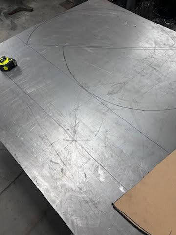

  25. Making progress on the first wheel tub. 20241109_171547.jpg 20241109_171558.jpg

  26. The Dana is together. New parachute cable brackets were made. More work on the wheel tub. The ground wire from the coil to the kill switch was pulled out and inspected. Looks good 20241109_171906.jpg 20241109_172241.jpg Only about 143 days until the chaos. Things have to get done.
