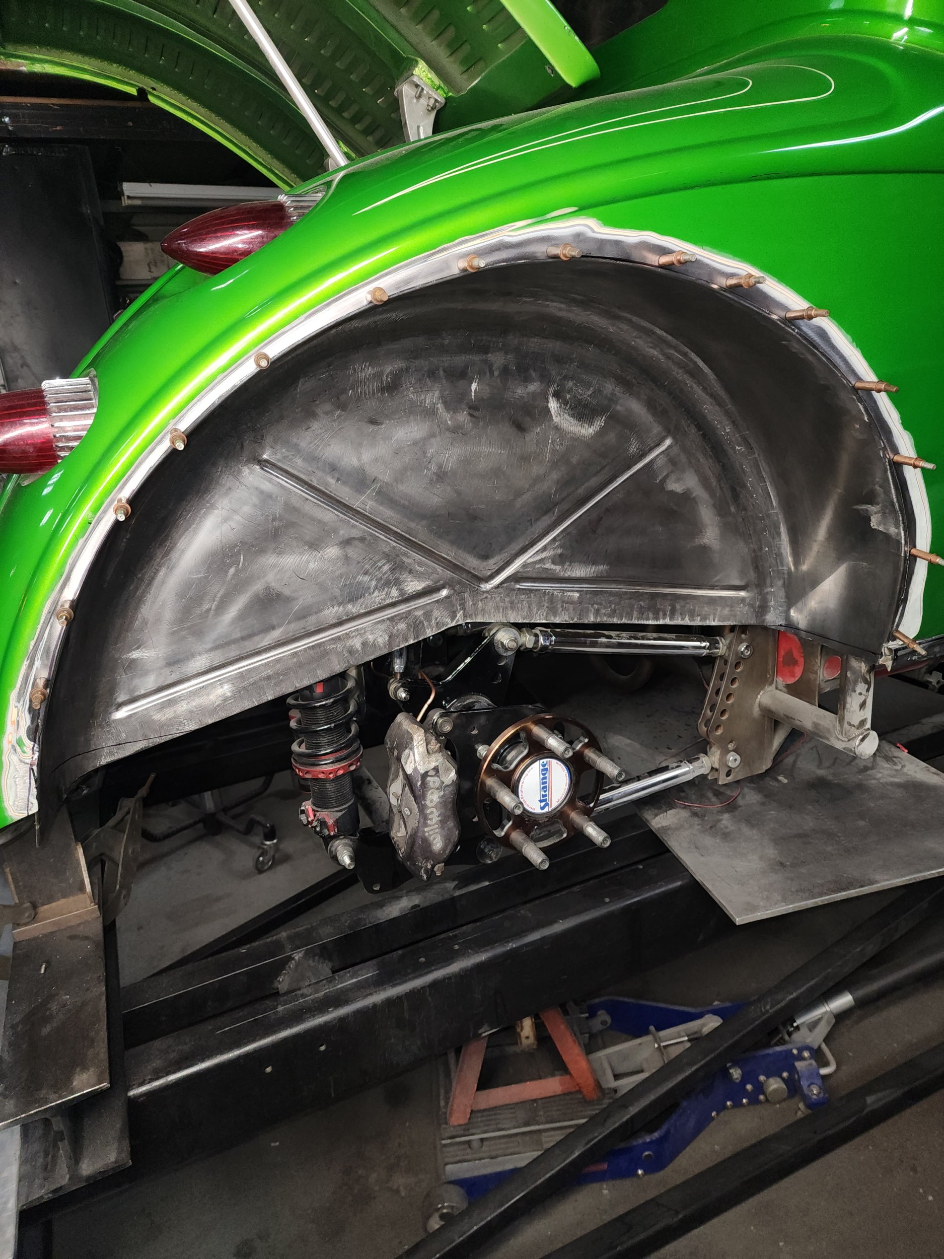

  5. The tubs are three pieces that are welded together. Alot of time was spent on the english wheel. Beads were rolled in for strength. A lip was rolled into the edge. The tub will be cut 1.5 inches from the edge. It will be welded to the body. The rest will have dzues fasteners holding the main section in place. This way i can have them powder coated for durability. I can remove them to work on the suspension.
    The kill switch was relocated. The brake lines are done.

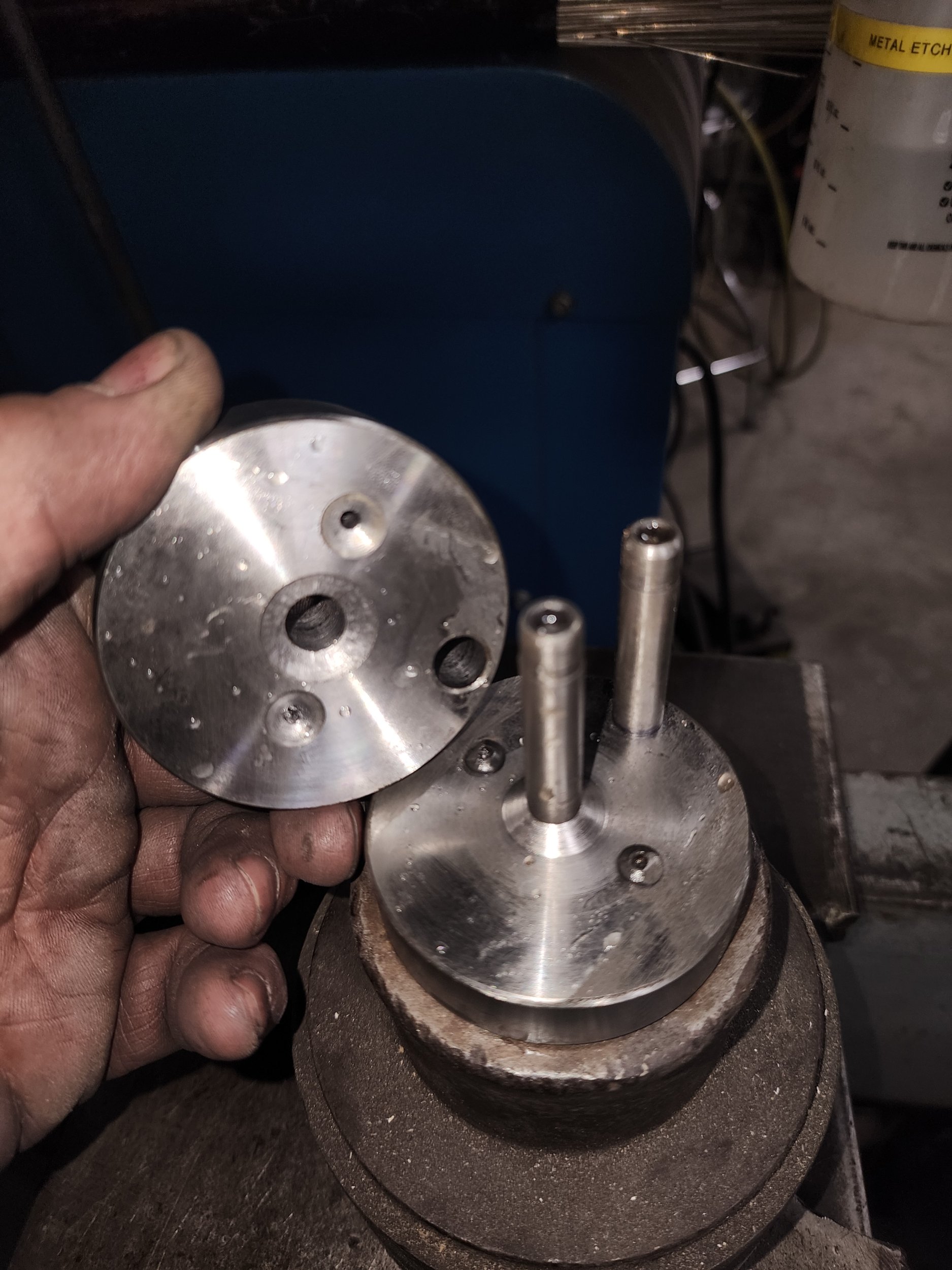

    A die needed to be made for the dzues fasteners. Three holes need to be drilled. One hole needs a taper. The die will locate all three. The hard part is over. It should be done soon. Then off to the body shop. 20241115_164617.jpg 20241115_164632.jpg 20241115_164640.jpg 20241115_164659.jpg 20241115_164722.jpg 20241115_164740.jpg 20241115_164756.jpg 20241115_164806.jpg
