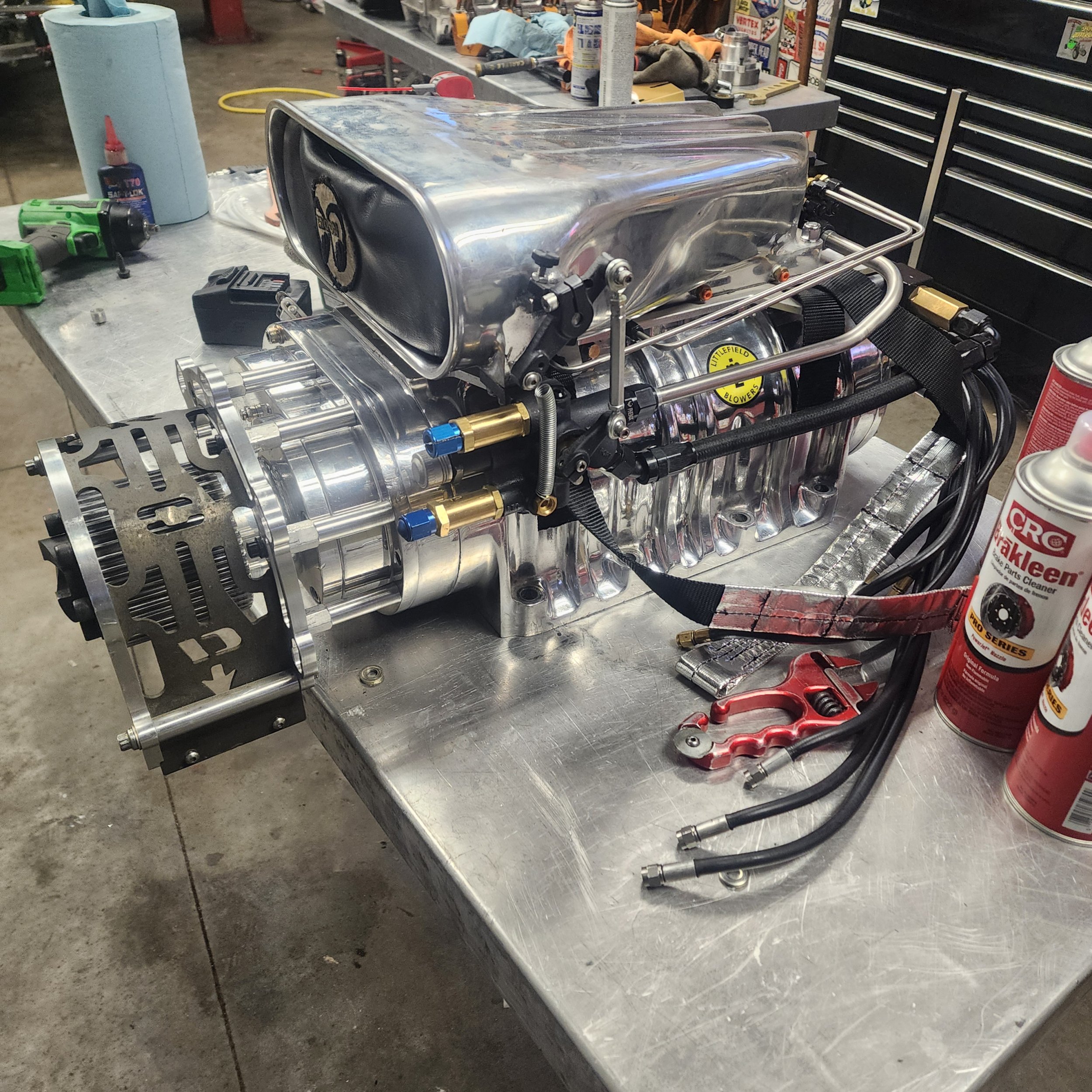

  7. Blower is back from a full service. At pri for the next few days.

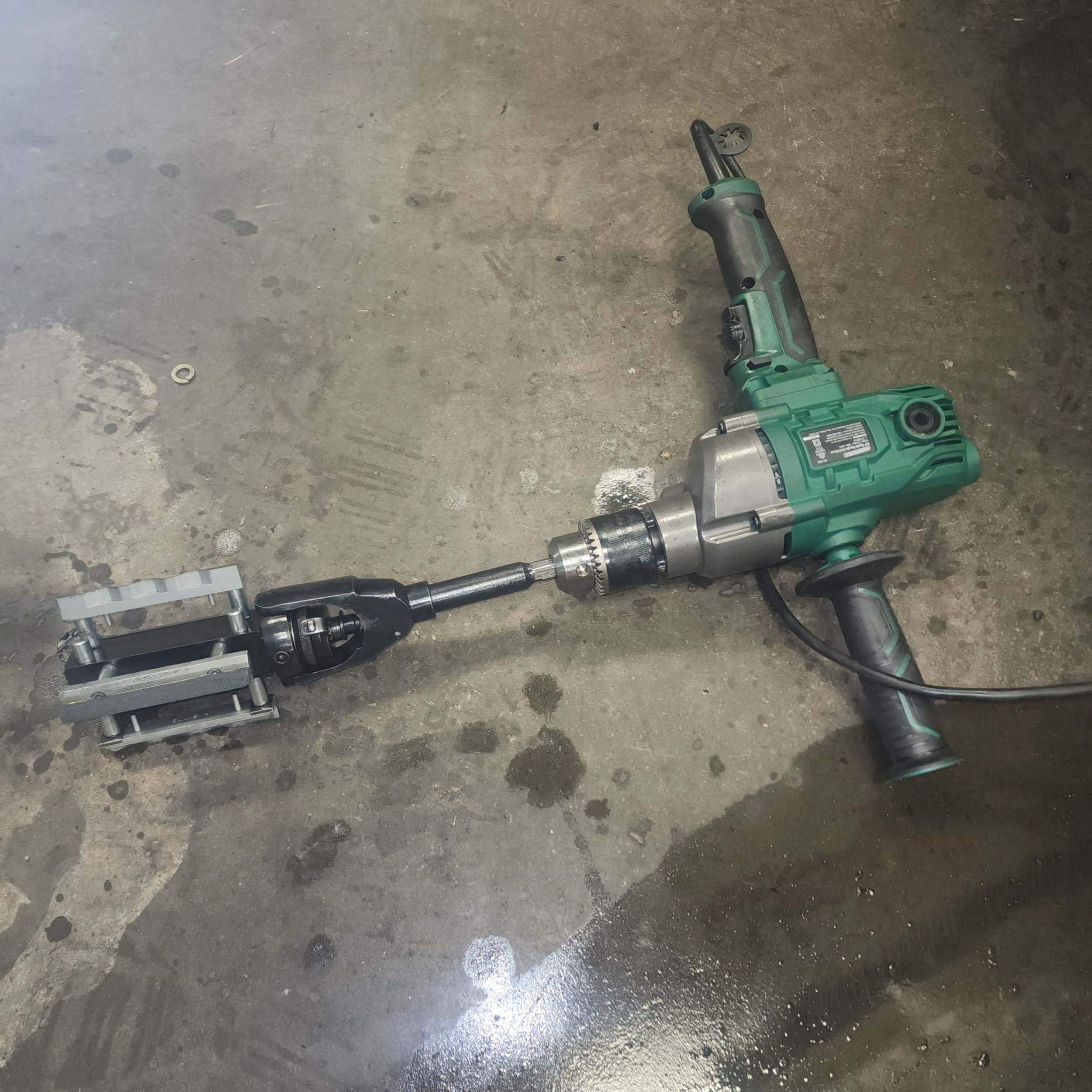

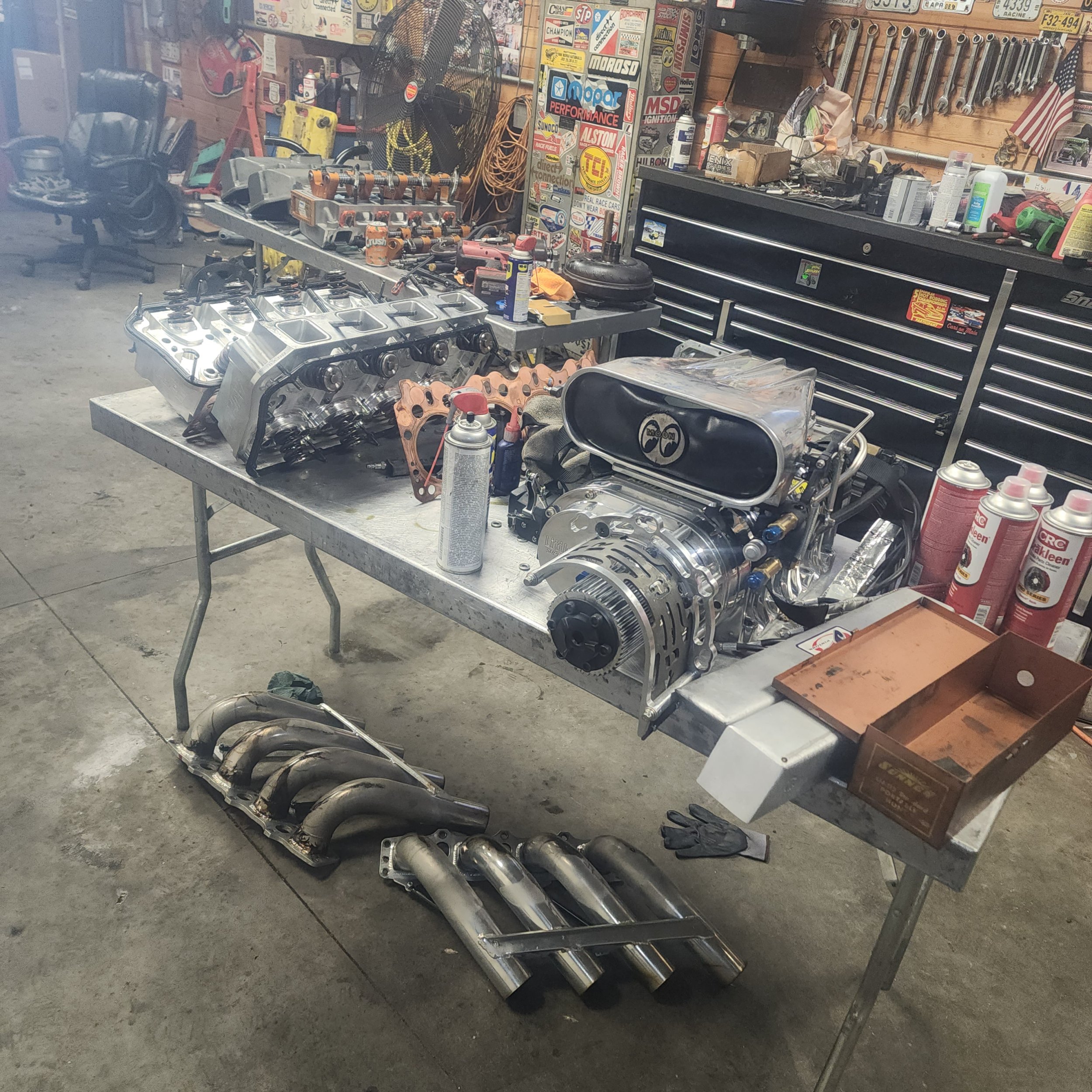

  9. I came home from the pri show and got to work. I pulled it all apart. The heads looked good. They will get serviced soon. The blower and injector are back together.
    I did find that number sevens second ring was pinched. This cylinder gave us trouble all year. New rings were ordered. The cylinders were honed. To do it right you need the right tools. That being a sunnen rigid hone and a 5/8 drill. The rigid hone will make a cylinder round if it scored or worn within reason. The max pressure is applied. Honing oil or wd-40 is used. The drill needs a tight grip. I do this work with the block in the ch***is because its safer. Theres a chance of flipping a engine stand over. The hone only needs a few revolutions. Measuring before and after is a good idea. I went from .008 to .009 well within the allowable .012 they look great. This stone provides a rough finish. I follow up with a dingle ball hone to knock off the sharp edges. Again only a few revolutions are needed. Brake cleaner and rags until they are clean. Then coffee filters with atf until clean. The block will be removed on Wednesday. 20241214_153853.jpg 20241215_160314.jpg 20241215_160331.jpg 20241215_160340.jpg

  10. DDDenny
    Posts: 22,480
    I have a hurky old 1/2" Milwaukiee, the thing wants to hurt me every time I use it.
    Johnboy34, porkshop and rc57 like this.
  11. 19Eddy30
    Joined: Mar 27, 2011
    Posts: 4,006
    19Eddy30
    from VA
    **2 , I was thinking same thing when seen earlier this morning ( drill)
    Mid 80s Direct drive 1/2 or 3/4 chuck
    Has hurt me More then few times , would catch , Broke secondary handle off stripping thread out ,
    Even after letting off trigger ,keeps on spinning , pulling plug out of wall ,
    Winding its self up!
    Arm breaker !' After about five times ,
    I only use to stir up pant / liquid.
    I know honing is different than actually using it as a drill

    When I was in the Automotive Machining program at Ferris State, we had a cradle to hold the block with the cylinders upright at floor level. Then the 5/8" drill motor was suspended from an arm with a counter balance spring over the block. The auxiliary handle was about 2' of 3/4" pipe.
    We would have contests seeing who could hone a cylinder round and straight the fastest. The co**** stones were run dry. Took a bit of muscle to manhandle that thing and you'd better be paying attention so you didn't hang the hone on the main webs.

    Dad has a similar drill. It came out of an old drill press. All aluminum body, direct drive, no clutch. We had to drill out some old, old concrete to install a drain pipe. Burnt out his normal hammer drill, so we decide to use the drill press drill. 2' of water pipe on the handle. It bit, threw me off the handle and kept spinning until it had wrapped up all the cord and pulled the plug. That thing is like a 9" grinder... it spends its days idle, thinking of ways to maim me.

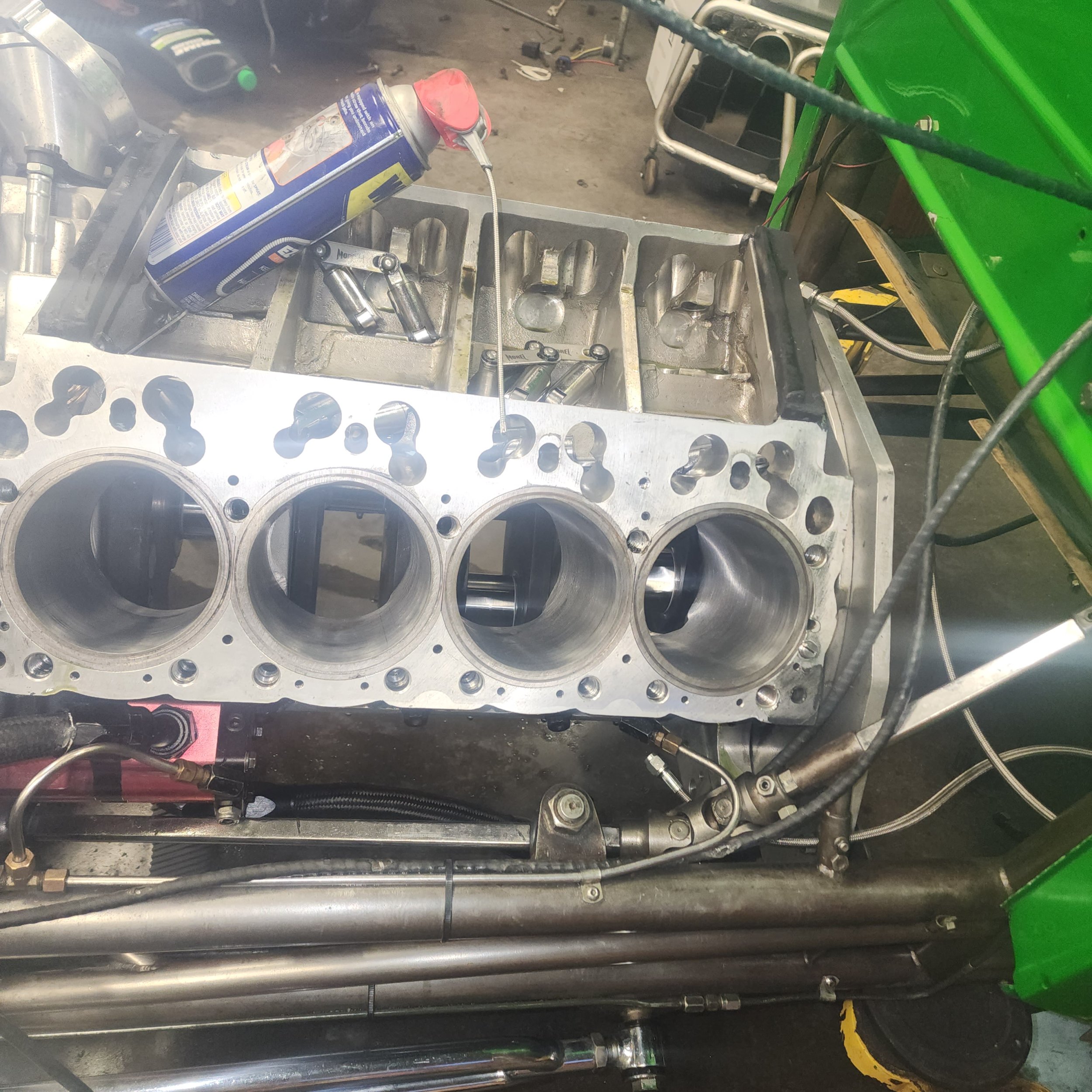

  17. I mentioned having the right tools. We all know how important they are. For measuring the bore there are a few options. A snap gauge and micrometer is the least accurate. It will get you close. Then there is the inside micrometer. This is much more accurate. The rods are one inch longer than the other. The micrometer is built in it's the rods that change. There is a third option that being a dial bore gaue. The accuracy depends on the quality of the gauge. You get what you pay for.
    The engine came out today. Only the crank needs to be removed. 20241218_163654.jpg 20241218_163701.jpg 20241218_163712.jpg 20241218_163749.jpg
    enloe, Okie Pete, Tim and 11 others like this.
  18. My buddy Jim that gifted the vette to me was over helping out. Jim is a retired tool and die maker. He is so exited to use his skills on a nitro hemi. He says he can't wait to tell his friends what he was doing today. It makes me happy to see him happy. He has alot of knowledge to share. He teaches me alot. I don't take it for granted.
    The block wouldn't fit the way we wanted. We tried several things. We ended up using square tubing to extend the deck. A tap was screwed into a hole for indexing. It was within .0005. The stud holes in the deck on the exhaust side are pulling threads out. I have heli coiled three already this season. The high heat on this side of the block softens the aluminum. I have already gone from a half inch stud to nine sixteenths. The heli coils have 20241219_170940.jpg 20241219_172943.jpg not pulled out. So we are doing the rest now. Pulling a stud will result in a blown gasket. We check the head bolt torque after each p***
