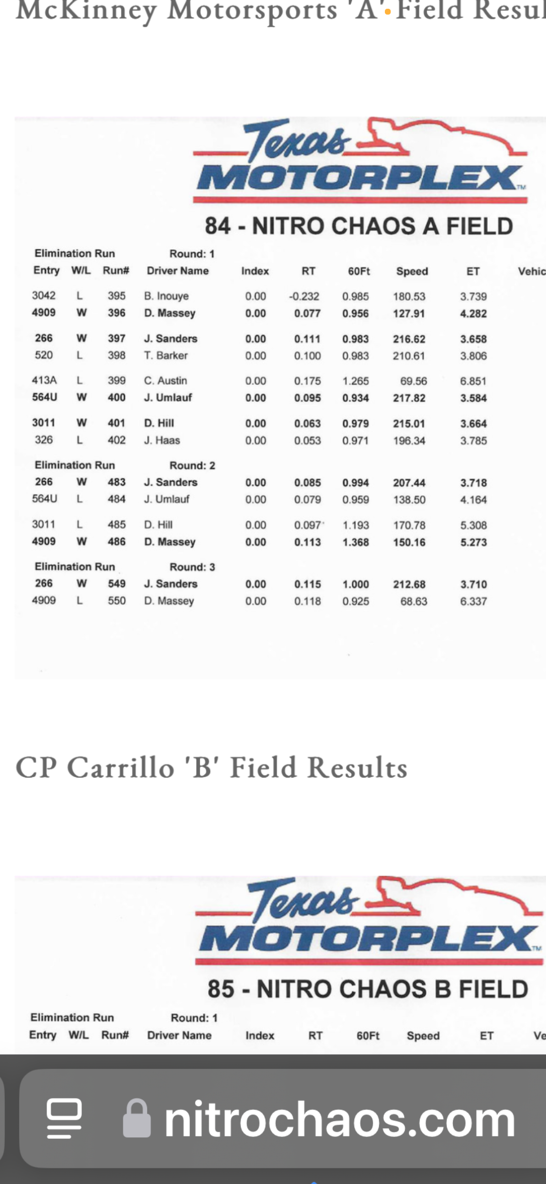

    Elimination Results:
    & Qualifying
    chryslerfan55 and porkshop like this.

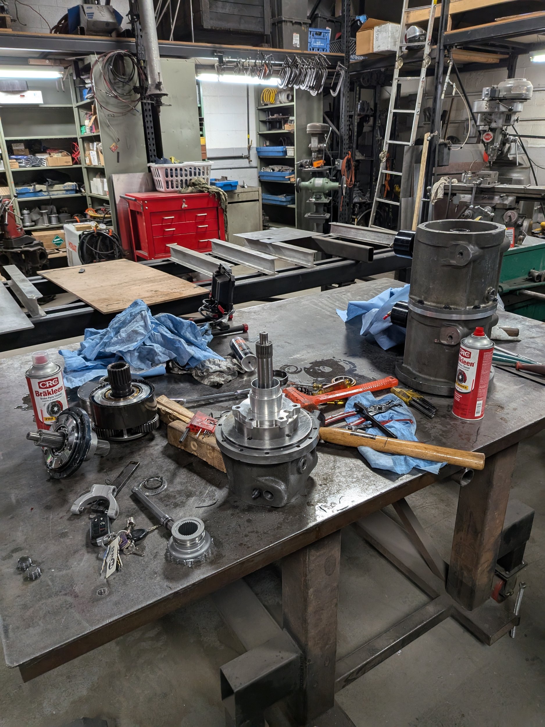

  23. Unfortunately the converter broke. I drove home today and pulled it apart. It will get sent out Tuesday. I have secured another while it's being repaired.
    On a positive note Jerry Newman turned up the power. It sounded and felt like never before. PXL_20250524_235219572.jpg

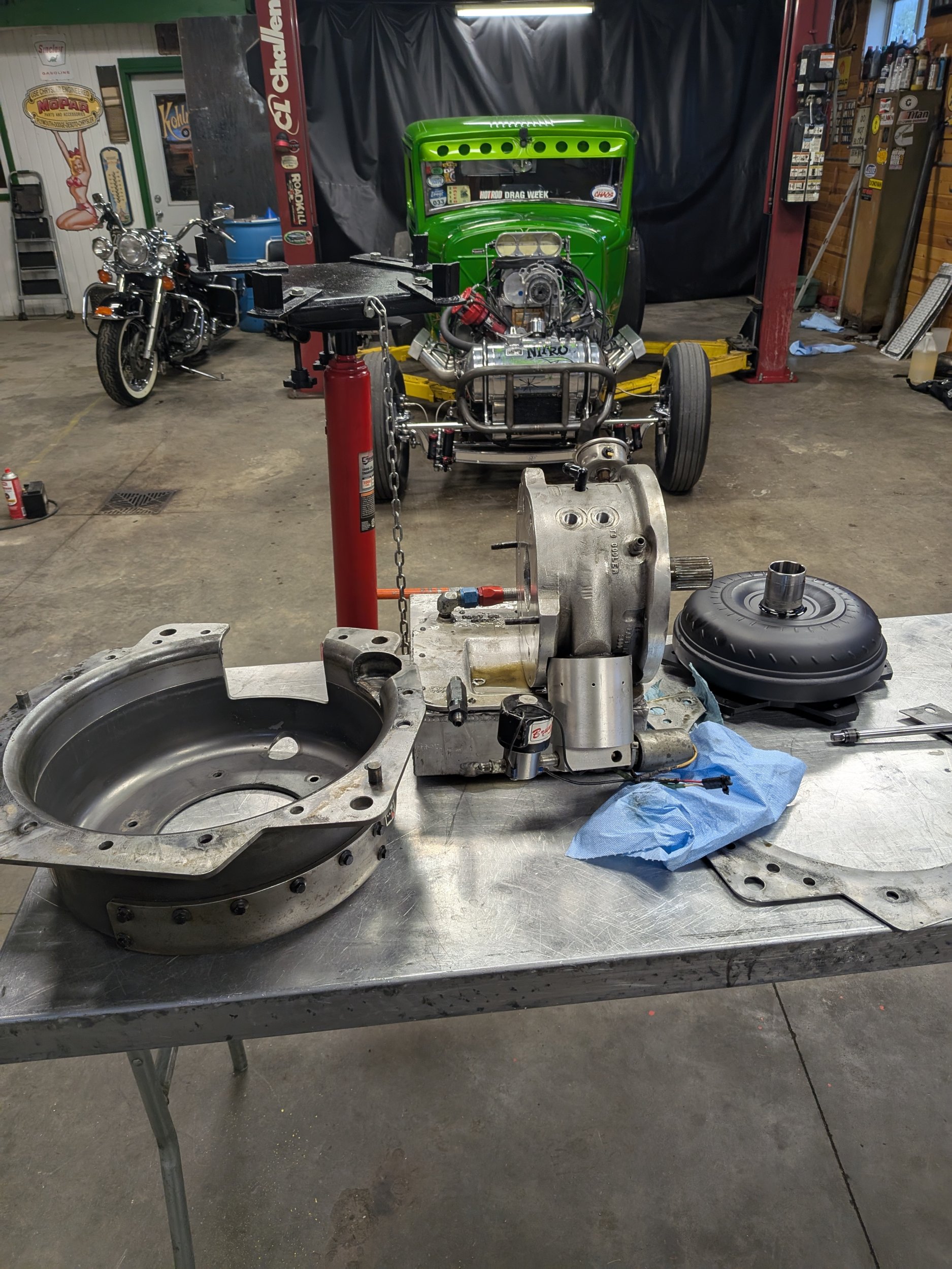

    Do you know what broke in converter ?
    Does not look to be serviceable unless cut open.
    I seen Friday Night @ start up ,
    Could not tell if started before water box , if so is that when broke when you went to engage forward ?
  28. It turns out the converter didn't break. I changed gears from a 1.25 to a 1.34 for a better 60 foot.
    I have changed gears for decades and never ran into this issue. The 1.25 uses a different shaft. It's smaller by .050 so the splines were not engaged. It's a easy fix I just put the 1.25 back in. I guess those things happen when you have no sleep and your in a hurry.
