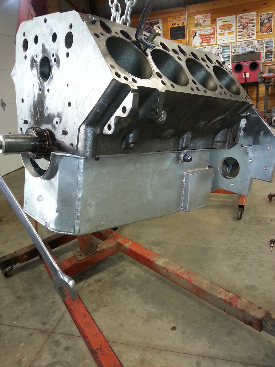

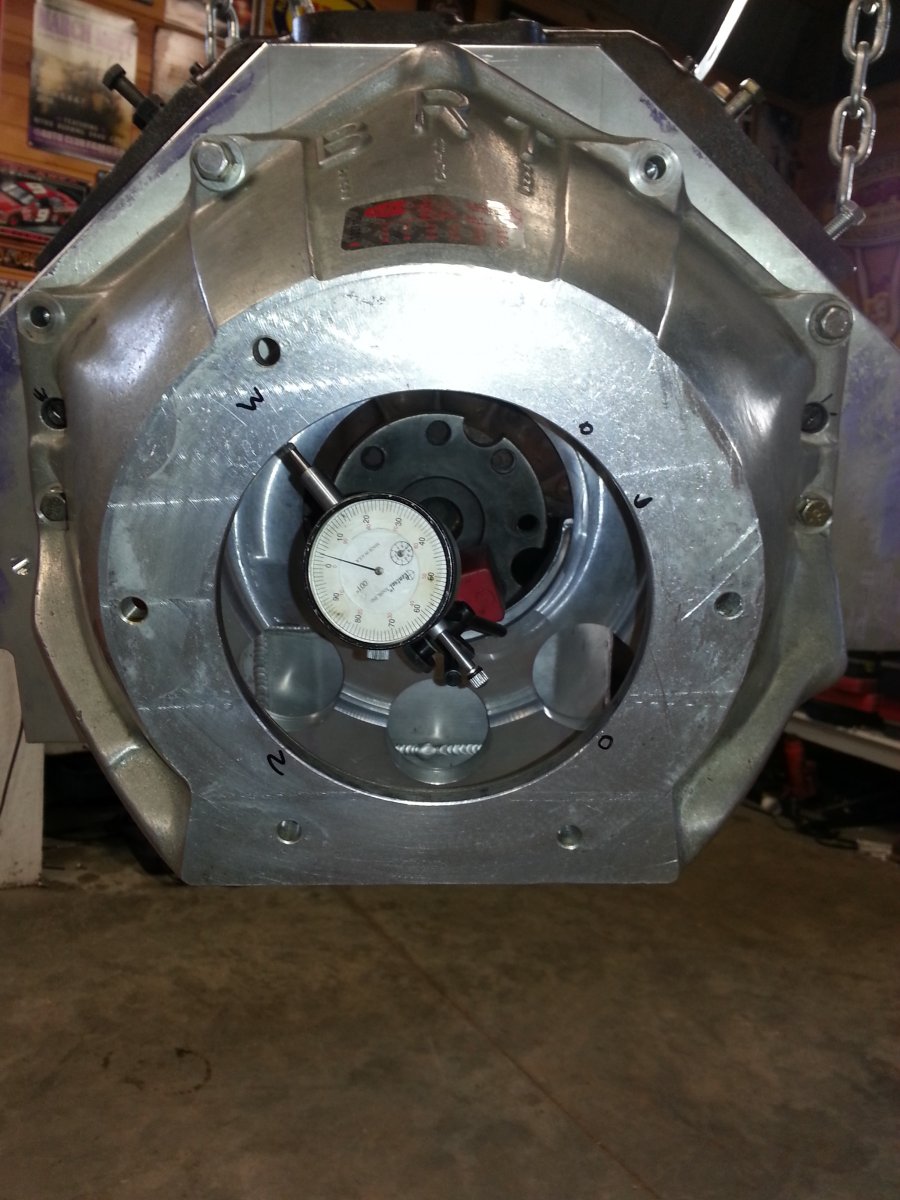

  4. 20160309_163502.jpg 20160309_163522.jpg I finished up stripping the block. Im glad thats over. I also indexed the bruno bellhousing. It came out within .003 thats good enough. I always scribe around the bellhousing in case it needs to come off outside of the shop. I can then get it real close. Its crucial to get a bruno dialed in correctly. On the 65 i had it dialed in then changed cranks. The registering hole was drilled .070 off center on the new crank. The result was oil pushing past the seal. It ran onto the spinning converter then flung onto the hot headers. Its amazing how atf can burst into flames. It was no fun being on fire at 190 mph with smoke so thick you cant see your hands on the wheel. Not to mention expensive having to replace fire bottles aint cheap.I could see the flames blowing into the car through the window area. It would have been kind of cool if it wasnt so dangerous. Fires are crazy. I dont need any more than i have already had. I will put the flex plate on and check the converter clearance. There needs to be .100-.125 forward and back movement. Its good practice to check this stuff now so there are no surprises later.

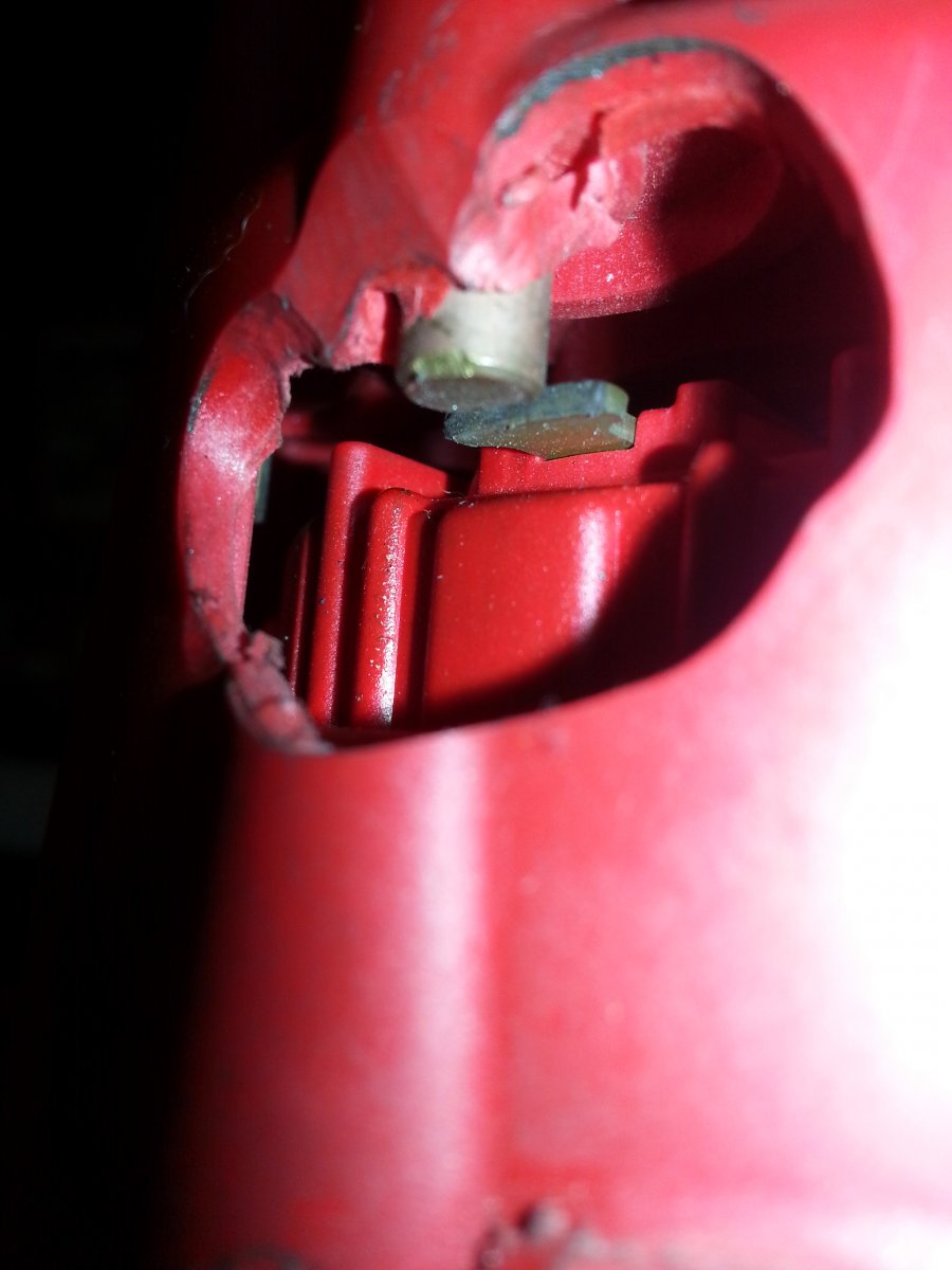

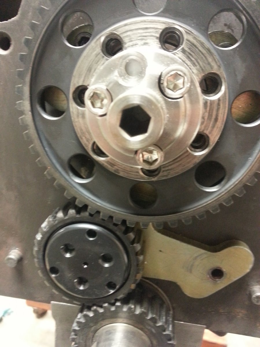

  9. 20160312_190001.jpg 20160312_190419.jpg Hot heads has come through again. Finding a drive spud was proving impossible. The drive is unique to the early hemi. Its similiar to a big block mopar but different. There is first the spacer. This bolts directly to the cam. The slot in the gear drive hub needs a key driven into it. I had to machine the end of the cam a little to make a 3/16 key fit.
    This key goes into a slot in the back of the spacer and keeps the spacer from spinning. The center bolt isnt enough to do the job alone. This bolt is hidden once the spud is put on. This setup drives the fuel pump and magneto. The parts are very well made with nice tight tolerances. nothing was needed to make them fit perfectly. These parts look simple and dont have the wow factor of a blower but without hot heads coming through the car goes no where on nitro. over the weekend the body made it back to illinois. I started on the engine ***emble. I got the crank in along with six pistons so far. The cam is degreed and tdc confirmed on the new timing cover. the short block will be finished tomorrow

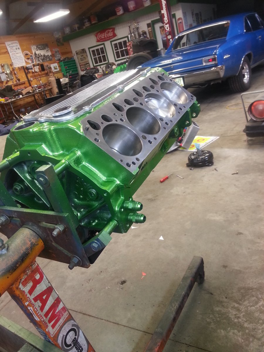

  11. 30 minutes later presto a painted short block. I think the pa 20160315_133508.jpg 20160315_133414.jpg 20160315_133616.jpg int fumes are getting to me. I have to get out of here.

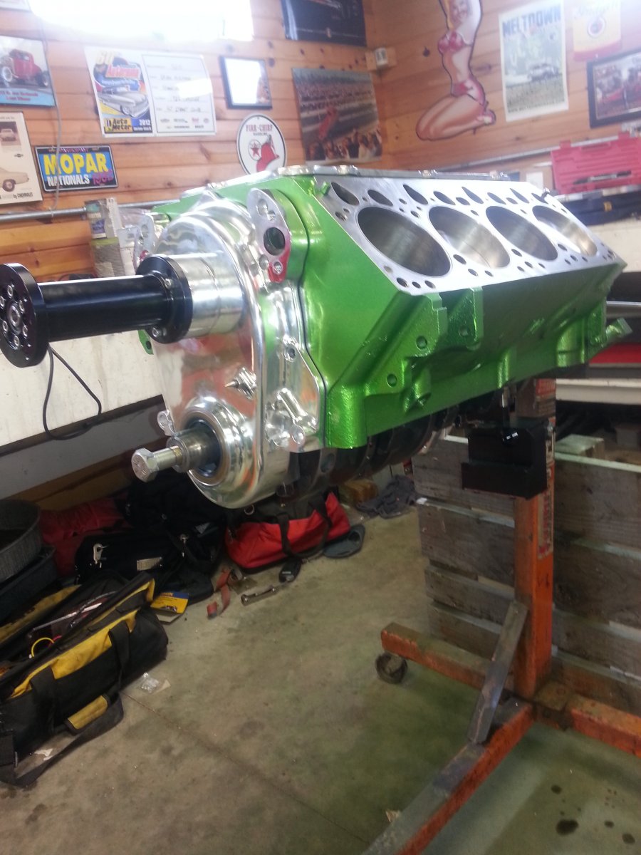

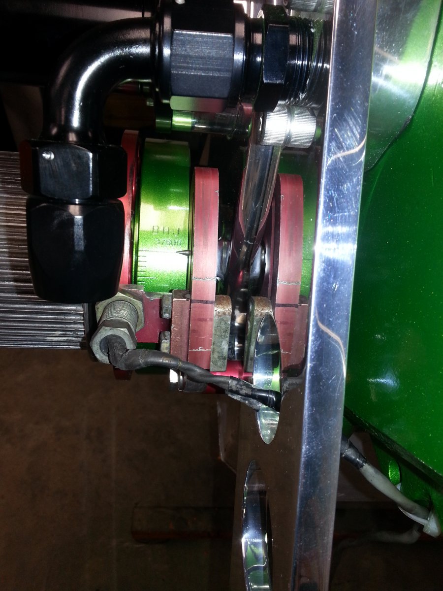

  20. I got a little more done on the green monster. I dont want to go over each step of the ***emble. Most of us have built a engine before. I will touch on a few things that are a little different to this build. Due to the severe duty this engine has to live through it is used as a poduct development piece for several companies. The roller lifters are from hot heads. Two years ago we locked up a roller lifter. The lifters were sent back to the manufacture. Bob myself and the lifter company president all got together to come up with a better product. The lifters i have are a experimental set. They have holes drilled into the bodies to pressure lube the axles. So far so good. There have been no more axle failures. To set the timing tdc true tdc needs to be established. We use a piston stop and a degree wheel. The hot heads timing cover has a adjustable pointer making the job easy. The timing on the car is done in three ways. The crank trigger needs to be set at 50 degrees btdc. A magnet on the trigger wheel needs to line up with the pickup. The wheel has several patterns drilled into it. This must be correct. Then the engine gets rolled to tdc. I use a 20160316_220430.jpg 20160316_231552.jpg 20160316_225902.jpg 20160316_224342.jpg 20160316_225706.jpg old distributor cap to verify correct rotor phasing. These two timing steps are for the efi. The mag goes in at 40 degrees. We use a buzz box to set that. The wires for the efi are carbon core while the mag wires are solid core. hot heads offers a sfi certified balancer that makes it easy to set the timing and lash the engine due to it having the timing marks machined into it. there is no longer a need to use a timing tape that just falls off. the balancer is offered with pulleys for a number of different uses that are all designed to work together to get the right spacing. it really makes life easier. The fitting on the oil pan are for oil return from the valve covers. More on that later.

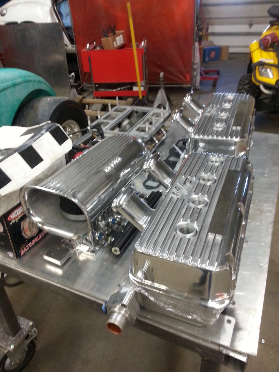

  26. 20160319_155435.jpg I started with a pile of parts today and finished with a engine ready to fire. Trying to build whats basically a race engine that i can drive on the street has special needs. My hot heads hemi heads are o- ringed. Several years ago we changed the height off the deck from .015 to .008 due to leaking anti freeze. The extra height was holding the head from sealing with the deck. we use silicone to help seal it all up. The maniflod runs a divider for better fuel distribution. This is something learned from the dragster. The manifold is torqued into place. Its then filled with rags and sanded flat with a large plate that has sand paper glued to it. We o- ringed the manifold so we dont need to replace the paper gaskets when the blower comes off. The blower is torqued to 25 inch pounds. Any irregularities on the deck are transfered to the blower case. With the tight clearences in the blower these steps do make a difference. The roller rockers are hot head items. Its starting to look like something now. 20160317_103331.jpg 20160319_110141.jpg 20150503_201206.jpg 20160319_155405.jpg 20160319_155426.jpg 20160319_155535.jpg

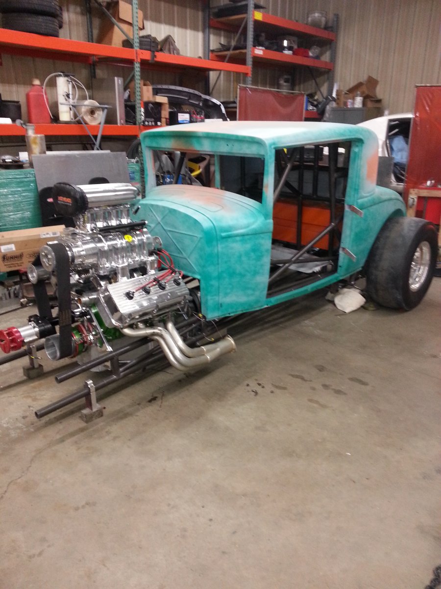

  29. The body shop had extra paint in a gun. So they put some color on it. It just needs to be blocked out now. Jimdidnt want it finish painted in case there is a fire from welding inside the car. I thought it was a good idea also. Whats another trip do the body shop.
