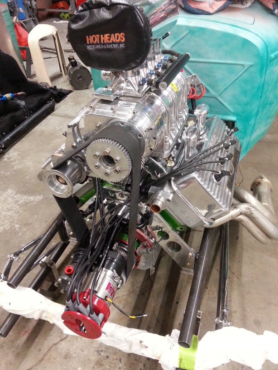

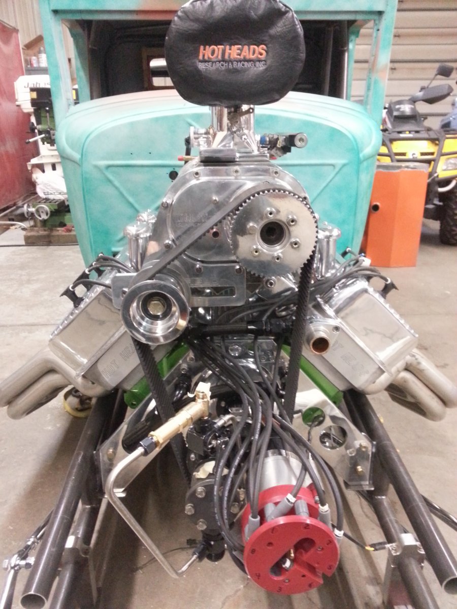

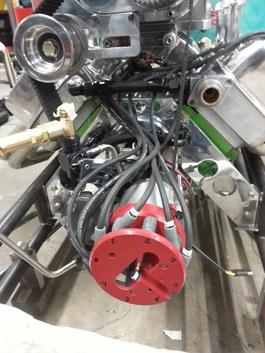

  2. The fuel pump showed up today so i ran down to the ch***is shop and got to work. I got the pump mounted first. Next was the timing for the mag. then put the wires together for the mag. i ran the wires inside the blower belt to keep them out of harms way should a belt break. 20160321_174838.jpg 20160321_174816.jpg

    The front of that motor sure is busy, but it has a great look to it!

  5. thanks guys. it will get a little busier. i still need to mount the alternator; moon tank; grille; fuel lines; two coolers; system one oil filter; two fire bottles and fuel shut off. I'm in the process now of making all new hoses. i couldn't see putting on the old stainless hoses with red and blue fittings. against the green and black i think it will look nasty. so I'm replacing everything with black hoses and fittings. I'm hoping they will just blend in and go away. the new hose is 1/3 less weight as a bonus.
  6. This thing is all sorts of busy... and for what you're doing with it.... it'll get busier!
    Dual purpose street/strip gas/fuel all fitting in that little coupe... Dayum!
    Great to see it coming along and I hope everything works as planned and intended!
    Sent from my LG-LS980 using H.A.M.B. mobile app

    That front drive distributor is crazy looking but business looking all the same.
  8. the parts on the front are really just standard nitro parts. racers run the mag out front so the blower can be moved back on the manifold. otherwise the mag gets in the way. im just mixing my race and street experiences into a build I have thought about for a while. im very happy and proud to announce we have partnered with hilborn fuel injection. I have been working with them since the pri show. they like my idea of running the first car on drag week with nitro. they also like the idea of running a car combining efi and mechanical injection using their products. hilborn has offered full support from their technical and parts departments to make the project a success. we have had several in depth conversations regarding all of the technical hurdles that would need to be overcome. they think I have a solid plan in place. hilborn has been in the injection business since the 50s. their connections and access to the movers and shakers in the sport are endless. having their support behind me is huge.

    I hope the dual drive holds up on the street. Just looks like a lot of weight hanging out that's un-supported. Ever think of a craddle for under the mag to help support it ? Just wondering, also seeing I have a 2 port Hilborn set-up , I'll be watching to see how your travels go, good luck down the road.

    I agree that I think I would like to see some support on all your front engine parts. Street driving and more so your wheel stands will be hard on all those parts. Your car is so great I can not do it justice on this key board! Have a great Easter, Gary

  14. great observation guys. jim and i are very concerned about the weight. we have discussed this in detail and we do have a plan. i just have not mentioned it. we plan on having a collar on the mag. a shaft will connect to the idler pulley bracket. we will have heim joints with right and left hand threads so we can adjust the tension. it will all fit inside the blower pulley. it also needs enough adjustment when we disconnect it to drive on the street. when this car is done i sure hope to meet everyone who is following this build.

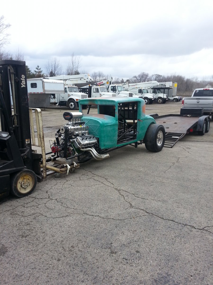

  24. 20160401_192558.jpg Everything went smooth picking up the car today. My time for inspection is 8:15 sat. It should be a lot of fun. S.e. wisc. Forcast is calling fot
    Temp a balmy 38
    Wind sustained 20160401_161759.jpg 20160401_174234.jpg 35. Gusting to 50 mph
    1 inch or less of snow
    the rear end is all done now. The anti rollbar is removed in this pic. The drive train is all in. I just need to get the driveshaft shortened.

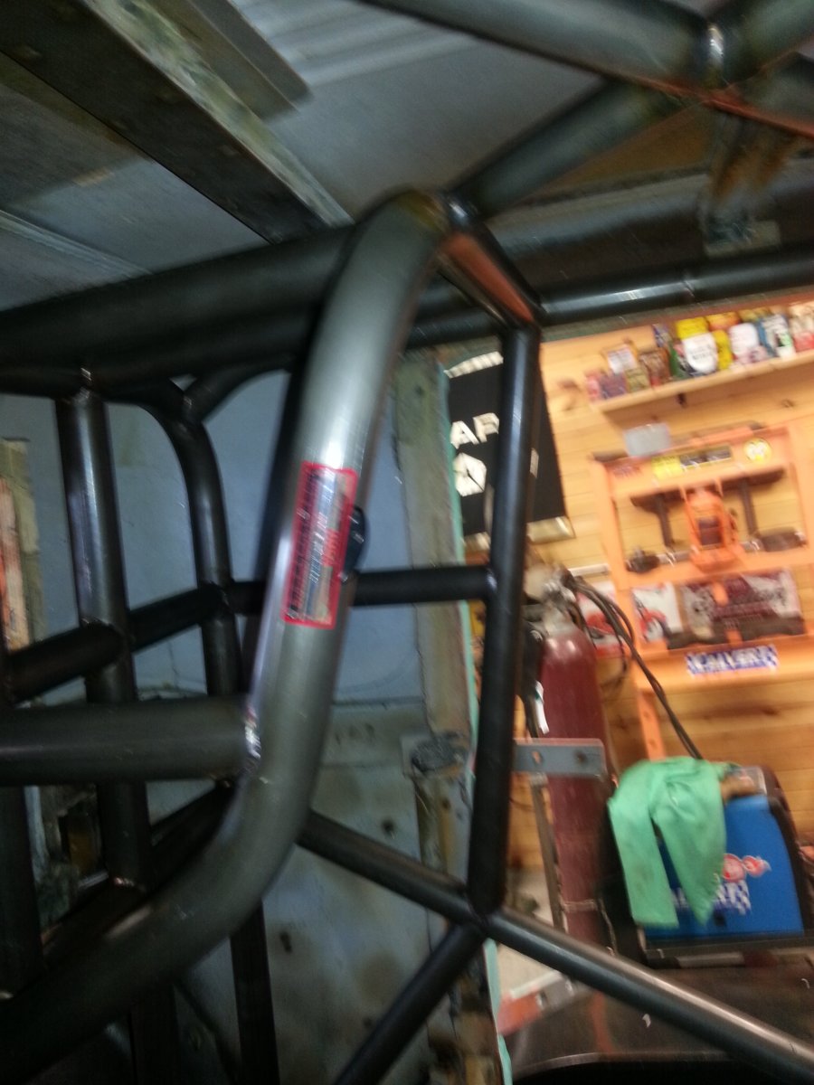

  28. 20160402_085443.jpg 20160402_085426.jpg 20160402_085810.jpg 20160402_095405.jpg 20160402_095419.jpg Well that was fun. Almost white out conditions at times with the blowing snow. I was the first car through the inspection. Mission accomplished. I went for a pro tag. Thats 7.49-6.50 with a red sticker. They measure the outside diameter of each bar then sonic check it. The welds are checked to make sure they go all the way around. They use the ch***is drawings to make sure all the bars are there and in the right places.
