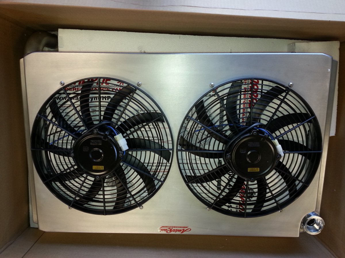

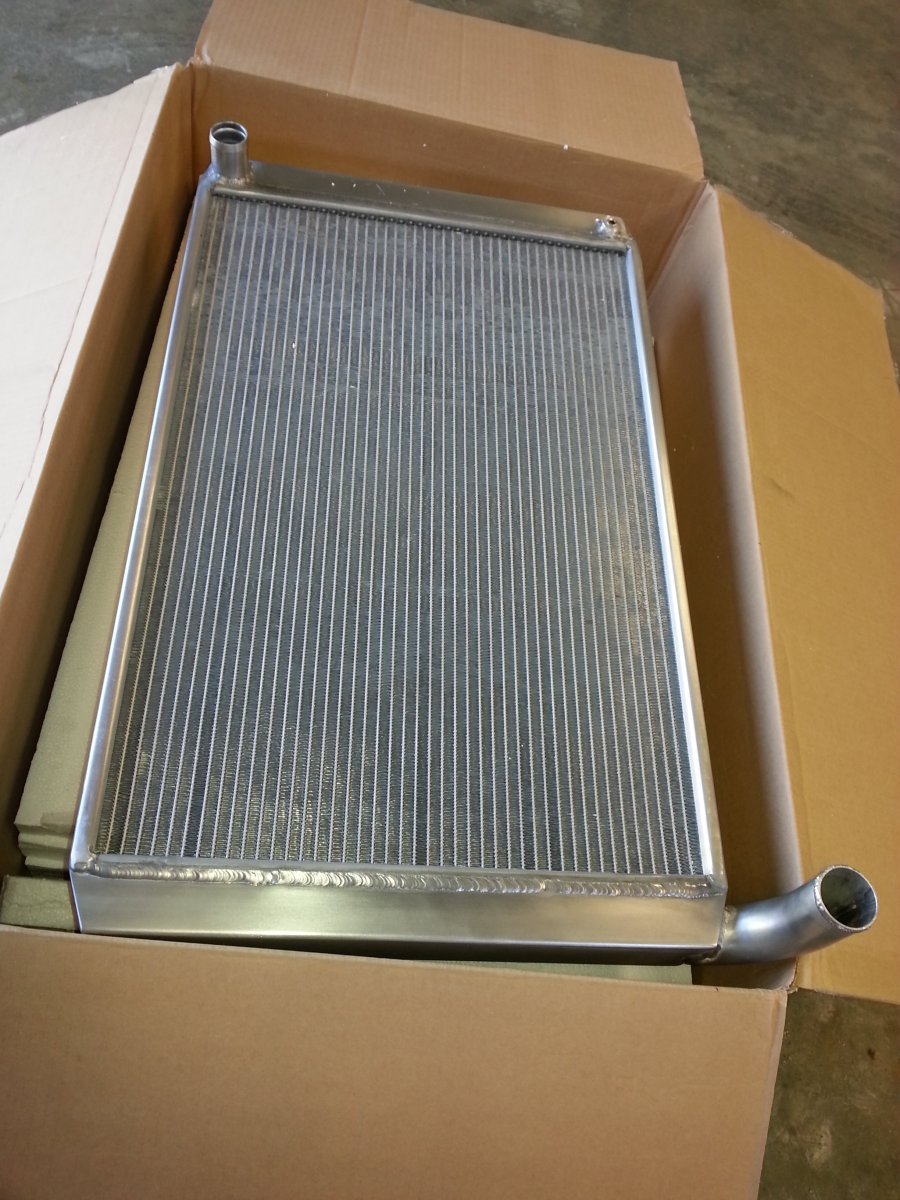

  25. 20160518_101038.jpg 20160518_101058.jpg A key piece of the rebuild showed up today. This custom radiator was built to my specs by jimmy walker owner of auto rad radiators. I have known jimmy for 30 plus years. He worked at Modine radiator in Racine wi. His position was testing and developement before moving to Georgia to start his own shop. He also built the previous one that got destroyed in the crash. The new radiator is a cross flow design. It measures 20x30x3. It has two 14" fans mounted in a custom shroud that flow 4270 cfm. The fans draw 18 amps each. Thats why i upgraded the alternator to a 185 amp unit. Hooked to the meisere water pump I don't think cooling will be a issue.

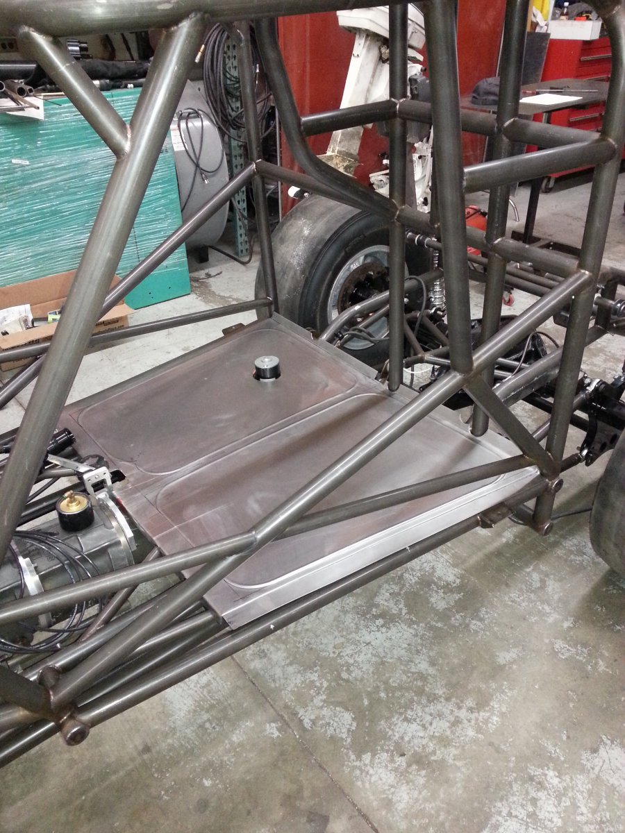

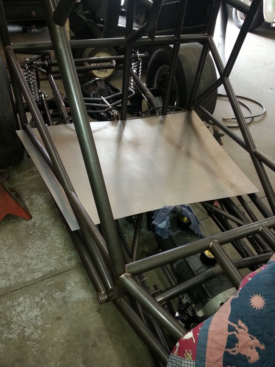

  26. 20160516_162516.jpg 20160519_090120.jpg 20160519_090215.jpg The tin work has started. Due to the rules regarding nitro the floor needs to be steel. A cap will cover the fuel pump. The stepped edges are put in with a machine that hammers them in. The front area will be made in three pieces. the radiator was test fit this morning and all is good with that.

  27. rooman
    Joined: Sep 20, 2006
    Posts: 4,045
    rooman
    Actually it is hard to find anything in the NHRA rules that applies directly to your project. Probably the closest is the Pro Mod rule that says that the driver's side floor must be .024 steel welded in place (with the proviso that the p***enger side can be .032 aluminum. That said, the Pro Stock rules mandate that the entire floor be steel (again welded in place). Interesting that a Pro Mod car that has double the horsepower and is 6 tenths (or more) quicker and as much as 35 mph faster yet has a lesser requirement.
    The Pro Stock rule was implemented following the horrific Bruce Allen/ Kenny Koretsky crash back in 2005 and typical of the NHRA rules makers they have not thought about some of the other cl***es that might have the same issues. Both cl***es also require paneling (steel or carbon fiber) in the forward portion of the driver's side X brace and Pro Mod also requires the same in the top of the cage, at least a far as the centerline.
    If you read the NHRA rule book as written, as far up the food chain as Advanced ET nitro is not allowed in sportsman racing although some ASO's (Alternative Sanctioning Organizations) do allow it (NDRL for example)
    Roo
    els and Finn Jensen like this.
  28. The car never had any intention of running a nhra event. Its not a dragster or funny car. The only nitro cl***es allowed. its also not a cl*** car. When the general rules are read there are bits and pieces pertaining to supercharged engines and nitro. Its not very specific to this car. I'm ok over building for safety. i have been on fire a few times. its never fun. i feel safer with a steel floor compared to aluminum. All I can do is try to cover all my bases. as you know a well built quality car with a concern for safety can do wonders when tech inspected.
