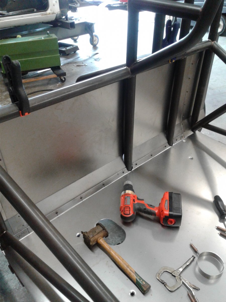

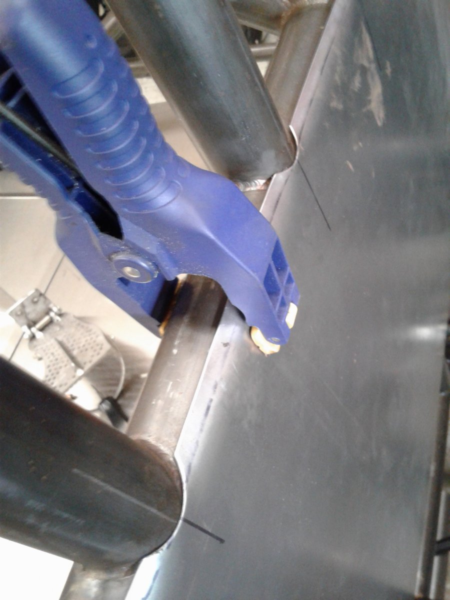

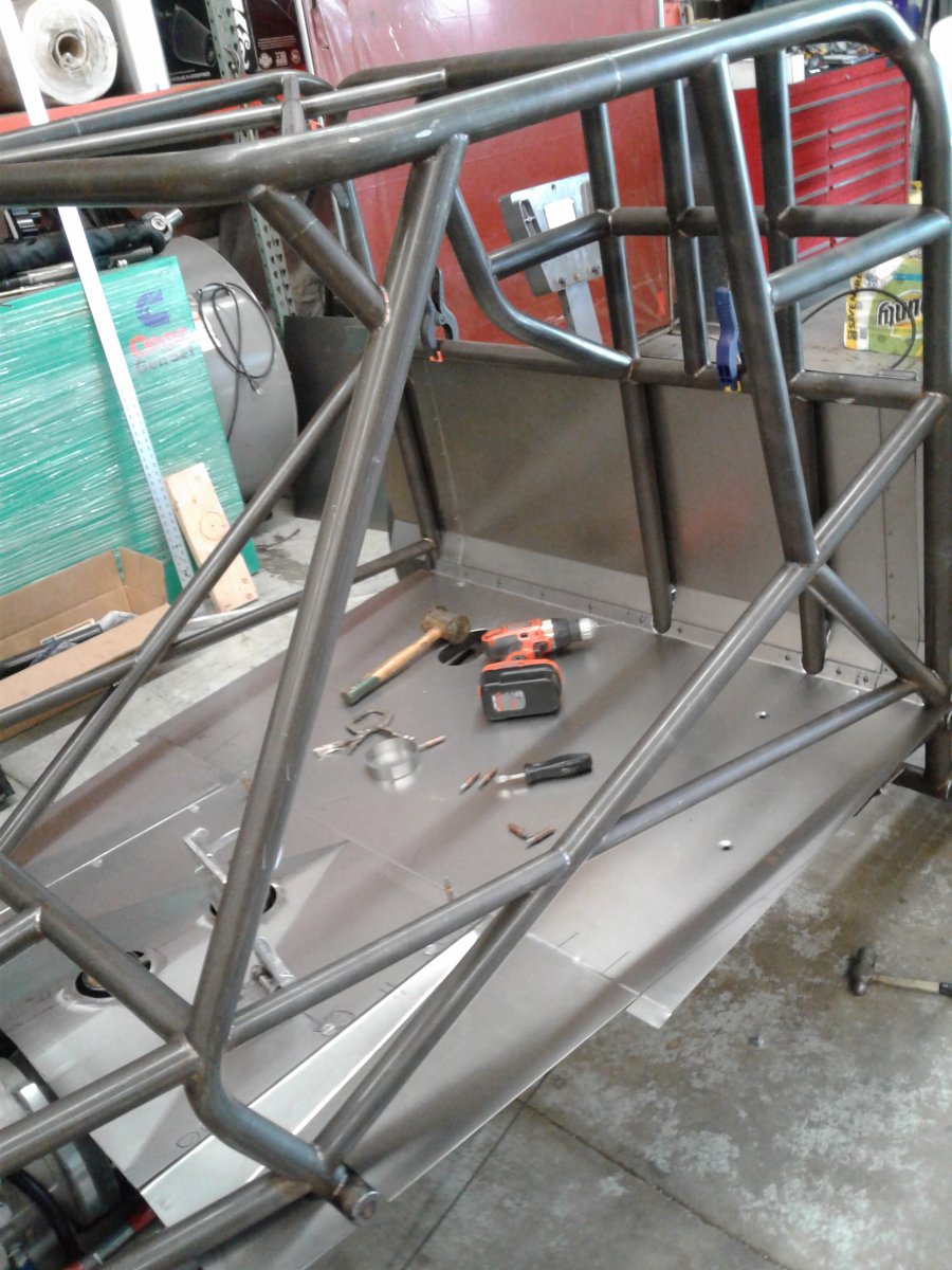

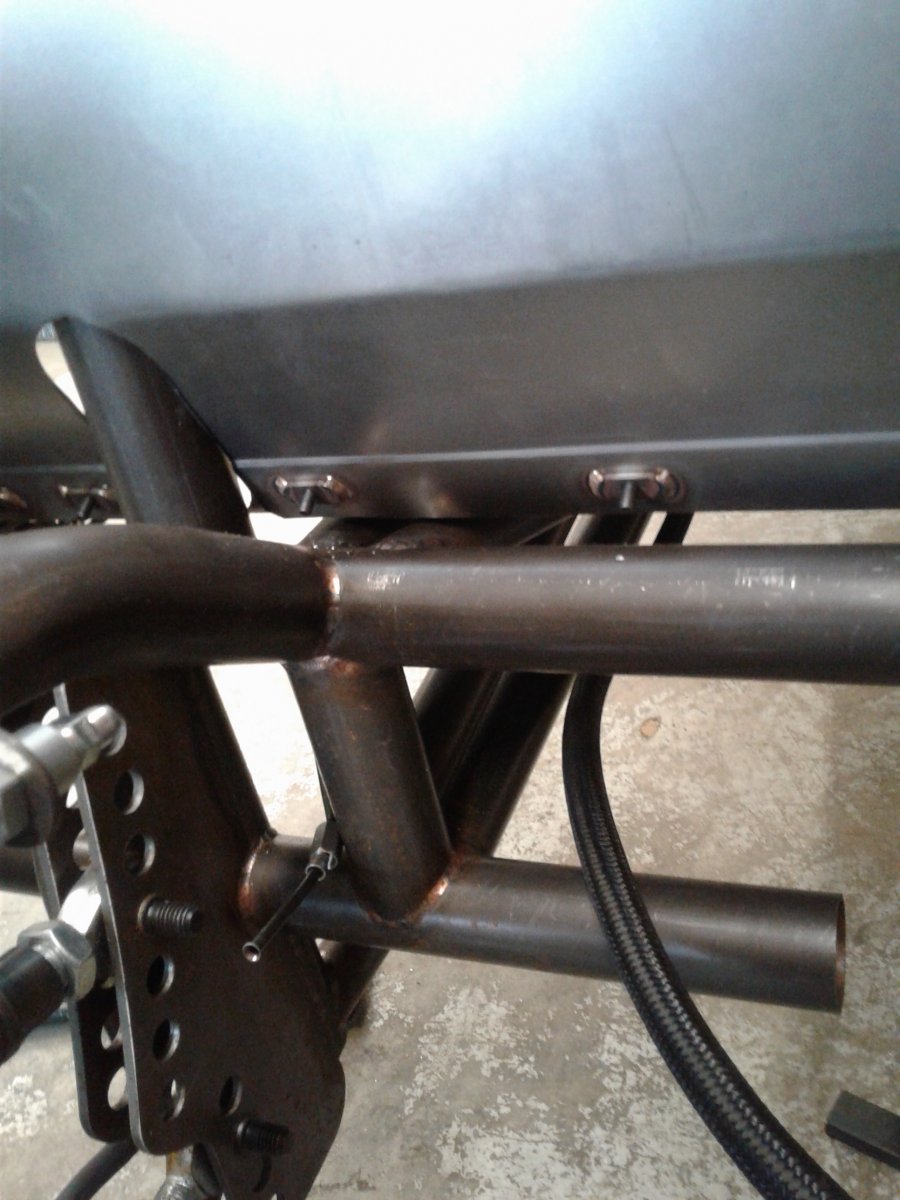

  3. They say the devil is in the details. It certainly is when it comes to the sheet metal work. At first glance the details dont show. After looking closely they start to appear. Things like rolled edges done with a leather hammer. Or the drilled and tapped tabs brazed onto the panels so pieces can be screwed together. i don't want everything vibrating. The tubes are exposed for future ch***is certifications. If everything was covered up holes would need to be put in for access. 20160527_161448.jpg 20160527_161519.jpg 20160527_164316.jpg 20160527_164345.jpg All of the overlapping pieces have a step in them so it all lays flat. The floor is removable. the edges need to be trimmed and rolled after the body goes back on. With the floor being steel i need to powder coat it. Im leaning toward a apple green. That way all of the details can be seen. On the other front i helped get the body onto the dollie so it can go into the paint booth. it will be painted this saturday or on tuesday.

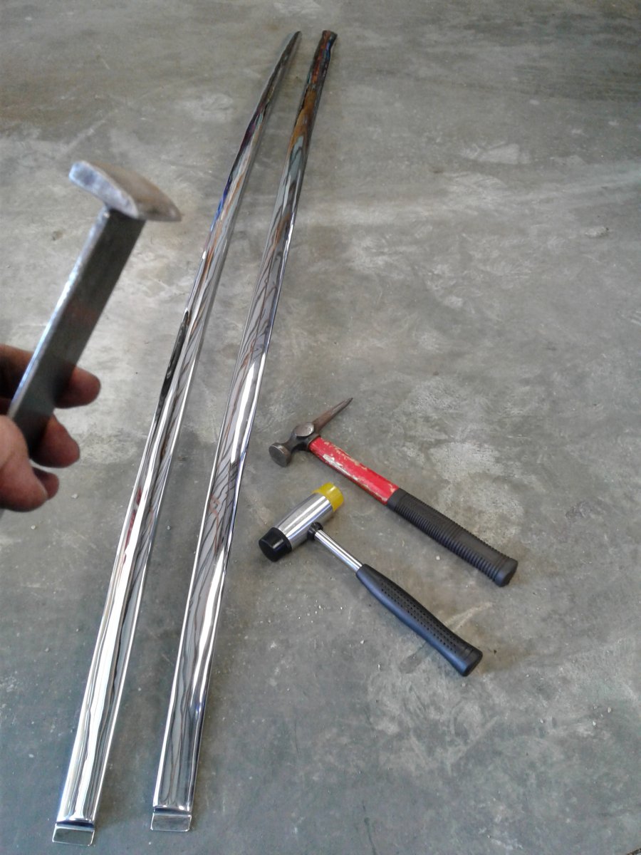

  8. 20160530_163049.jpg 20160530_163110.jpg View attachment 3231348 Todays fun was all about repairing damaged pieces. My car came from the factory with a piece of trim at the bottom of the body. The originals were full of small rust holes. A friend in town made perfect copies off the originals years ago. These old mopar parts are incredibly rare. I have never seen a set for sale. My only option was to fix what i had. When the wheels got knocked off they hit this trim both sides front and rear. I stopped by my friends house to get his opinion on how to fix them. Lucky for me he still had the dolly he used to make them. I spent a few hours getting them straight again. They were dented and twisted. I think they will help set off the green paint and break it up some what. It will add a few pounds but im ok with that. the drivers side muffler took a good hit at the turn out. i was able to save that. both headers front two pipes were dented and i was able to get creative and get those out also. this work today saved a lot of needed cash not having to buy new parts. 20150813_161126.jpg 20150813_160818.jpg 20150813_160701.jpg View attachment 3231348

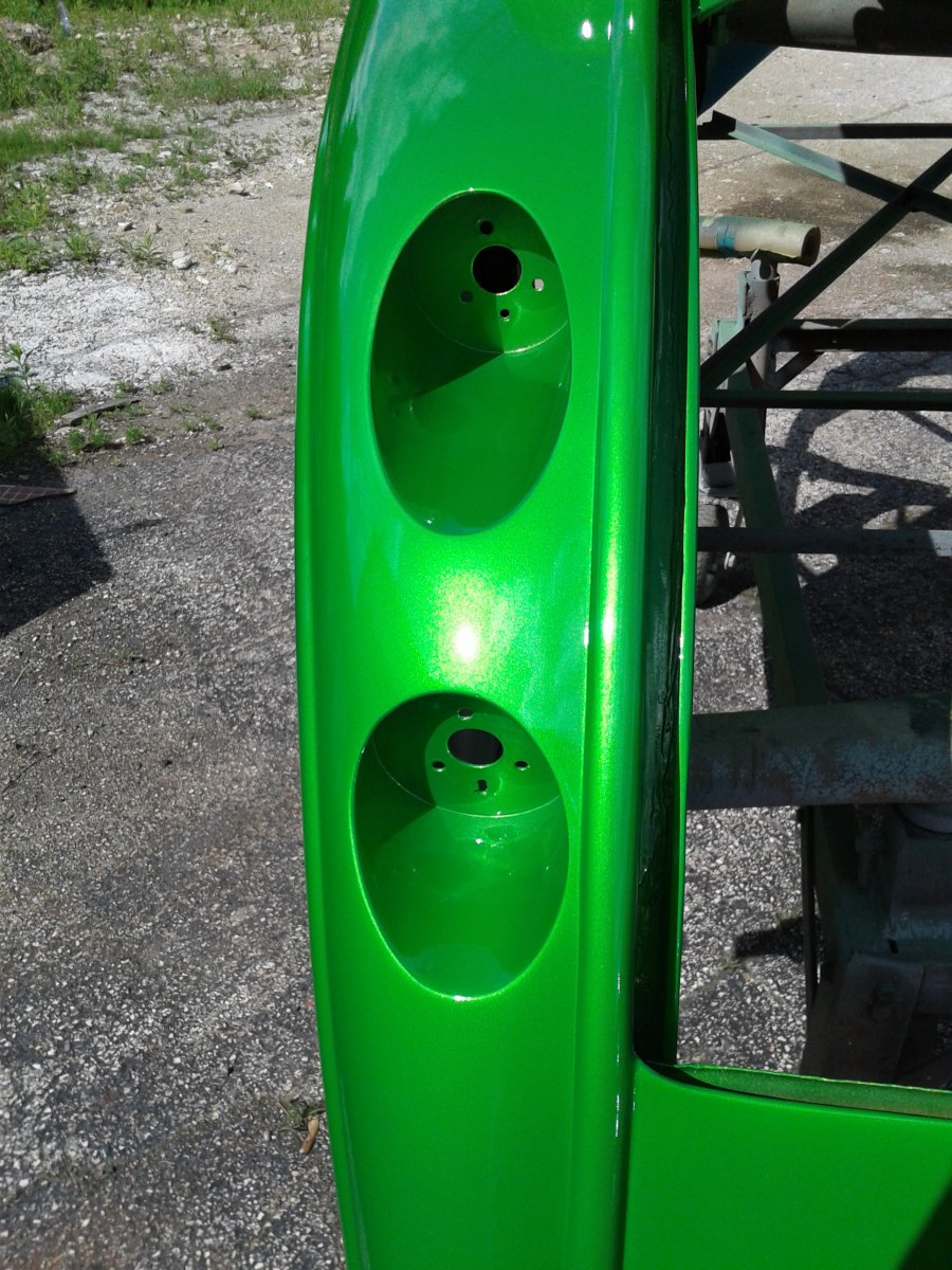

  9. Lots of good progress today. The last piece of the front end showed up. Now that can go together. It will be nice to see the car on all four wheels. Gene adams has been working with hilborn on the nitro stuff. I sent him my pump to flow. The pumps output is put into a math equation. These numbers are used to pick nozzles based on total area. This will be a safe starting point. The car was painted this morning. It was hard to get good pics due to p***ing clouds. It will start to get rubbed out tomorrow. After the gold leaf and chrome trim gets on it should really pop. the pics i took look terrible on my computer screen but look great on my phone. 20160601_154318.jpg 20160601_154338.jpg 20160601_154414.jpg 20160601_154347.jpg
