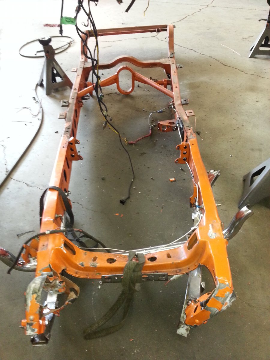

    WOW! That's twisted all to hell. I am honestly surprised its THAT tweaked from a relatively low speed hit.

    The damage is bad, which surprises me too since he was p***ing tech to run 10.0 in it. I'm no expert, but with this much carnage at 35, it's scary to think what it would have looked like if this had happened at the top end of a run.

    It pretty much bent around the rear crossmember/driveshaft loop, it looks like some sort of x-member tied into the mid-plate would have been a good deal.

    Front frame horns all separated at the welds for the boxing plates..35 mph..I re read the entire post but don't understand how it happened if it was stated I missed it...

    Taking the boxing plates out of the equation, I think the frame did a good job.

    Have you thought about using a Deuce frame? HRP

  13. my ch***is builder did run the deuce rail idea p***ed me. i think that were i want to go with this car i need the double round tube ch***is. the speeds i want to go will need to be around 180 mph. that kind of speed needs the frame rails as narrow as possible. a narrow frame is a stiff frame. the motor mounts and mid plate become shorter also. the frame will be no further out than the outside edge of the deck. it will be very similar to a fuel altered. while i do plan to street drive the car i want every thing built into this ch***is to run the number at drag week.i also want it light so its easier on parts. i was surprised at the frame damage to. then after thinking about it something has to give when 3200 lbs comes to a immediate stop. i did move the concrete barrier back about six inches. i showed it who's boss.

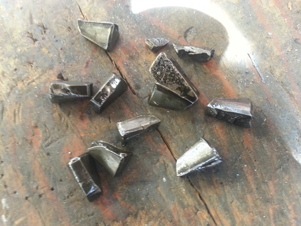

  16. 20150920_152859.jpg I found this little surprise when i got the cover off. It can only be chunks of spider gears. The rear end was not making any noises. Im sure im pushing the limits of the diff. i don't want to go with a spool if i don't have to. another good reason to lighten it up. good thing i didn't p*** up two good dana sure grips a few years back for 150 dollars. that was for the pair.

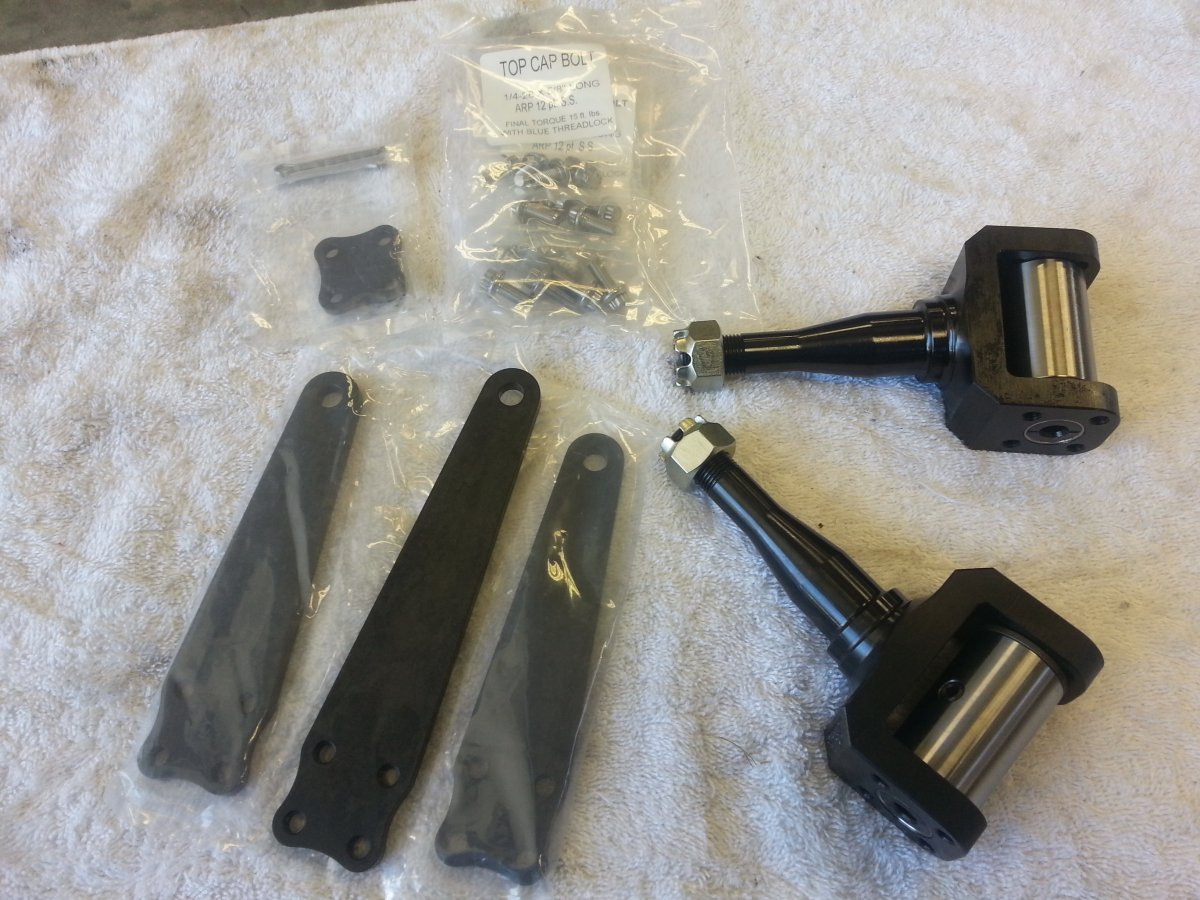

  17. I mentioned im going spindle mount. This showed up on my door last week. Its a forged chromoly anglia spindle kit made by stilletto. Most funny cars and the faster drag week cars use these. The dw cars also use them with struts. I was told as long as i have a front suspension they will live during street duty. 20150920_160221.jpg

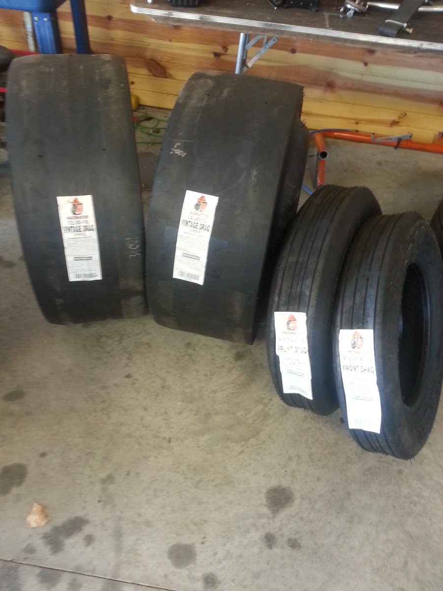

  18. Just to make my busted up self feel better i bought new m h tires. The rears are 16 inch dia. The bear claws only came as 16s. I wanted a speed rated front tire on the front. I just need the wheels back from the polisher. if any one needs some polished radir tri ribs or some slicks that only have five runs on them i just happen to know a guy selling some 20150920_162830.jpg

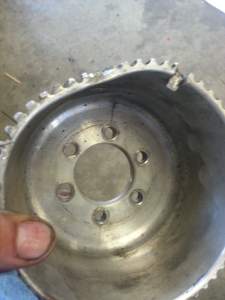

  19. 20150920_153053.jpg This was the lower blower pulley. I will be checking out the thrust. The pulley will find a place of honor on the shop wall. The offerings to the gods of speed is getting bigger

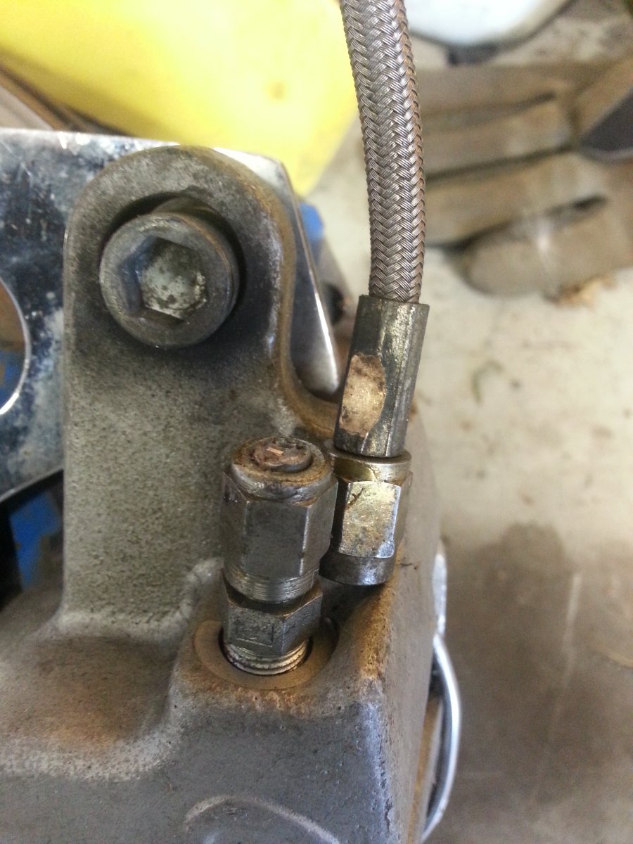

  20. I never did get the drivers side brake line back. It was torn off. I do have the p***enger side. When i took it off the caliper i was surprised to see this. It all worn. The strange thing is nothing would rub on it were it attatches. Im holding it up where it would go. I wish i had the other side to compare. Could this have been the cause. I will never know. I do remember the pedal dropping half way to the floor. 20150920_152333.jpg

  24. they are for sale. they are in great shape for their age. i stuck them with my durometer and they are reading in the forties. unbelievable. they show almost no wear on the tread.some one must have stored them inside. these tires are very collectable for the guys restoring old drag cars and cackle cars.
