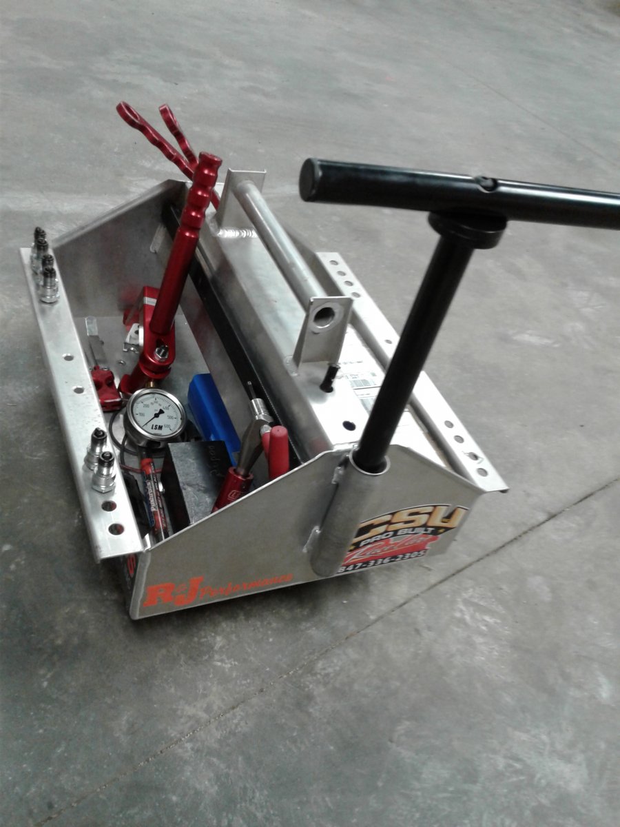

  10. If you want to play with a blown nitro hemi you better be willing to work on it. Lots of work. So to make that between round maintainence easier i have been getting my tool tray put together. This tray goes on top of the injector. Jim bent angles in some aluminium for me. These bolt to the bottom of the tray and keep it from sliding off. I added a hemi spark plug tube to the front to hold the t- handled spark plug wrench. Magnetic strips were added to hold ***orted tools. I drilled holes for the blower restraint pins these pins get pulled so the covers can come off. I added more spark plug holes so i have eight per side. four new plugs and four old plugs I added holes for the feeler gauges and a old pushrod to check for tdc while checking lash. Self adhesive felt was put on the bottom so the injector wont get scratched. All of the parts and tools to service the top end will go in the tray eventually. special tools that can check spring pressure and a inch pound torque wrench for screw adjuster nuts and blower nuts along with a torqing plug wrench. a spark plug viewing tool and spare pushrods and screws go in it also. a bottle of lube for the valve train comes in handy sitting in there. I used a similiar one on the 65. I also got the fuel tank filler all set up. The connecting tube has a fitting welded on it for the number 8 vent with a tip valve. When the tank got shortened i lost the place that had the bung for the vent. This will work just fine. 20160628_215752.jpg 20160628_215838.jpg 20160628_162416.jpg

    Gettin' close when you make a punch list and a tool tray. This has been impressive to watch. I hope to see it run!

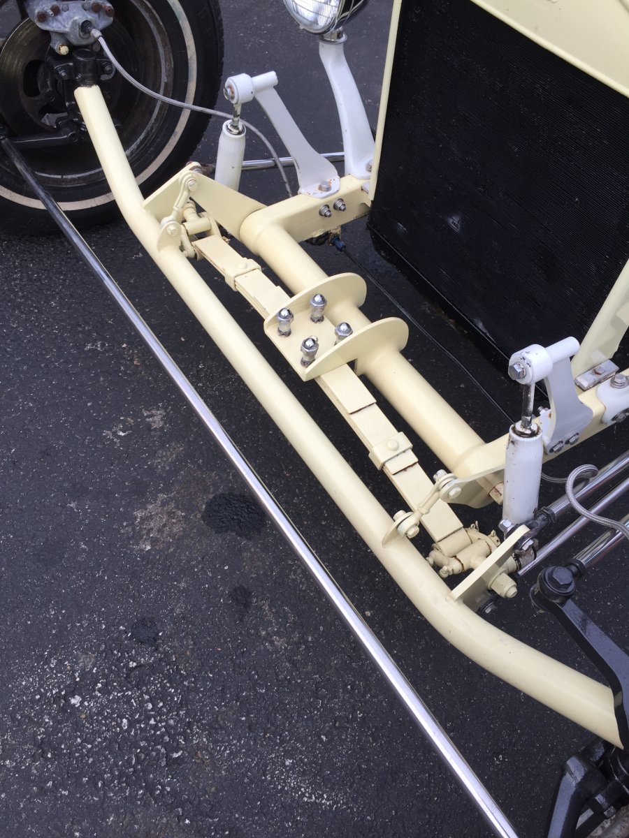

    Dang getting close! Thought of you and snapped a photo when I came across this t bucket last week. Put together in the 60's and shoved into a corner of a building for the last 3 or 4 decades a local guy bought it and put it back on the street.
    Torsion bars and a leaf spring, seems a little redundant but made me think of your hunt either way

  21. lsm makes great stuff. they are worth every penny paid. I make sure I stop in their booth at pri to see whats new. I buy the tools at that show because I get a great show special price. they don't want to have to load it up and bring it home. the cresant wrench they make is very cool. for the rockers I use missle rockers. they are sold through hot heads. the front end is interesting. I wonder what that's all about. the tortion bar looks fairly stout. it must ride very firm.

    I'll ask him about it the next time I see him, image doesn't know much about the car other than what I posted but I'm sure I could ask about how it rides etc

    I called LSM looking for an on-head spring pressure checker for early Hemi and he said no one makes that. Maybe I asked the wrong question? @402BOSSMAN was even looking into fabricating something. So the one you have can check intake and exhaust springs on the head?

    I bet those are friction shocks not torsion bars in the spreader, although it does seem redundant.

    It's got a bar in the spreader I checked,

    Maybe is a sway/stabiliser bar ? Could be necked down inside to small dia for not too much action...

    Now that makes the most since! I'll have to look next time I see it and pay more attention to the details. But that does sound the most likely idea

  28. dog patch yes it works. if you look close at the tool in the tray i use extra shims. the tool is designed to use them to get extra reach. i use misslle rockers and they are big. the tool comes with directions on how to adjust the shims to get the right reading. with the two different lengths on intake and exhaust you can adjust the tool for each one. it takes time to change it over so i don't do that. i use one setting for both. it reads accurate on the intake and off on the exhaust. that's ok i know what the inaccurate baseline reading is. its just a number. i just need to know if a spring is going away. with the blower checking the intakes the handle gets close to the case. i bought the handle that has a angle cut into. this should make it easier to check springs. i have a tool from wizards warehouse that allows me to change springs without removing the head. if you want a better pic of the tool i can get you one.
