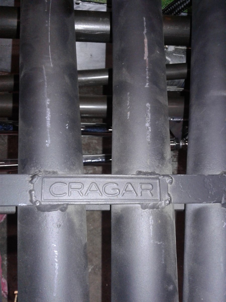

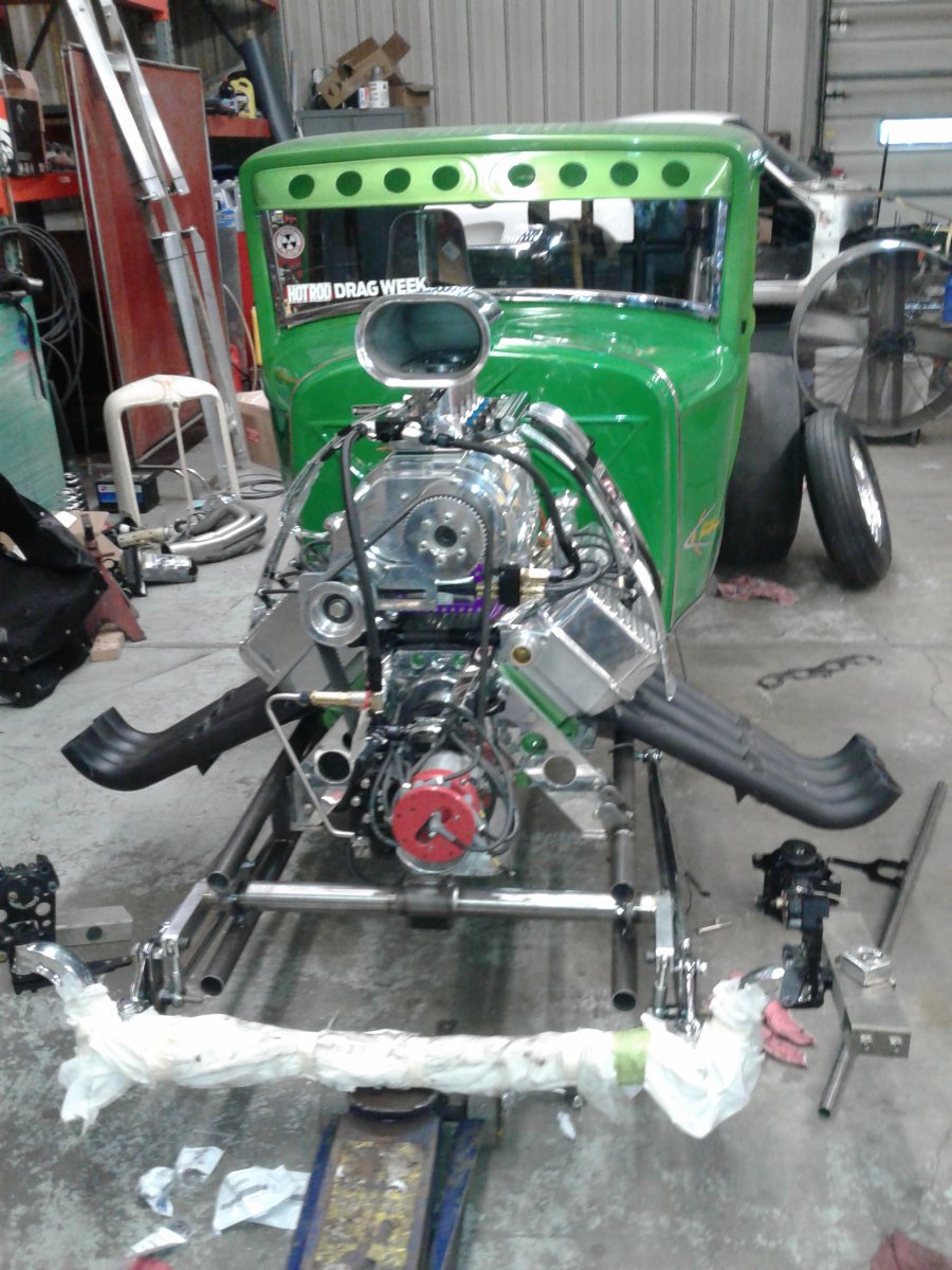

  27. There is not enough time to finish off what we need to do and build a set of zoomies before next weekends unveiling. A good friend of mine don francis came through with a set of old cragar funny car zoomies. These are beyond rare. While not exactly the look i wanted they will get me by. On the way home i stopped by mike the polisher. He called to say the wheels were done. He will fully polish the wheels after i park the car at the end of the season. Jim told me do not stop by for the next four days. They are locking the door so they can finish up what needs to be done so it can make the melt down. So there wont be too many updates in the coming days. I need a break anyway. 20160707_155604.jpg 20160707_171033.jpg 20160707_155614.jpg 20160707_192729.jpg 20160707_192751.jpg
