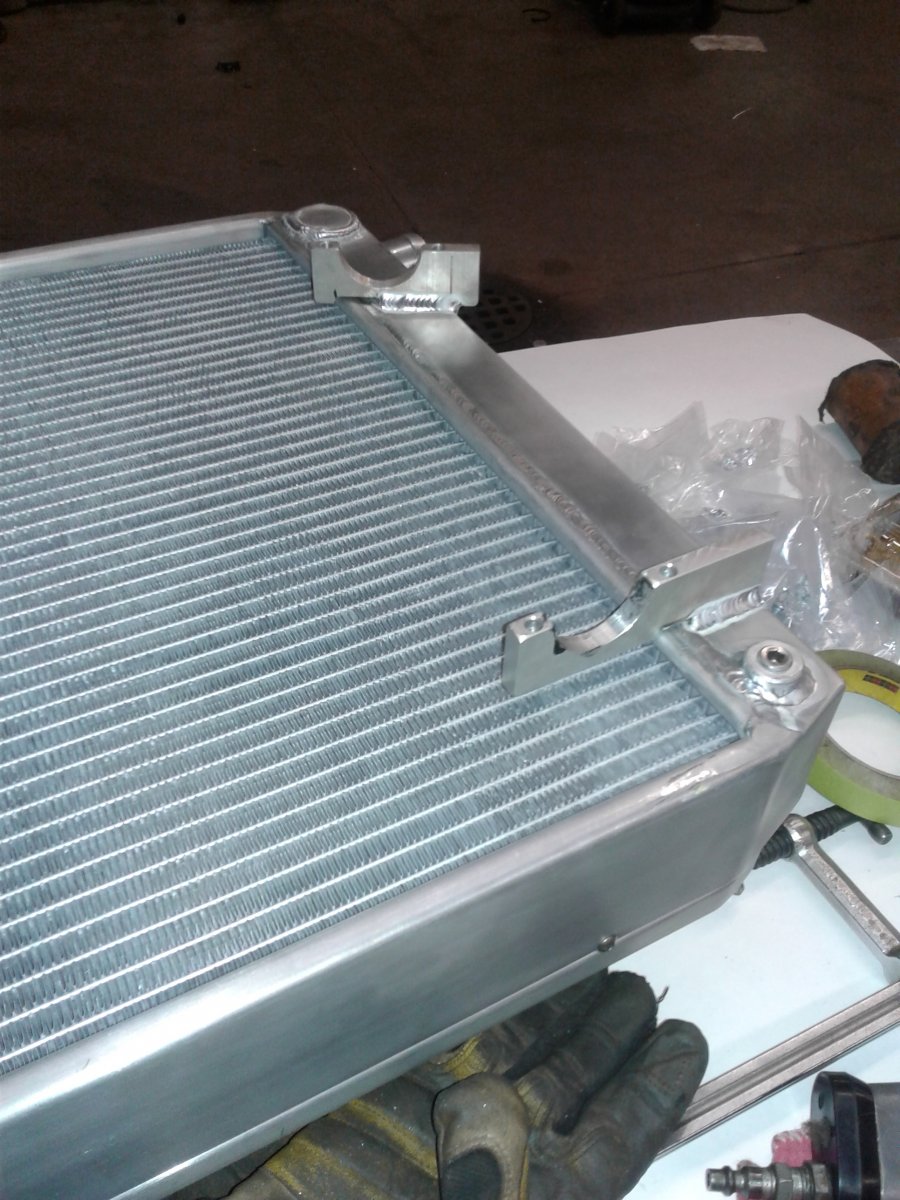

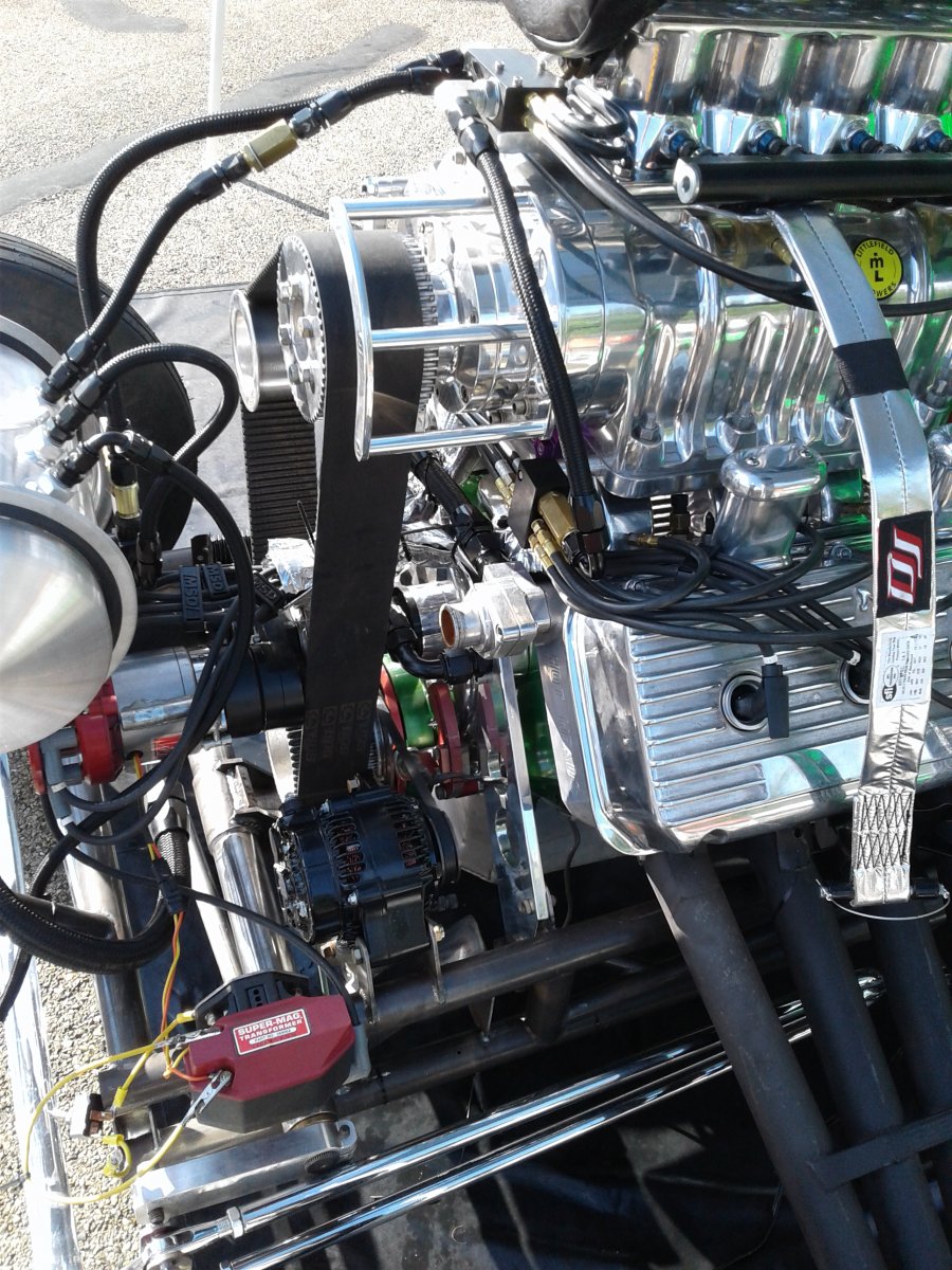

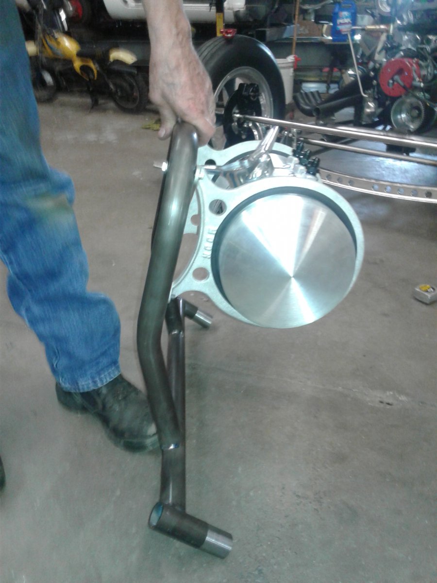

  9. I was so busy getting tjhe car ready i didnt have time to post any pics of the progress. Jim made a cool moon tank mount. The tank has to have a rollbar around it. The mount slides into the frame. Two small bolts hold it in. Servicing or removing the engine will be alot easier. The radiator mounts use a rubber spacer between it and roll bar. The engine pics show just how busy the front end became. The headlights still need to go on. We held up the grille shell to the car. Im not sure i like it. I think i like the total buisiness look without it. For all of the c***andra fans out there here are a few. 20160716_190823.jpg 20160716_190806.jpg 20160714_181816.jpg 20160714_165537.jpg 20160716_175400.jpg 20160716_175354.jpg
