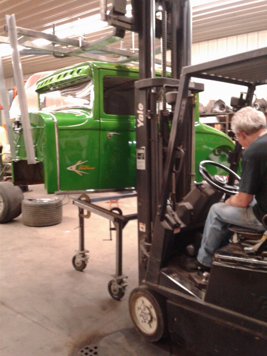

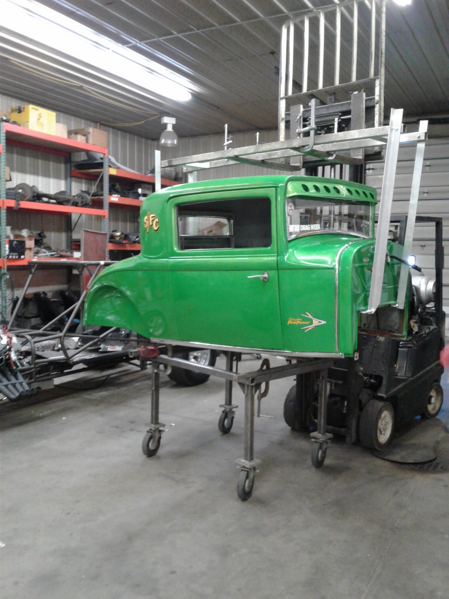

  2. 20160722_145435.jpg 20160722_145448.jpg 20160722_145448.jpg You are not seeing things. This is not a old photo. Today we pulled the body off. Its easier to finish the sheet metal work with it off. The radiator came out also. before it was pulled and the trunk lid removed i tested the fans to get a idea how well the air was going through the louvers. it seems to work good. The lower hose elbow needs to be changed by a few degrees. We got the switch panel mounted today. Like everything else on this car the mount needed to go in the mill to make it fit. The mag switch and parachutes handle bracket were also mounted. the handle was placed so when the handle gets pushed up my hand is right at the mag switch. Jim has some cool things going on with the tank mount. We finalized our plans for the mag support. The wheels need pollishing again so i know how i will be spending a few hours on saturday. i tried to get a pic of how it looks from the drivers seat. the thing i hate the most is coming up next. wiring the car. View attachment 3279016 20160722_163709.jpg 20160722_163737.jpg View attachment 3279016 View attachment 3279016

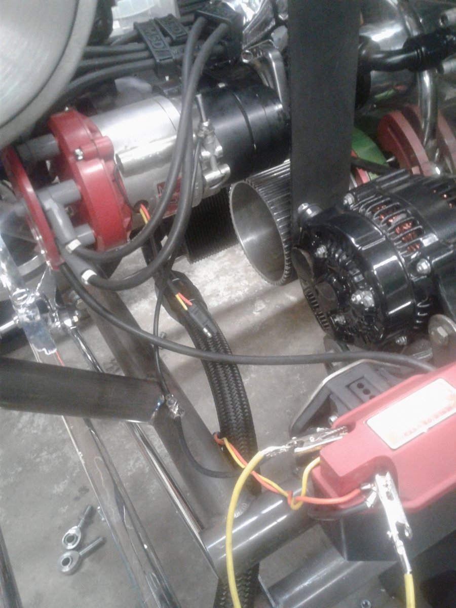

  9. The wiring has begun. First up was the mag kill switch. The starter was next followed by the fuse box. The wires in the back of the car were covered by some antique motorcycle wiring protective sleeves i had laying around. The wires in the back of the car take alot of abuse from the burnouts. I hate wiring cars. I hate even more having electrical problems. Im very careful doing this job. I dont want gremlins or a fire. I also finished up the straps to raise the side windows. I had some old ratchet straps laying around. Cheap and easy. with the body off it made wiring the tail lights a easy job. i still need to wire the trailer harness back there. The pile of wires on the ground is the efi harness. Just getting things untangled and seperated into piles was a big job. the shift light was also mounted. i plan on setting up the tach with a pig tail so when i switch back and fourth on the ignitions i have the right trigger. that would be better than two tachs. That was enough for a 100 degree day. 20160724_161454.jpg 20160724_161510.jpg 20160724_162137.jpg 20160724_161543.jpg

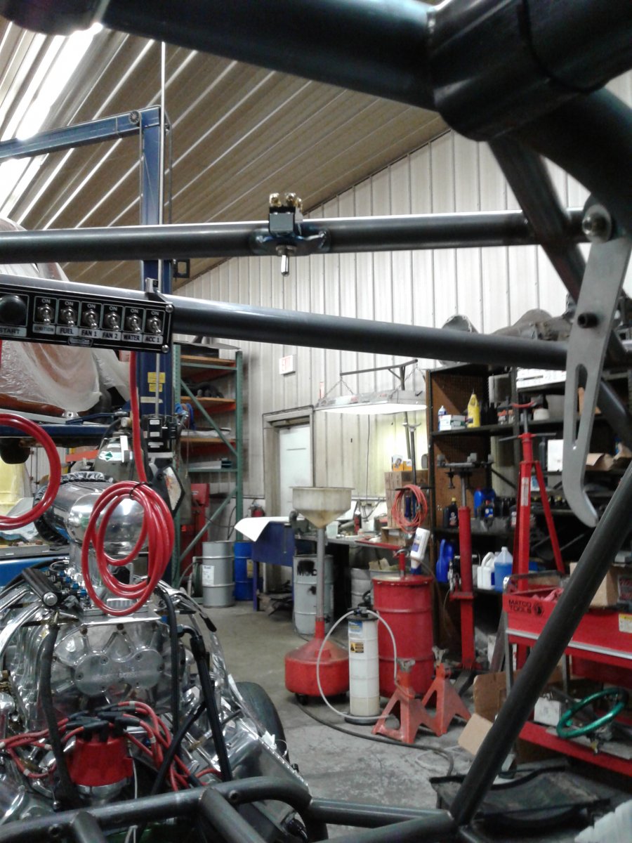

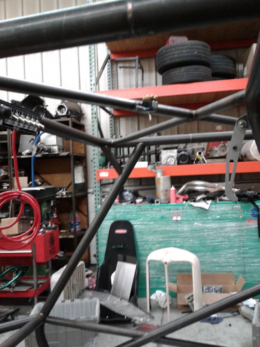

  11. The fuel shut off is coming. I feel that its so important that i want to be in the car with my fire suit on so it can be located in the best position. Today we are working on the steering column. Im glad people are paying close attention what im doing. The more eyes on it the better. 20160725_121005.jpg

    :D Hi Racerx. At the risk of sounding like a complete ***,could the fuel shutoff switch be placed on the steering wheel or the shift handle?OR does it have to be a mechanical device?Thanks.

  13. Not a bad question at all. Mechanical fuel injection engines can be shut off two ways. The mag switch can ground out the mag killing the ignition. The other way is to shut off the fuel. As mentioned above a nitro engine can diesel and stay running without a ignition source. If there should be a fire its critical to be able to shut off the fuel immediately. The shut off can be mounted any where as long as it can be reached quickly.
