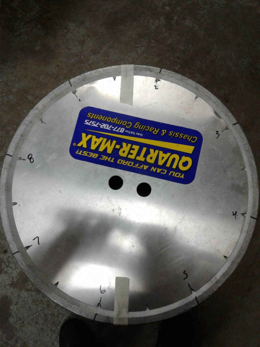

  1. For those not familiar with the parts im talking about here are a few pics. The number stamped on the end of the spool refers to how the ramp is ground. There are diffent ramps for different fuels or for different percentages of nitro. I dont want to loose followers if they dont understand this stuff and what we are doing. 20160720_163937.jpg 20160725_093316.jpg

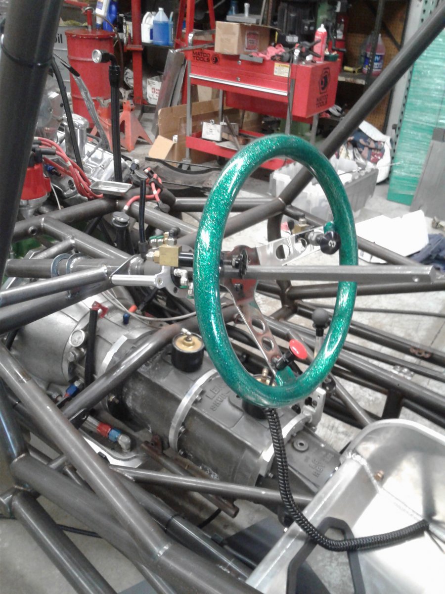

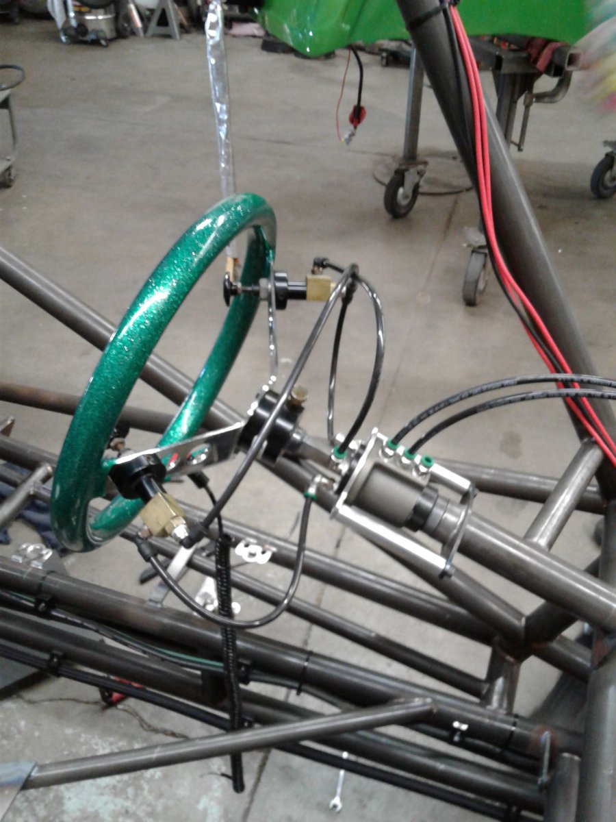

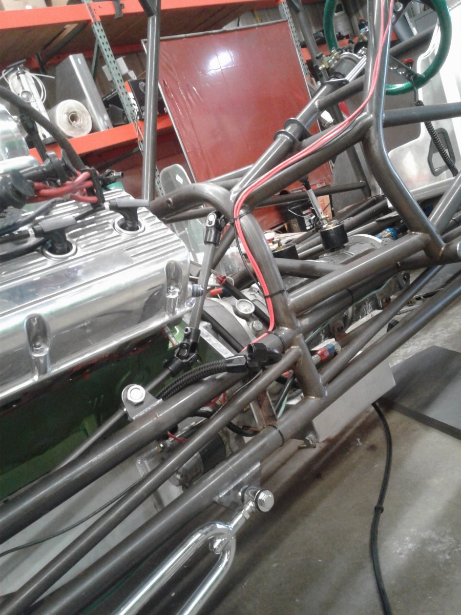

  11. The pics say it all. The steering is very smooth. The column bushings were fit by hand. The mount for the air lines turned out great. We did the final fitting this morning. 20160730_084649.jpg 20160730_084658.jpg 20160730_084738.jpg

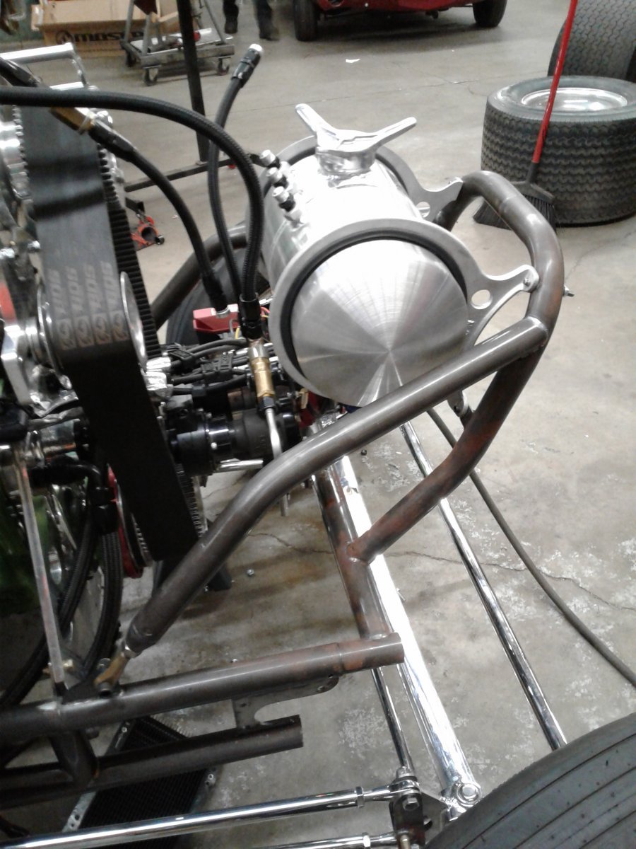

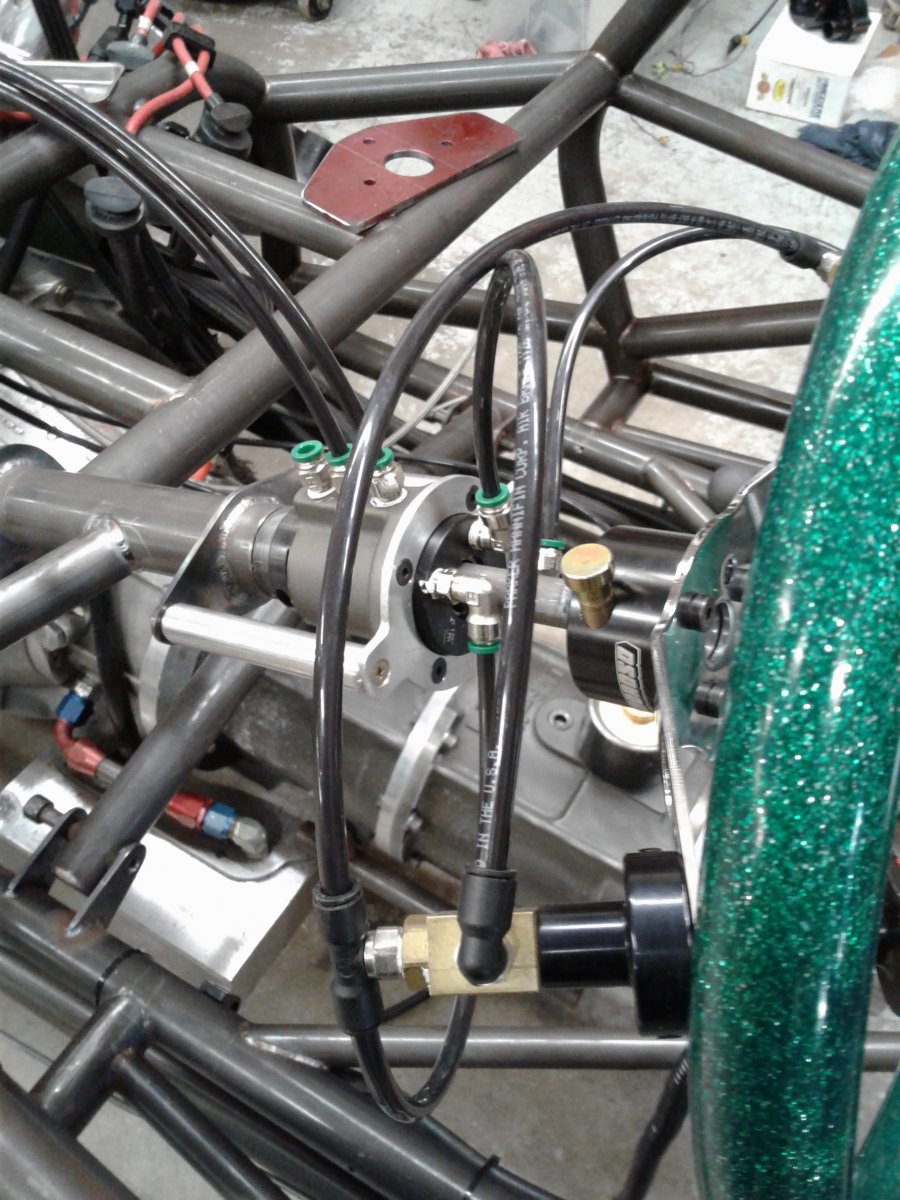

  22. 20160801_155841.jpg 20160801_155805.jpg 20160801_160619.jpg 20160801_155848.jpg 20160801_163101.jpg 20160801_172941.jpg 20160801_172814.jpg i was able to get out of work a little early today. i started out plumbing the shifter air lines. i need to be able to remove the steering wheel to get in and out of the car. So until the body goes back on i cant trim the lines any shorter. The bars that support the fuel tank look simple. They are far from it. The tank and all its attatched tubing are removable. There are several complex angles there. Its hard enough to build one on the first try. Now do it twice and make them match thats hard to do. It takes some balls to put a drill to mag halibrands. But what can you do it needed to be done. Next up for them is the mill. A 5x5 pattern needs to be drilled into them. Jim was hard at work with a piece of box tubing. He said this is your brake pedal. Im still trying to picture it in the car. The torsion bars are due to arrive tomorrow. the arms were shortened by six inches to make everything fit. this messed up all of the calculations. the bars were too strong now. because the arms were shortened half their length the bars had their diameter reduced by nearly half. they can't be cut on a lathe. they had to be sent back to be center less ground. Lucky im off so i get the fun of putting it all back together. Parts are starting to get bolted in their final places. Time is running short.

    The air hoses look just like the stuff we use on the high school robots :)
    els, volvobrynk and loudbang like this.
  24. i was told this air line can be run under real hot water so kit can be formed into nearly a 90 degree angle. do you have any experience doing this jim
    els and loudbang like this.
  25. squirrel
    Posts: 59,967
    I know it will get soft if it's attached to a compressor that overheats.... my guess is that it probably can be formed like that. There are also 90 degree quick disconnect fittings, that look just like those elbows that have a thread on one side, you can get them without the threaded fitting. called an Elbow Union
    In the robot stuff we do, there are strict rules about not modifying pneumatic parts, at all, so we don't try to form the hoses.
  26. i can't fit 90 degree fittings on the casting. there is not enough room between the three fittings to rotate them. one is a air supply the other two go the trans pods to engage the clutch packs. it would look cleaner if i could get the lines to be at a 90 degree angle running closer to the column.

    Looking good man. Do you think you are gonna make hamb drags ? Also they make those airline fittings in a 90 degree that are a swivel fitting and also make 90 degree push connect fittings that push in a straight fitting like you have and the line pushes into the 90 fitting we use them all the time in the trucking industry I don't know what kind of pressure you are running but the air brake stuff on these trucks are regulated at 120 psi. What pipe thread and air line are you using

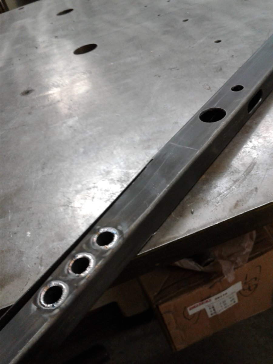

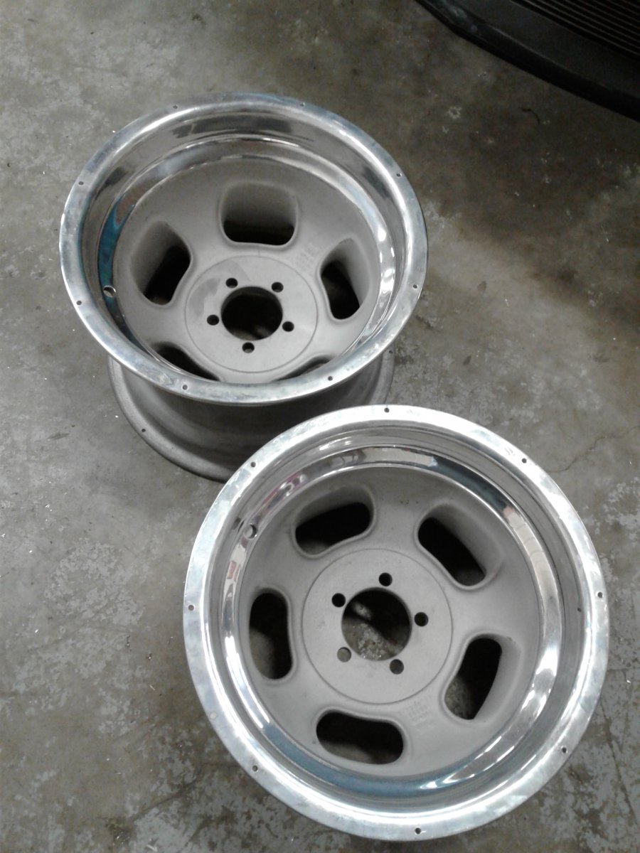

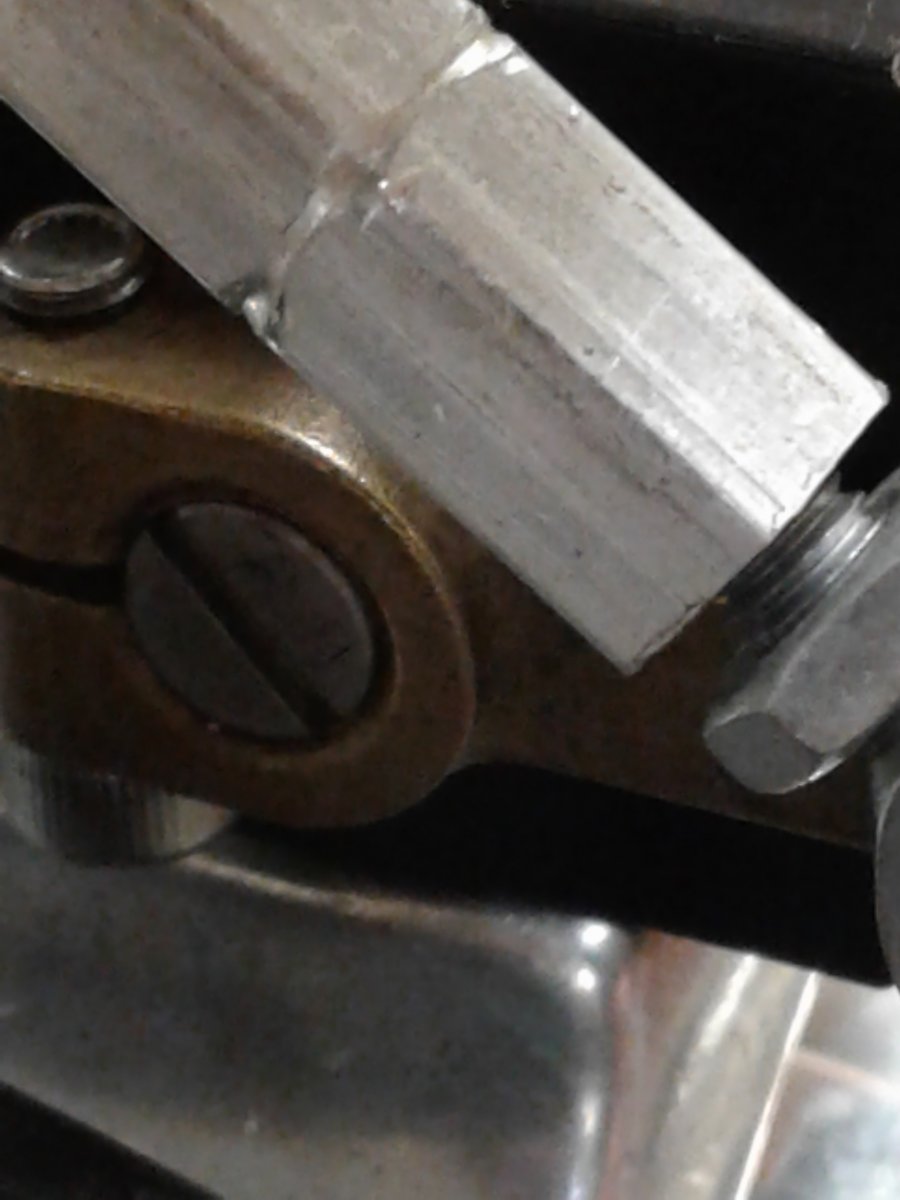

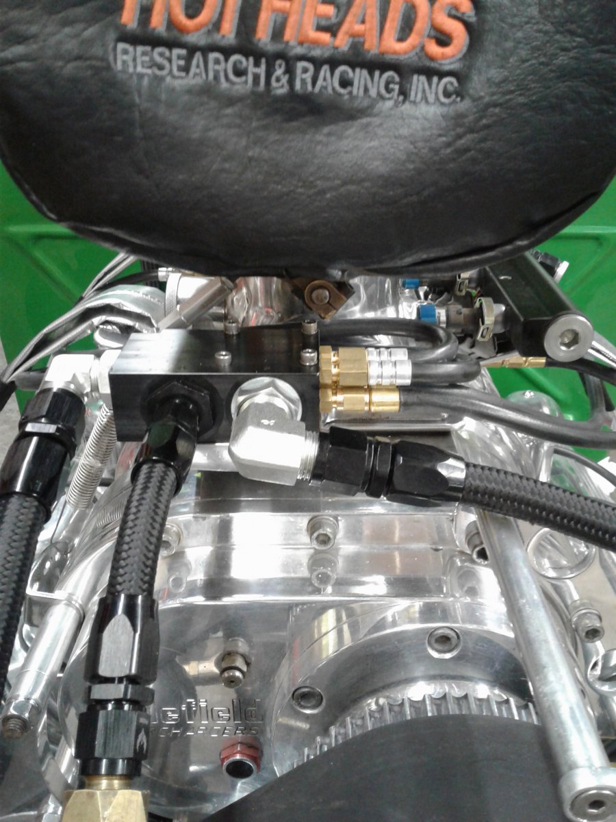

  29. We are doing all we can to get it there. Its high on the priority list. Jim got the wheels drilled. The torsion bars showed up as planned. They are in the car now. The bars were adjusted for ride height and firmness. I took a few pics to show what makes it up. Im out getting all the hardware to finish it off. The lenco reverser handle was moved back 5/8 of a inch. This caused domino effect that took more than a hour to straighten out. John is making the water pump mount. Now that jim is back from lunch he is working on getting the master cylinder in. Im sure im missing something but these are the highlights from this morning. Jim the hot water worked. 20160802_101421.jpg 20160802_103140.jpg
