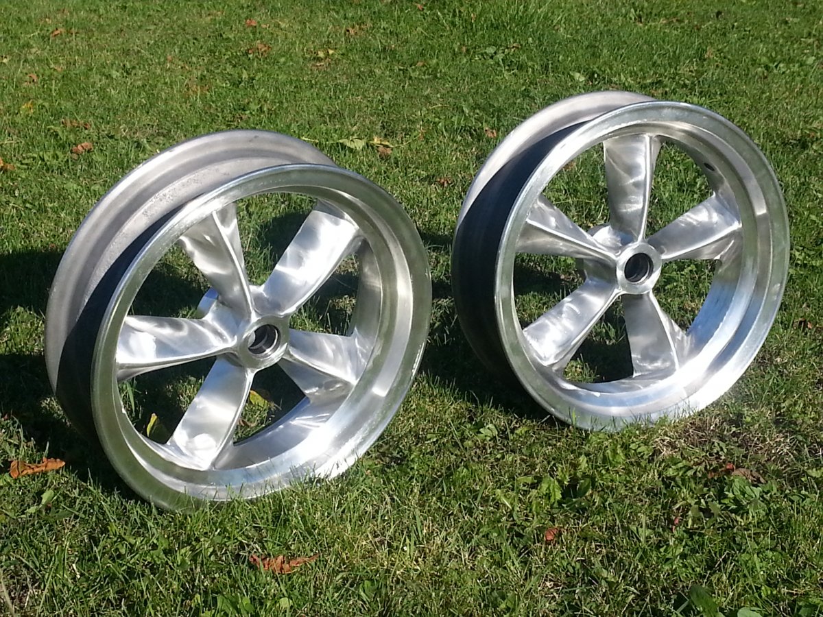

    Joined: Oct 29, 2009

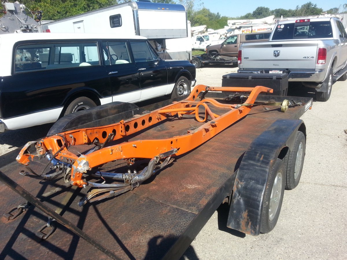

  3. I got the frame home today from the ch***is shop. I gave them a big check to order the tubing. They say they will be putting tubing on the frame jig thursday. There will be a slight change of plans on the ch***is. The only plans nhra has that dont have bars going from the main hoop to the trunk area that dont attatch at the top of the hoop can only be a 7.49 ch***is or faster. So we will build that. 20150921_104347.jpg

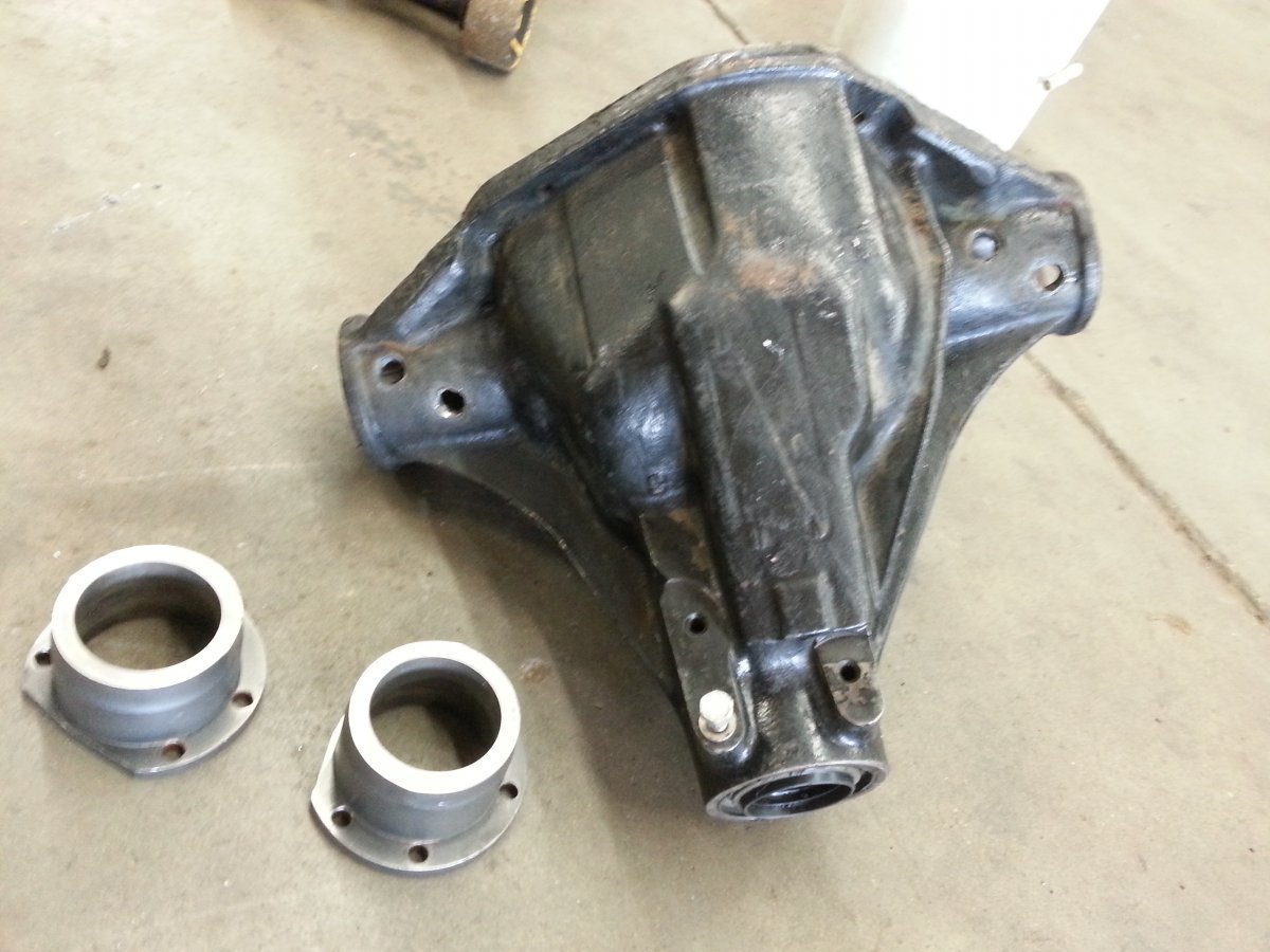

  4. I stopped at the polishers today on the way to the ch***is shop. I picked up the wheels to machine them for the hats. They have been sanded with 320 so far. I cant wait to see them done. I also put the dana housings ends in the lathe. They will be reused. Now im trying to get the welds drilled out on the housing to get the rest of the tubing out. Its no fun. 20150921_162555.jpg

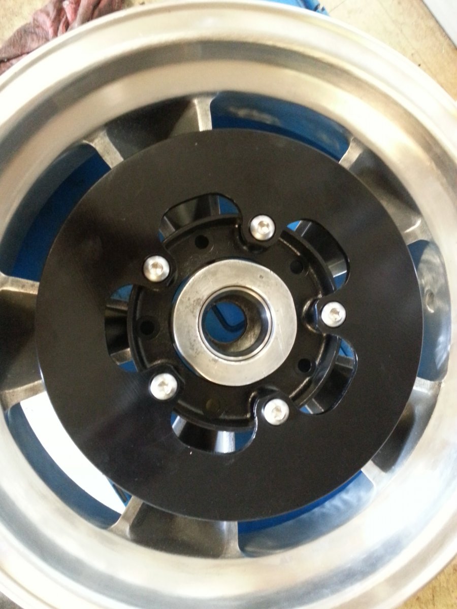

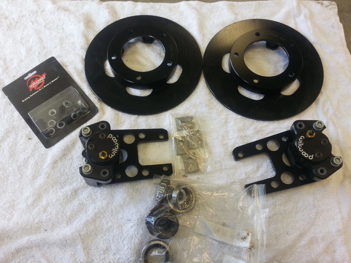

  12. The front brakes showed up. It looks like i will be spending more time on the lathe and mill. The hats fit the new aluminium repro five spokes not the real mag ones. the bolt pattern is too big. were the bolt holes are there is no material to drill into. There are no hats made so i will just have to make my own. But isnt that what hot rodding is about. 20150920_152836.jpg

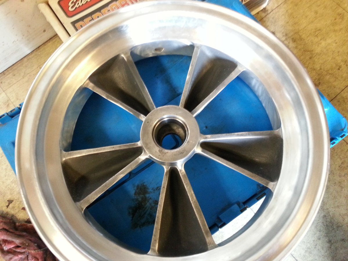

  15. 20150922_131758.jpg This this is the back side of the wheel. There is no material to bolt a hat were it needs to be. I thought about mounting the hat just above the race. i will have to make a new hat.

  16. 20150922_131811.jpg Here you can see how much difference there is.

  19. 20150913_130352.jpg 20150913_130316.jpg Steve morley who owns this car has graciously offered to help with the front wheels. The wheels need to go on a rotary table. A register is cut into them then a hat is made to press on the rim. The rotor bolts to that. I picked up shipping boxes and i will ship it all out today. Just knowing this will be taken care of and done correctly is a huge load off my mind.

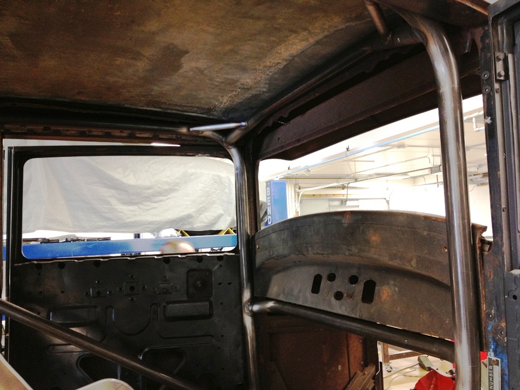

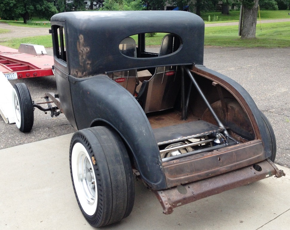

    RacerX, you Can do an 8.50 cage with no bars protruding thru the body. I had mine done by Gizmo and he built this and it is certified to 8.50
    els likes this.

  28. I got the axle tubes out. The plasma cutter was a life saver. I thought this job would be easy. Once again i was wrong. Im glad thats over. 20150925_133125.jpg

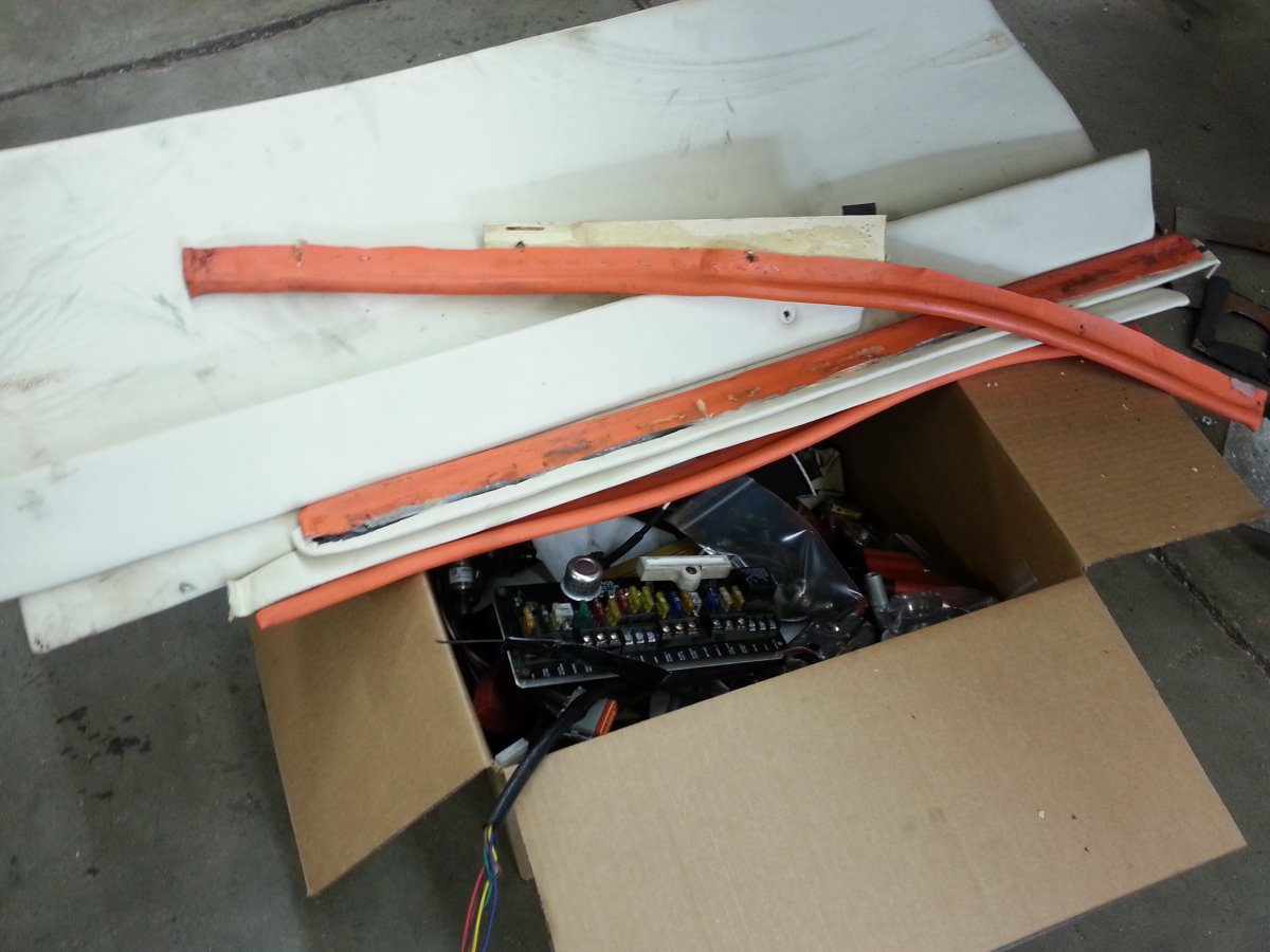

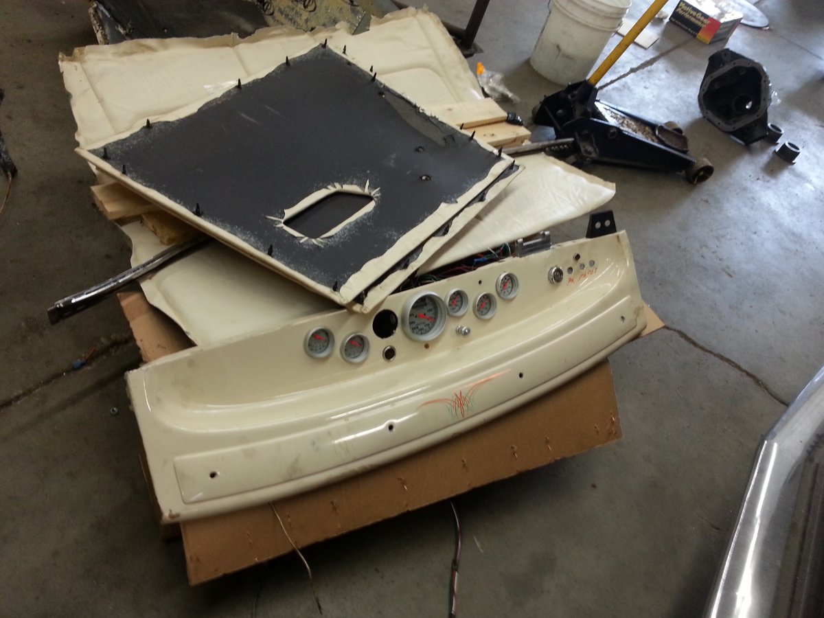

  29. More of the car was taken apart. Most of it cant be saved. The dash most likely wont fit again due to the cage. The cars wiring will all need to be replaced. I filled up the chevelle and took it all home to sort out. 20150925_133154.jpg
