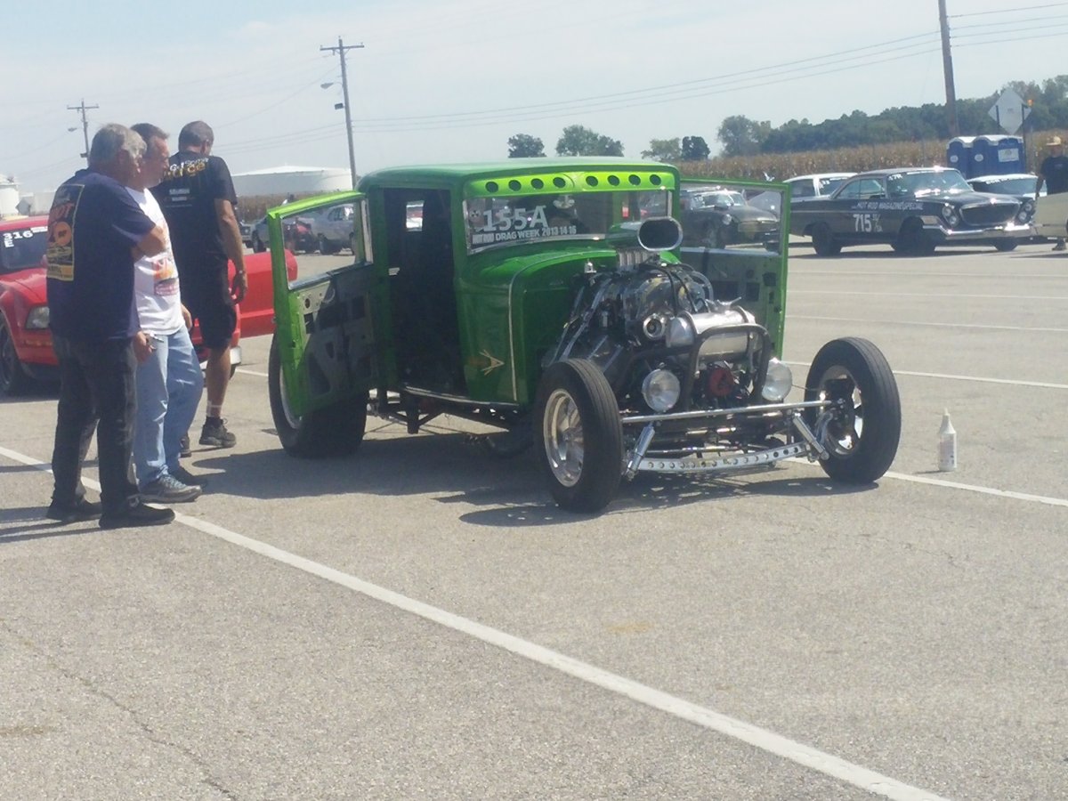

  29. I thought I would leak the engine down to see whats going on. leaking the cylinders is a good way to determine the overall health of the engine. I had done all of the regular servicing the previous night after work. I felt like the car was kind of flat on the last p***. it just didn't sound very crisp. my gut feeling was something was not right and I needed to dig deeper. It was my off day so I had some time before I needed to load up to go to the race at Milan mi. well that didn't go as planned. number one was down 45 on the leak down several were down 25 and number eight was 85. with the headers off I could feel air blowing out of the exhaust. so the heads came off and were loaded in the truck. off I went to rogers in cedar falls iowa. for drag week I set the spring pressure lighter to prevent burning up pushrod tips with all of the street driving. I went a little too far. six exhaust valves were bent. out of those we straightened four while replacing two. when they were put back in I added a .060 shim setting them up the way I usually do. there is plenty of room under the retainer with the .100 long valves. there was no piston damage as they just barely touched the valves. the intakes are ***anium so the are a lot lighter and were all fine. I left home at noon arrived at the shop after five. left the shop at eight and arrived back home at 1:45am. the alarm came early at 4:40 this morning so I could go to work. luckily its only a eight hr. shift. I need to put it back together and load up for the race in Milan mi. the alarm will come early again this time at 1:00 am. so we can get to the track when the gates open. the key to running a nitro car is to stay up on the maintenance. a lot of damage can be prevented by staying up on it. i cant believe I used to do this on a weekly basis. welcome to nitro racing.
    els, bobwop, mad mikey and 2 others like this.
  30. 1474639392051.jpg 1474639398903.jpg we used a lathe and a indicator along with a cresant wrench to straighten the valves. The were about .050 out. Getting them within .001 allows them to be reground. it requires some patience and feel to get the valve that close. The seats looked good so a quick lap job and were are good.
