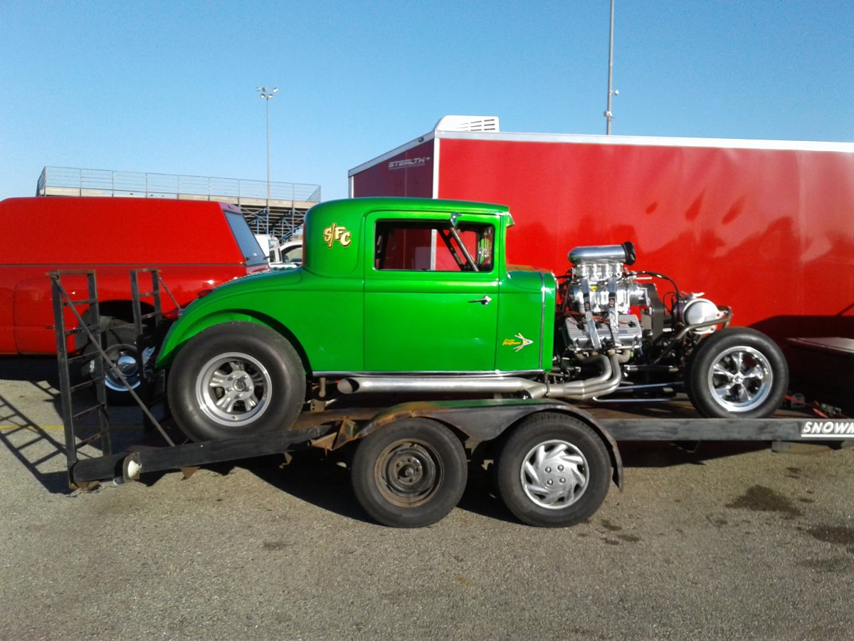

  8. I had to pick up some things at the local parts store tonight. The last time i was there the owner told me he had something i could use. He pulled out a few sets of old side gap nitro plugs and the champion gapping tool. The tool can push the pin to close the gap. Putting the plug on the other side of the tool using the roll pin pushes it back out. I have never seen one of these tools it was richard hutchins from the chevy rebellion wheelstander. 20161018_200120.jpg 20161018_200134.jpg 20161018_200223.jpg

  11. and use it we will. it came along at just the right time. I was planning on switching over to a colder side gap plug now we have the tune up where we want it. its safe to use the colder plug now. it was starting to get expensive burning up all of those hot plugs.
  12. Mission accomplished. I made the required p***es to get my license. We did five hits in less than three hours. The tool bags were never opened. The only work we did was checking the tire pressure. The car ran a best on gas at 9.7 at 136mph. Thats not too bad for a engine with a nitro cam set at 112 degrees with a compression ratio of 7.8. Basically there is no bottom end due to no cylinder pressure. The 3.73 gears dont help either. Its all one big compromise because it works great on nitro. The toe adjustments have really worked out. The car goes down the track as it should. We will bring it out one more time weather permitting for a photo shoot on nitro. I will continue to street drive it until the snow flies. It was a fun day with several hamb members on the grounds. View attachment 3359167 20161023_145702.jpg 20161023_161514.jpg View attachment 3359167 20161023_145702.jpg 20161023_161514.jpg

  15. i have been getting a lot of street driving in lately. we did run into a issue the other day. while i was out doing some unsactioned acceleration trials the car suddenly started running bad. it would start ok and drive ok but when the gas was hit hard the engine would die. i went through everything from a leak down to the ignition etc. it turned out to be the hose running from the back of the manifold to the map sensor had blown off. the map is under the dash out of view. it never came off the barbed fitting before. its hose clamped on now. problem solved. while these things can be very frustrating to track down it does provide valuable trouble shooting lessons. I'm getting much more comfortable with the fast efi and tuning with the lap top. during the trouble shooting i had fast on the phone and we got the latest software down loaded into my ecu. the customer support from fast is great.

    Bryan It was good watching the car today. Hopefully I'll be out there with you soon. I tried to upload the video but had no luck dm me your email and I'll send it to you.

    Sorry this took so long I wanted to get the spelling of your last name right for the video. Do magazines ask if the spelling is correct before they run an article? Good thing it's in big gold letters now above the door.

    :D Hi racerx.Looking good.Finally figured out what S/FC means."Sweet ****ing car":eek::p.

    Brian, great to finally see you run & talk after all these years! The coupe is a thing of beauty, pictures just don't do it justice. Let us know when you come back out with "the can" also, if you see Neil, tell him I said HI ! Bugsy
