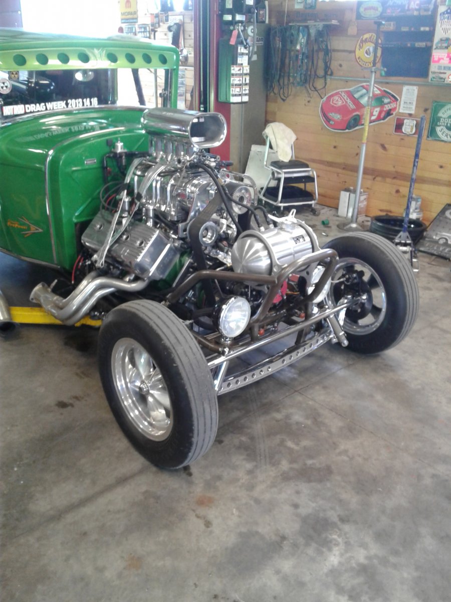

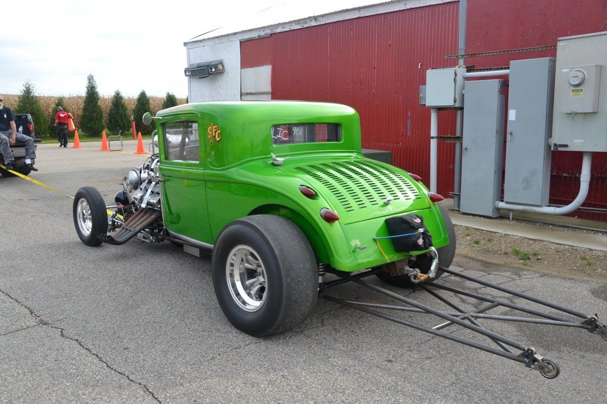

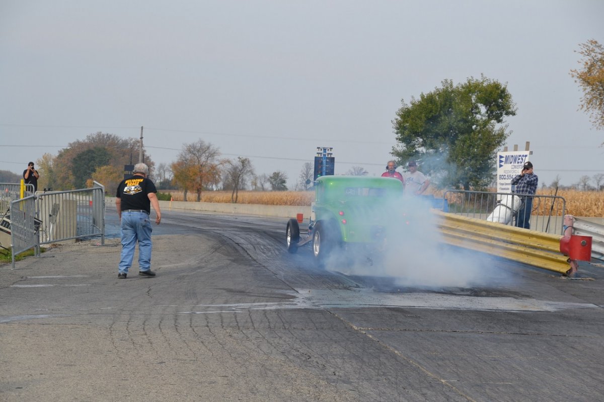

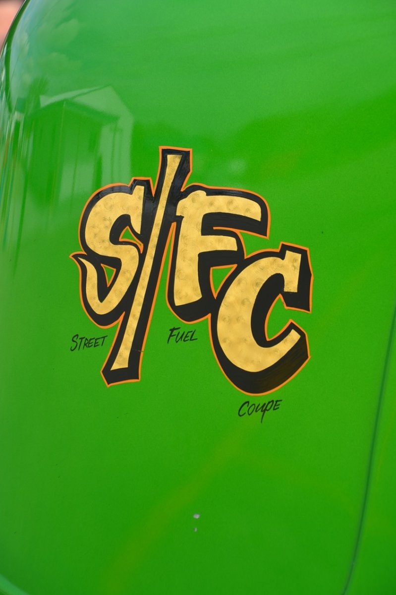

    It was nitro nice to see you run the S/F C Brian, this car is awesome !!

    How did it run ?

  3. consistant 1.24 60 foot times. we can start going after the 60 foot times with some four link changes. i will convert it back to street driving tomorrow so we can get the street pics done. we got lucky with the weather today. there are not many days like this left. big drag thanks for the pics.

    What are those front wheels... I've always loved that style. I may want a pair for the 48 Austin PU project

    American racing spindle Mount ==$$$$$. 1,000 up for a pair

  6. correct on the wheel id. they were made two ways either anglia spindle or early ford. the anglia is smaller. the originals wheels were only made in magnesium. they were never setup for brakes. we have shown that they can be modified to take care of that. the repros are aluminum only and are sfi-rated. they come set up for disc brakes. they are just as much money as originals. the price quoted above would be for a unpolished set. add another 50-75 percent for polishing. keep in mind you will become a slave to those mag wheels polishing every week if you go that route. the ch***is shop in michigan carries the stiletto forged chrome molly spindles and wilwood disc brakes to complete the install. add another grand for that. it aint a cheap date but the look can't be matched. they scream race car.

    Without a doubt, both these and the rear wheels are some of the coolest wheels to ever grace a race car!

    Correct on the original wheel pricing. The new repros are even more "spendy" at $790 each (or in fact were, as currently neither Summit or Jegs has them listed as available)

  10. after its all added up the repros might end up cheaper when the polishing and machine work for the brakes are figured in. i personally prefer the look of the magnesium.

    Thanks guys but I think I'm going to try and keep the Austin build simple and relatively inexpensive.
    I can get the same look and feel with a set of old school torque thrusts. Lets me run front brakes and keeps the cost and maint down.

  12. they can always be added later. it took me a lot of years to finally get mine.

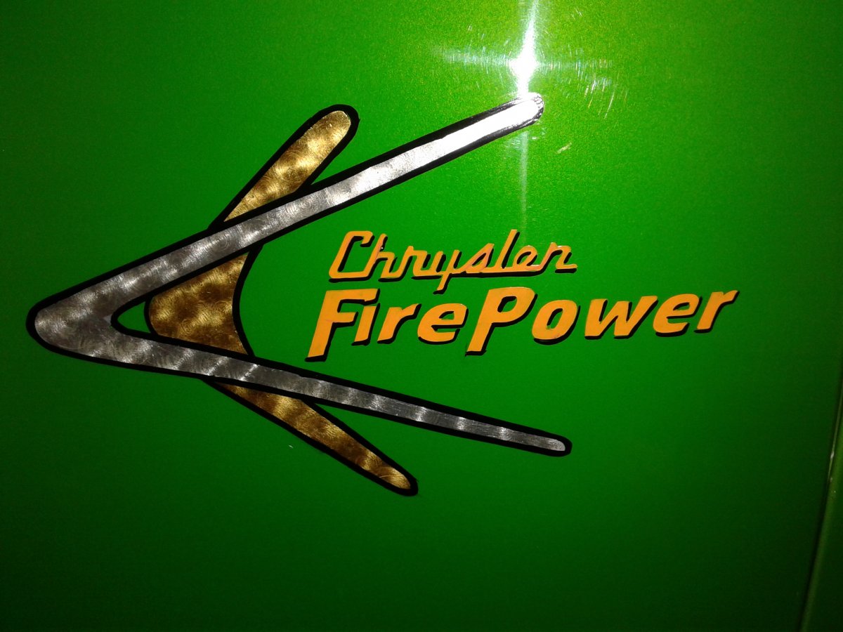

  13. My friend john shepard stopped by today to finish off the shadowing on the chrysler logo. the pic taken in the shop doesnt show how the lettering jumps off the car now. before the shadowing the logo kind of disappeared. the car is converted back to a street car now. its ready for the final photo shoot. pete ores was able to get some great pics both on the track and static shots over the last week. unfortunately i cant post any until after the magazines run their stories. it takes a long time for that to happen. i had 20 gallons of race gas left over so i put it in the car. that sure smells good driving around town. starting the car up after converting over from the nitro smells even better. as the engine runs the nitro that was still in the fuel lines gets ****ed into the engine. the nitros distinct smell fills the air. 20161103_195940.jpg

    WOW loocking Better and Better! Gary

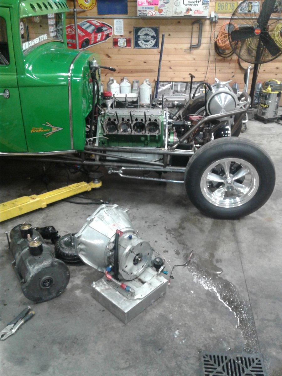

  16. 20161107_085426.jpg 20161107_164826.jpg 20161107_165732.jpg The 2016 season has ended. the 2017 season has begun. everything but the short block came out today. it was my schedualed day off with rare temps in the upper 60s. a perfect day to work in the shop. i could have removed the short block but i took the chevelle for lunch and a ride. I couldnt p*** it up. mental notes were made for some changes over wintèr. it was a crazy and challenging year. next year will be even better. there will be no letting up until we reach all of our goals. for the next few months maintainance will be done and the interior finished off. since the car became driveable in mid september we were able to hit seven tracks in six states. union grove was run more than once. thats aggresive. we learned alot along the way. proving the ideas could work like the dual fuel system; tortion bar; radiator in the trunk; spindle mount wheels etc was a big relief. for those that have been following this build thanks. it was nice to run into so many hambers along the way that have been watching. there is alot more to come. 2017 will be here before you know it. have a fun and safe off season.

    Brian , that was a hell of a thrash to get your Rod together, (2016)
    Work & more Work !!! when you have a Race car on the street ,,It's the Love &. Dedication
    to Achieve Your Goal, Love last 3 pic's of your Shop , I can relate to it so much the cars go's together come right back apart , go back together , till all the Bug's are worked out ,,, """""""""""""""Street Fuel Coupe """""""""""

  22. thanks everyone. its been fun sharing the rebuild. the plan now is to get the short block out then return the car to jim so the interior can be wrapped up. while the car is gone I will do a project each week. disasembling the Bruno and lenco looking for worn parts is one such project. the crank will come out for a close inspection. the rods go back to grp for resizing. the heads will be dis***embled and completely gone through. the brakes will get a going over. between these off season jobs I will attend the pri show and several trade shows and swap meets to break things up. I also plan on getting back to doing some compe***ive combat pistol shooting. during the winter months I shoot on average 500 rounds a week. its a good thing I reload my own or I would go broke. now that I have some extra time I will take some extra hours at work so I can buy a enclosed trailer this spring. im looking for a 28-32 foot. I want to be able to put the car and the drag week trailer inside or the car and the three wheeler.
