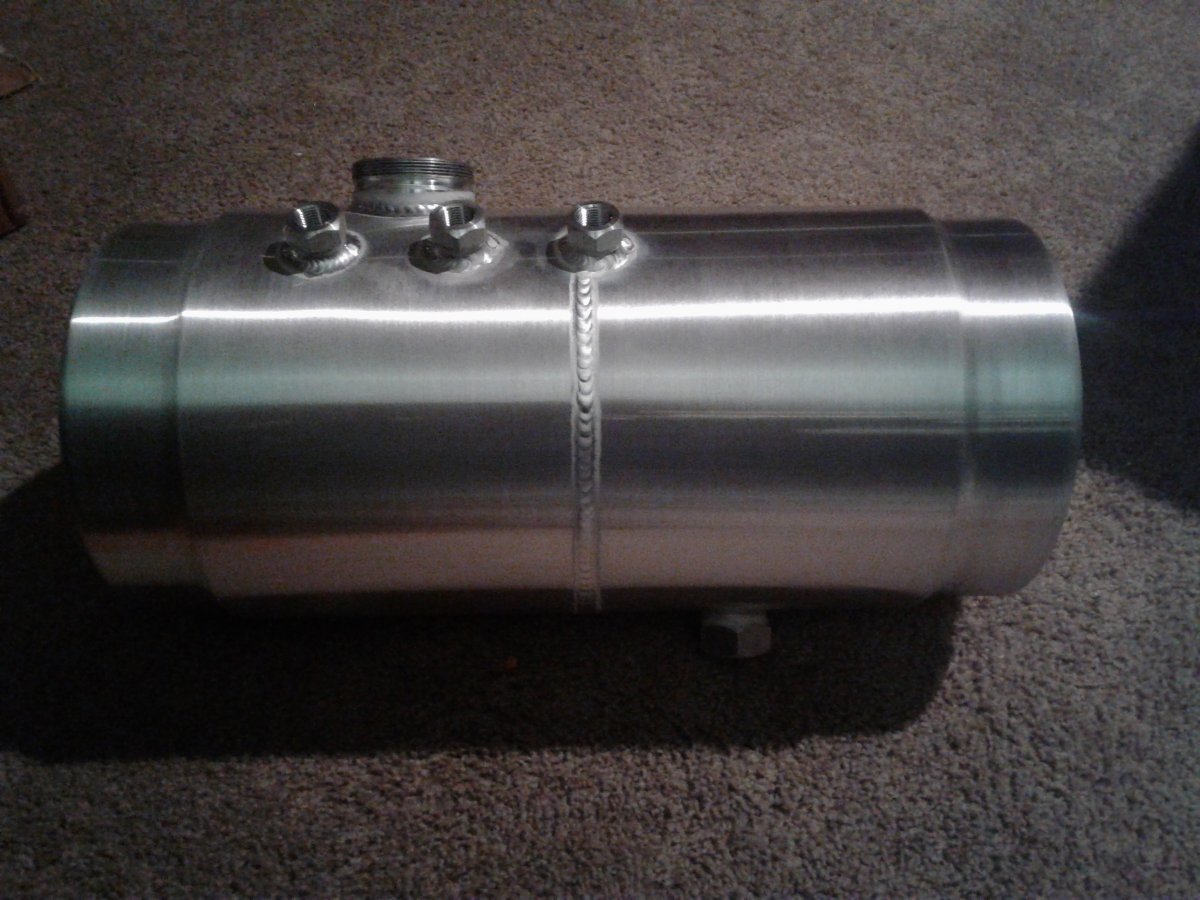

  9. The moon tank showed up today. This one is a 5 gallon tank. Its replacing the 3.5 gallon tank. Between the compe***ion licence along with the tank being too small 20170119_173942.jpg 20170119_174622.jpg they were both holding me and the car back. Both the new and old are both eight inches across. The differance is in the length. The new tank is three inches longer.

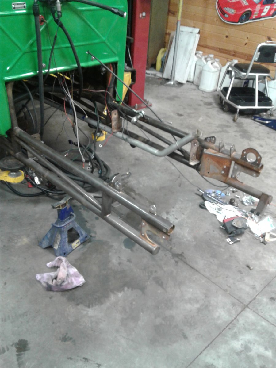

  11. With the engine out i figured now was a good time to do some work on the frame. Anything that was not chromed or pollished last year was recently taken care of. Inventory was taken on all of the old fasteners. They were all replaced with chrome pieces. Several items on the frame were trimmed down or had holes drilled in them. This was done not only to save some weight but to also give a more finished look. The frame will be gone over with 0000 steel wool to remove any surface rust. The bracket that held the oil filter was cut off. It seemed like a good idea to mount it on the frame rail. It was always in the way when we changed headers. It will be relocated to a more suitable location. A lot of filing made the area look unblemished. The seats and floor were pulled so jim can finish the tin. The door panels went back on with the recently chromed hardware. That turned out good. All of this work also allows me to examine the front end for possible problems. We did find the steering box had come slightly loose. We will use different fasteners and lock tight next time around. Good thing i check stuff regularly. 20170129_165700.jpg 20170129_165720.jpg
