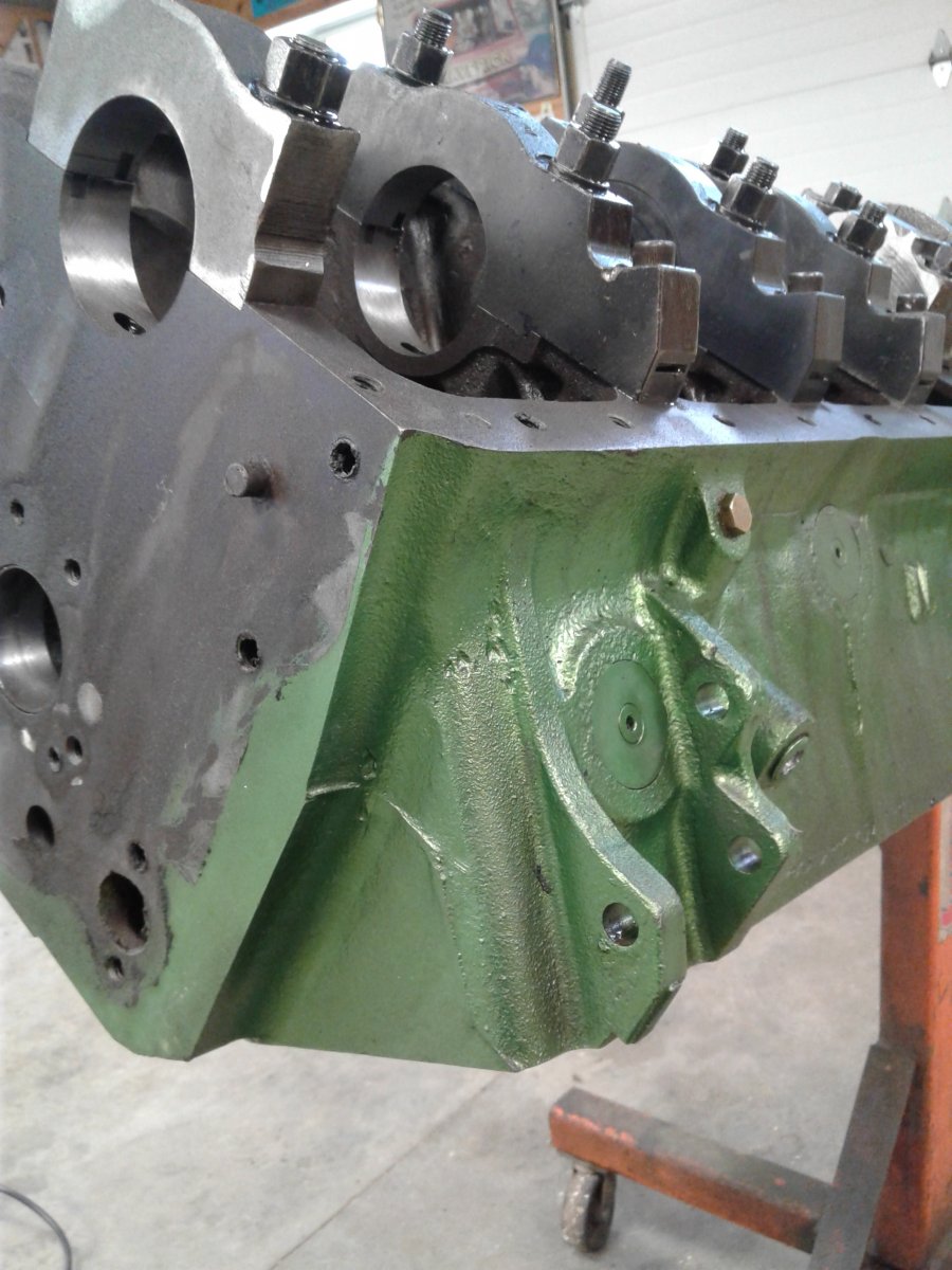

  25. 20170305_183907.jpg When i took the engine apart last fall i noticed a strange wear pattern on the thrust bearing. It was wearing at 2 and seven oclock. The cap was fitting loose in the register. This cap was in a different block that tossed a few rods a few years ago. I got a new hot heads cap and sent the block out to have the new cap fit. This required a align bore. Before i cleaned the block i cut off the motor mounts. They were in the way when i would try to take the headers off. Between the motor plate and frame my hand doesnt fit well. This was something i suffered with all last year. Sometimes its the little things that can really make a difference. Nothing a sawsall and grinder cant fix. 20170305_184144.jpg 20170305_171615.jpg 20170305_183840.jpg
