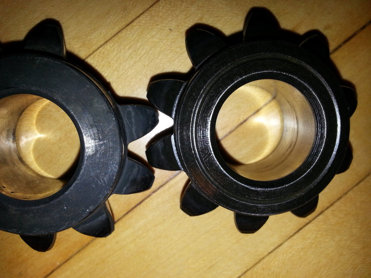

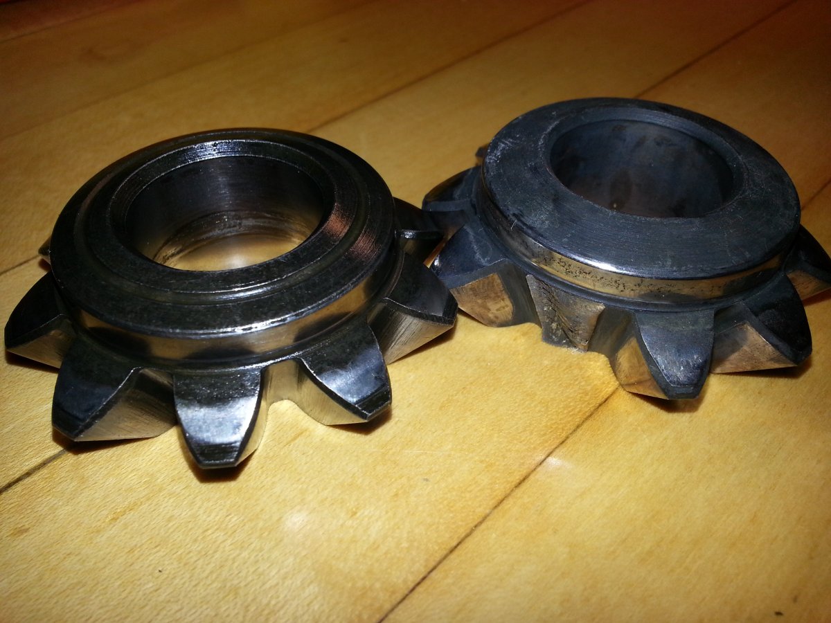

  2. 20150930_170520.jpg g 20150930_170511.jpg The spider gears showed up today. As promised here are the pics. The regular spider has a broken tooth. the special gear has the groove cut into it. thats what you look for. Good luck hunting.

  4. On drag week 2013 the spiders broke. We think the cause of the failure was the bolts loosened up on the sure grip case. The case is two pieces. The cross shaft holding spiders ; the clutch pack; and side gears are inside. when i took it apart to repair it some bolts were loose. The bolts need to be lock tighted. I dont remembee doing that step. This time around i dont know. The early pro stock cars did have enough power to break them on occasion. It was not a wide spread problem. Chrysler asked dana for a fix and these gears were the cure. I hope with the new gears and a car that weights 700lbs less the trouble will be gone. I will still keep a extra set with me. Just in case. Good luck on drag weekend.

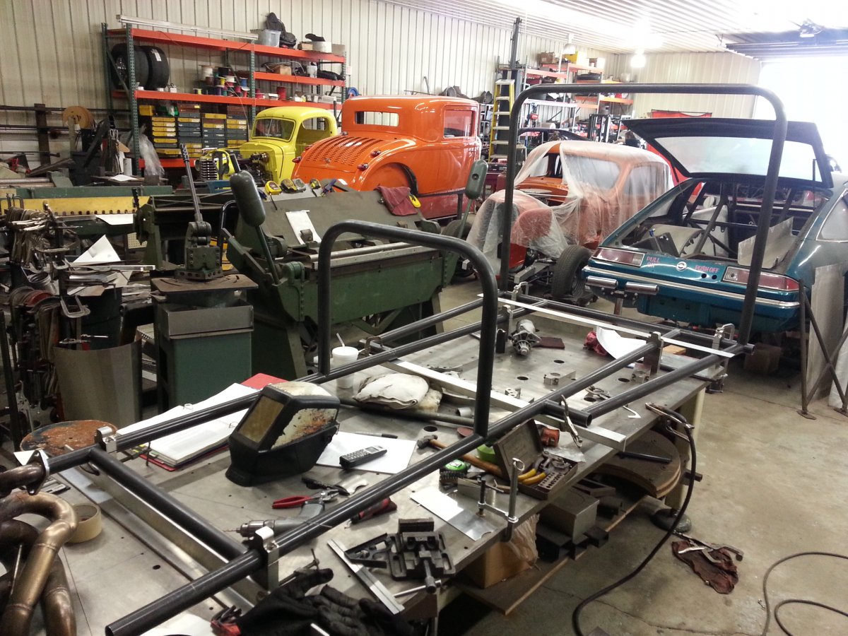

  15. 20151001_093631.jpg This is the way the cage will be made. Each color represents a specific diameter and thickness tube. These plans must be adheared to. When a car is going for a 25.1e ch***is tag it will be looked over very closely. They have a gauge that checks the outer diameter of all the tubes. A sonic checker is used to measure wall thickness. A visual inspection of all welds is done to make sure the tubing is welded all the way around. The ch***is is compaired to nhra prescribed plans. If it all goes well you get the tag. The inspectors doing this kind of work are not your local track tech crew. They are nhra ch***is safety inspectors. We are just waiting for the mid plate material to show up today.

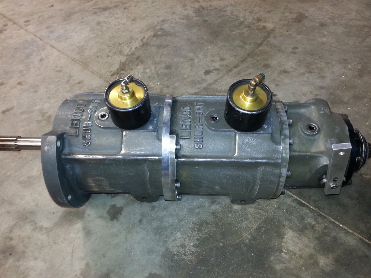

  16. Parts just seem to keep following me home. This time its a lenco three speed with a 1.89 first gear. I had the option of a 1.81 first gear. My thinking is with only 392 cubes i need more gear in first. Its like new inside. It has the larger helicopter spags front and rear. The shafts are the larger fine spline and the clutch units are both lightened. Every thing has been coated for longer wear. I need to modify a gear in the reverser so i can have a neutral. A lenco is other wise in a gear all the time. a cetrifical clutch would normally provide the needed slip to make the forward to reverse changes. Also it makes it easier to push the car around getting rid of the trans drag. The coupler unit on the back needs to be changed to a slip yoke style. Im taking the air pods off so i can shift it with levers. A friend has some he is not using. If i did the air shifter i would need a air bottle the size of a fifty five gallon drum to drive it on the street for long periods of time. Im looking at a bruno conver adaptor. Im hoping to get that wednesday. With the torque multiplication of a converter i can use a three speed. This will save weight and shorten up the trans by a needed foot. If i do a clutch i have to bolt on another case to make it a four speed. Im a hard core manual trans guy. There is just something about a engine at max rpm and pulling the next gear. Its a lost art. I just dont think i can shift the car four times in seven to eight seconds with a h patterned shifter. With the damage to my knee im not sure leaving a clutch in the car would be a good idea. Parts breakage will be reduced with the converter which is a plus. For those not familiar with a bruno it uses a torque converter to drive the lenco replacing the clutch. There is a band over drum thats air activated. The power needs to be stopped going into the lenco to be able to shift from forward to reverse. Activating the air brake does that. Once the lenco is in forward the shift levers do the rest. I ran a identical set up in the altered wheelbase car. They work great. 20151004_170951.jpg

  18. I forgot to mention the input shaft needs to be removed. They just pull out by hand. The lenco bolts directly to the brunos splined shaft exiting the rear of the unit. I hope i did not confuse anyone. Also the bruno fluid does not p*** through the lenco. the reverse unit can be flipped over to put the lever on the p***enger side. i will most likely set it up that way to provide extra room on the left side.

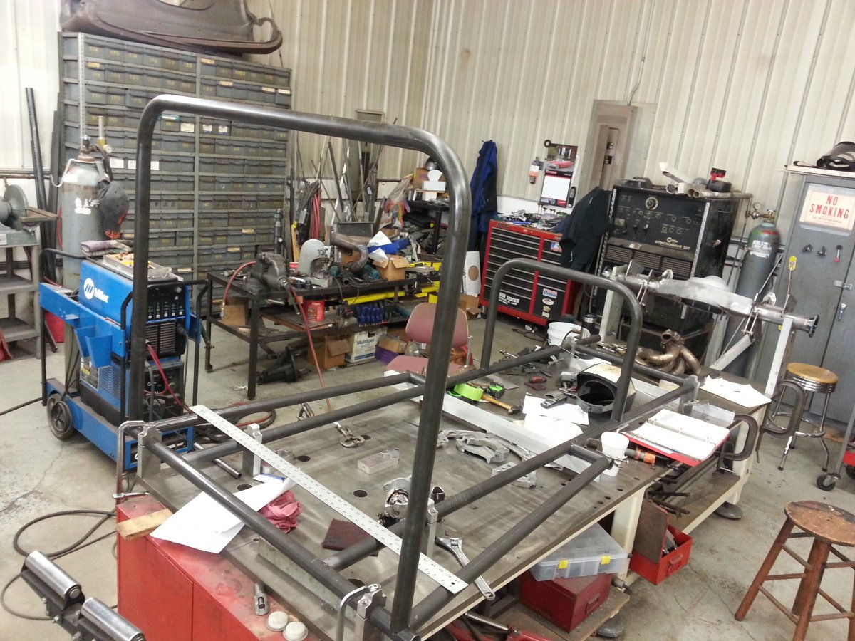

  22. Its a big day for me today. I stopped by the ch***is shop to get my first look at the frame. There is not alot to look at but every long journey starts with a first step. What you are looking at is the frame table with the main rails on it. bar -1 and 2-a from the plans posted above. This table is the flattest thing in the county. It allows bars to be clamped in any position. Being the foundation for the entire car everything needs to be flat square and parrallel. Nothing can move around. It all starts here. The bar in the fore ground will have the main hoop attatched to it. The small hoop goes under the dash. Jim and i went over several details pertaining to the car. After the main hoop is attatched there will be a day or two of measurements and tube bending. It will go back and fourth. This kind of work cant be rushed. I will continue doing my part to get all the components freshened up so when the ch***is is done everything can go right in. At least thats the plan. If it was easy everyone would be doing it. 20151005_111012.jpg 20151005_111012.jpg 20151005_111003.jpg

  23. More progress today. The main hoop bar 10 bar 8a and 8b are tacked in. The hallow and a pillar bars go in monday. I got a call today the front wheels will be done friday. Pics to follow. The torque converter was ordered from dynamic converters in delaware. I have used their products in the past. I highly recommend them. The shift levers are in the mail for the lenco. The flex plate has been ordered. As you can see there are a lot of details to take care of. 20151008_143925.jpg 20151008_143946.jpg
