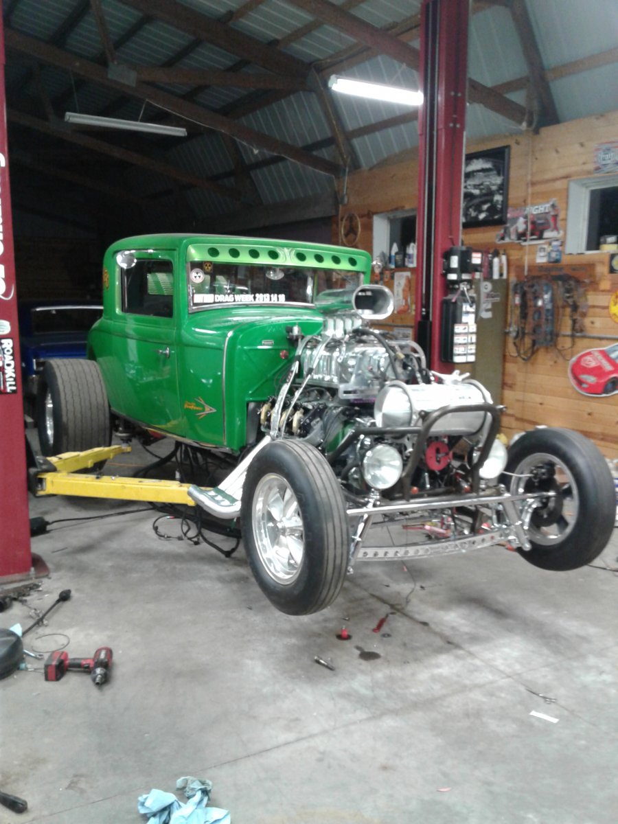

  8. It was a rough day. It was hot and humid. I started at 8am its now 3am. There is a lot more work to do. I hope i can have a easier day coming up. 20170611_024623.jpg

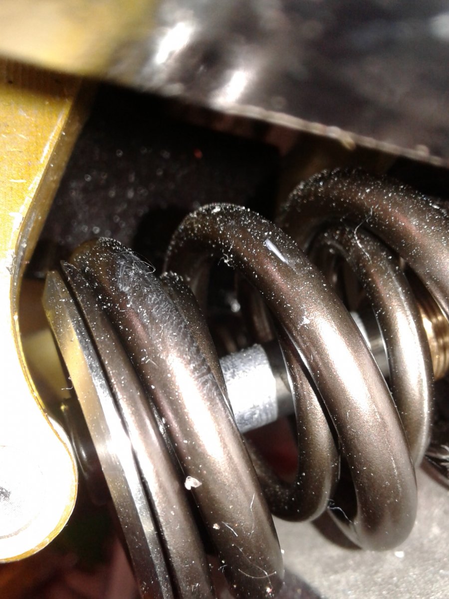

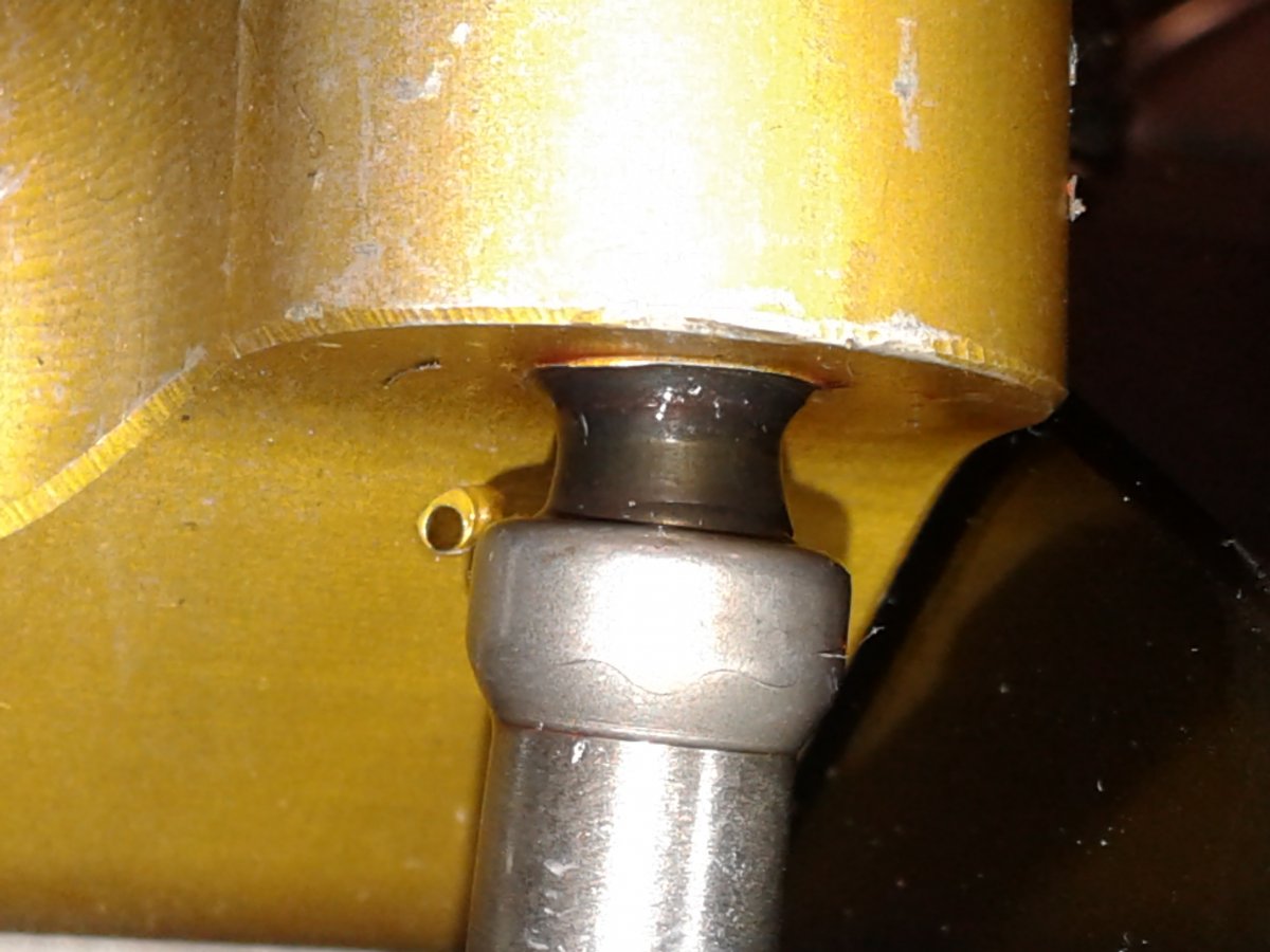

  10. Im certainly no quiter but sometimes you just get beat. After a two and a half day thrash the car is ready to race almost. The new heads with the 1.950 installed height have not been bolted together with pushrods before today.
    With all the new changes to the combination the pushrods are too long due to the need for a lash cap on the exhaust side. We need the lash cap to tip the rocker back for retainer clearance. It wont be safe to run the car the way it is now. I will get out the pushrod mock up tools and set one up. This mock up along with three sets of exhaust pushrods will go back to manton to have some cut off. I need to mention my friends at cometic gasket sent me a care package with new 6 bolt intake gaskets. These gaskets are made to my specs so i dont need to do any t*******. They also eliminated the 16 holes i wont be using preventing a possible blow out. We came real close to making it real close. 20170530_101717.jpg 20170611_213340.jpg 20170611_212949.jpg

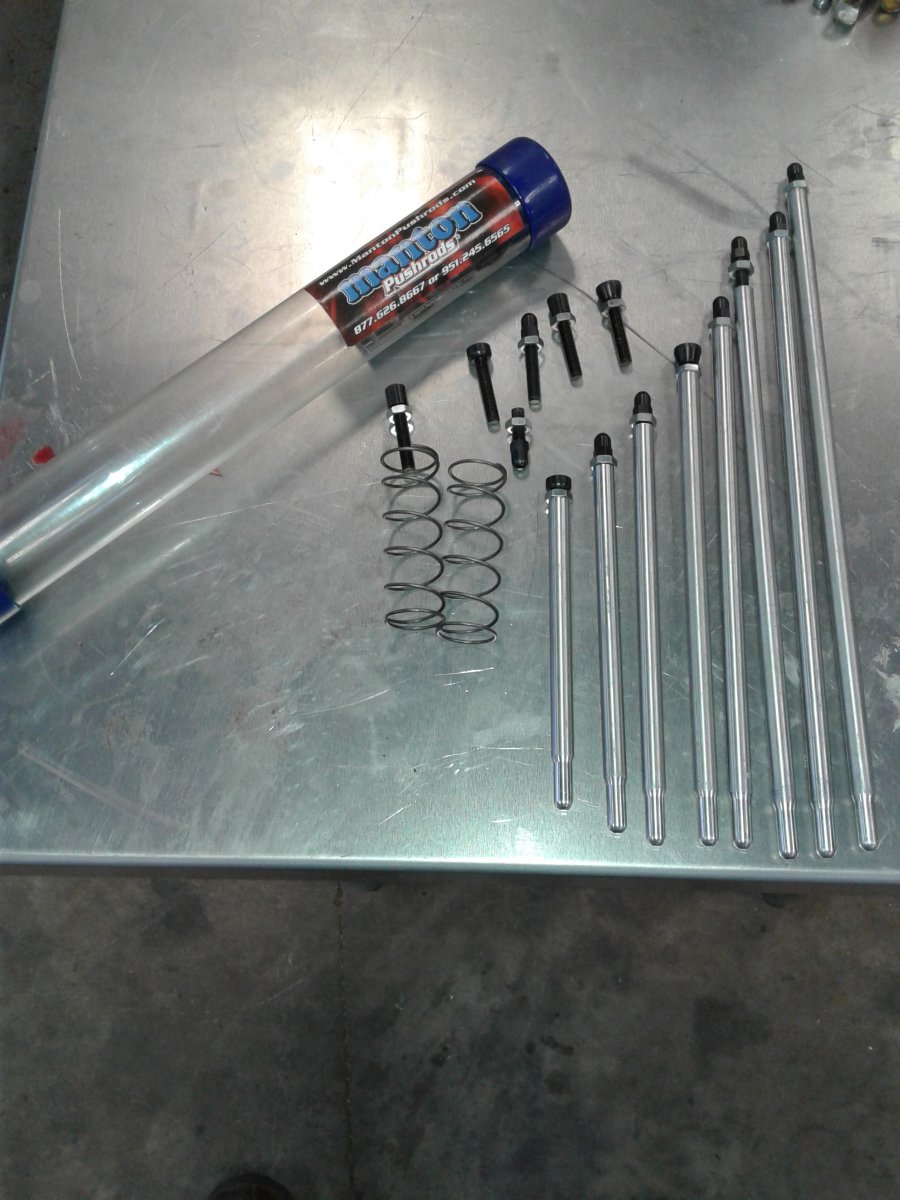

  25. I got out the pushrod checking tools. At pri a few years ago manton was selling this kit for 25 dollars. It contains several lengths and various screw in tips. Also included are a pair of light weight springs. To use the kit select the correct length and tip. Install it and adjust the length to suit your application. Tighten the locking nut and you now have eliminated any guess work. Ship the sample back to manton so they can make a perfect set of pushrods for your combination. A hemi uses two different length pushrods. My friend mark also bought a set. We share them back and fourth. It was difficult to get good pics but it does show whats going on. The last two pics show with and without a lash cap. They speak for themselves. 20170612_185624.jpg 20170612_190310.jpg 20170612_191625.jpg 20170612_192536.jpg 20170612_192559.jpg

  26. Its alive. We are 20170618_173936.jpg getting real close to start up. The electrical was taken care of today. With that done i could crank the engine for oil pressure. I can also watch the fast box. It has lights that go on when all systems are go. I have been concentrating this weekend on finishing up some things that were not completed last year. All i need now is my exhaust pushrods and a few interior panels and its off to the races.

  30. It ready. The interior and new pushrods were put back in friday. The air shifter and fire bottles were hooked up today. The mag is timed for the nitro now. Alot of small details have kept me busy. I hope to get some miles on it sunday. 20170624_192658.jpg 20170624_192539.jpg
