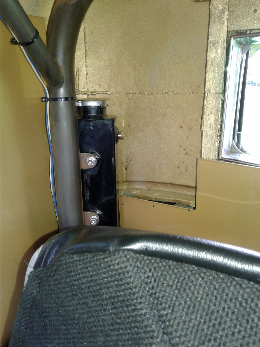

  14. The first road trip went well. The expansion tank that was added over the off season worked great. I was having trouble keeping it cool. I explained the situation to the guys at mezziere water pumps while at pri last year. They looked at my pics of the system and told me to add the tank. It has to be mounted higher than the radiator. It has lines going to both the hot and cold side. It removes the air in the system allowing it to make pressure. The way the radiator was mounted on a angle it always had air trapped in it. It works so well now i could drive with one fan on getting no hotter than 185 degrees.
    Due to limited space in the trunk its mounted inside behind the p***enger seat. Two number 6 lines run to it. Its info like this that i get from the manufacturers at pri that make that trade show so great. I was able to drive the car out to union grove and back. Its about a 50 mile round trip. 20170626_155141.jpg 20170626_164440.jpg

    The rebuilt tank bracket fits right in. It doesn't jump out at you, you have to be looking for it to pick it out.
