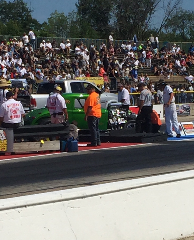

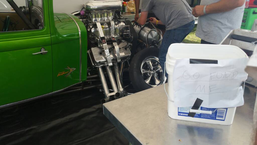

    My wife and I were able to hang out with Brian Saturday and had front row seats for the mishap. He sure had a lot better attitude about what happened than I would have. This is directly after. Hard to see, but the bucket says "Go Fund Me"
    Good luck, Brian.
