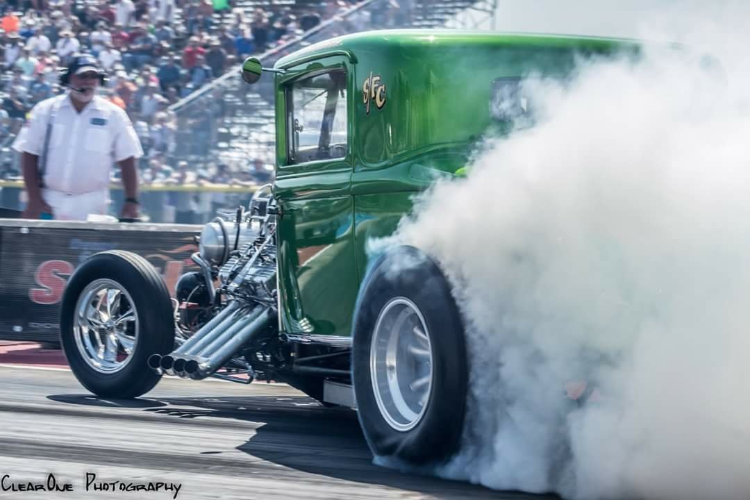

  24. Cara Marie
    Joined: Jul 18, 2016
    Posts: 37
    Cara Marie
    Here are a few pictutes I found online from ClearOne Photography.
    [​IMG][​IMG][​IMG][​IMG][​IMG][​IMG]
    Sent from my SM-G930V using The H.A.M.B. mobile app
    David Gersic, els, Woogeroo and 10 others like this.
