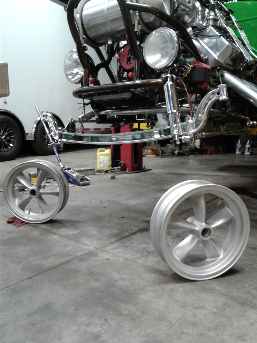

  1. the wheels should have arrived today. they will get polished after we are done machining them. it most likely wont happen right away. I swear at the wheels every time I have to polish them. when im done I step back and think how cool they look all shined up. there is nothing like polished magnesium.

  5. the head headlights; shocks and wheels arrived. the wheels are some of the nicest mag wheels i have seen in some time. the old tires on them look brand new. vern offered up a great pair of wheels. i was able to remove the three front exhaust pipes today. i put them in the band saw first cutting them off close to the flange. then used a hard grinding wheel to remove the left over material. i finished it off with a flexible abrasive wheel to remove any left over powder coating. then i needed to die grind out the weld and pipe on the inside of the flange. that ****ed but its done ready for new pipes. the bracket for the torsion bar heim was straightened and welded. i also picked up a new heim joint. i pressed bushings into the shocks and removed the barrel valve. i need more time in the day. they are too short.

  9. It may not look like much so far but the car is going back together. I needed to get some work done before the axle went back on. The front section of frame that is removable took a hit. The fuel tank and headlight would not go back into position. I used a porta power to move it back where it was originally. It wasnt off much but i needed get it right without making it worse. It took some time but everything fits now. The torsion bar has also been re***embled and installed. Im confident i will get it done so i registered for the hamb drags. 20170721_203740.jpg 20170721_203831.jpg 20170721_203842.jpg

    Brian glad you are getting it back together and hope all goes well at Woodward and if all works out I'll see you at the H.A.M.B. Drags also I was wondering on your front wheels why you don't just use the new American spindle mount 5 spokes they are all ready machined for disc brakes I get that aluminum wheels are not mag but in your case I would think it would cost less and could have parts quicker in this instance
    els and loudbang like this.
  12. Tbere arent any available and havent been for years. i have never seen a set used for sale. the new ones only came set up for a anglia spindle. this would create another mess because no one makes a axle for anglia. i found that out the first time. it took 40 hrs to make the last axle. with the ford style wheel i can use off the shelf parts saving a lot of time. we need to do the brakes either way i just cut out doing a lot of work. i did think about that option.
