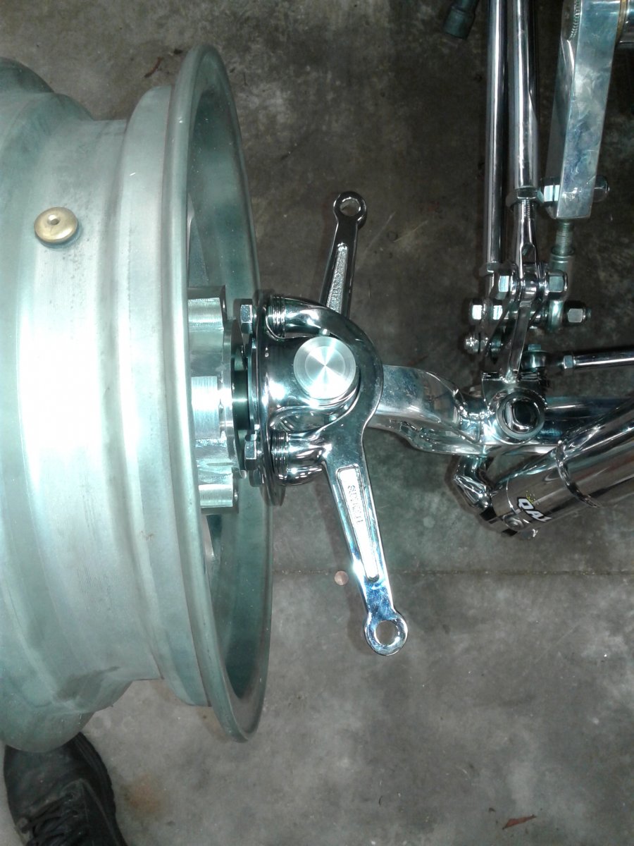

  18. The first half is done. The spindles now fit the wheels. After lunch the hats go on. 20170731_110304.jpg
    els, chryslerfan55, loudbang and 4 others like this.

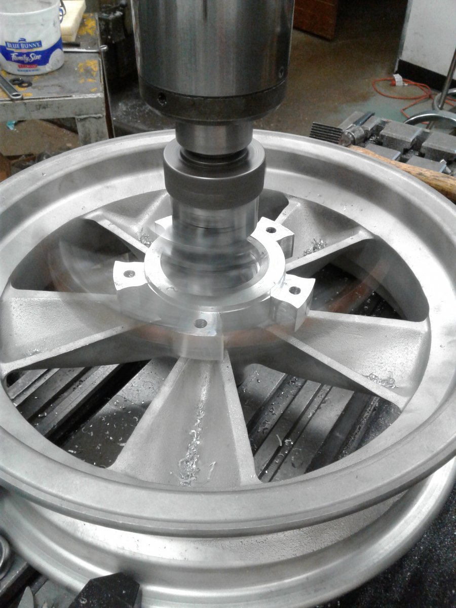

  19. 20170731_183617.jpg A register was cut on the inside of the wheel. Being a casting there is some variation on the size. We cut in enough to have a .125 register. The adaptors are then cut to be pressed on. 20170731_154228.jpg 20170731_141957.jpg 20170731_160241.jpg
    els, chryslerfan55, Jet96 and 5 others like this.

  21. 20170731_190018.jpg I just need to make caliper brackets. 20170731_185201.jpg
    els, chryslerfan55, OahuEli and 9 others like this.

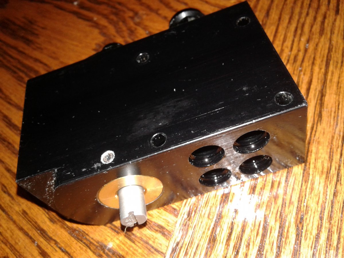

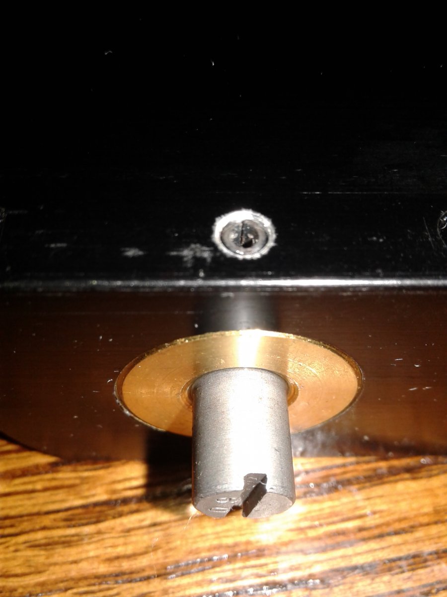

  22. 20170801_021244.jpg I got home after a 5 hour drive to find that the new barrel valve had shown up. The new one is pinned to retain the bushing. I dont know if this was done special for me or if this is a design change. The incident certainly has not gone unnoticed at hilborn. I will follow up with them soon. 20170801_020406.jpg

    I'd say it was done special, otherwise the roll pin hole would also be black anodized. Think I'd still be more comfortable with a threaded set screw with lock tight, but they should know what will work.

  26. I wish i got paid. The main thing is the videos recorded the incident. Now hilborn will decide if they are going to make a design change. Im thinking they will. They cant have anything like this to ever happen again. Everyones safety is my biggest concern.

  28. I put the new barrel valve on today. Hilborn put the roll pin on the bottom of the bv. This is a good idea. The pin is now trapped between the bv and the injector casting. It cant possibly come out.
