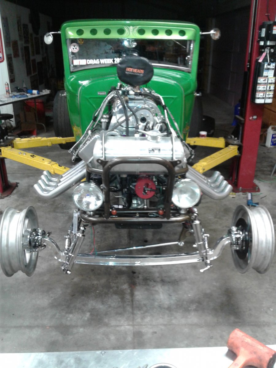

    maybe an optical illusion but the engine looks high on the p***enger side, like it's ****ed over a bit

  18. the rocker cover is off of the drivers side. thats why it looks funny. tonight i removed the front drivers side motor plate. it came right off and bolted right back in. i had a water drip coming from that area. if the ch***is was sprung it wouldn't go back on so easy. i went back to look at the recent pics. i had to look at them closely to see why it looked funny.

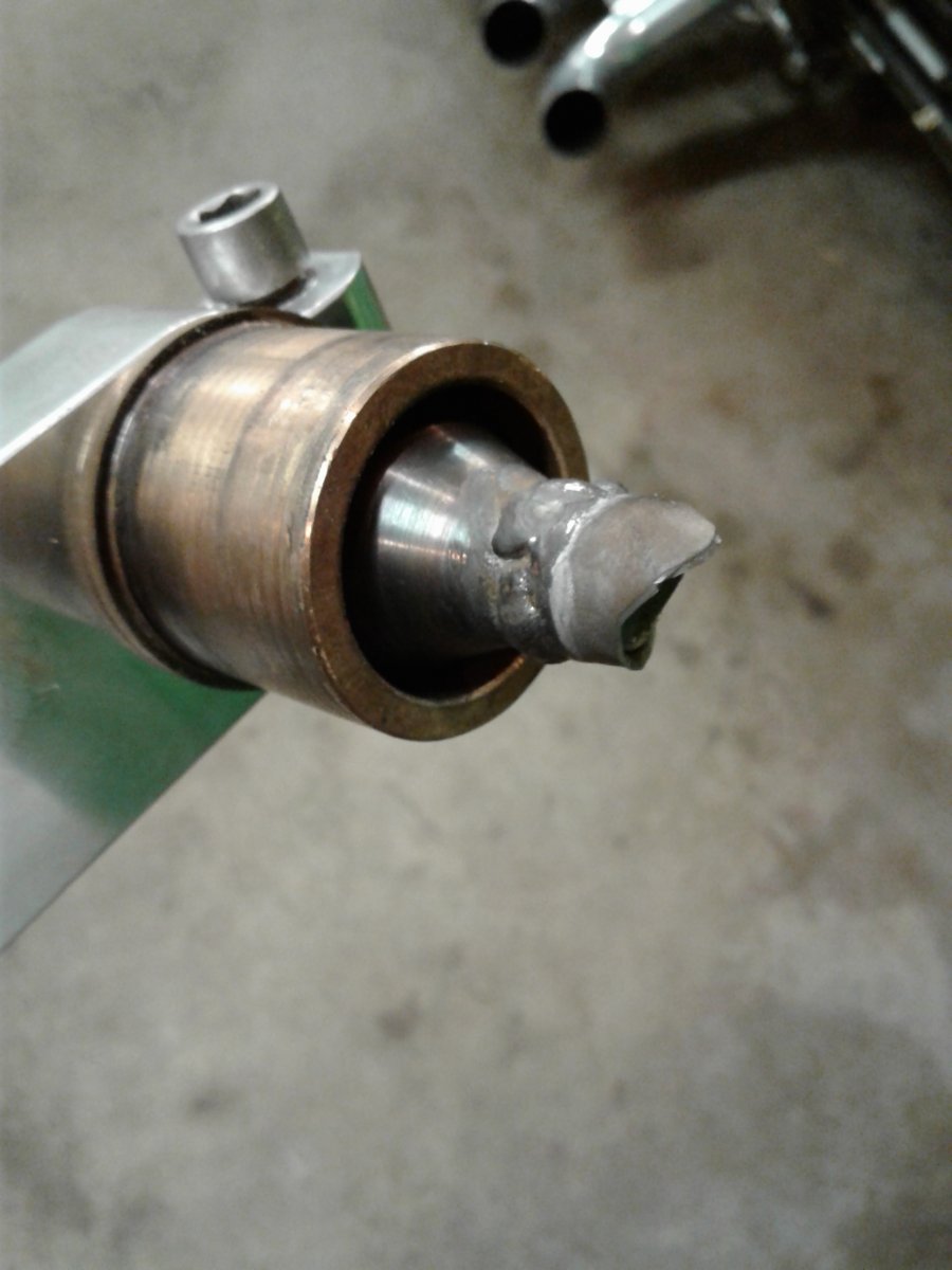

  22. 20170814_180750.jpg We made it to detroit. I spent some time in my sons shop working with him on his 69 super bee. It was recently upgraded with a fast efi system. The car is crazy fast now. We were going to take both cars to the road kill event. Were being the key word. The torsion bar broke on the righr side. This bar was bent in the crash. Sway away told me i could straighten it in the press. We did this compaired to buying new ones because of the eight week delivery time. I called the owner of sway away pleading my case. He pulled some strings with a expedited charge attatched. The heat treatment is a two day turn around alone. A better m-300 material is being used this time. Red labelled it should be here thursday by noon. He also told us we could weld it back together with a sleeve but dont race it. We tried that with poor results. So whats another grand in this anyway. Im spending the next few days getting ready for the hamb drags and drag week while i wait for the bars. Good news is the little trailer fits in the big trailer as planned. 20170811_224013.jpg 20170811_223846.jpg

    Maybe you won't say it, but I will, That ****s, glad you will be getting the replacement expedited though!
    Edit: Good thing is that it didn't break at a most inopportune time, while under power and high rate of speed which would have been much worse!

  25. Sitting on the side of the road broke down some where during the hamb drags or drag week would have been bad. Yes it ****s but at least it was found before i was making a p***. The bars take about 15 minutes to install and set up. Its no big deal. I should have it all back together and loaded up before my copilot gets out of work.

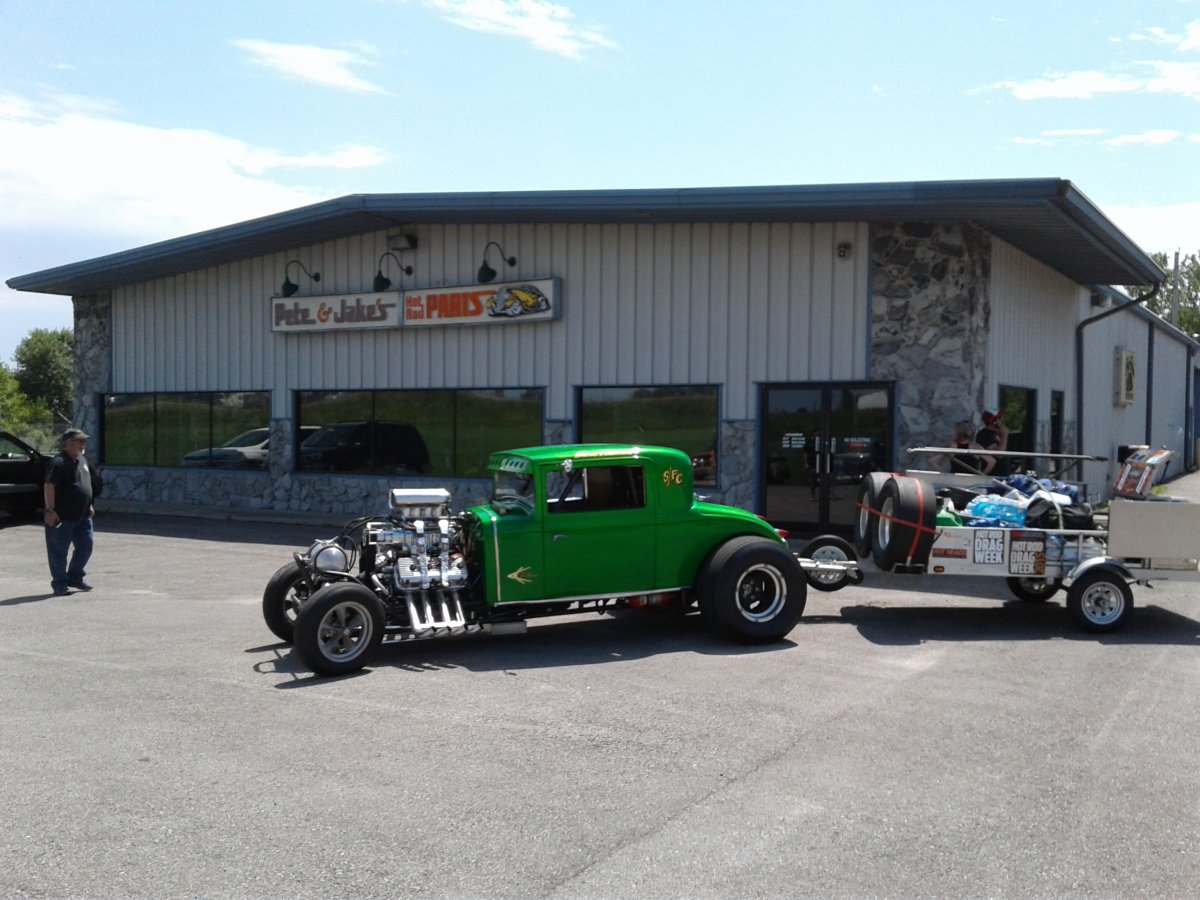

  30. 20170818_132403.jpg We made it to tims just fine. Unloaded the car and trailer. We stopped at super bell to personally deliver the axle. Now off to mokan. One of the things we are experimenting with is driving with the trunk off. Its good for 20 degrees. Running a cool 180-190.
