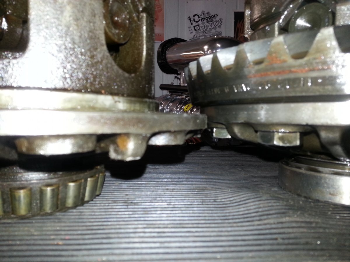

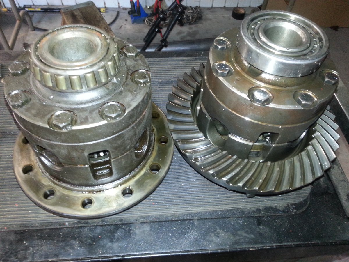

  4. 20151009_123735.jpg 20151009_123759.jpg I got lucky today. i have the parts i need for once. I need to swap gear ratios. To achieve the speed i want the 4:56 gear needs to go. Im going with a 4:10. With less weight and more power this needs to be done. to use this new gear the carrier needs to be changed also. A few years back i bought a pair of carriers for the cross shafts and spider gears. I was not concerned what ratio they were for. I looked at them today and i have the right one. The unit on the right is for a 4:56. The left is 4:10. the 4:10 can run a spacer to use 4:56 but not the other way around. The 4:56 carrier measures about 2 1/2 inches to the ring gear. The 4:10 about two inches. Another good swap meet tip there. I used a 3:73 in the 65 dodge. To use that it had to have a ford pinion bearing and other special parts from strange. I hope i dont have to step it down further. Nitro motors like to be pulled down at the hit. I do have more options that would be to change the first gear ratio to 1.81 to help with the launch. The other is the bruno. On a bruno the pressure that the pump makes is adjustable. The slip in the converter can be adjusted. There is a pressure gauge so you can keep track of changes. Its just a matter of turning a set screw. A violent launching car is a parts breaking inconsistant car.

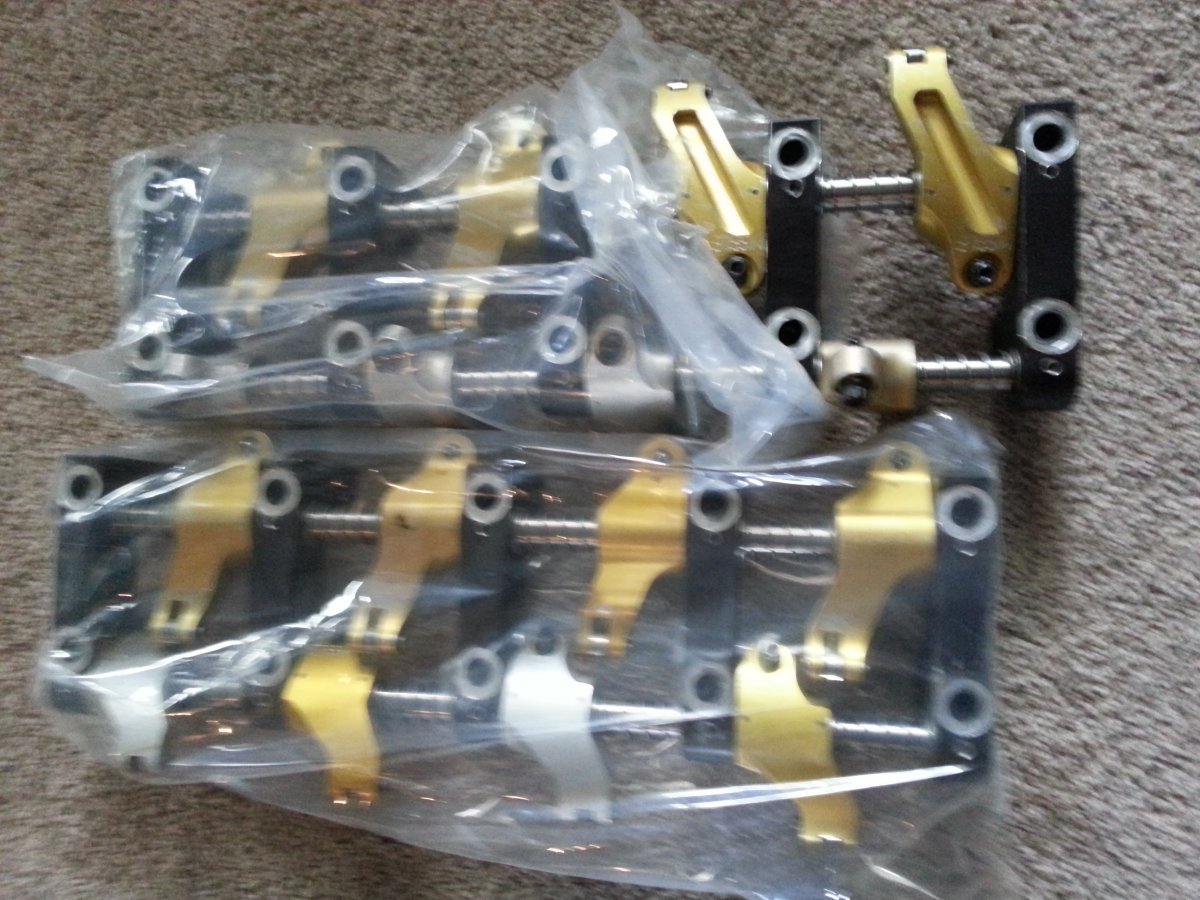

  5. My rockers from missile showed up. I had sent them out to be upgraded. In severe duty situations the bushings can move inside the rocker. Driving on the street in high heat for long periods of time is one of them. The rockers are drilled and a pin is pressed in. There are two bushings per rocker. 20151008_162713.jpg 20151008_163040.jpg

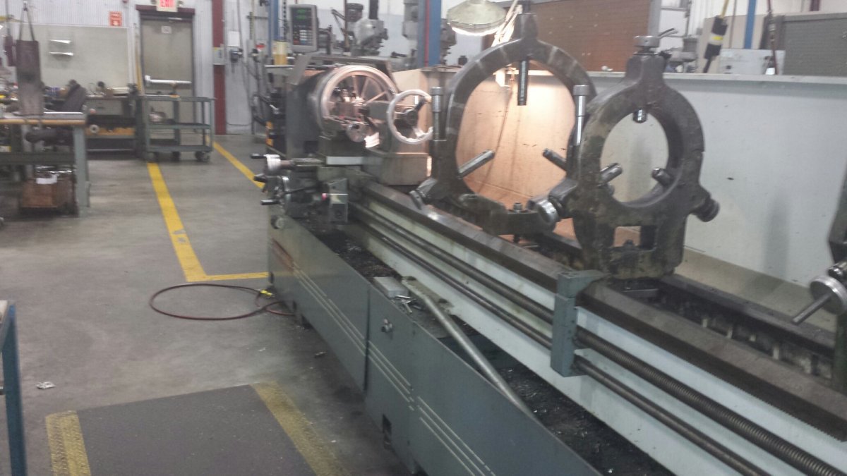

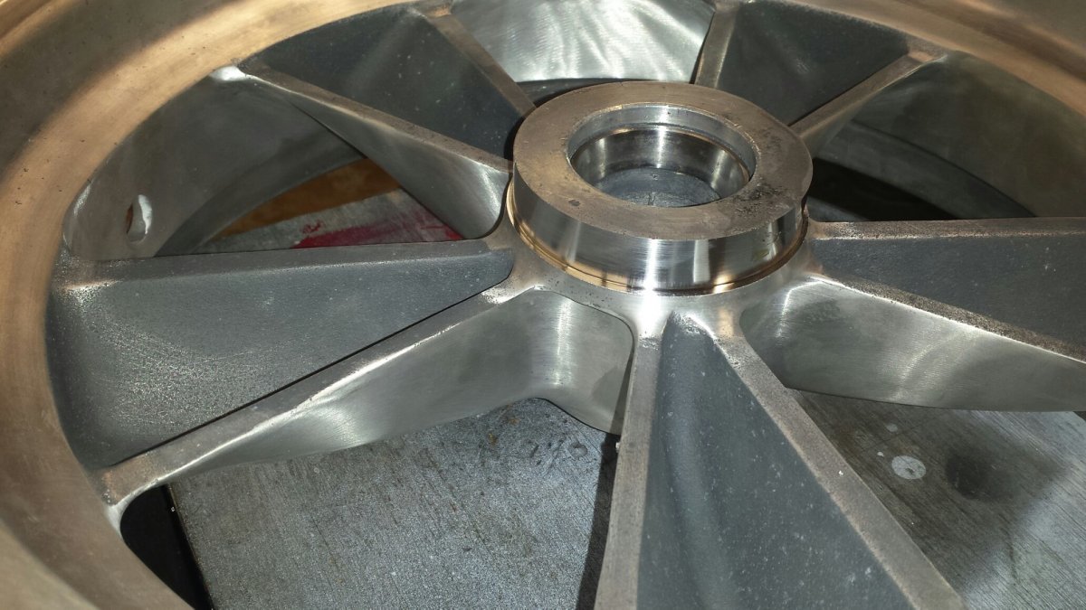

  23. Cutting the register for the hat. centers were made to hold the wheel true. 20151014_152450.jpg
    els, Woogeroo and squirrel like this.
  24. 20151014_172858.jpg the registers for the hat are done.
    els and volvobrynk like this.
  25. The finished wheel. New hats will press onto the wheel. Looking good so far. 20151014_172920.jpg

  28. as i have mentioned before it takes several peoples talents to build a car. some of the things i need to do are outside my skill set. i try to do as much as i can. this work on the wheels is above my skill level and i don't have a big enough lathe if i could do it. the work being done on these wheels is the work of tim harris. he is from the st.louis area. tricky steve turned me on to him and i am very lucky to have him on the project.
