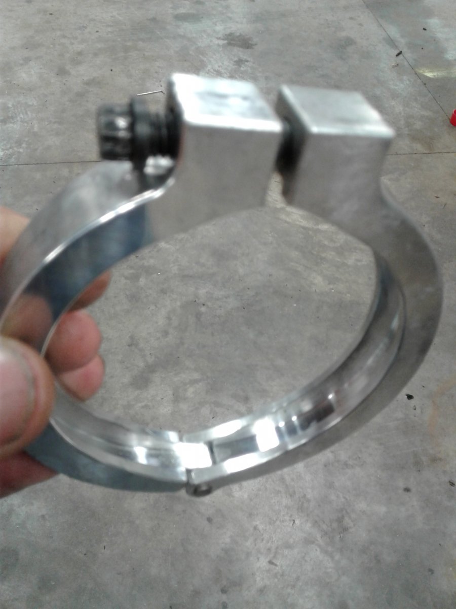

    Brian how exactly do you disengage the mag and nitro pump I know you have a offset dual drive I never give much thought to that as I'm sure it would take a toll on it just running it all the time with the mag grounded out and fuel pump looped with some lubricant in it

  16. wrench bender the way it works is like this. The cam gear gets a drive spud bolted to it. A hex shaft slides into the spud. A pump extension goes over this shaft and bolts to the timing cover. A sealed bearing inside the extension supports the shaft end opposite the cover. There are pieces bolted onto the extention and dual drive. They are called wafers. There is also a role pin to index the two halves of the wafers. Thats what all of the little holes are for. the role win can be seen.The raised outside edge of the wafer has a beval cut. When the wafers are brought together a billet clamp is attatched holding it all together. The hex shaft engages the dual drive turning both the mag and pump. The clamp allows for quick dis***emble. The setup is rather heavy so its supported when not engaged. I dont want the dual drive spinning unless we are racing. I dont want wear and tear on the components. As long as the engine is turned over to 36 degrees before dis***emble and returned to 36 degrees before re***embling it all goes back together quickly. The rotation of the pump and mag have to be correct or they may end up running backward. We use readily available parts then modify them in a way they were not designed to be used. If i had it all connected on the street the tank would have to be full of something to make sure it didnt run dry. Its plumbed in a loop so the fuel can go round and round under no pressure putting no wear on the pump. The mag on the hand will get worn out or out of adjustment if set to run all day. The points like any others need to be adjusted at times. the mag has a clamp that allows me to rotate it to correct timing if its needed. the pump has a special clamp that can be loosened up for quick pump removal. i hope this explains the dual drive. if not ask more questions and i will do my best to answer. 20170822_201136.jpg 20170822_201212.jpg 20170822_201232.jpg

    Right on brian thanks I didn't realize that you unhooked it like that I fully understand how it works and I can appreciate the making things work the way you want not always what they were designed for I could go on and on with technical questions about your setup I'm very interested and intrigued with it especially with how you tune the mechanical side of things the electronic side is no sweat for me as I have delt with electronic injection for decades but mechanical stuff im still learning and want to get good at it and if you ever decide to dust off the ol 65 s/fx you have a crew member eager to learn the process lol thanks for all your info
