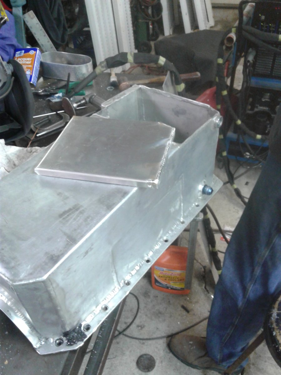

  3. The first time out with the new pump did not produce the desired results. While better it needs more volume . There has now been a change of plans. The pressure screws wont help. The pump needs to be bigger. So the pump is back out for a return trip to michigan. It will get a new set of gears 1/2 inch longer. This will increase the output 30 percent. That will increase the pressure. That should do the job. Now that we have a baseline im confident we will get the results we desire. To make it fit the pan needed to be cut up and deepened a matching 1/2 inch. R and d can be a learn as you go kind of thing. I know we are real close now. 20170827_203405.jpg

  5. It takes a serious effort to make this car do what we want it to do. There is no easy way to do it. Bob stephans made the pan originally so i called him up this afternoon and asked if he had time this week to work on it. He told me to drop it off. When i got there he asked if i was going to wait for it. I didnt think he was going to do it tonight. Its a hour drive to his shop in illinois so i figured im better off waiting around. A few hours later it was done. Bob is a racer he understands time constraints. With luck im hoping to have it all back together on friday. Some how in this busy weekend i also replaced the melted lexan windshield. The nitro melted it instantly when it got sprayed.

    Whit this pump change you may want to keep an eye on the dist drive gear and cam gear.
    els, mad mikey, bobwop and 1 other person like this.
  9. Thats a regularly serviced item for me. As the gear wears the timing changes.
